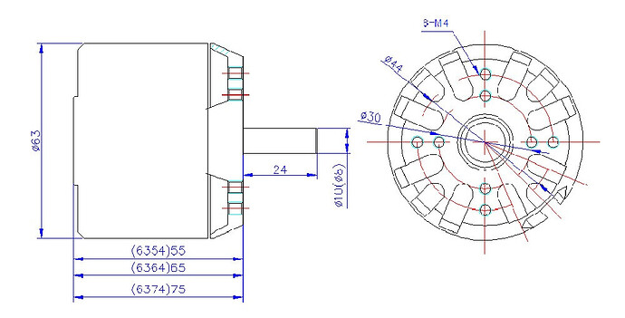

I’m trying to find the motor mount pattern found on most of our 63xx motors. If someone replies to this with the image I will add it to the wiki
APS 6374:
Flipsky 6374:
im busy atm, if u can add them that would be great, thanks
Done :slight_smile:
