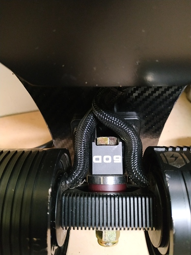

OK @spade a couple of things about your setup from your recent post. Bustin boards have a tendency to hammock the setup in that the flex and rocker of the deck cause both the front and rear truck to be angles above their base pate angles. This can be great for commuting and pedestrian slalom but not so great for stability at speed. Not sure why you are running larger wheels in front than the back but that can lead to unknown issues. The Paris trucks I assume are 50 degree front and back with the added wedging influence of the Bustin, you are likely at 52 to 55 degrees symmetrical which is a handful to handle to be sure. It would take a lot of skill and experience to go fast on that setup. Let me know what you are willing or able to change and we can go from there
Ahh it was probably the change in road that made the board feel less stable or maybe losing grip? (I doubt that in good dry conditions you would lose grip though)
I mean that’s fair, don’t get me wrong, I’m not saying go fight wobbles with an unstable or poorly setup board but a large amount of wobbles are just riding loose and mind over matter. That’s what it did for me as I too came from longboarding background (garage bombing and slides). You just got a new board right? The bustin one? It’s slightly flexible right? Flex doesn’t help with wobbles but I would definitely say as you become more confident in riding that board, the wobbles will disappear without you having to change it.
haha to be fair, crashing in a car or even speeding is way different than crashing from speed wobbles. One on hand you either have a roll cage or at least some sort of metal plating. On the other hand, it’s road rash or bruisings for days :sweat_smile:
Good catch! I just came back from reading his post and realized this might have also contributed to wobbles
Wow! thanks Brad for your much welcomed advice - I have no idea about the exacting degrees on the trucks, but here are some photos I just took to see if anything can be made out just by looking at them… this will be interesting. With regards to larger wheels in front, I have no idea really, of what I’m doing and have many assumptions like loading weight in front and raising the board higher in front because of the ā€œhigher anglesā€ in the front theory - I assumed they are like one in the same?
I’m certain I am wrong after the test run. Most of all, the low clearance of deck off the ground (which convinced me to buy the board) didn’t really help much which again proved my assumptions falsely. The board itself has zero flex- one of the stiffest I have ever stood on. But yes I somewhat feel the hammocking effect.
My goal is simple, I just want to get rid of speed wobbles at top speed of the the board which isn’t really that high anyhow (27mph). I was experiencing it at 18mph onwards and anything you suggest to change is welcomed (I would dearly like to keep these beautiful Paris trucks though) and I don’t exactly have all the expert DIY tools to dissemble the motor mounts from the trucks etc etc… quite limited in terms of what I can do. But thank you!
Loading weight up front is good and the right thing to do but that has more to do with how you position your body weight and not heavier wheels (100mm vs 90mm). The angle is measured from kingpin to the baseplate. Ie it in relationship to the deck. Changing the wheels does not change that angle, only the angle of the deck in relationship to the ground which doesn’t do anything really. You want to change the angle of the baseplate or kingpin in relationship to the deck
