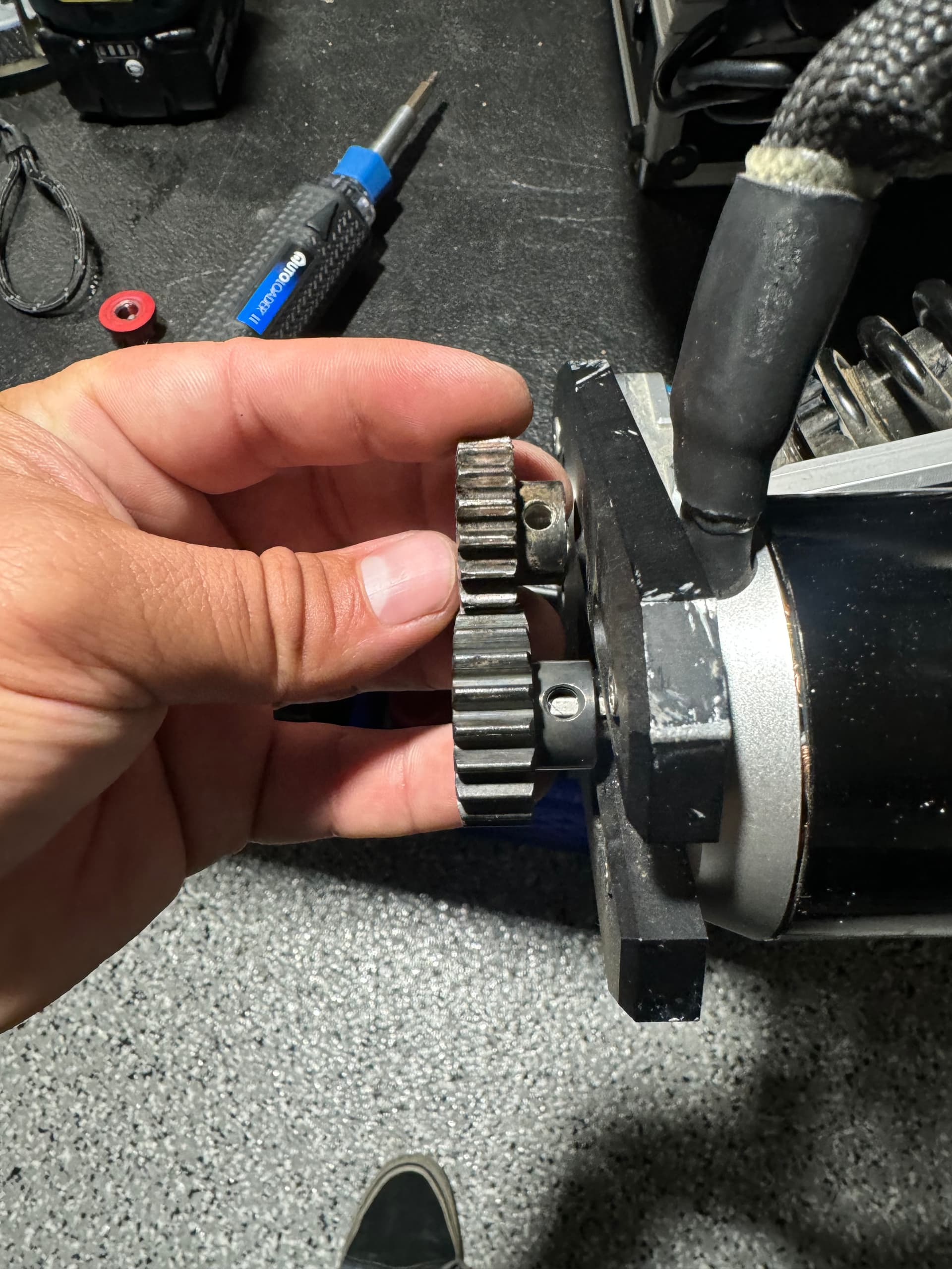

maybe a 14t motor Pinon
I’ve run 170A on zoobomb motors without hitting saturation

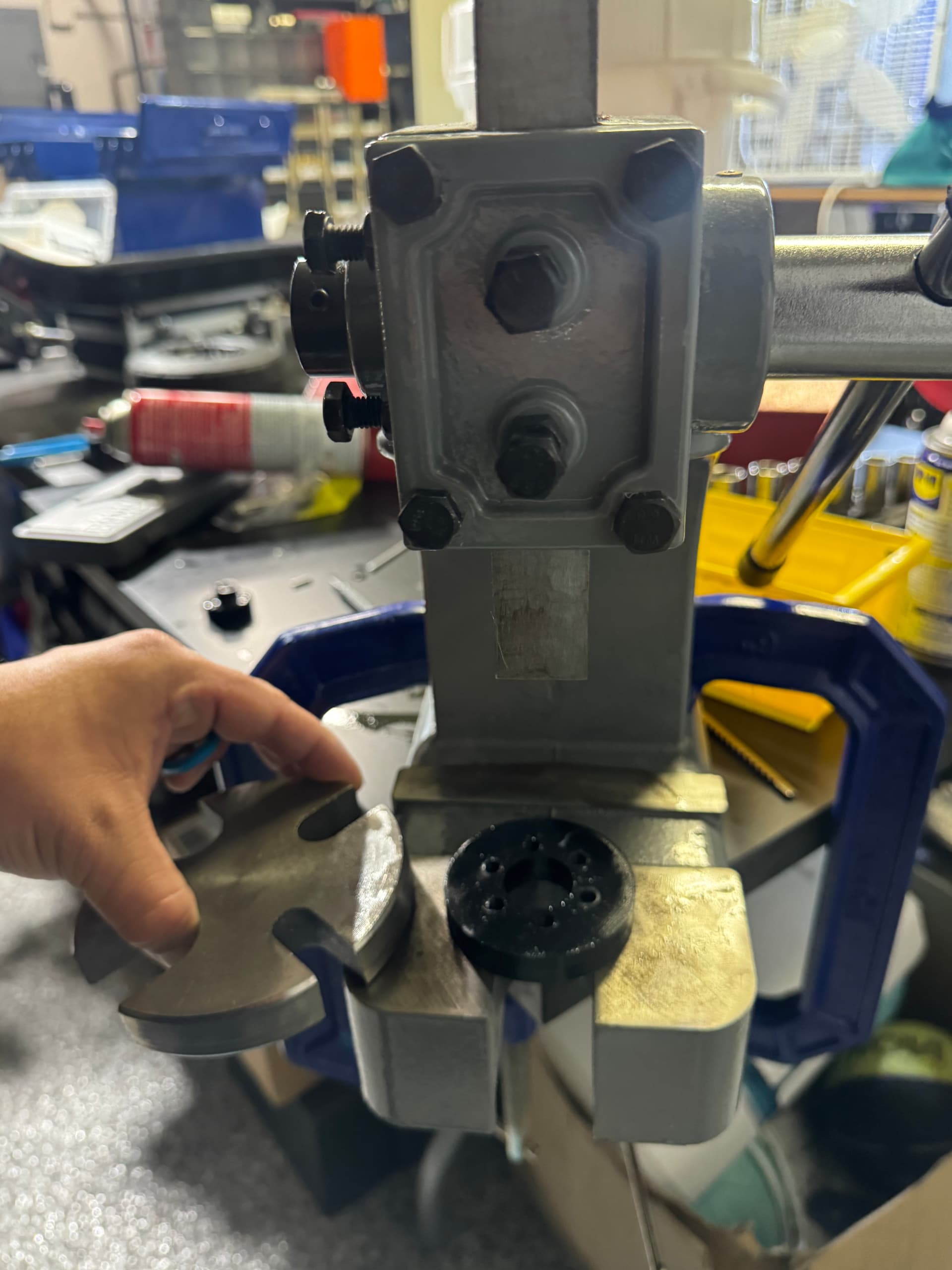

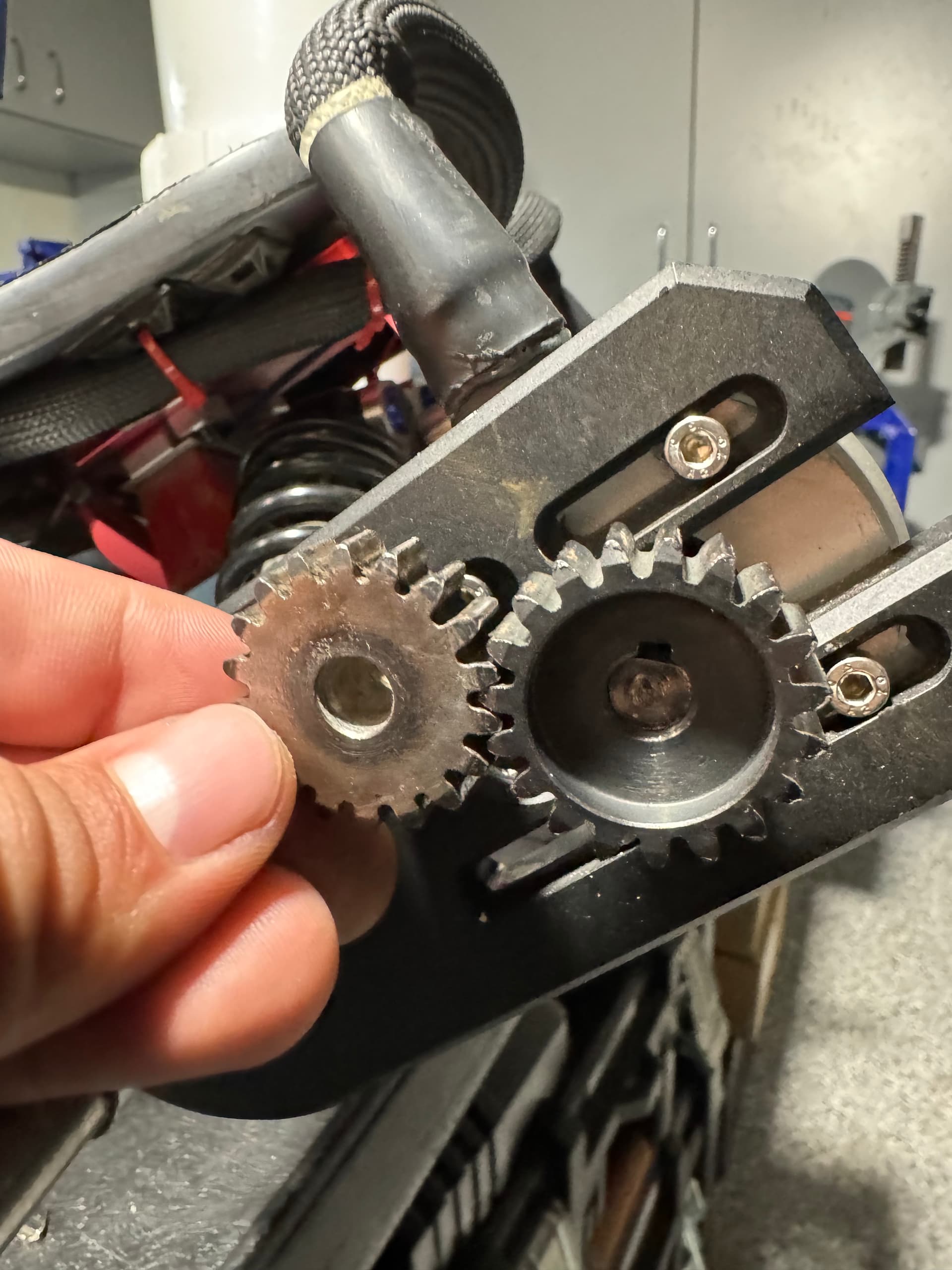

Broachin

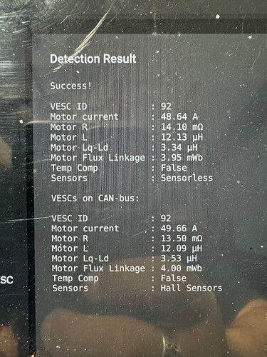

Anyone have any idea what this is?
Really odd…
Dead hall sensors?
@tuckjohn Idk I hope not … I didn’t treat these motors poorly at all I in fact barely ran them.
Gonna try and rerun it through Vesc tool rn to see what’s up.

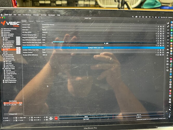

Something might be way wrong I initially set it up with smart reverse and it still says smart reverse when I booted it up
but doesn’t actually reverse :cry:
Shit you were right :(((( hfi here I come
Does anyone know how to set up current Smart reverse in Vesc tool where HFI doesn’t Counteract it?
I have current smart reverse on, and for some reason it still doesn’t reverse, which is weird
Never mind, I figured it out. My PPM just needed to be recalibrated because it was out of value threshold or whatever.
