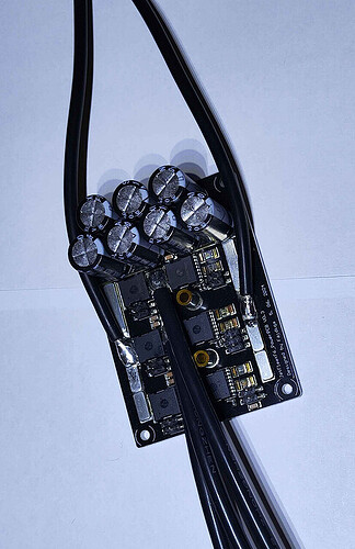

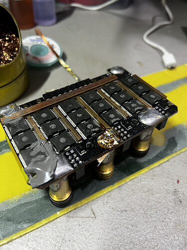

I wanna see someone put the new jet fleet F6 esc in a board. Curious if it’s a contender with g300 or primarily Onewheel focused.
Jet Fleet F6
I think the g300 is probably more powerful than the F6
Yeah looking at the phase amps it seems like a bag of socks
Gimmmeee all the power
I WANT WHIPLASH and nothing less of that

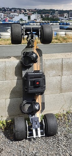

This picture is pretty convincing to run kart tires Hmmmm :smirk:
I am expecting nothing short of this
All neck vertibraes completely vaporized :+1:

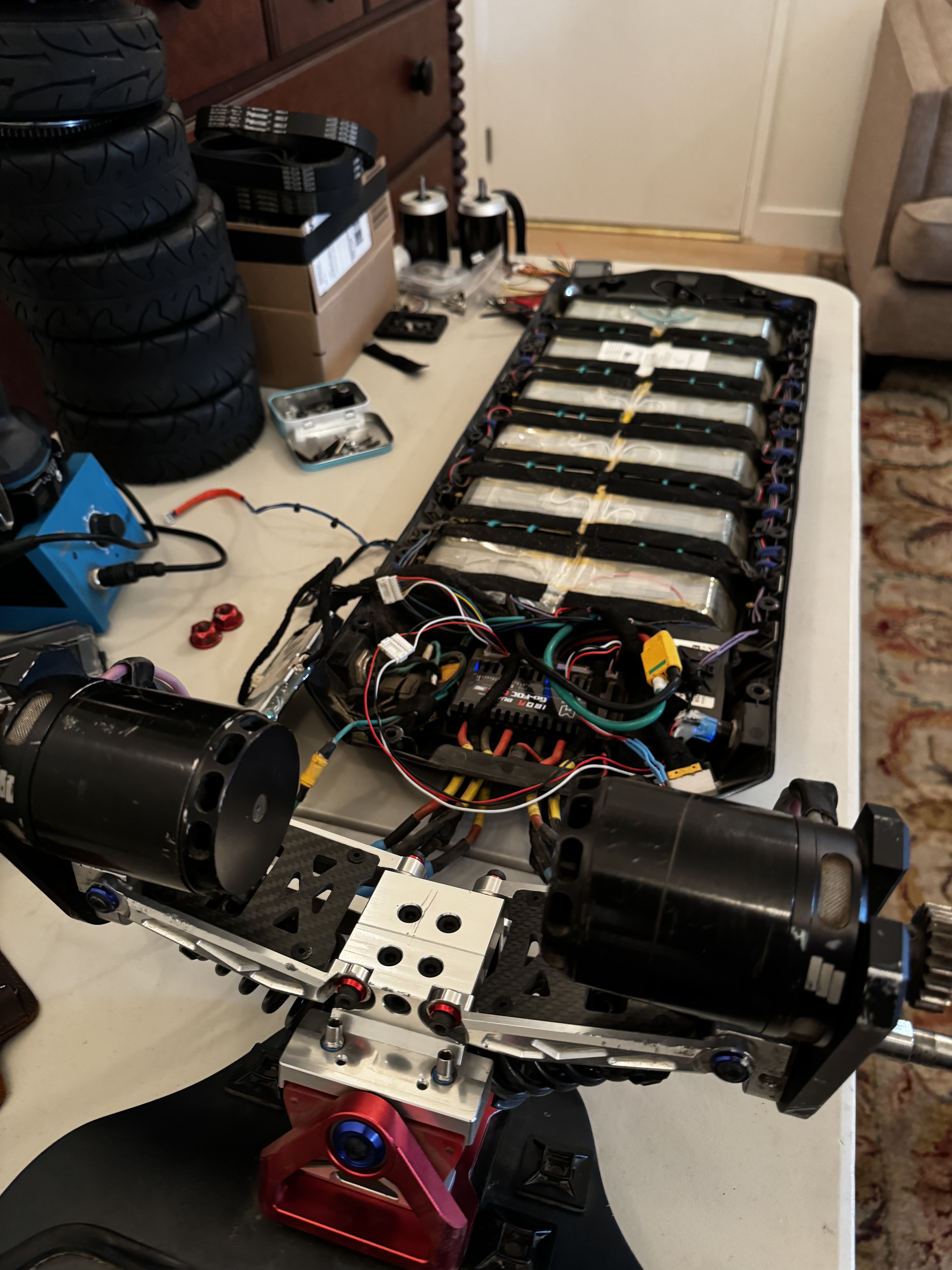

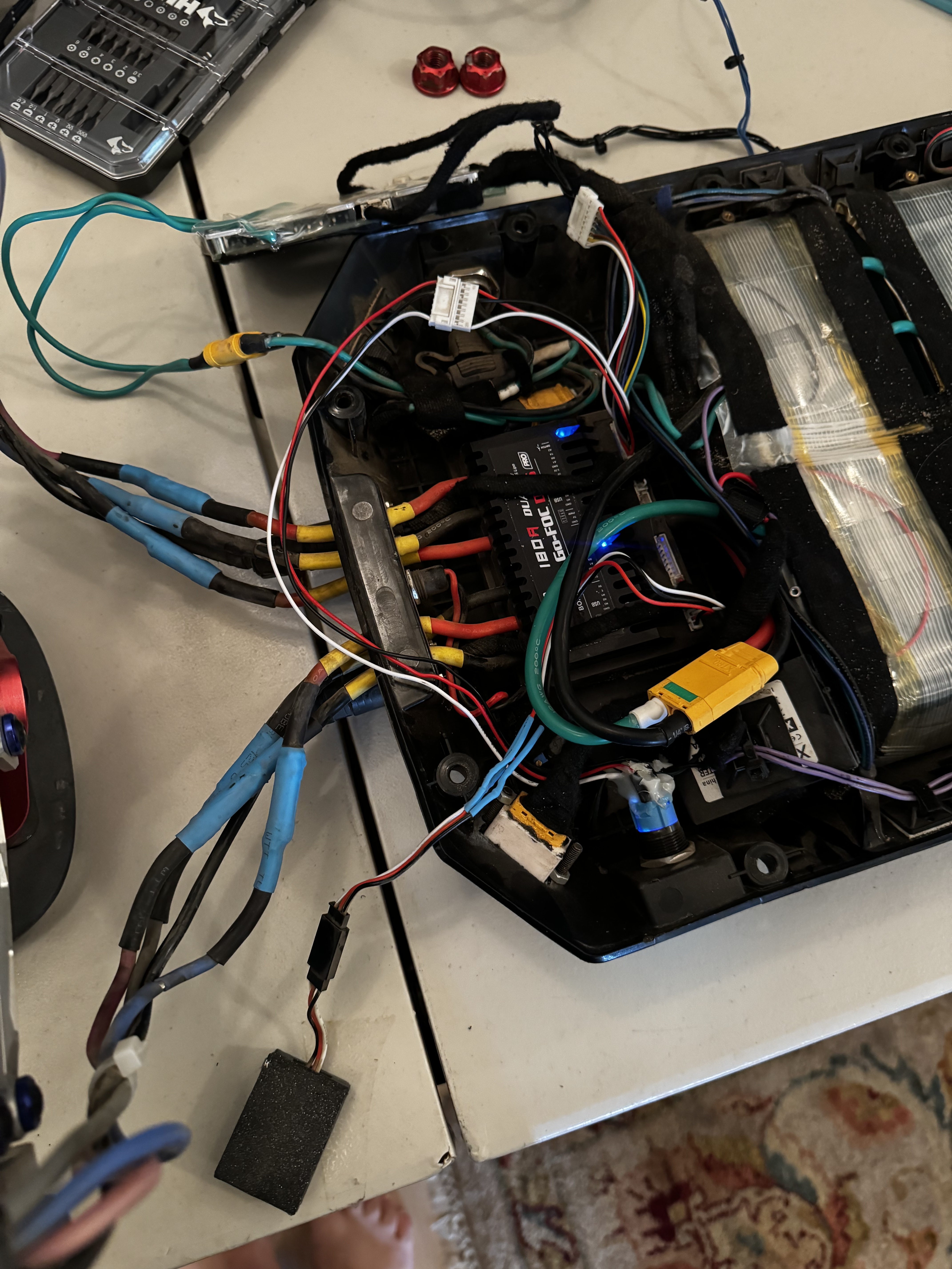

Hopefully going to acquire proper micro usb to program from my pc Vesc tool / transfer this Vesc + motors over to the metroboard pathfinder.
Give this deck a rest
Reconstruct this battery into a top mount box battery for another board
And prep this flux deck for some serious overhauling.
Exciting shit :zebra::zebra::zebra:

bit of a downgrade Removing the DV6 pro out of this thing to throw Xenith back in,
Reason Being is im going to be running the 190kv zoobomb motors in it as reachers that were on this board the went to the pathfinder build.
which seemingly are only 90 phase Amps Max?
Im going to test my luck w them at 120A phase max per.
Pshhh motor amps are just a suggestion. Temperature is the real tell.
@Venom121212 right I suppose I need to change my gearing as this board will be for under 30mph cruising / mild off road climbing.
to give it a bit more mechanical muscle.
It’s 78t / 20t rn
