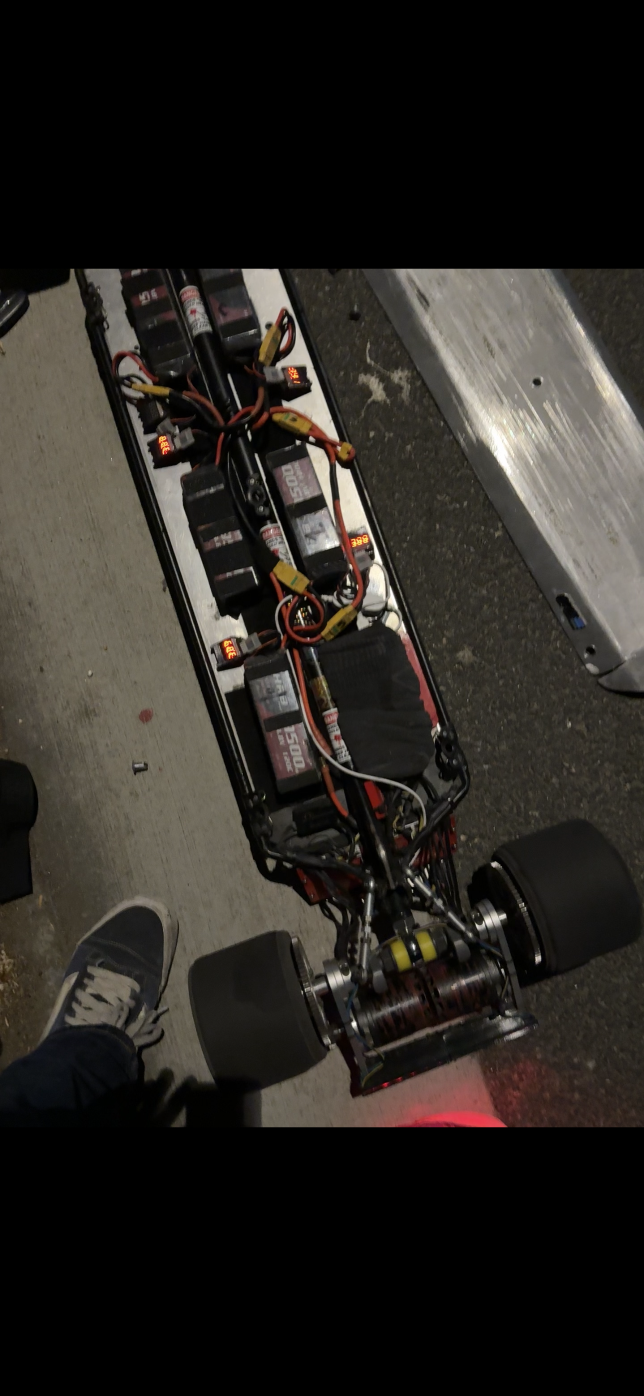

![4BFE0105-4C81-4176-BBD5-6235DA515D48|281x500]
This was while waiting for sawyer to show up, I was sort of in awe that I even made it this far.
