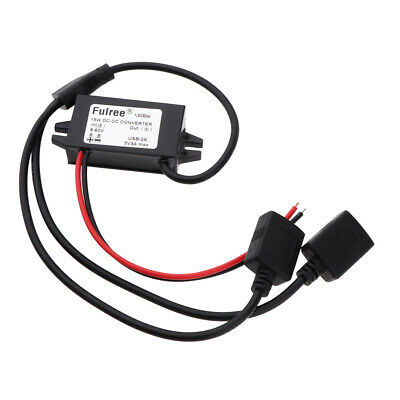

Adding USB port?
Ok that’s cool, I’m going to get a buck converter
Gotta admit that’s pretty smart
Wait how do I connect the battery? Add some wires onto the main battery wires?
I think something like this is what you want
You would ideally want to make a connection through the bms
1 on terminal of battery/1 on bms
Or
Both on bms (some have the discharge terminal being used)
And add a fuse to the wire, you wouldn’t want the battery to randomly send a jolt into your remote or phone battery.
The one @ducktaperules mentions is great for your needs. No tweaking, no different components to add to each other, just add a fuse, solder to power, and place in a convenient location
Hmmm ok. I’ll look at that one. Where do those wires go? Directly on the power wires?
That’s cool. However, they don’t ship to United States, and isn’t 3A a lot?
It’s a rating. Means you can pull 3a without it blowing up
This is a single usb output but same principle

Ok that’s cool although it’ll take at least a month to deliver
I’ll try and find one hold on
Also I’m not making my battery. I mean I could ask my builder to add wires but I don’t want to complicate anything
If your builder can’t add 2 wires, start doubting his skills :wink::joy:
Haha I haven’t asked yet, I’ll ask and let you know
Anyone has some pictures of housing the female usb port to the enclosure?
I would just epoxy it in there. I have no photos though. Not of USB ports anyway…
