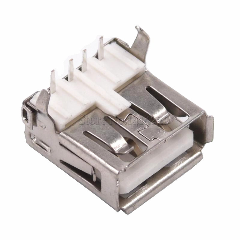

you mean something like this?
Yeah like that just not from ali
Yeah I understand that. If it’s not an insane hassle I wouldn’t be thinking about it… unless it is and I just don’t know
amazon also have them, but they all comes from china anyway
https://www.amazon.com/Degree-Standard-Female-Solder-Connector/dp/B07T82FB1M/ref=sr_1_8?dchild=1&keywords=pcb+usb+type+a&qid=1594783413&sr=8-8
Ok thanks. Free 2 day shipping on Amazon compared to 45 dollars for 2 weeks on ali

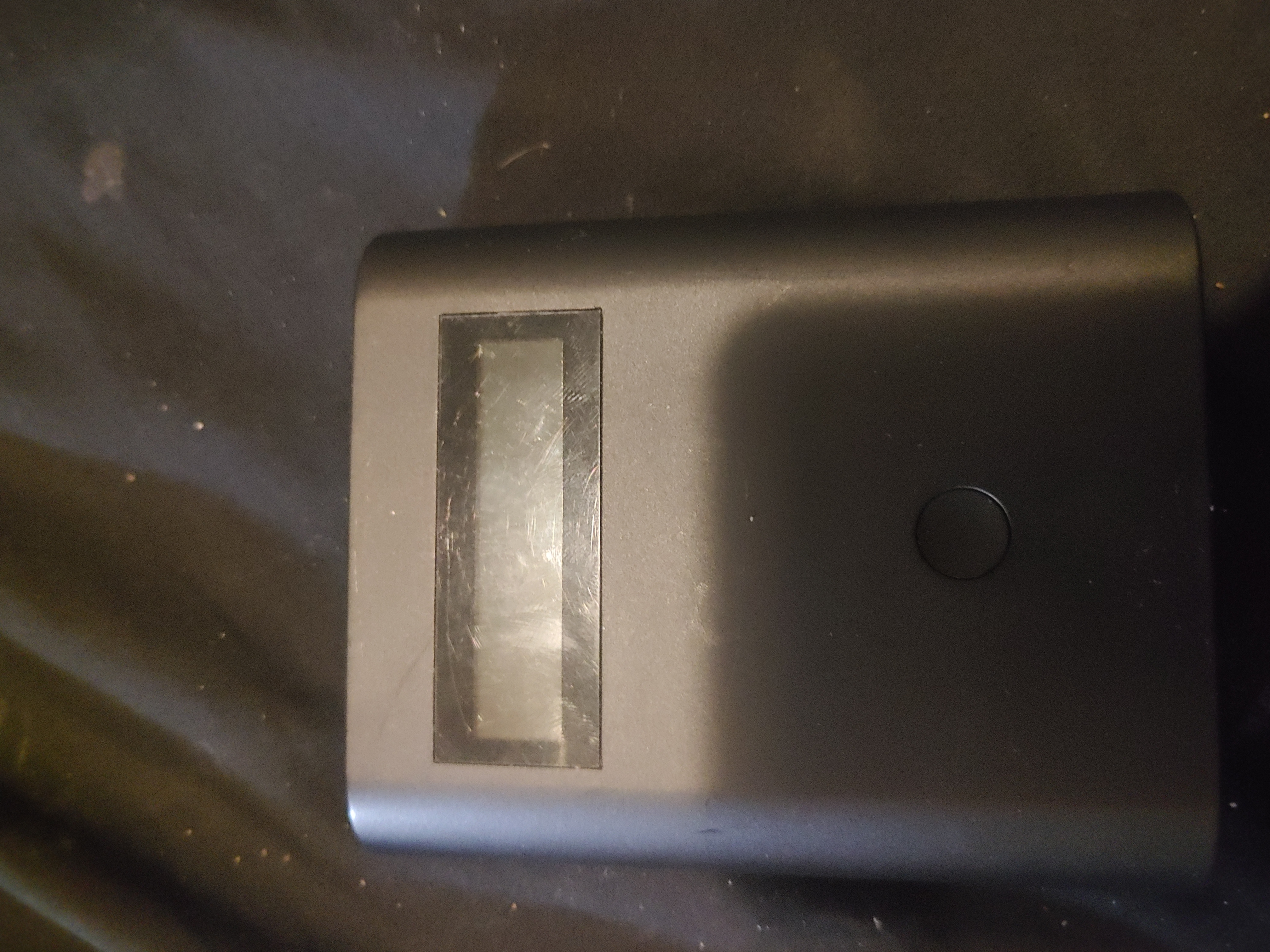

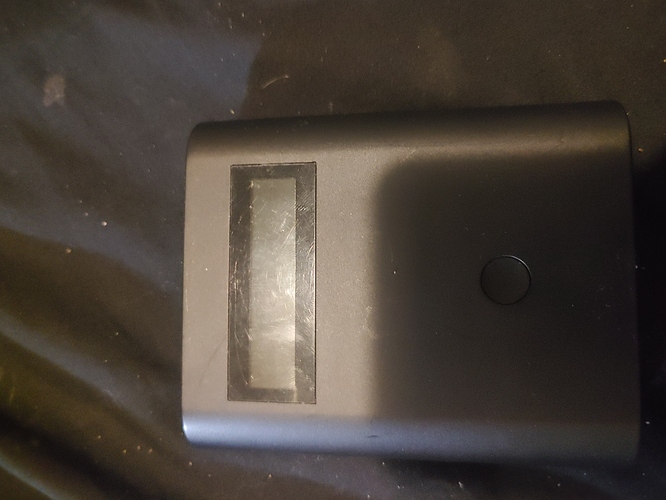

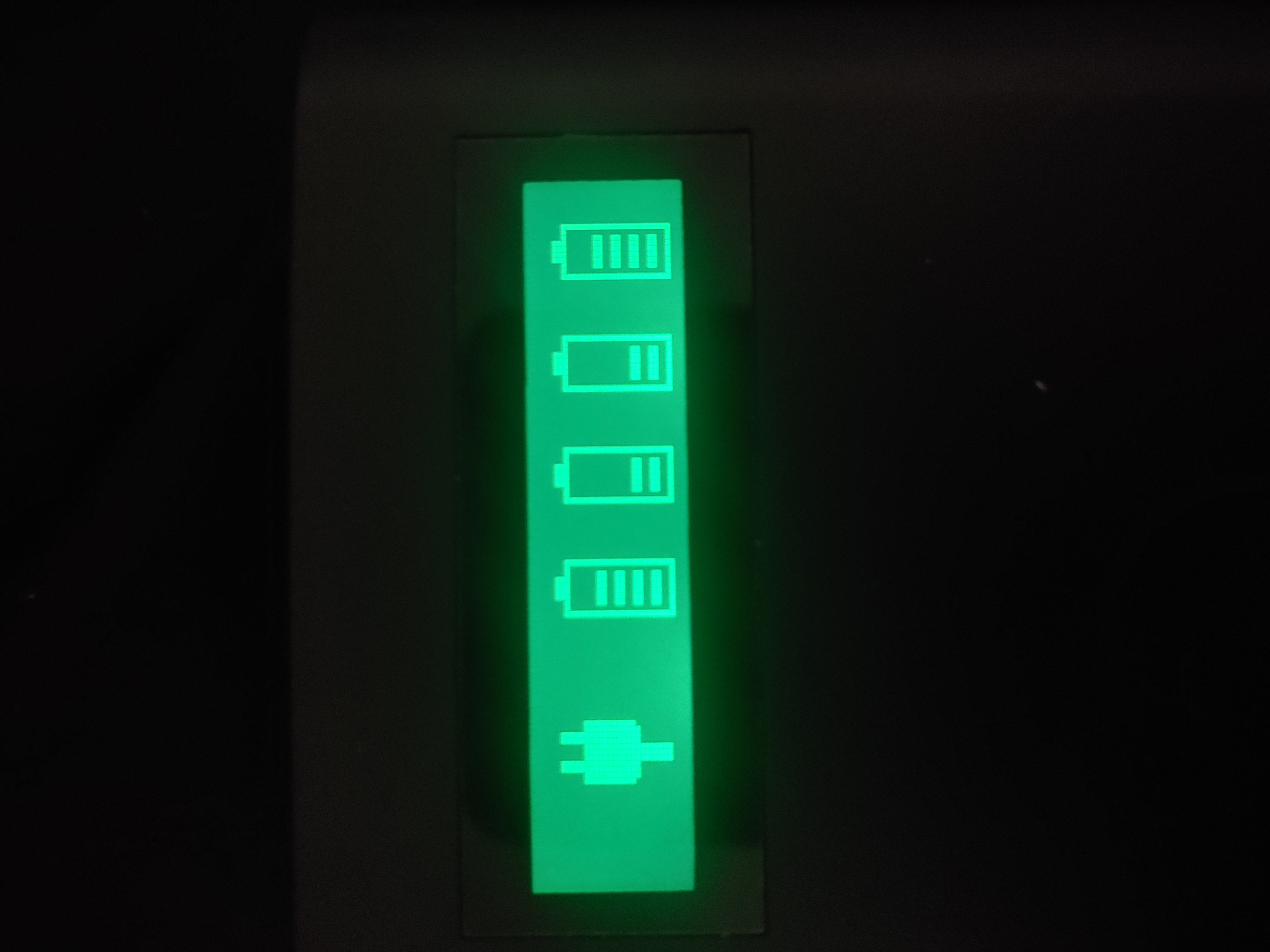

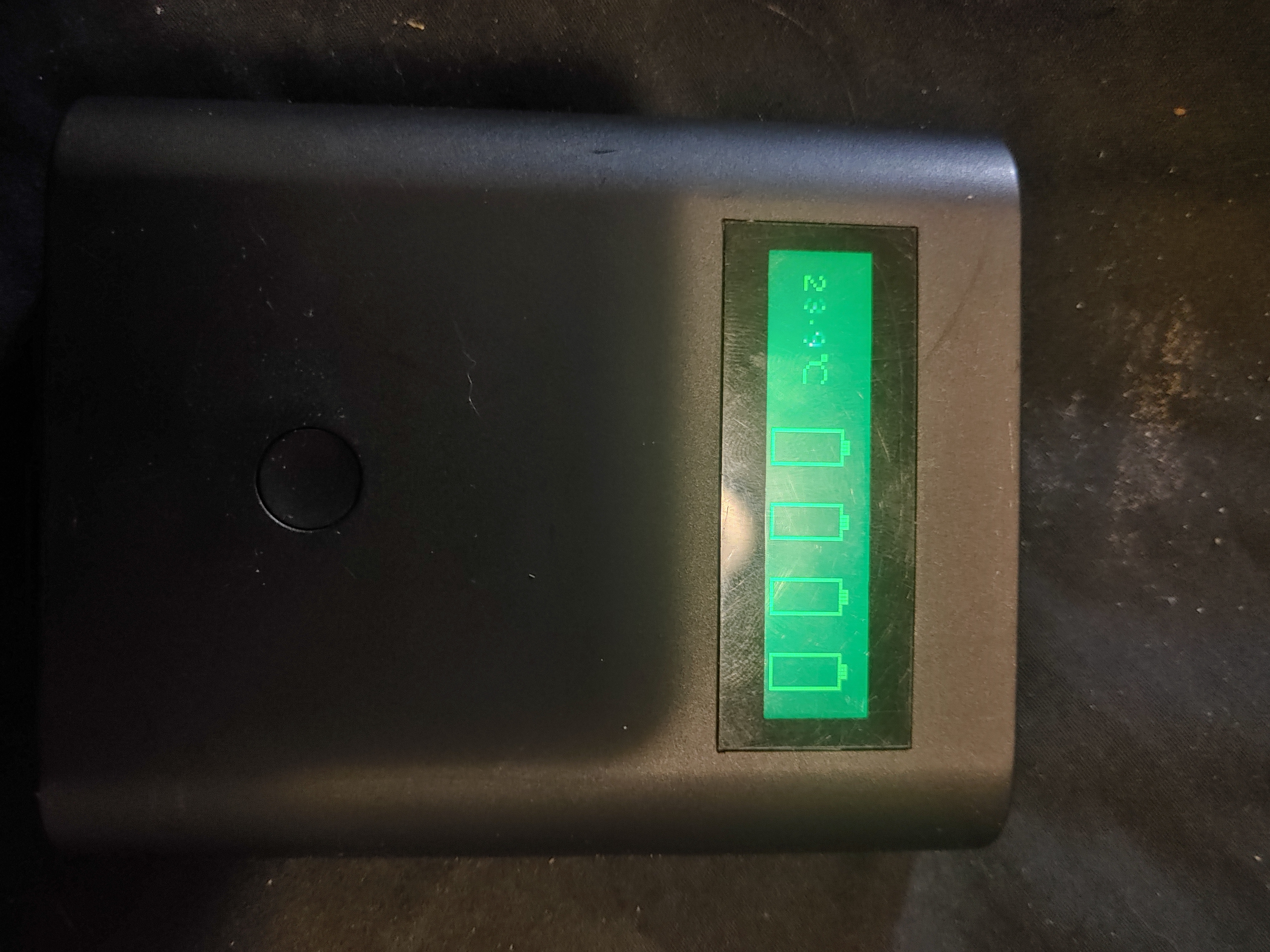

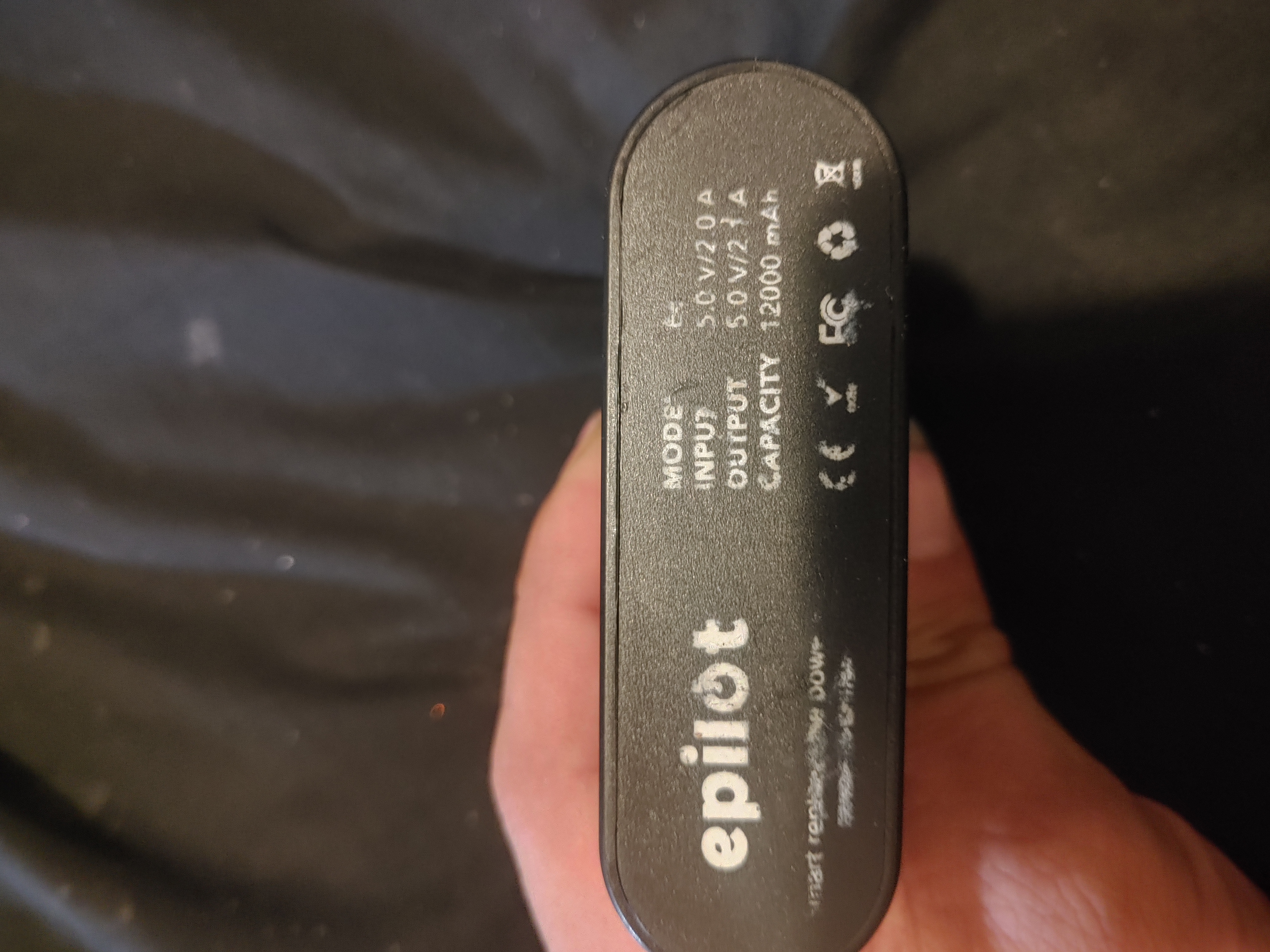

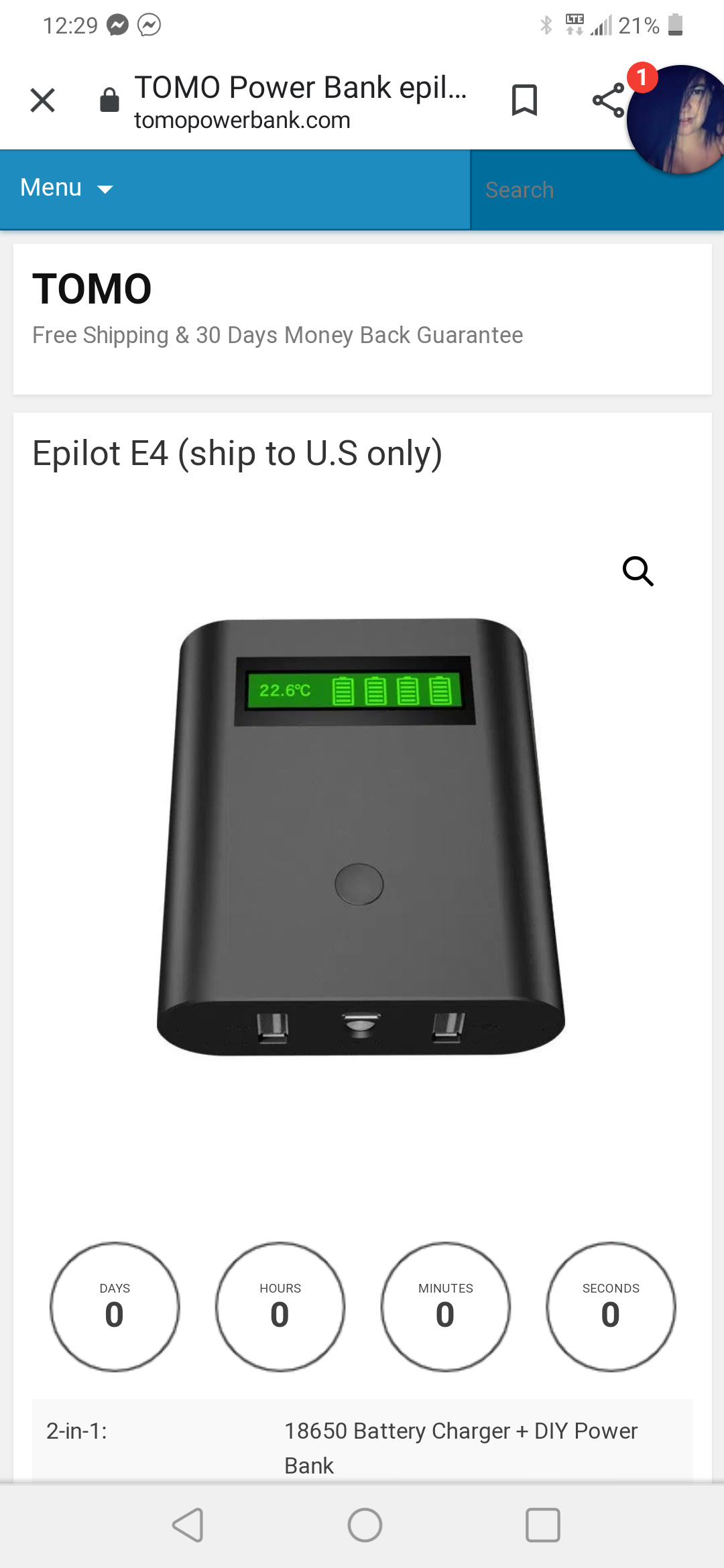

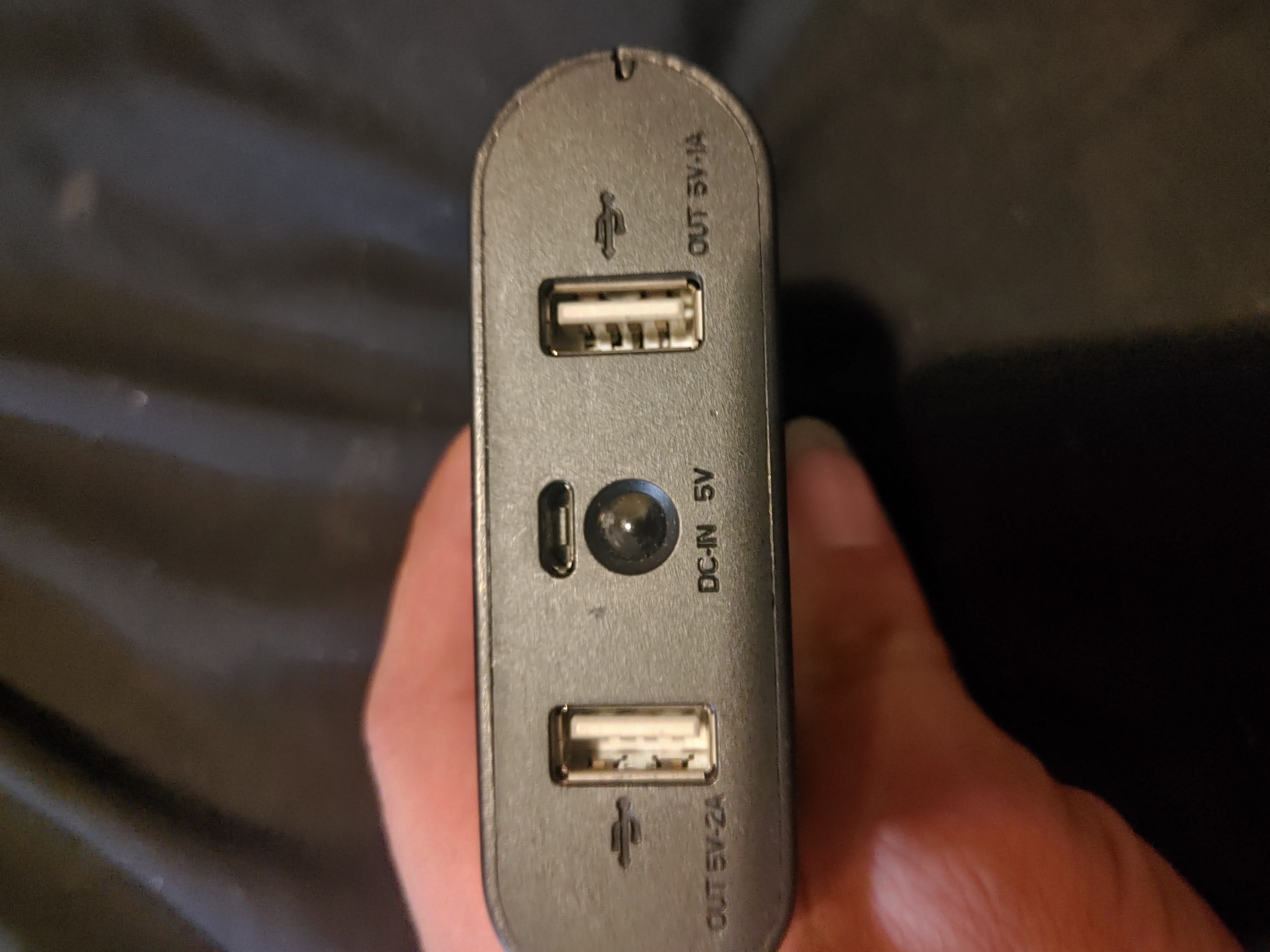

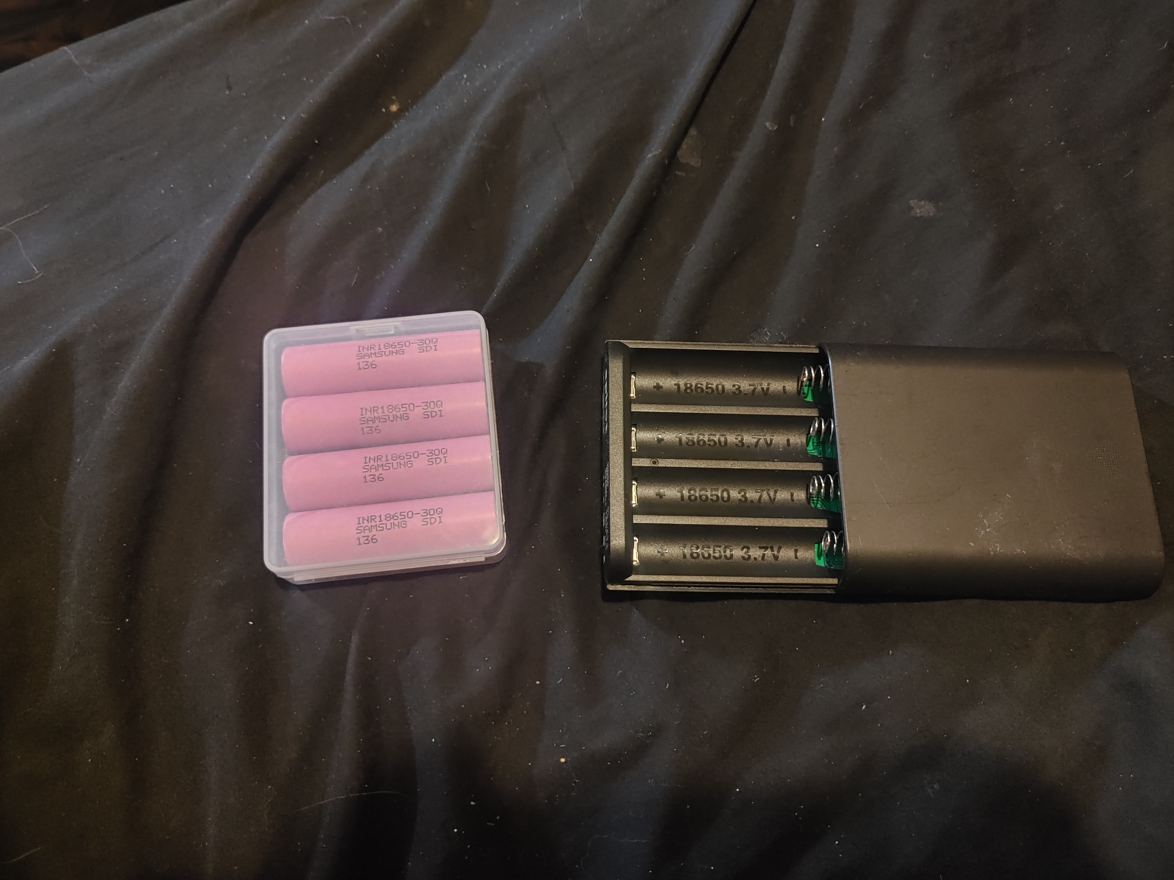

Just get a powerbank. I have a modular powerbank that allows me to put any 18650 I want in it (it also doubles as a 18650 charger for all my spares). So I carry it and a 8x battery case.
Oh shit that’s cool. Lemme look one up
It’s a pretty nifty gadget to have.
Takes 1 to 4 cells and uses/charges them individually so never need to have them all in perfect balance

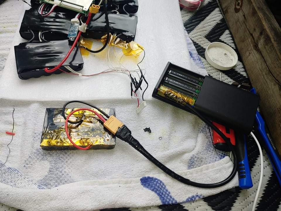

@maxmayer I’ve also used it recently to bring a entire pgroup back to life :joy:

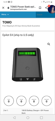

This might be a good fit for you.
https://www.amazon.com/gp/aw/d/B01N0JV0WV/ref=ox_sc_act_image_3?smid=A1CAGO66D4VW1F&psc=1

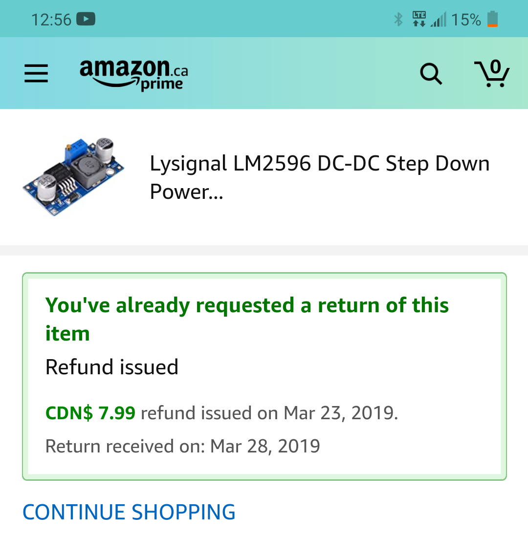

@Lunartic I’ve used these in my build. Anything over 24 volts will fry them.
It says they are rated up to 53v… That’s annoying! Are you sure it wasnt trying to pull more than 3 amps?

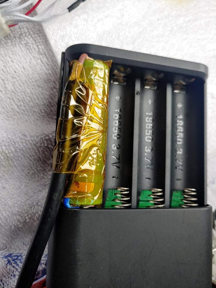

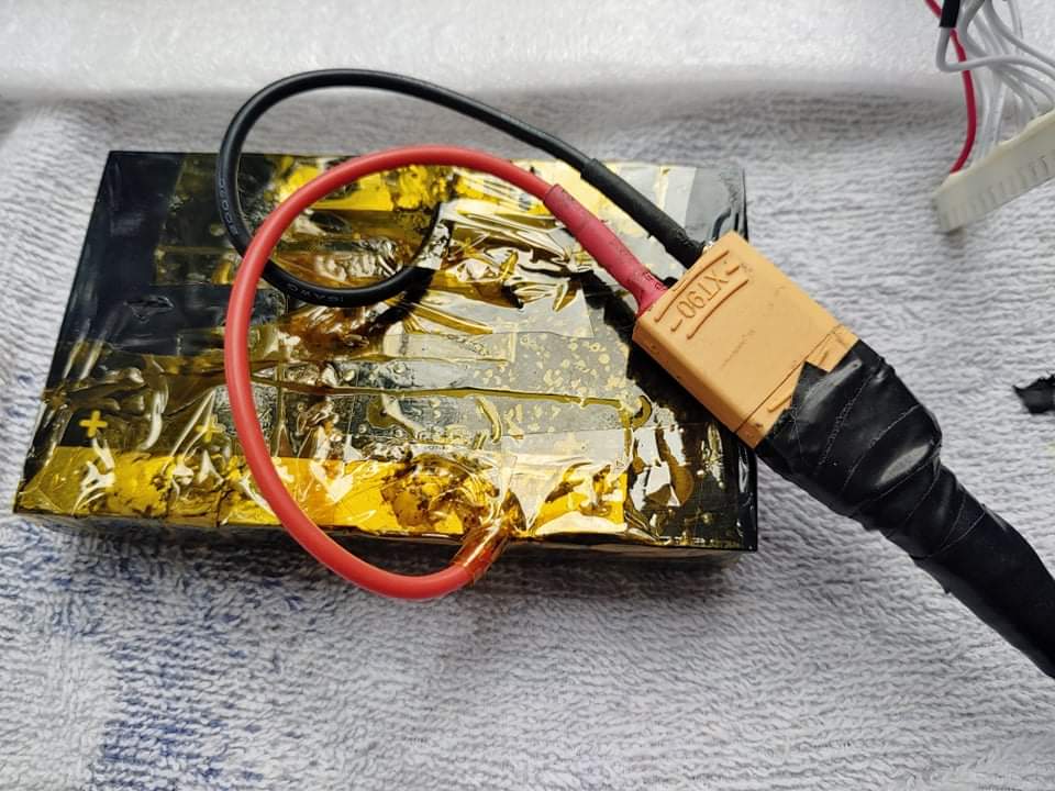

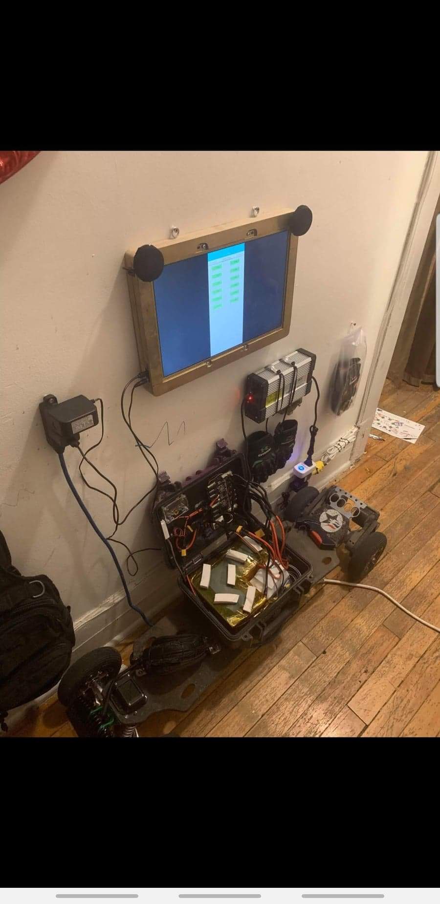

Well as Brian states, I bought the lower one. But no, I connected it to a 6s and it went poof. Had 5 of them and decided to try 3 times before contacting Amazon for answers. They requested I send back the blown units (seller wanted to “investigate”) and refunded me.

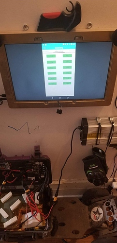

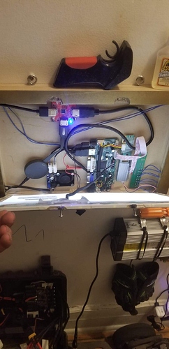

Was gonna use em for my diy television. Wanted to make it portable for my daughter in the car.
is that an alien remote?
any +/- comments I likes the form factor
@kook yes that’s my soon to be retired aps remote
