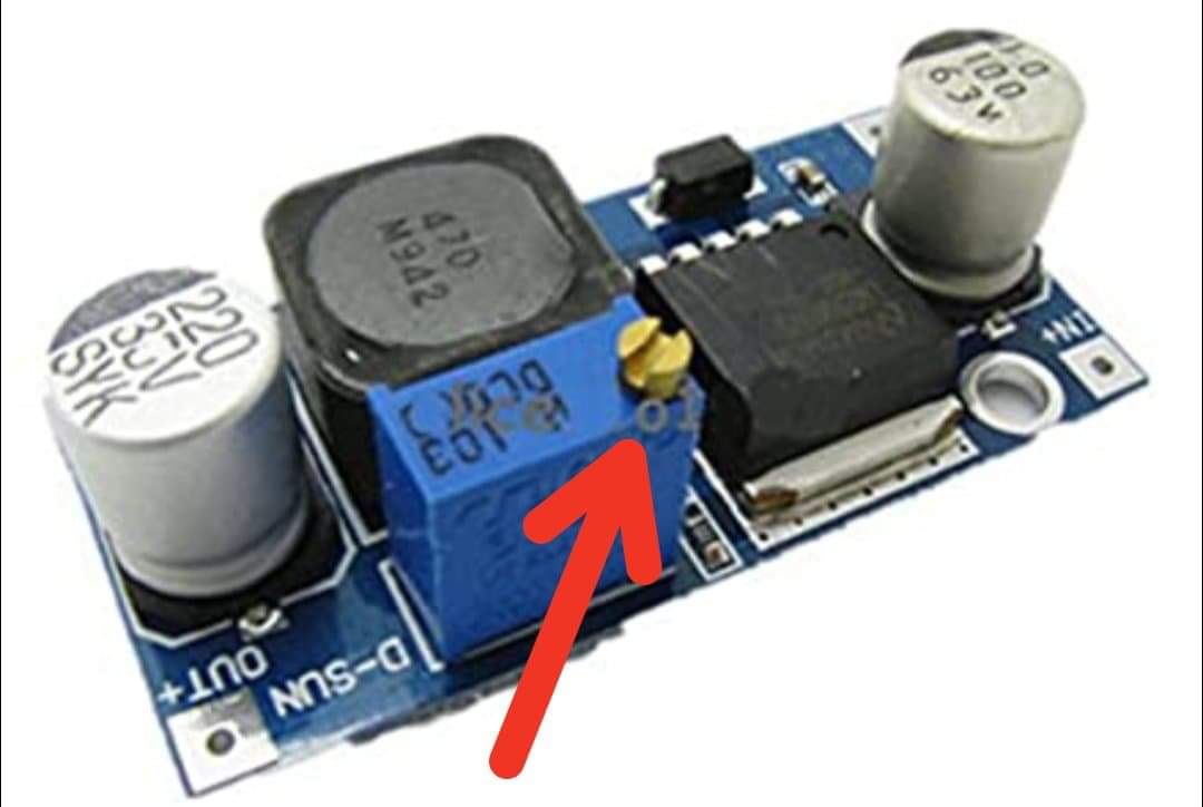

Can it take the voltage? I’m using 10s
Says they are rated up to 53v which is good on boards up to 12s though @Flasher mentioned he had issues with a similar model on only 6s. Note these converters are only rates for 20w total. Sounds like for $10 it’s worth a shot though you can always just pickup a power bank like this and isolate any potential issues.
https://www.amazon.com/gp/aw/d/B075SW3THG?psc=1&ref=ppx_pop_mob_b_asin_title
You have to be very careful with the LM2596HVS because there are many fakes that as I have found literally blow up over 40v. Here is one that is known to work up to 60v:
https://www.amazon.com/dp/B00W8UTRJA/ref=cm_sw_r_oth_api_i_yyXdFbW6PEHEE
Also don’t forget to fuse the USB port as I found when the LM2596HVS does die it completely shorts out.

I would say get a breakout board like this
10Pcs USB 2.0 Breakout Board, MELIFE USB to DIP Adapter 2.54mm Breakout Board 4 Pins Pinboard USB Type A Breakout Board https://www.amazon.com/dp/B07W7XMV3W/ref=cm_sw_r_cp_api_i_r4XdFbW8K1HH7
And connect the OUT+ of the buck converter to the VBUS, and the OUT- of the buck converter to the GND. Just make sure before you do any of that the buck converters output is set to 5v with the pot.
What’s the pot?
Potentiometer
You connect a multimeter to the output and turn the screw very slowly to control what voltage you want.
I emphasize on the “very slowly” as I somehow always forget which way to turn and end up with a screw that no longer changes the voltage for cause of turning too much in one direction
Ohhhhhhh ok thank you. And on the other method, can I connect it to the 5v pin instead?
You could but you would be putting in danger the reliability of your system. If your esc goes poof while stopping for traffic, you’ll be wishing you knew how to fly
