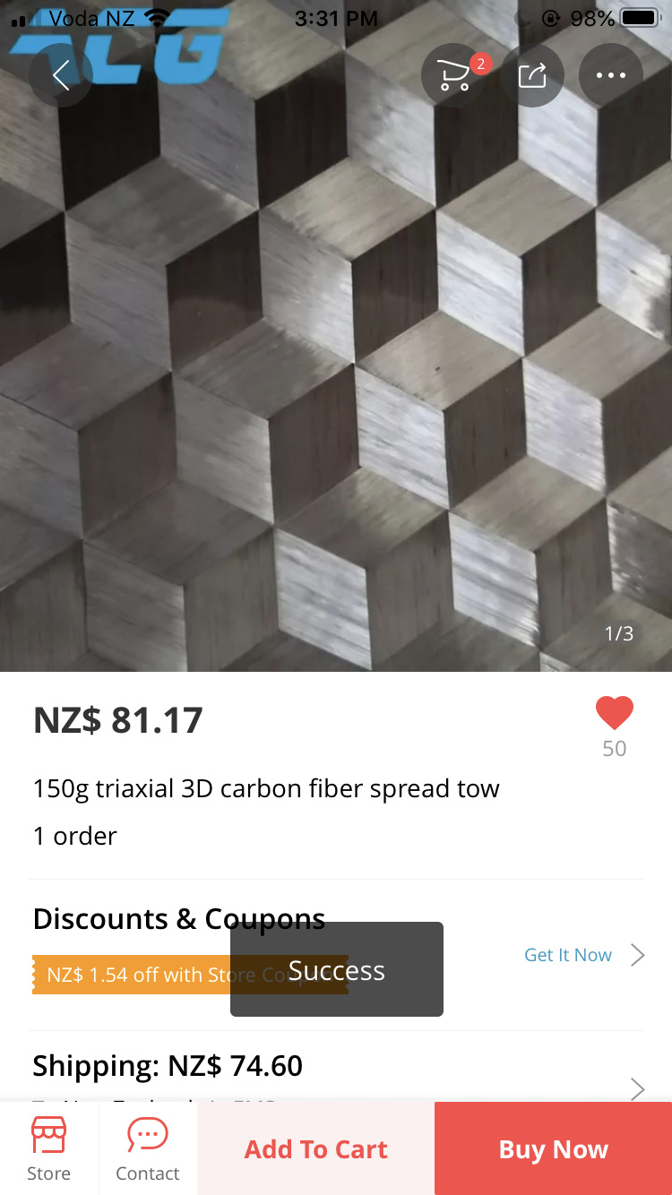

Not so cheap (but looks pretty)
NZ$ 81.17 | 150g triaxial 3D carbon fiber spread tow
https://a.aliexpress.com/2IhBrQSk
Thanks man! I like the triangular weave… but it’s crazy expensive (53$) compared to the normal weave… (12$) I’ll look into others as well. That’s not that bad actually, I could get away with spending under 50$ US for the whole process… not that bad… thx :+1:
Yeah that triaxial shit is dope. It’s exactly what I need to reinforce the wings on my Madness build but I can’t find it anywhere but the US. So expensive product plus extortionate shipping fees tells me no.
Lucky for me, your boi is in the US… but still… all I’m really using it for is wow factor… and atleast in my mind… and my wallets best interest… spending 80$ on carbon fiber isn’t too smart… so I’ll stick with the cheap, basic stuff
