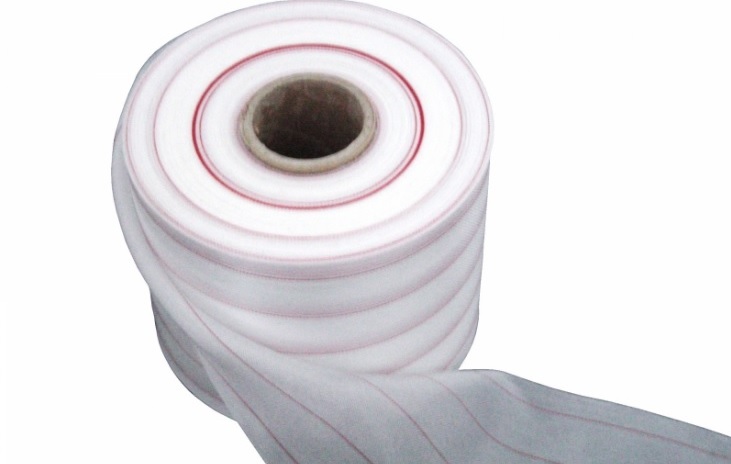

Can leave it raw - peel ply texture on the resin surface from my Hummie deck. .
Interesting. How do you achieve that?
Do you apply a top coat of epoxy after?
A peel ply is used when vacuum bagging the layup, it leaves a fine weave texture on the epoxy surface.
@Tamatoa you can apply an additional layer of epoxy on top to smooth it out, the peel ply texture provides a good key for the next layer of epoxy. I’d still give it a quick sand tho.
The fucking brand of epoxy I used for the carbon skinning has been out of stock since a couple of months before the coronavirus shit. I am seriously considering passing on the top coat of the road side. It’s just that right now it is not smooth, I can see and feel the weaves of the CF.
I didn’t, because as @glyphiks said I vac bagged this, so used this layer beween my layup and some polyester bleeder fabric which is there to soak up excess resin.
You could use this without a vac bag setup though, laying over the wetted out glass and pressing down onto the layup with a roller. Resin soaks through the cloth but the cloth has a release coating so when it goes off you can just pull it off the part. You end up with texture but there are other benefits for smoothness etc. on the part.
