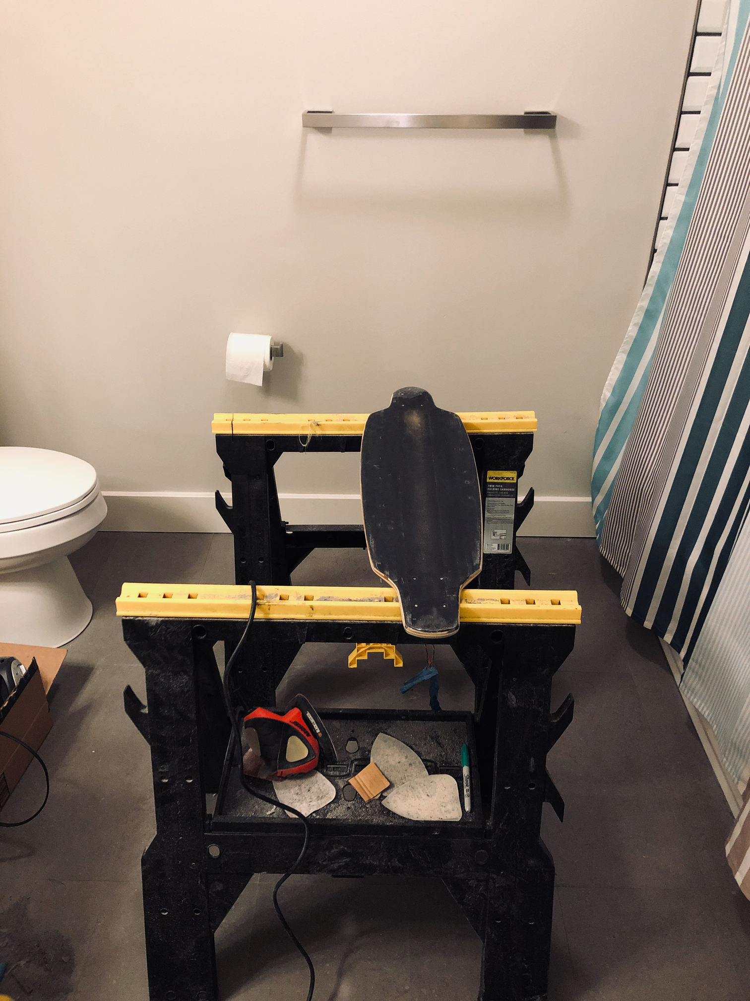

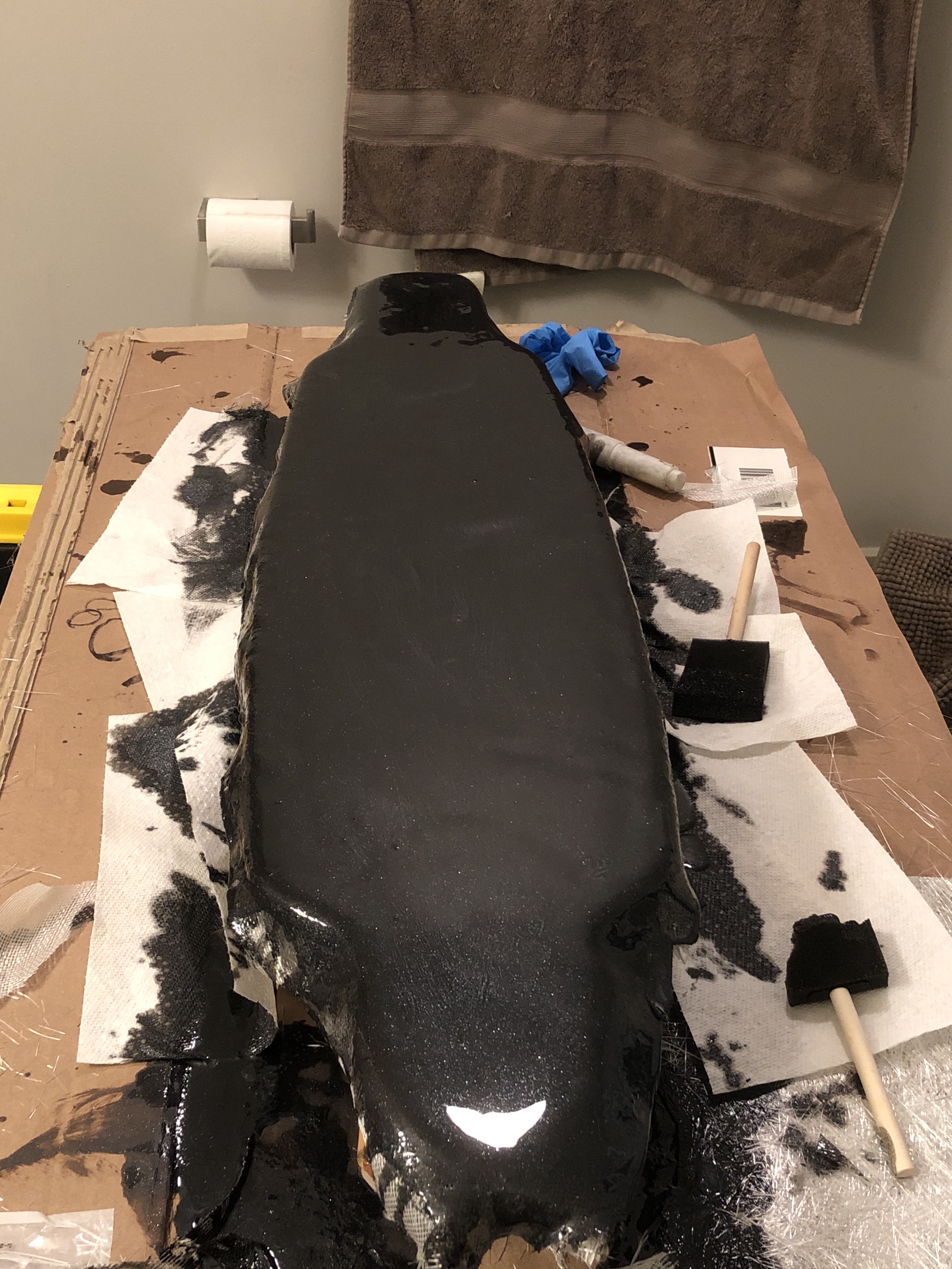

I did a hand layup of about 5 total layers (2 top 3 bottom) on this deck after routing wires. The last pic is a top coat, but you want to squeege as much resining off as possible on prior costs
It’s actually really easy to do
Carbon fiber has the potential to block signals and cause remote issues. Likely not an issue if the enclosure is FG or plastic.
And yes, I did this in my bathroom :rofl:
:upside_down_face: Favorite room where I make all my deck and enclosure :ok_hand:
Made a f-ing mess lol. But it works :slight_smile:
What did you do to draw excess epoxy out? Weight to press or a vacuum bag? Or was is just left to cure as is?
None. For the layups I laid out the cloth and wet it. Then used a silicone squeege to press out excess resin.
The pic is a final layer where it got two light coats of epoxy only. I was planning to sand it flat and polish out. There’s a sparkle black pigment in there. But for the sake of time, I rough sanded it up and vinyled the bottom and grip taped the top.
Bag method is much better. But it’s primarily just to reduce the amount of excess resin. Which keeps things lighter. If you have the time to do it, you should. But a hand lay up will save you about $150 if you don’t have any of the equipment yet for a vacuum bag

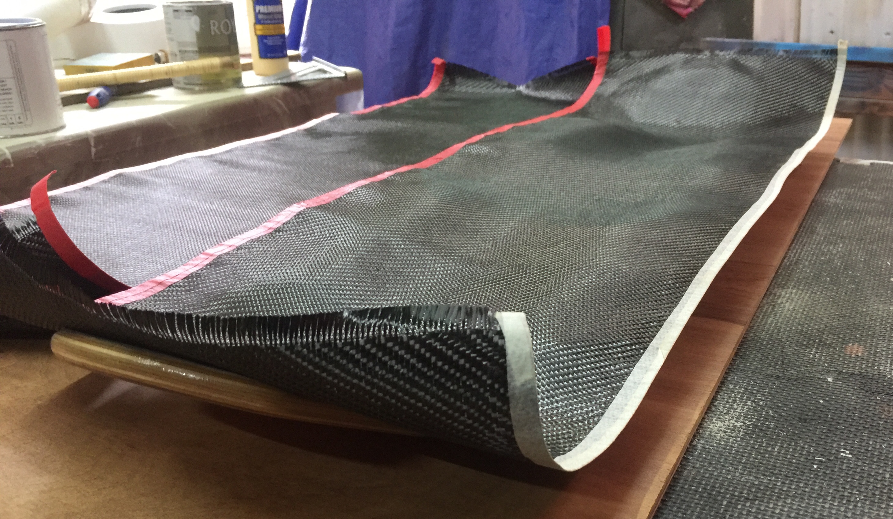

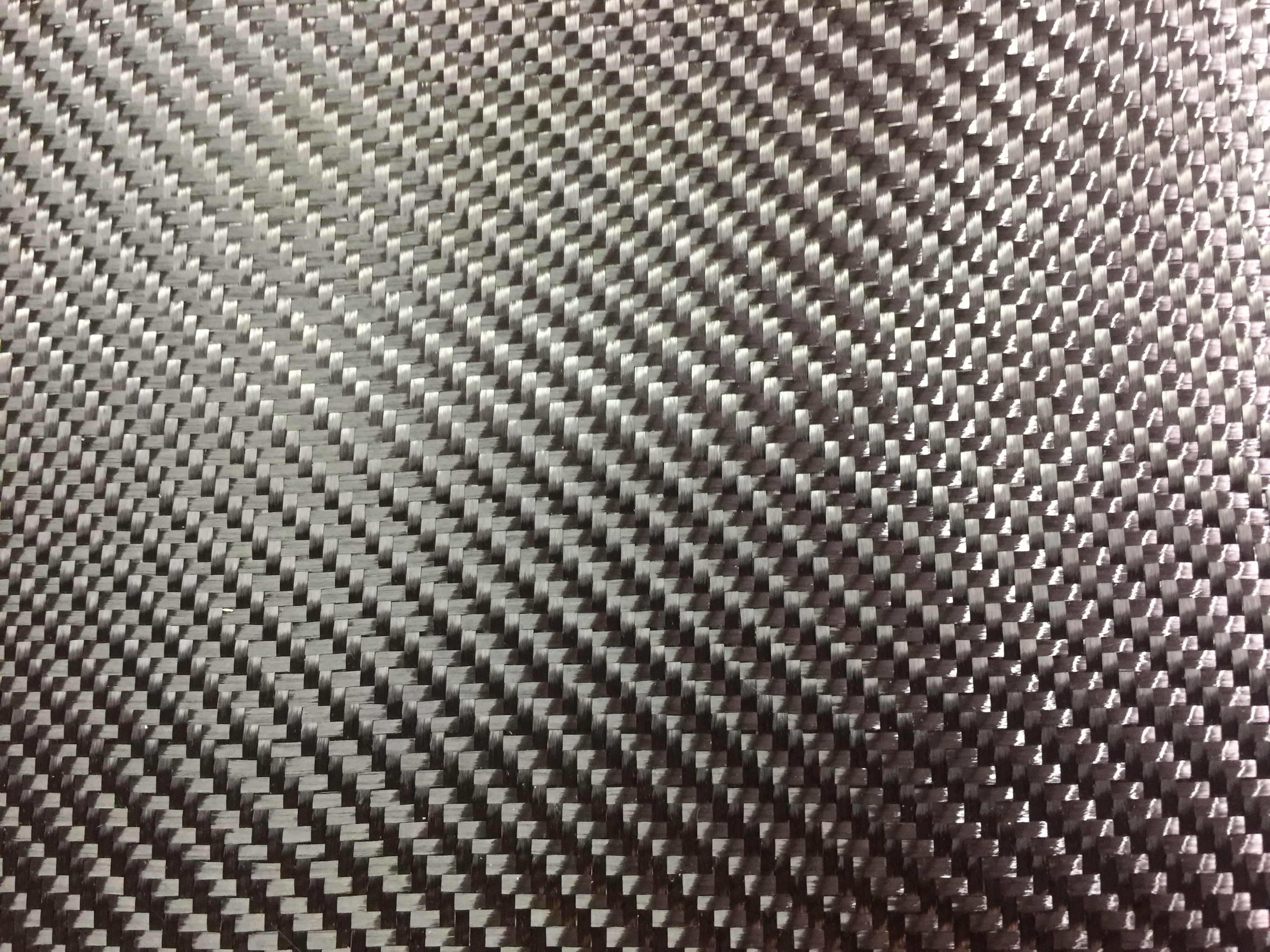

Bought the CF a long time ago because it was cheap but left it hanging in the shop :sweat_smile:
Yes I used some bitchin blue and green on my build and it looks crazy. Keep in mind it will pool up on dips and valleys on your deck. So on the drop of mine it’s way more colored than the straight plane areas.
Just mix up a couple diff colors and twirl them around on application. Make your tube channel already. And film this.
Maybe try and hit it with some air just be careful stuff is delicate as hell so it will RIP tear easy.
Tell me it is actually hanging ?
It was hanging, then I rolled that shit tight as a joint and slid it into a tube. Hopefully I haven’t messed up the weaves.
sounds like something id do, did you have it hanging just cuz you thought it would look cool? $20 says the saw dust on it adds to strength anyways
Nope mostly lazy ness, I saw an empty spot and threw it there, that’s how I organize my shop.
I hope the sawdust fuses well with the epoxy as well :smile:
Took a picture and there is a little bit of wood here and there but it looks clean tho. There is about an 1” extra length compare to the deck so I hope I won’t mess up.
pshhh looks fine
Perhaps you can still sprinkle some more sawdust on the fiber for added strength :rofl:
