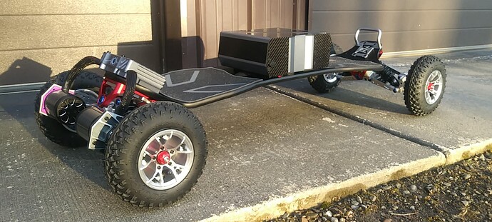

Board arrived today, looks really well made with great details.
Only had time for a quick test but immediately found a problem, I can barely get this thing to turn without bindings, it is stiff AF! I’ll swap out the red bushing in the rear with a white one like the front to see if that helps but I came across this interesting video comparing the carving abilities of the Horizon vs the Z3. The difference seem to be the size and shape of the plate that the bushings press against so that may be a future mod.
Swapping out the rear red bushing for the white made all the difference, carves nicely now. All the snow just melted of course but now we have mud so I was able to try that, the stock tires do not cut it in mud, probably not in snow either. Not so much the traction as the width, they dug down in the mud and left me high centered in the rear, probably need something wider like the MBS tires, (or tracks), for more flotation.
it depend your ride style, maybe is it great at low speed, but not great at top
I need maneuverability in the woods more than I need top speed stability. I’ll probably never go above 30 even on the road. Also I think the red is better for a heavier person.

So I was wondering if the stock Z3 hubs could take the wider MBS Explorer 200 x 70 tire if I made a spacer to make the rim wider?
I’m not sure if those tires fit on a normal 200mm bead or if they sit on the larger bead normally used by 9” tires
Website says: Hub Opening: 3.8" diameter (97mm)
What’s a normal 200mm bead?
Cant find the spec for the Acedeck tire but 200mm Mud Plugger says 3.75" wheel, I assume the 0.05" difference would be in spec?
take a caliper to mesure it , mine still on rim of the z3 right now but they look like regular mbs all terrain tire
Turns out my idea probably won’t work anyway because the spacer would move the inside of the tire too far in and would hit the gear drive.

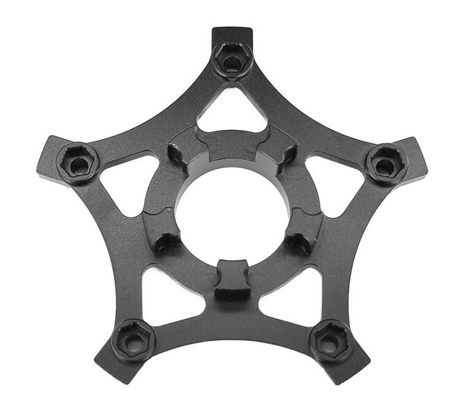

yes they have special patern for the wheel bolt but you can still use 17mm rachet socket like i still do with locktite because i don’t trust the tool

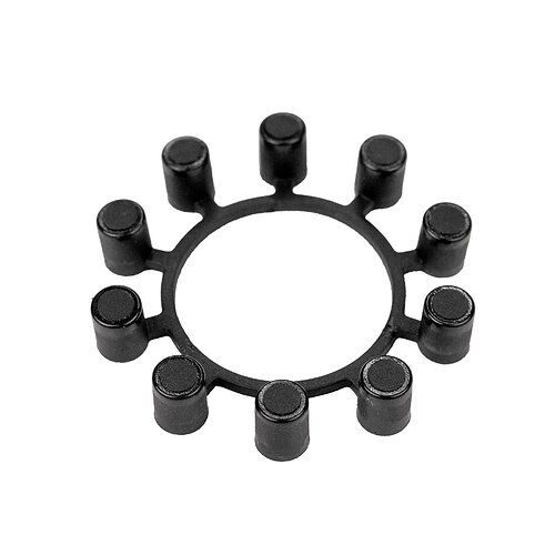

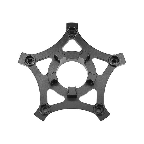

What’s the difference between the MBS drive adapters and the Z3? This looks very similar to the Z3 pattern, (the coupler cushion are both 10 segments), is the diameter of the coupler cushion different on the Z3?
