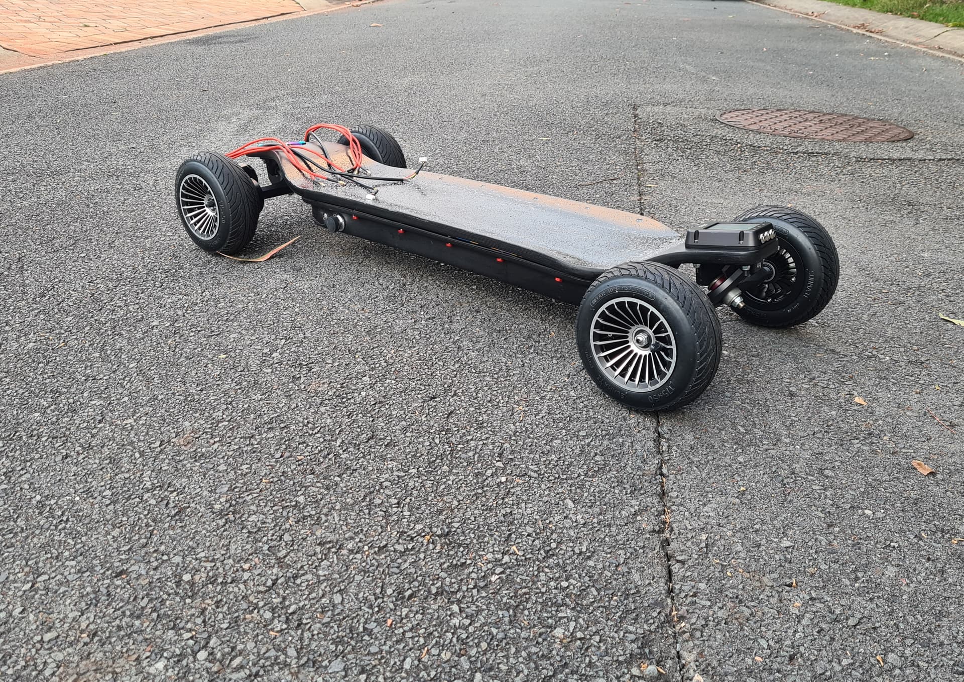

My first DiY I’ve named ‘The lost soul’.
Specifications are as follows.
Deck/enclosure: boundmotor octopus double stack. Formerly landyachtz evo.
Hangers: BN270.
Wheels: Newbee impaler. Switching between 6" and 7" tyres.
Remote: Hoyt Puck.
Battery: 13s8p li-on M50LT 21700.
Motor controller: makerX d75.
Motors: Radium Performance 6485 245kv.
Telemetry: Davega X.
Gearing: 16/65.
Bluetooth: flipsky vesc6 module.
Upgrades coming. Radium Performance 78t wheel pulleys, meepo cyclone 165mm racing tyres and fresh griptape.

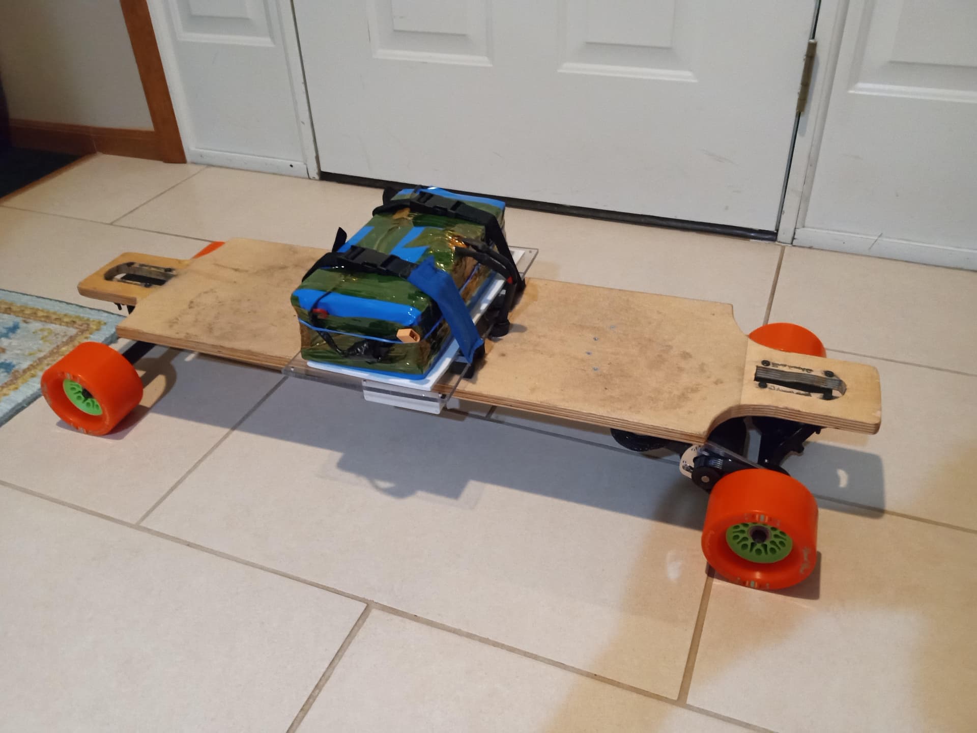

I call this the camel…
it has a top mounted 30 ah 12s battery made of samsung 5000mah cells in a 12s6p configuration. Its running 2x mboards 6368 190KV Motors and a dv4 makerx esc. remote is flipsky vx2. gearing is 16 motor and 36 wheel pulleys.
This thing goes!
I went 10 miles and could barely tell if the battery dropped. I calculate it has a range of 60 miles and a top speed of alittle over 40 mph.
