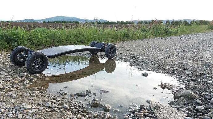

Or someone have the tyre can tel me the masur tyre .to be sure if they fit on trampa wheel pls
4in/100mm rim
All Evolve tires fit on Trampa Superstars or any 3.75" (96mm) hub.
7" Evolve :point_down:
4" (102mm) hubs are for 9" (and some 10") tires only
Thankyou Rich I wil order now
