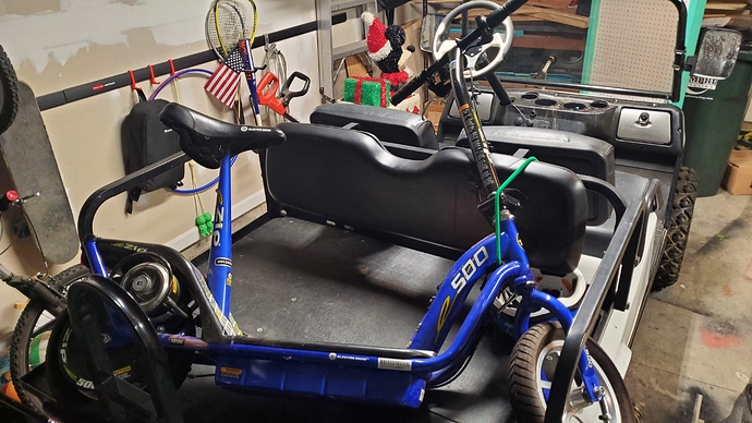

Check Craigslist etc for schwinn, currie, and gt scooters. 350s are nice to build on and have a huge metal built in tray. Some even have suspension built in to the front fork. Honestly the tires are big enough the suspensions not that helpful unless offroading.
Changing tires sucks dick though cause no split rim. Get it on an ebrake so you don’t have to deal with removing the brake band system to change a tire.
I found one of these for $275 on offerup, but I dont really think its worth that to me, especially if im going to do a full electronics swap. What do you think of that price? It was posted 3 months ago, so if they still have it I could probably talk them down to $200.
Absolute shit. That one above was on the curb for free and the other one I bought a few years back for $65. I wish you lived closer, I’d give you the frame. Maybe check some neighborhood Facebook for sale groups. Lots of parents cleaning out garages.
Fuck of course there is a perfect one near me for “$75”

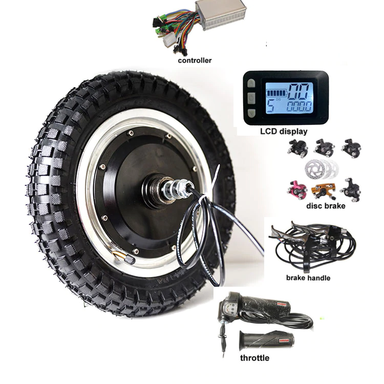

I’m doing this sometime next year. Scooter is here already, its for Simon, but it could scale to lady size.
scooter:
https://www.amazon.com/gp/product/B00E95KE1M/ref=ppx_yo_dt_b_asin_title_o01_s00?ie=UTF8&psc=1
ali express 12" hub motor kit with throttles and all that:
Thats pretty cool! I saw one of these large tire push scooters on facebook marketplace a bit ago, but it was adult sized and they wanted a lot for it. It would make a really cool scooter though haha.
