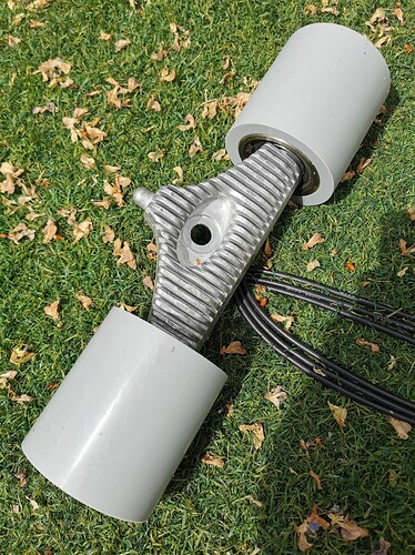

A Hummie Hubs & Deck build
So I participated in Hummie’s Kickstarter campaign in 2019.
At the time I also bought the ESC (Flipsky FSESC 6.6 dual mini), battery (eskating.eu 12S3P 15Ah Li-Ion with 80A BMS) and fiberglass enclosure from @BigBen.
I stored them until a few weeks ago when finally I received the parts.
Everything seems of excellent quality. I am very satisfied.

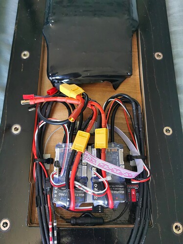

I started by drilling the holes to attach the enclosure to the deck. I used hot glue to poke the two together.
My Li-Ion pack is a little wider than the compartment dug in the deck, so I bought a router which I used here for the first time… I had to put some wood filler back in on one side…
I coated the inside of the enclosure with Shoe Goo.
Once the wiring was done, when the smart BMS was first switched on, an ESC capacitor exploded. The ESC still worked. I removed the capacitor, which wasn’t easy as it was cast in epoxy resin.
I ordered new ones from AliExpress, but I won’t receive them until August…
https://fr.aliexpress.com/item/4000746324994.html?spm=a2g0o.order_list.order_list_main.33.21ef5e5bt5OxhF&gatewayAdapt=glo2fra

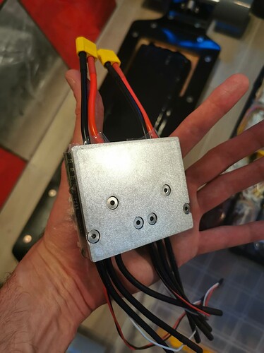

So I finally bought new Flipsky ESCs, two FSESC 6.7 mini Pro. I had already used two pairs on other builds without any particular concern. These are equipped with 100V capacitors instead of 63V for the FESC 6.6 dual mini.
I replaced the smart BMS switch with an XT60BE-F port, and added an XT90E-M on the circuit to avoid new problems.

I machined holes on an aluminum plate to attach the ESCs together.
I added a fuse to the charging port.

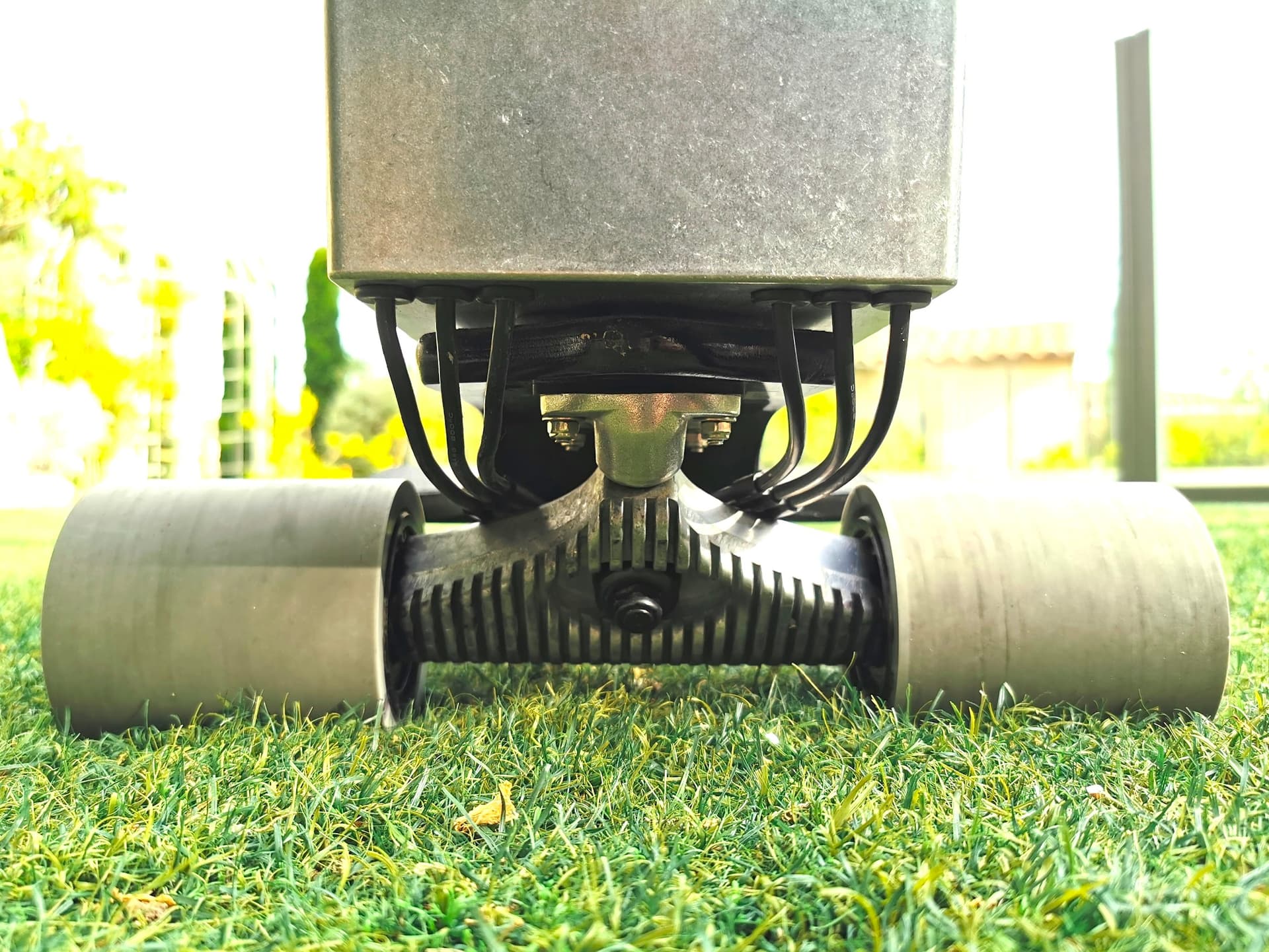

Here is the final rendering:
I updated the firmware to 6.02 following Flipsky’s recommendations (especially the disabling of phase filters), in particular to benefit from the new HFI.
I set each ESC’s Battery Max to 40A, Battery Min to -20A, Motor Max to around 35-40A and Motor Min to -35-40A. The Absolute Max must be increased to around 100A otherwise the HFI triggers ABS Over Current faults.
It starts without cogging, including when climbing.
As @Hummieee advised me, I use it as a front wheel drive.
It’s flawless. Free rolling downhill, while retaining the ability to brake, is what I like the most with hub motors.

FWD doesn’t feel odd comparing to RWD. It makes me feel safer when going on bumps. Turning also feels easier and more natural.

Motors were 65-70°C at the end of the ride. It was a hot day : 34°C.
This build weighs 12.2 kg with Li-ion 12S 15Ah. My lightest mountainboard is 13.5 kg with Lipo 12S 6Ah.

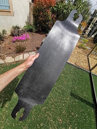

While dismantling the mess, I discovered this:
The coaxial cable was crushed between the carbon fiber plate (sandwiched between the ESC and the Lipos) and the interior of the aluminum box. The central conductor was therefore in contact with the braid.
However, I was not able to reproduce the malfunction once I arrived home. I tried to rub this damaged coaxial cable everywhere, but nothing happened.
Does anyone know if this can explain what happened?
