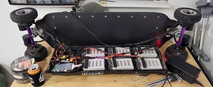

So I rode this thing for most of Carvepdx and it did great. Ran out of battery at one point and got towed. In the last day halfway through the ride it began locking up the right front wheel and then working properly when I applied throttle after zero input. Idk if the TB ESC’s flash lights for faults but all were blue as normal.
I will put my Bluetooth on that esc and see. Maybe need to redo detection.

Did motor detection and had insane numbers for one and wouldn’t pass. Checked it out and found loose phase wires. I re-shrininked them and thoroughly secured them with a type of tape. Definitely not electrical tape…
It detected properly that time but no flux linkage number was shown for the problematic one. and shakes like crazy with power applied. No faults still but my next step is to test the motor for shorts (undo my tape) or/ convert to 2wd until I replace a motor. Probably not the esc.
How mine was acting up once I cornered the issue. Are you on 5.3 or 5.2?
5.1
I forget that low charge can cause detection problems. Juicing it up right now. Here’s to hoping that helps with anything.
I’ve also been detecting with the belt on, perhaps I’ll try with it off as well.
Kinda want to rethink my enclosure spacer/gasket as well.
Charging to 4 volts per group did the trick and everything seems to be in line. all 4 wheels spin as they should! Looks like I’ve got a cool skateboard again.

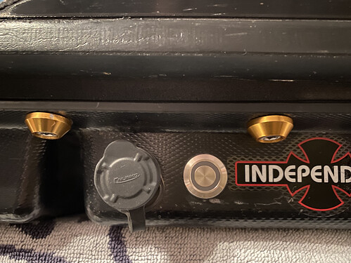

No need to rethink your enclosure-seal. I have a 12S9P (Samsung50E 21700) build on me Flux, so it was also a little bit too big for the enclosure. Bought a extra gasket from Flux (so 2 now on there) and this works great.
Also i read a lot about your enclosure bolts coming loose ; try riding 2,5cm bolts; they will NEVER come loose :+1: (but easily come out when wanting to work under the hood :wink:
:point_up_2: no need for those fancy caps btw …
I saw them on Monsterbuilder’s “Fuck-Cancer” build (in black) and my wallet started itching…
