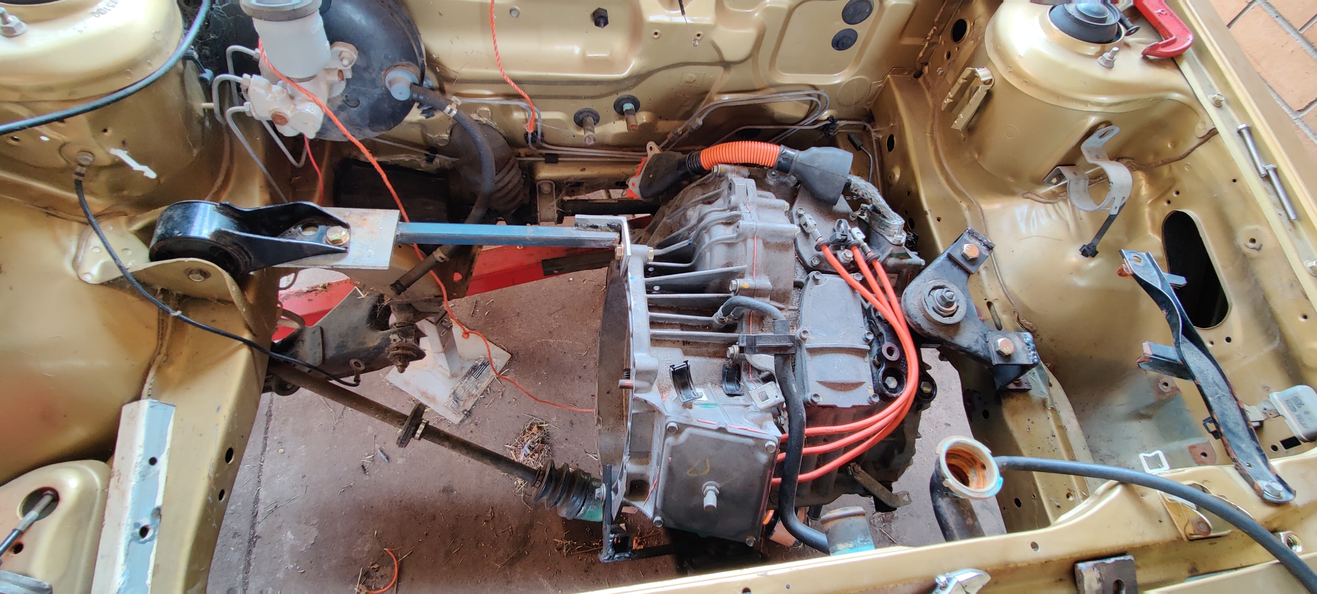

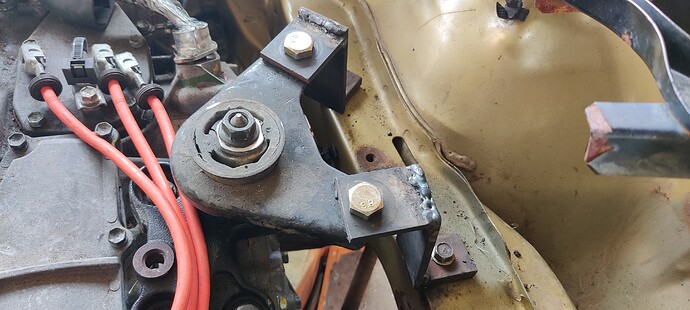

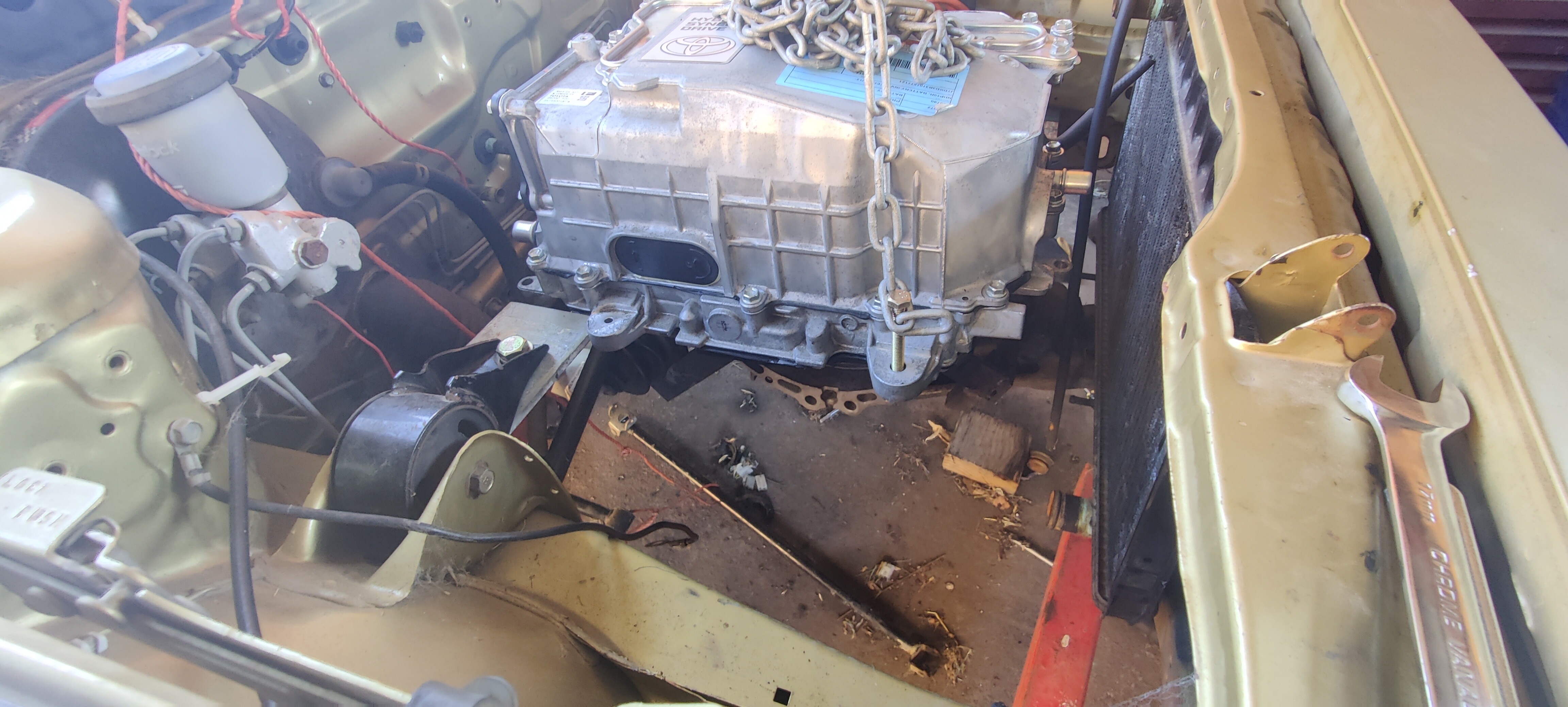

The transmission is now mounted using 3 points, completely self supported. The mounts are dodgy as hell, but as a proof of concept they work great.
This mount here is where the original engine was mounted to. Later on I will add more square tube that goes further along the face of the transmission.
This mount here is borrowed from some random car. I need to find what car this mount is from, as the rubber is old, but it does the job for now.
This one here at the back is not in use yet, still working on it. There is another mount at the front that is also bushing supported.
Next is to learn how to take the hubs off so I can take the CV shafts off so I can make my own

Going to the wreckers today to get a Prius CV shaft to cut and weld to the current shafts. I will get custom CV shafts made up on the final product once proof of concept stage has been achieved

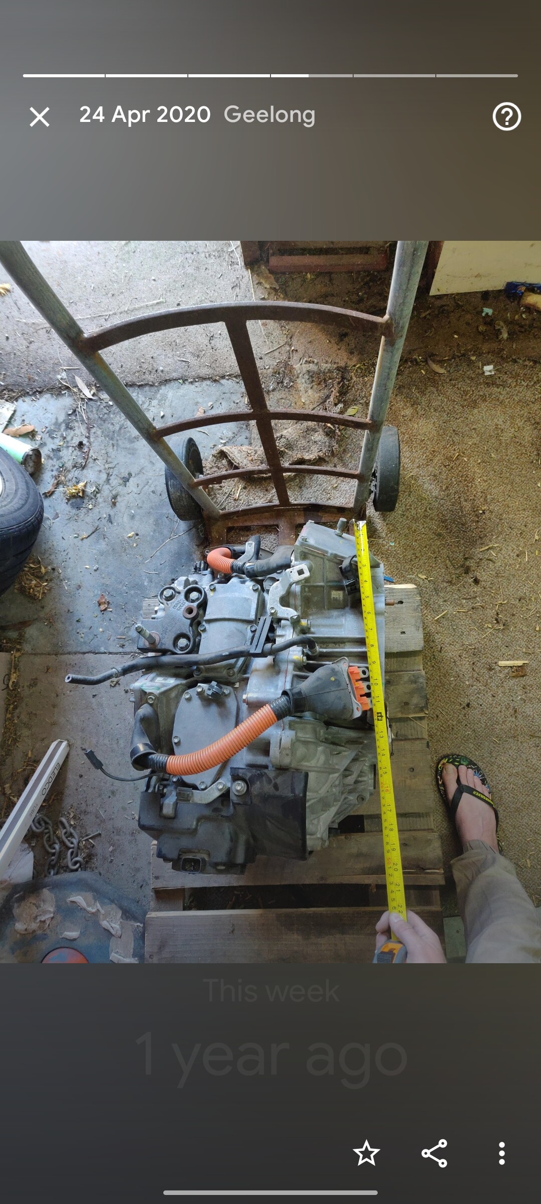

Phone decided to remind me how long I’ve been working on this.
Went to the wreckers to get my CV shaft but wasn’t successful. Didn’t have the right tool with me. I’ve bought the diff side CV boot on eBay to speed things up a bit, I can go back to the wreckers to get a half shaft.

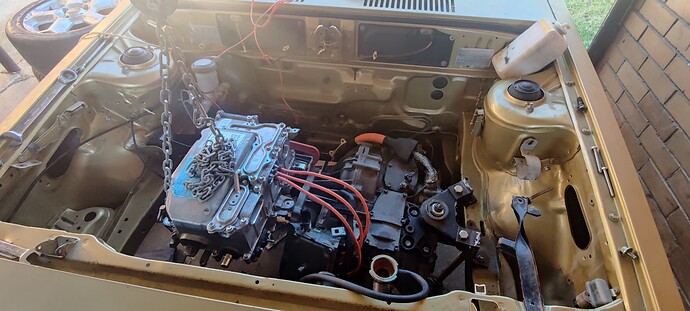

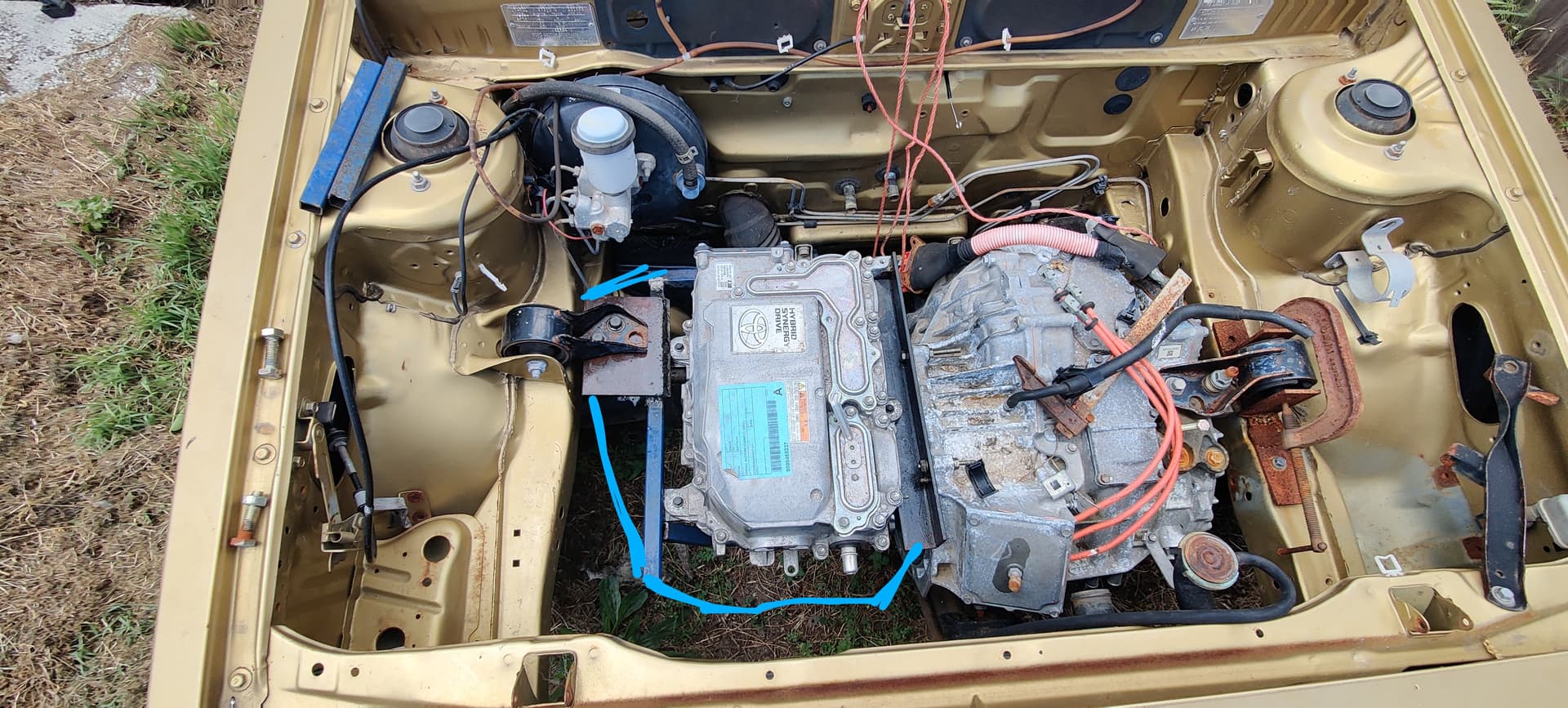

Now that the transmission is in I’m starting to get a better feel for how to improve on the design, as well as how to mount other components like the inverter, battery and other electronics. On the left side of the transmission with the box steel, I’m gonna build a sorta cage that will hold the inverter and have some room for batteries when those come eventually. This will give the whole thing more rigidity, as well as giving more mounting points as there is a stabiliser bar that isn’t currently being used
So here’s what I’m kinda thinking. To the left of the inverter is enough space for a 12v battery, and underneath is plenty of space for some high voltage action. Picking up part of a CV shaft from the post office today so we’ll mock that up too.

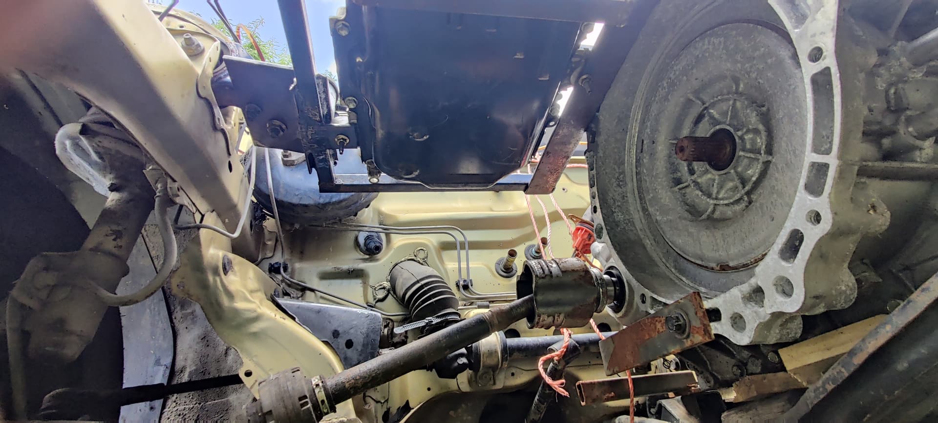

Last photo gives a better idea of how I have the transmission mounted underneath, and the path for the shaft too

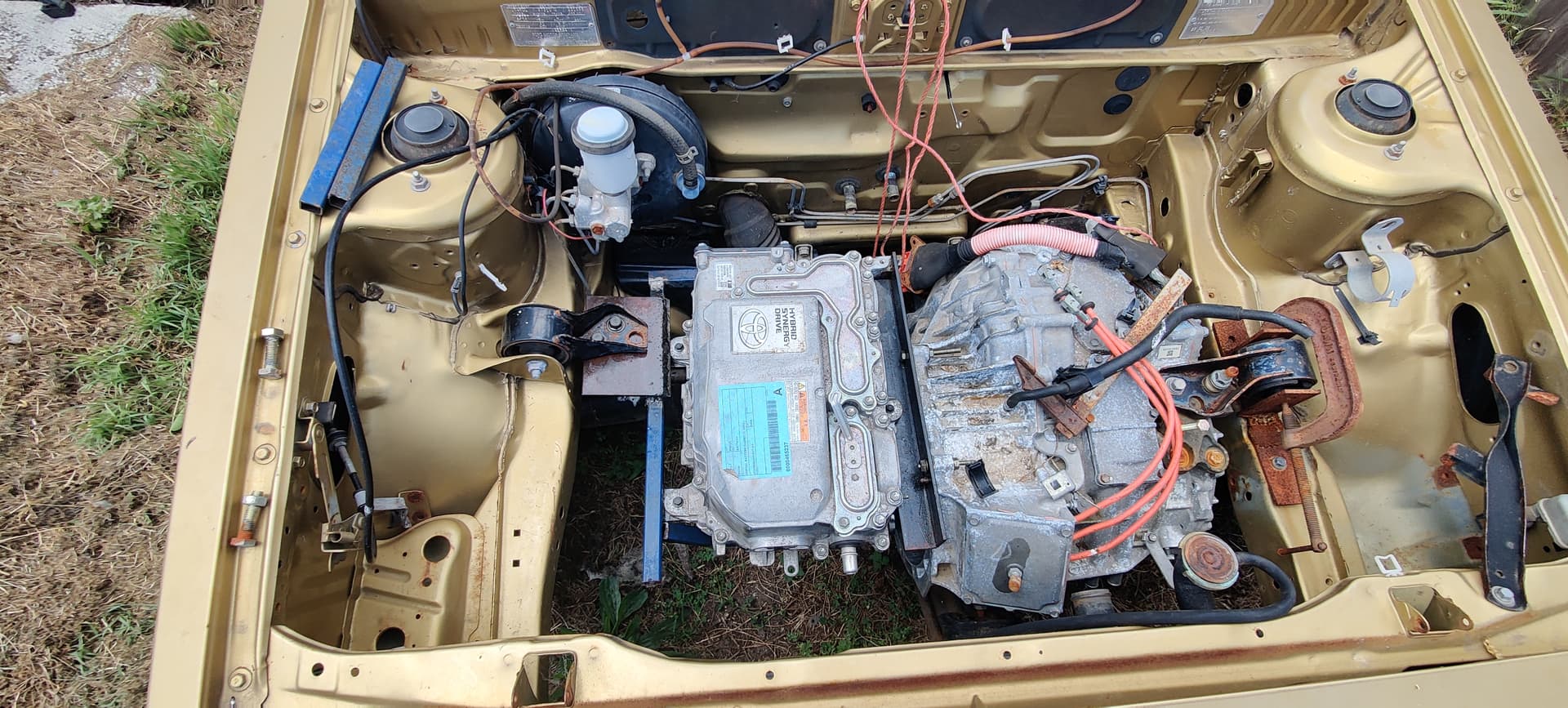

Over Christmas I was given a new welder so I figured it was time to put some proper hours into fabrication. I also got a new set of drill bits and some cutting fluid, which if course has made a huge different in being able to drill a hole :upside_down_face:

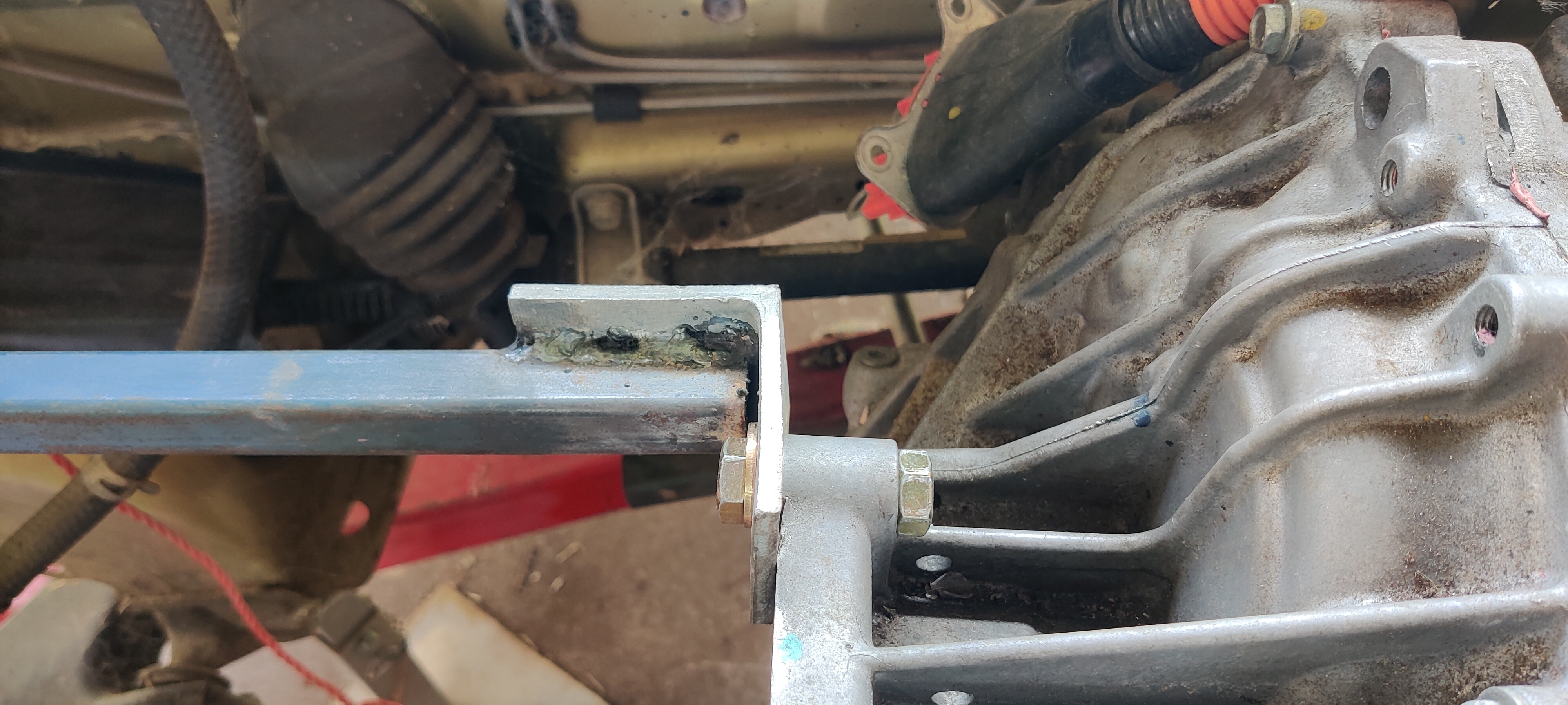

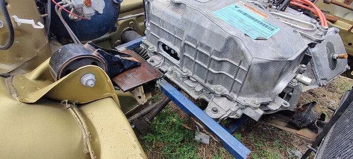

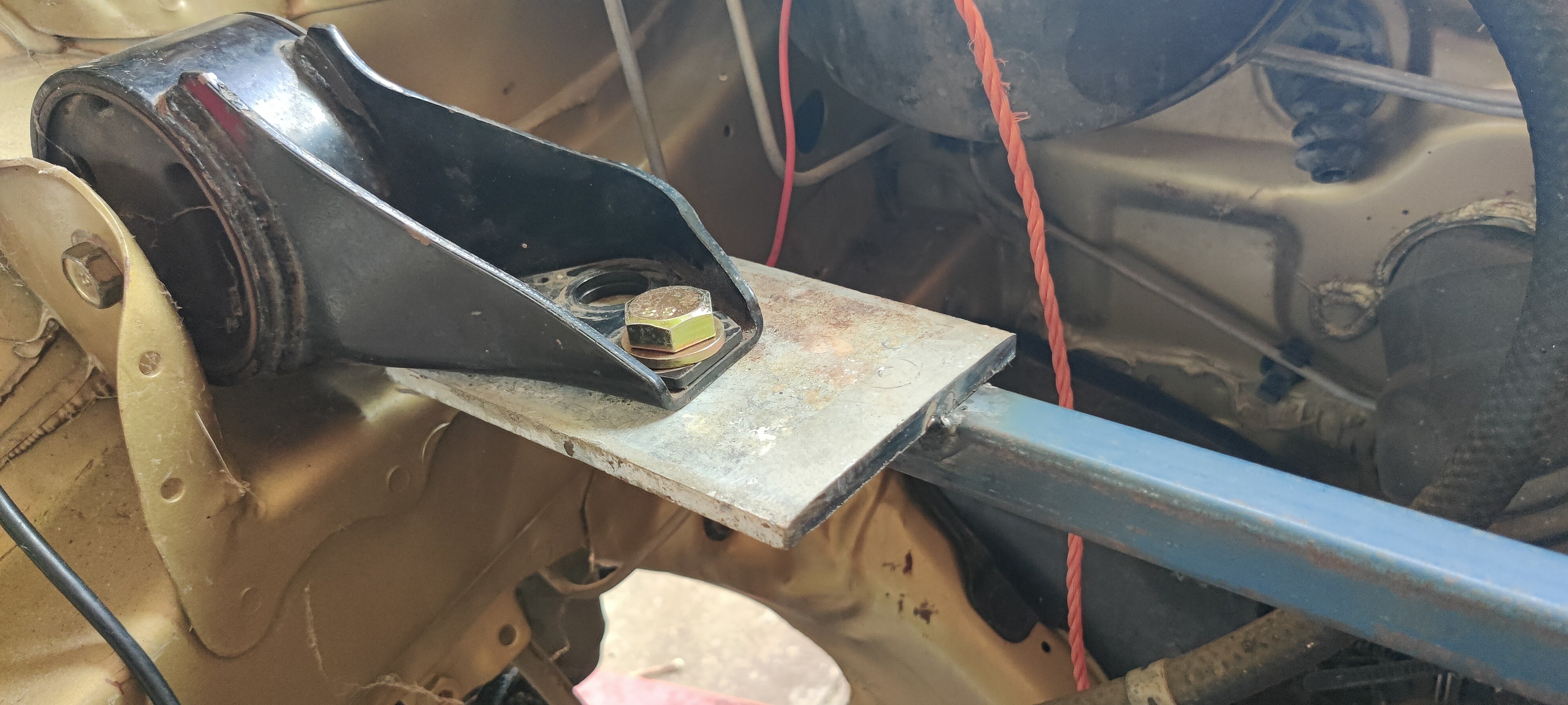

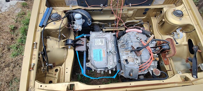

Here you can see that the frame for the inverter has been finished off, with it now connecting to both sides of the engine bay
These images show how each side mounts, with bolts being used to join the various components together

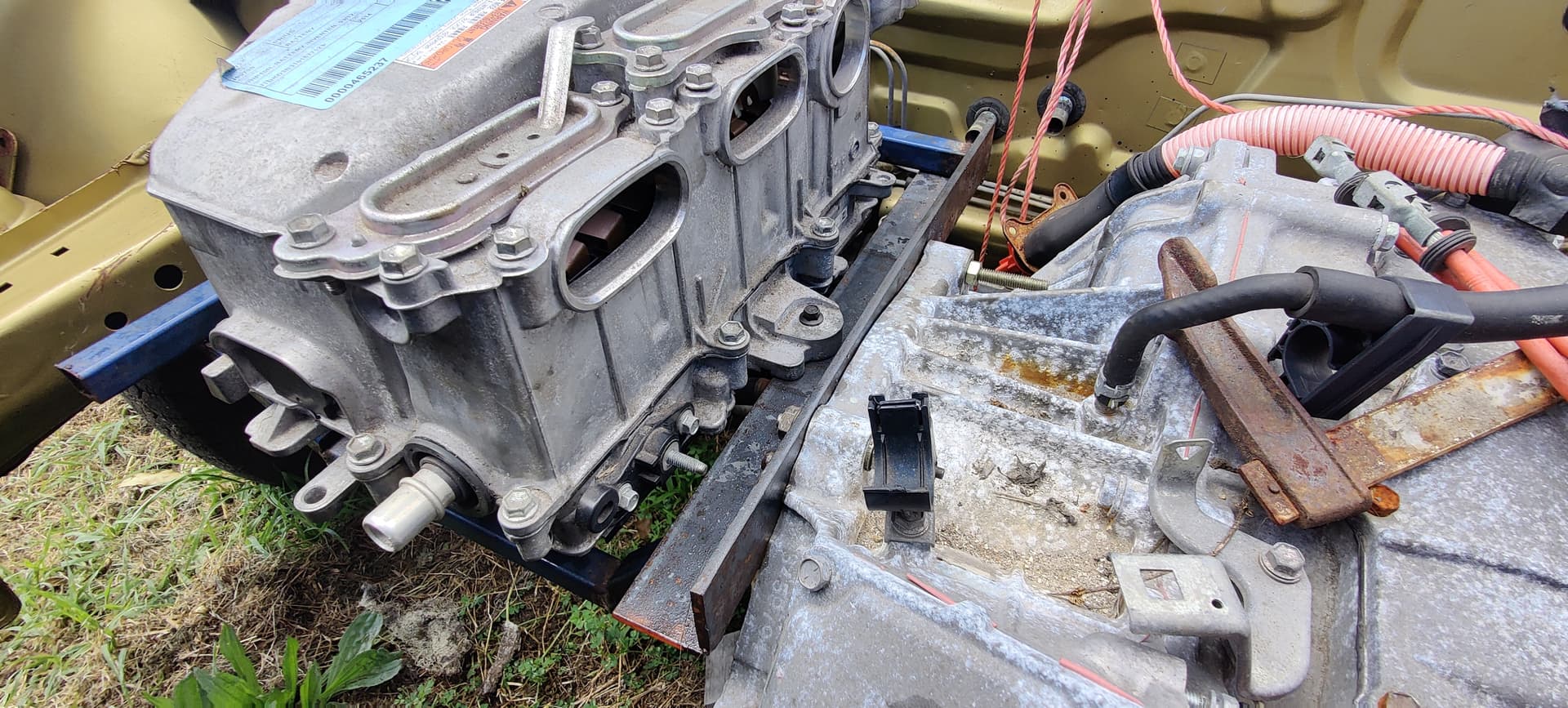

This show the space underneath, which will be used for storing the batteries. You can see on the right side, at the back of the transmission is two bits of metal not connected. That was a test fitment for another mount, with that being my next point of effort
The blue lines show where I will be adding some more tube steel, so that the setup is properly triangulated and supported on every side
From here, the last step is to acquire the control board for the inverter, test the batteries and make sure I’m getting a decently high voltage (gonna be starting at like 70-80v) so we can get it rolling

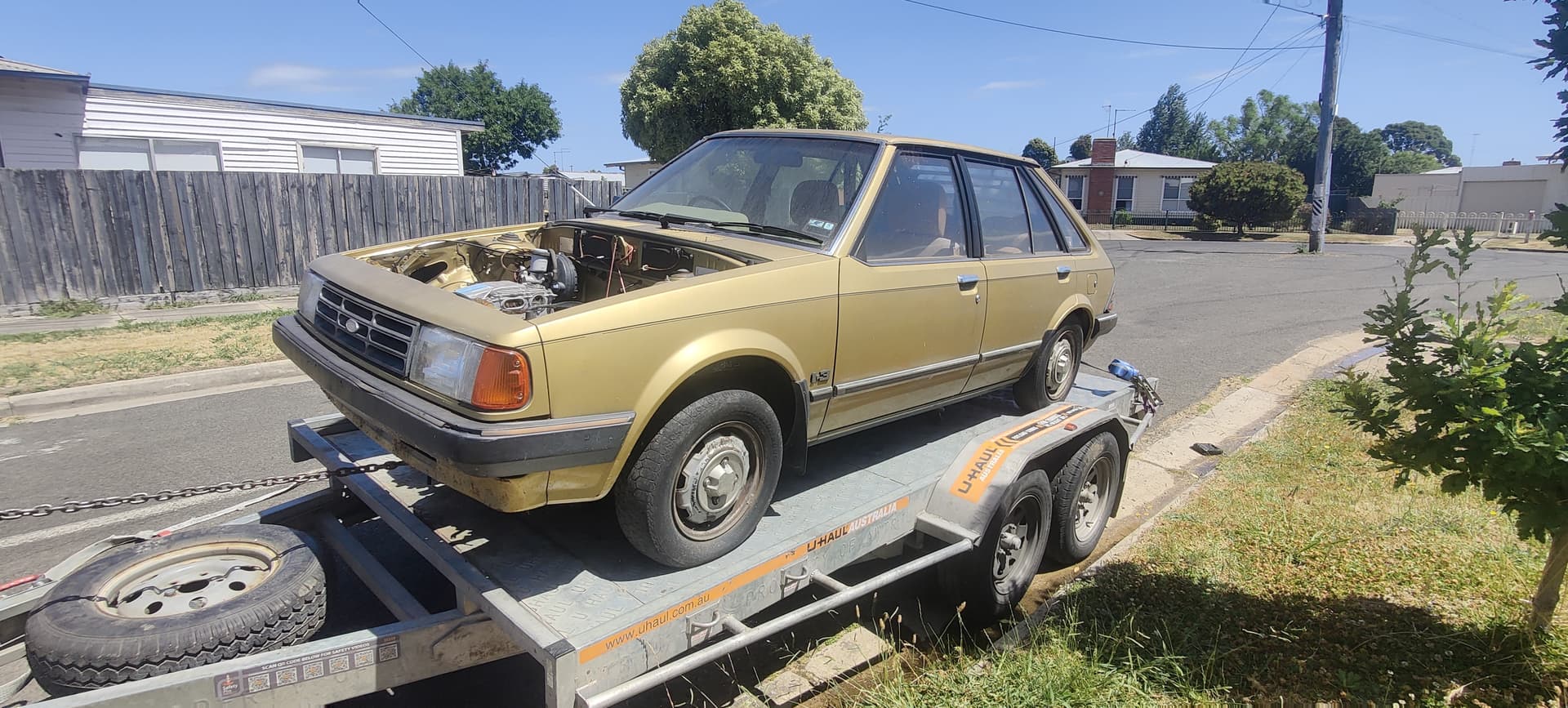

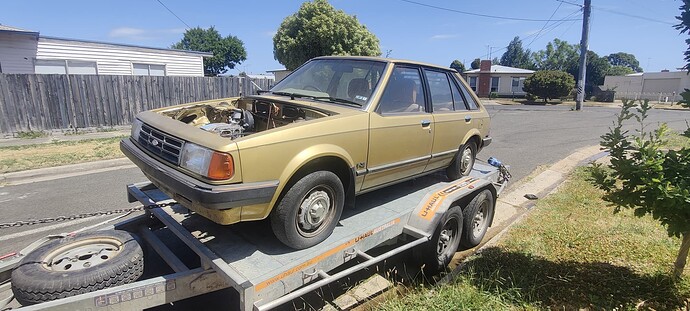

So today the Laser underwent another trailer journey, I’m hoping this is the last time it gets moved like this before it moves under its own power. Unfortunately the rear plastic window Venetian fell off mid transit, and we also smashed a rear light while pushing it into its current resting place. I never half ass anything
This trip was a good test of the welds for the pieces I engineered. While not every bolt was fully tightened, and the main trans was still supported by wood underneath, this showed that at least the welds won’t fall apart under mild movement
Edit: also peep the power pole in the middle of the court/cul-de-sac, I’ve witnessed it get reversed into at least once
