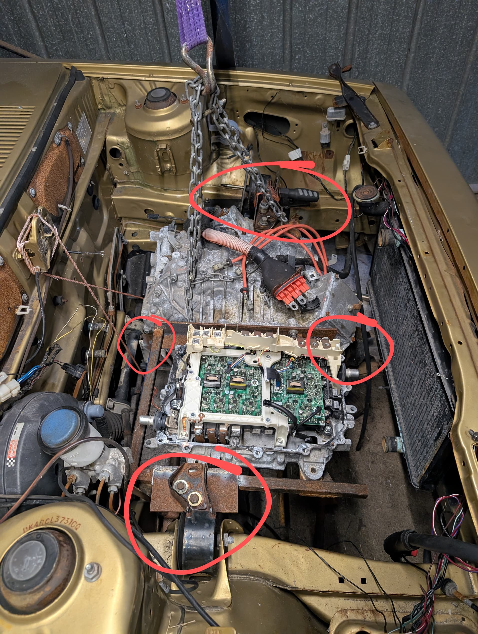

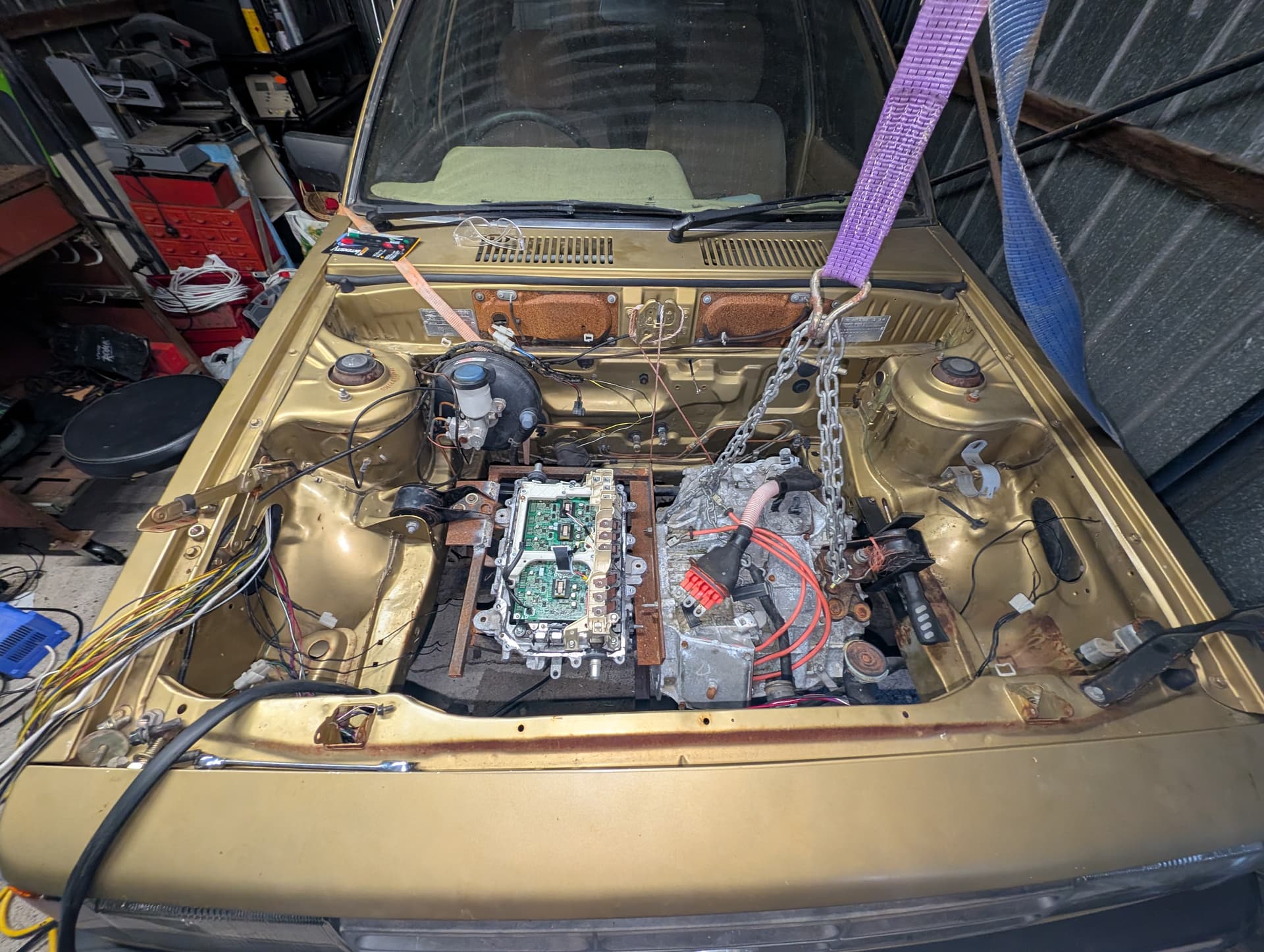

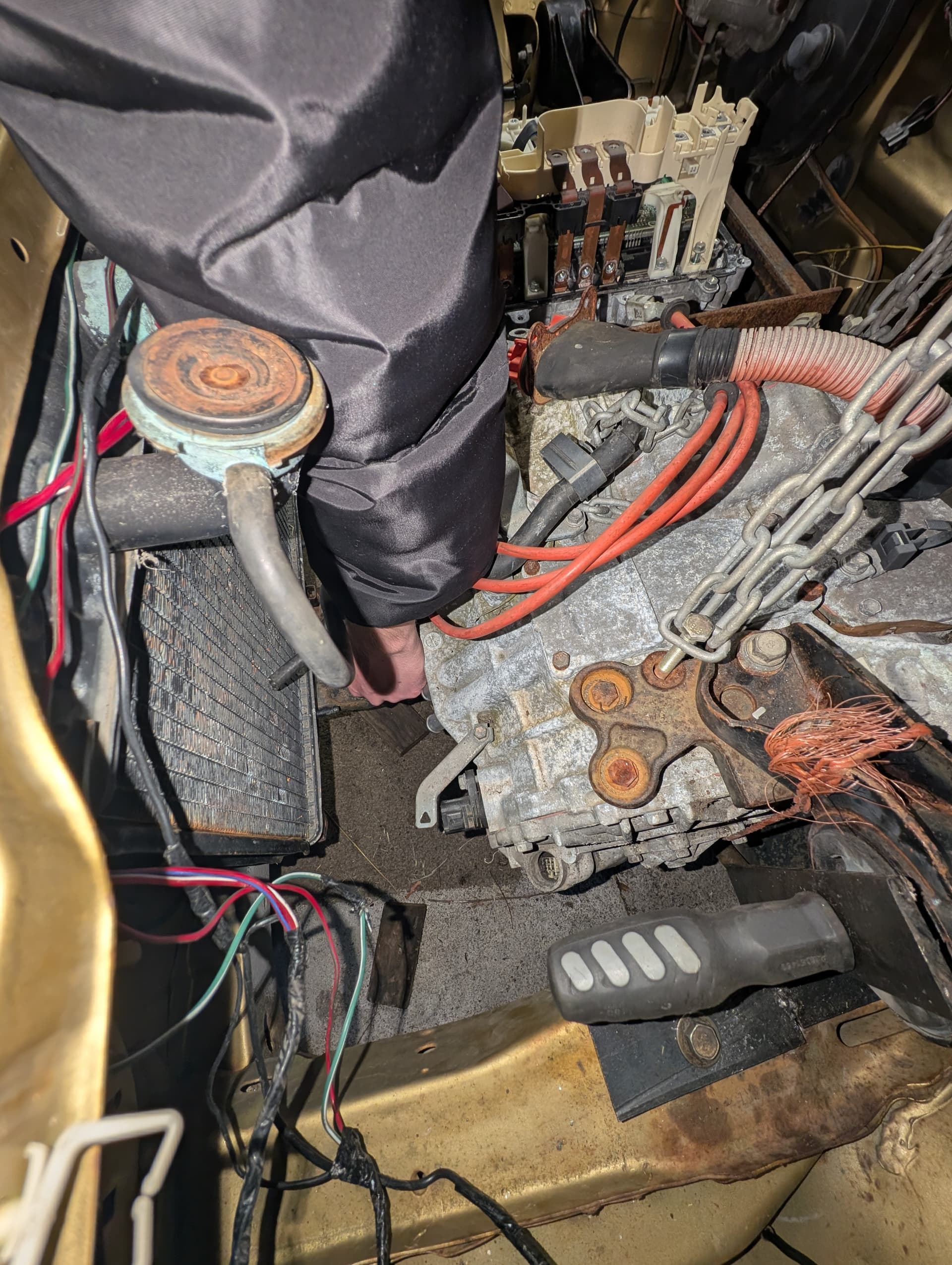

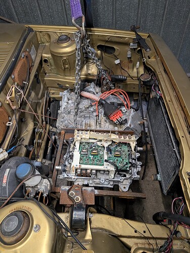

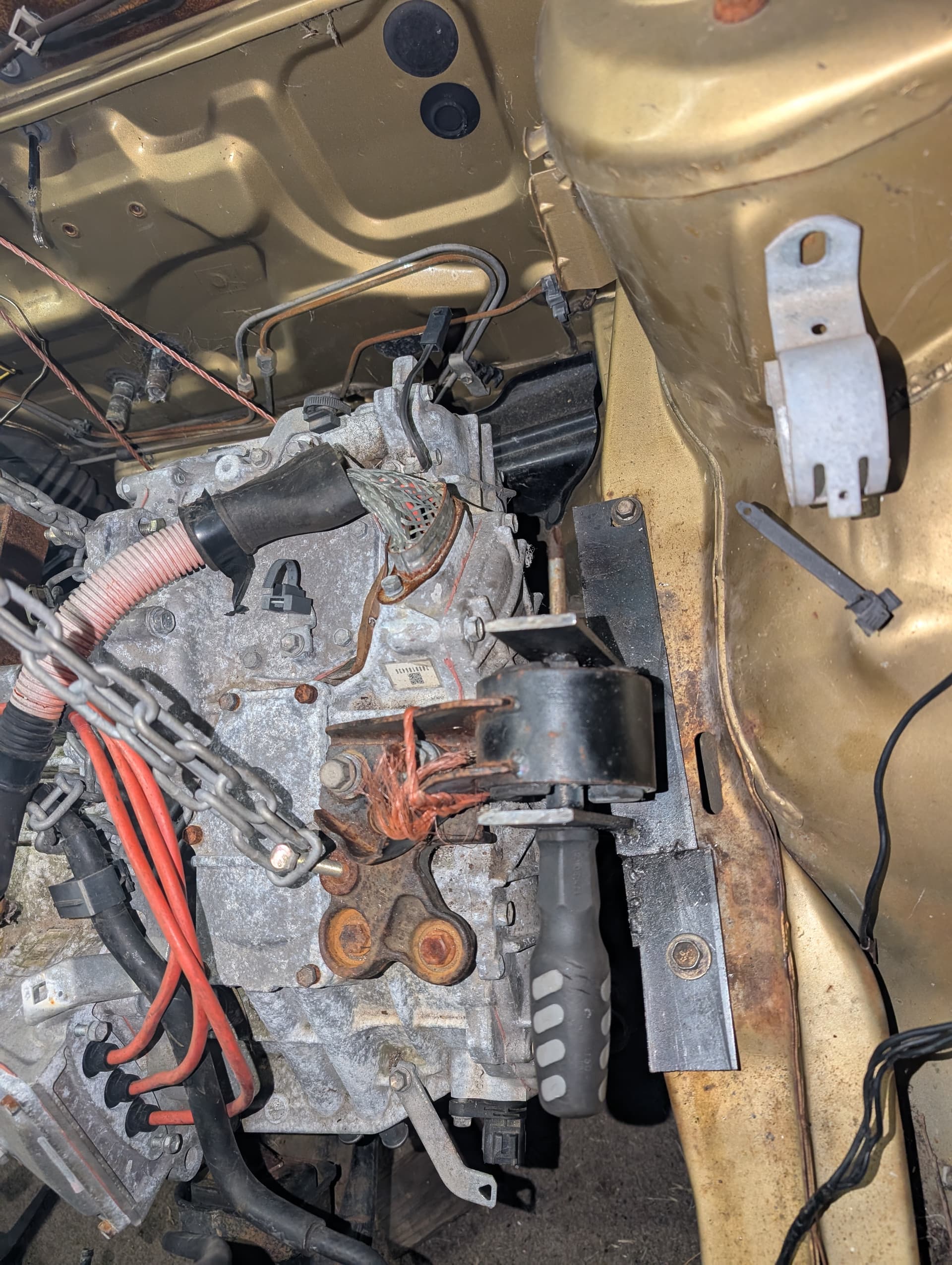

So here is the current state of affairs with the P112 transaxle, and Yaris/Auris Gen3 inverter. It is essentially mechanically mounted, and the car, and my amounts, are able to carry the weight of the trans successfully for the first time. In some of the images you can see some wiring hanging around, one of my next tasks is to decipher the original wiring diagram and determine what I need to reuse and discard in the way of wiring. At this point, the main hurdle from getting the wheels spinning is buying the add-in board for the inverter to get things spinning. Hoping to make some progress on that front in the new year, as I continue to tidy the whole setup. Coming together really nicely
The top and bottom mounts are the main load bearing mounts, the bottom one being a stock factory mount, and the right one being a welded up one, that uses existing bolt holes to hold it in place, so that it can abide by Aussie standards

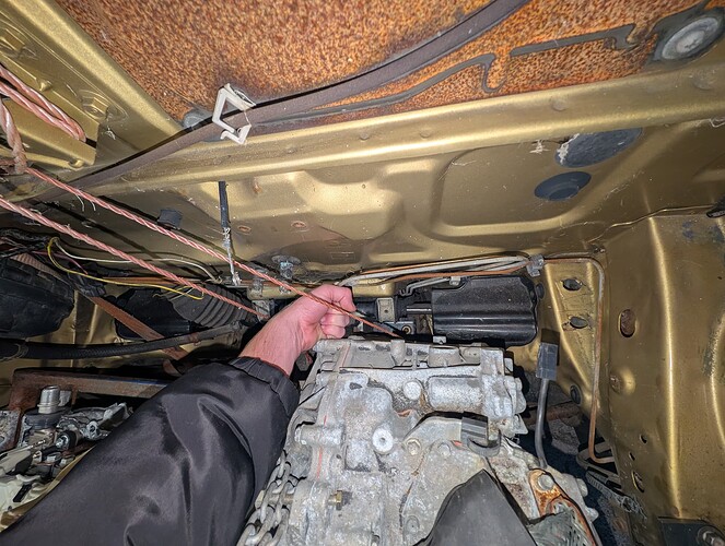

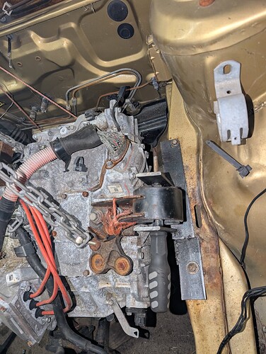

Here’s a better view of the new mount, with a screwdriver to hold it in place instead of a bolt so I can easily unmount. Previous mounts in this location only relied on the horizontal mounting pressure, whereas I have new moved some of the load over to share it vertically with the frame rails

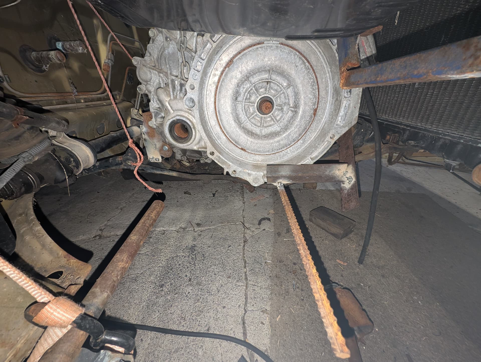

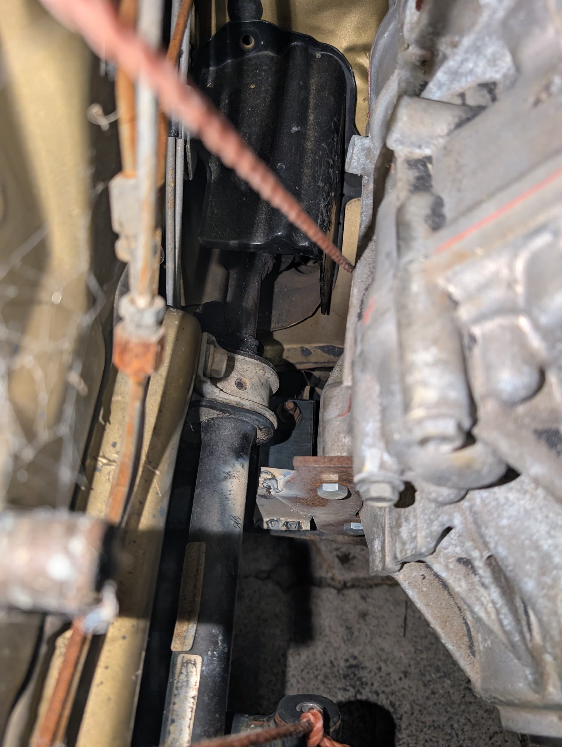

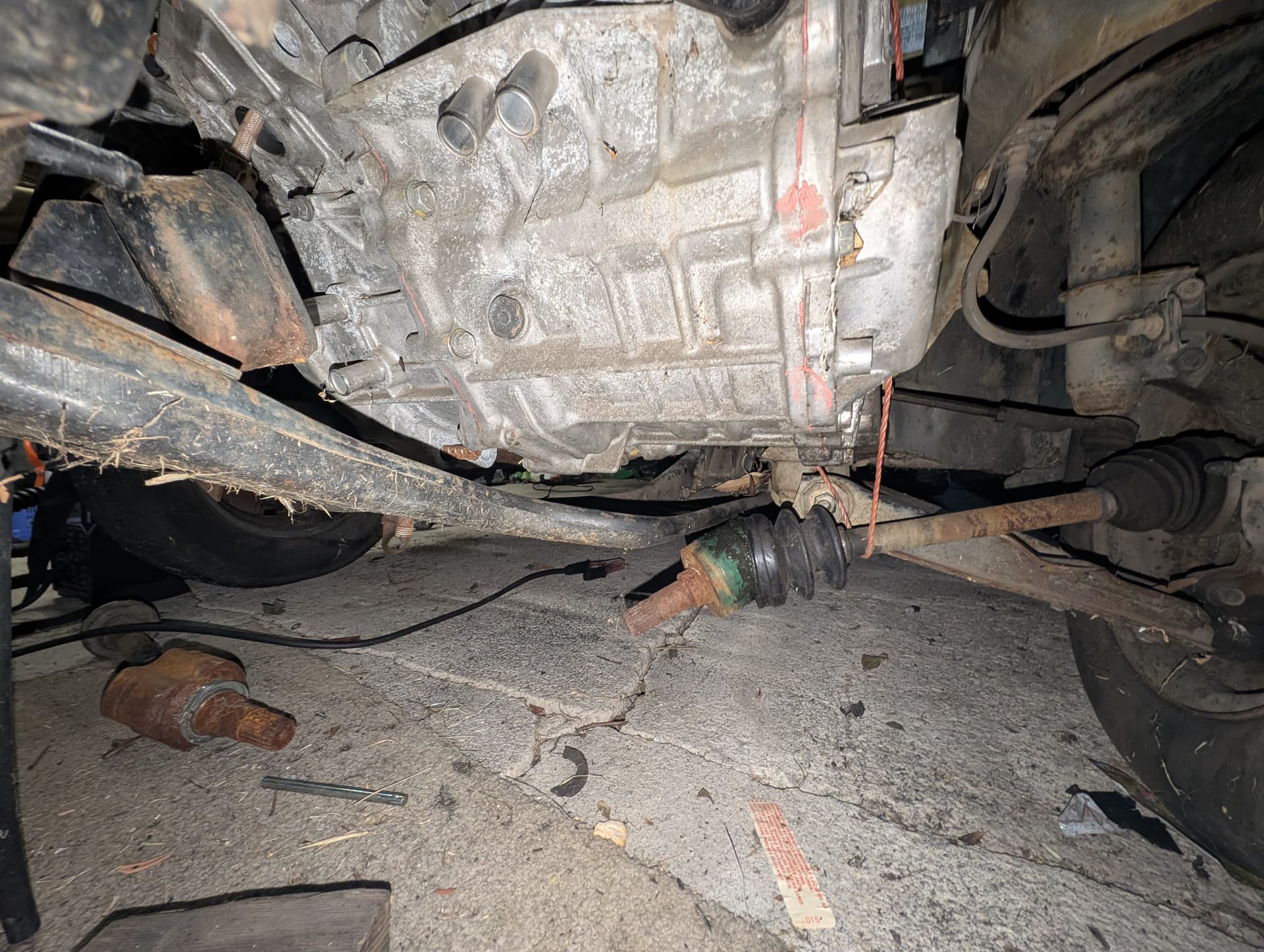

This shows the bottom mount towards the rear of the trans, towards the vehicle body. This mount will hold a bit of weight, but is mostly there to stop rotational movement
This is the space below the inverter, which is where batteries will eventually go. The mount you can see on the right is the only one that still needs to be ‘re-engineered’, its just there to stop any slop

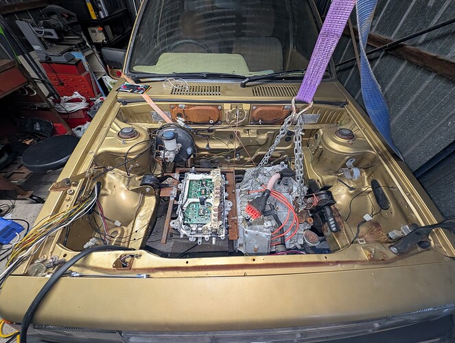

Here is the front on view of the engine bay, the lift is currently holding the weight of the trans, but as is, the mounts are 100% capable of handling the trans’ weight

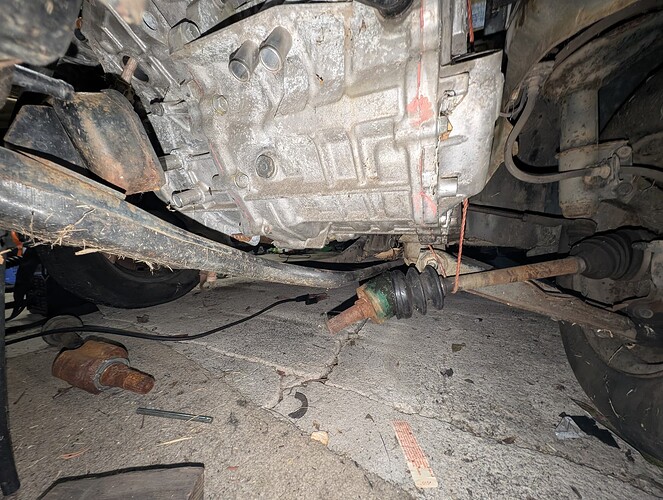

This is the clearance underneath the trans, probably a good few inches to work with under there. Considering the rubbers on the mounts are all original from 1984, they hold up really well
Last two are just using a fist for scale, I have small hands tho
