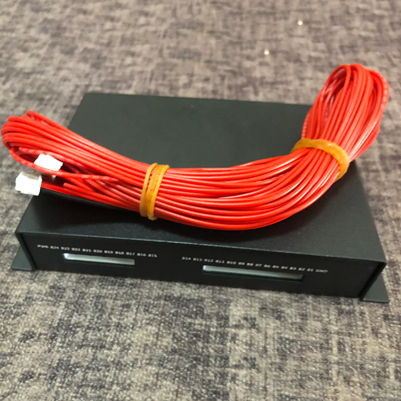

Just come across this product. Its a 24S active balancer that is daisy chainable, and has bluetooth. It will always balance, at a max of 1A at all times, which is pretty fast for these products. I will be able to buy 2 units and have my entire 48S battery sorted. Won’t need a proper BMS as I’m charging through the inverter and there will be overamp and undervolt warnings that are contained elsewhere in the system already (inverter).

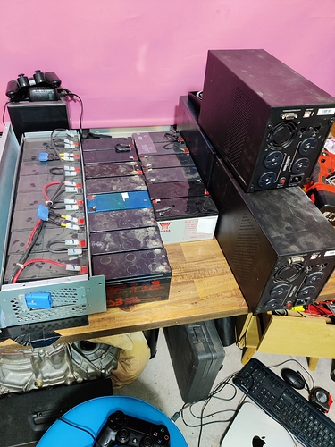

May have acquired some more lead acids…
Gonna try and charge them up tomorrow, the first 10 are all flat right now
So every single one of those batteries was dead. Back to the drawing board.

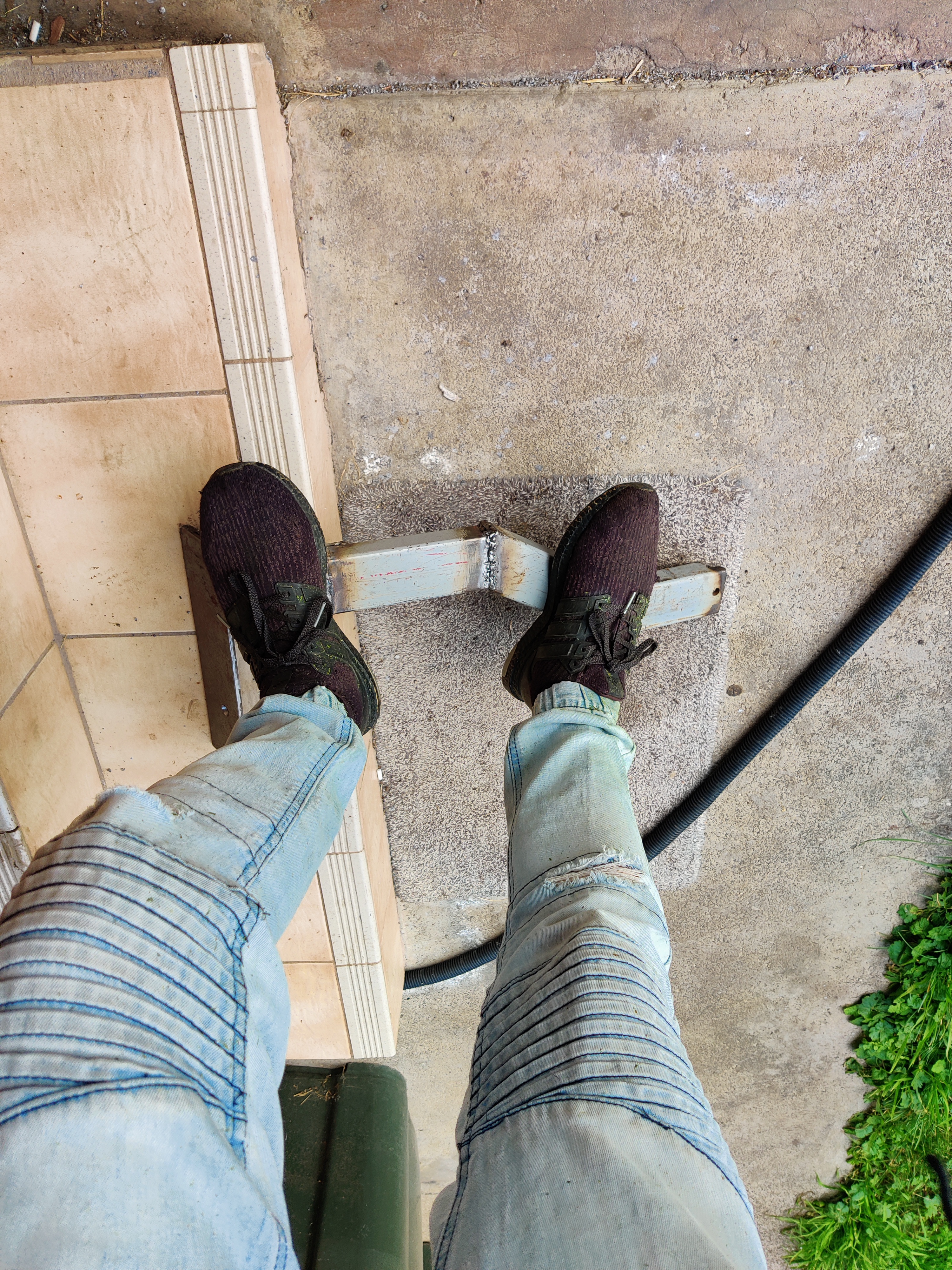

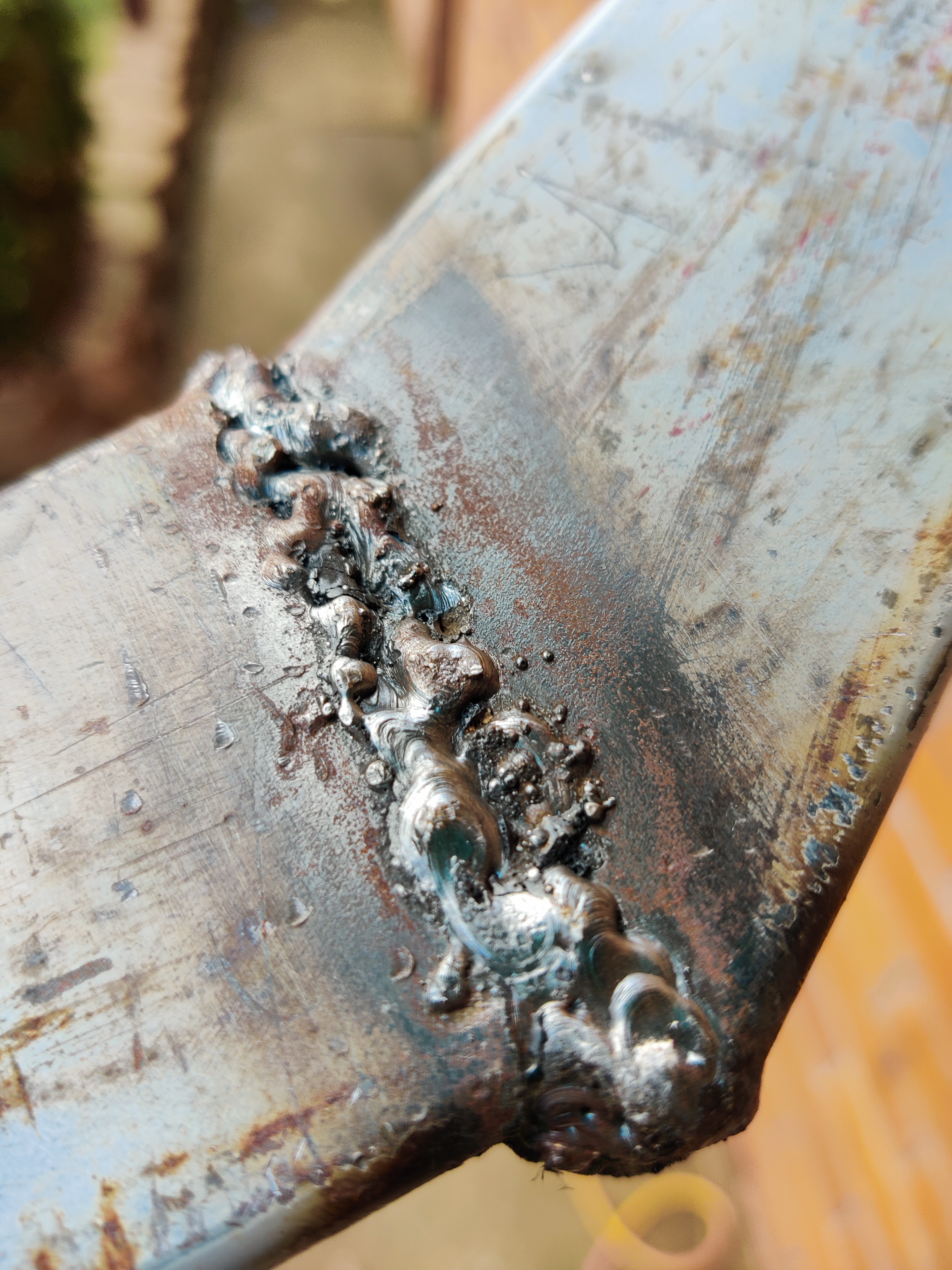

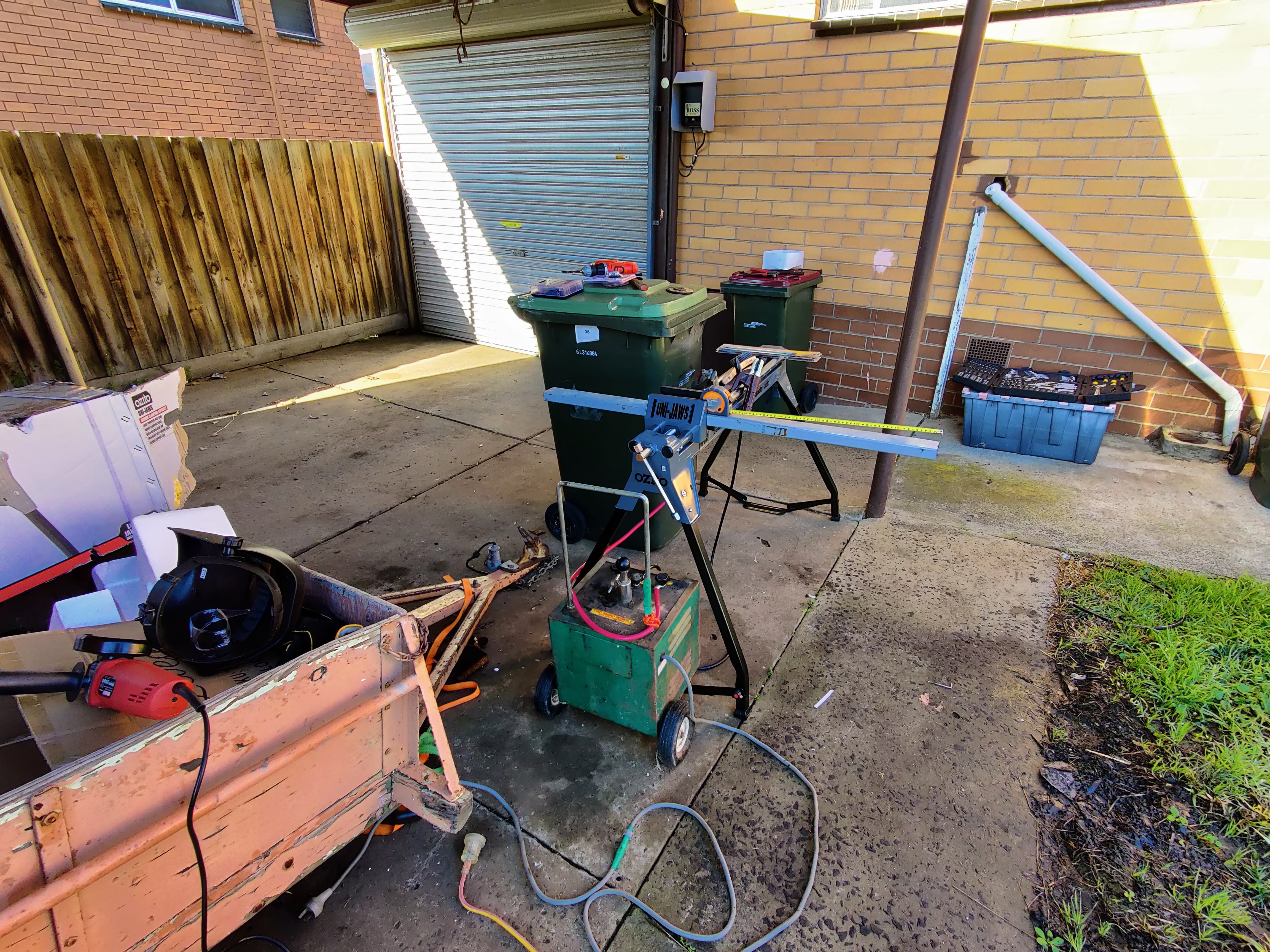

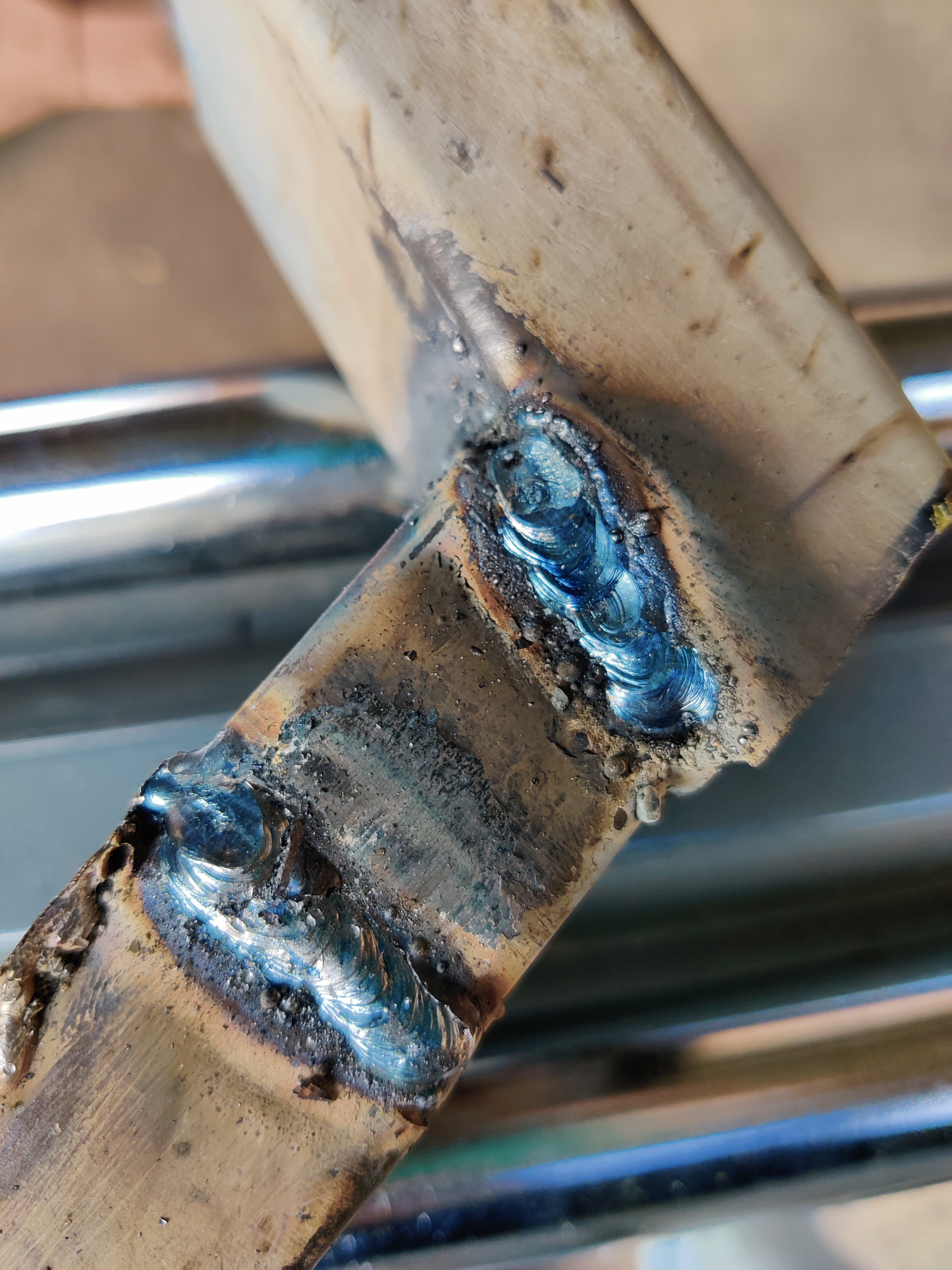

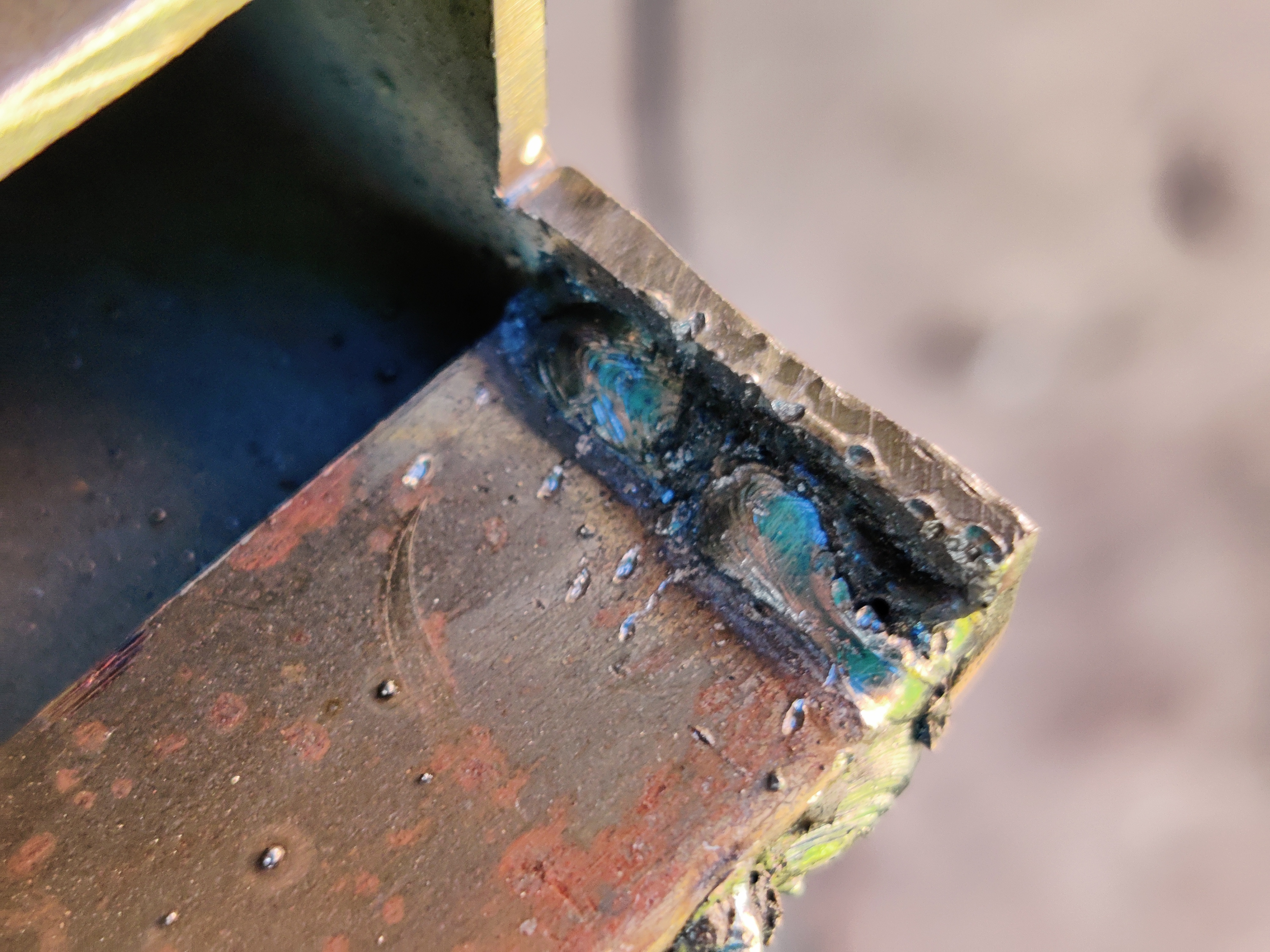

On another note my welding is getting better, as you can see with the before and after. The first mount design is able to hold my weight which is awesome.
Looking a whole lot better! What is this mount for?
A mockup for the transmission mount. This will allow me to do some proper testing once I have the inverter board, and if the road authorities need an engineering certificate for any welding I will take this to a fabricator/welder and say ‘make this but good’
I think you are making a good choice having a professional handle the fabrication.
Absolutely, I am nowhere near skilled enough to have my piece of metal holding a giant 100kmhr spinning magnetic ball of death. Car modification laws here require a fabrication certificate for any structural welding but because I’m not technically welding to the body I’m not sure. Still need to chat with a certification person

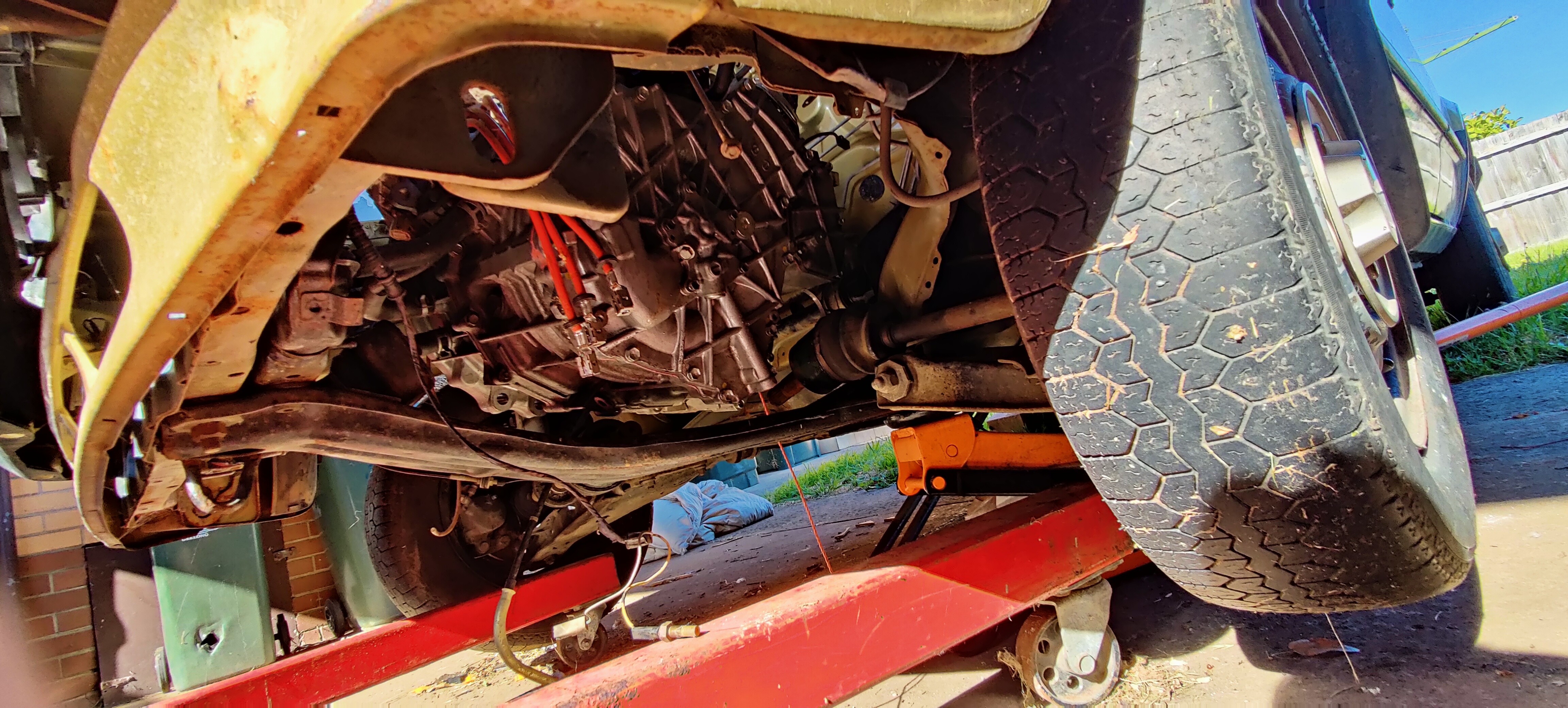

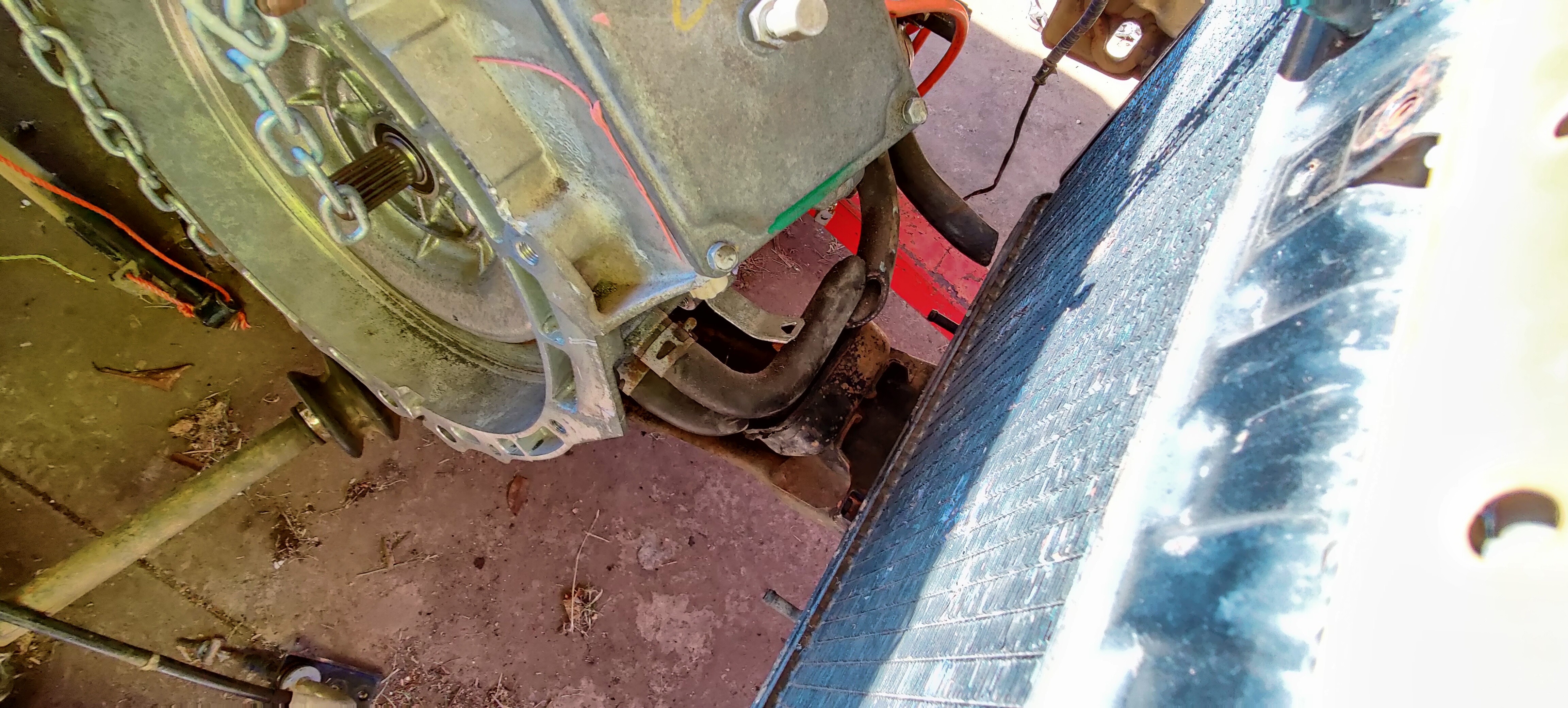

Moved the car to a better spot and I’m starting to size up the transaxle in the car. I made a very crude rig to get this thing up and was bracing for a heart attack every time I moved the crane.
This is the sort of clearance at the bottom. When I get the mounts made up properly I’ll aim to get it a little higher, but where it’s hovering now is a pretty good spot.
Here is the space at the back, there is probably a couple inches between the steering rack plastic guard and the trans. This can be moved forward a bit.
This is the space at the front, a bit if room to move. Those tubes need to come out as they will be routed different eventually. There is some space here.

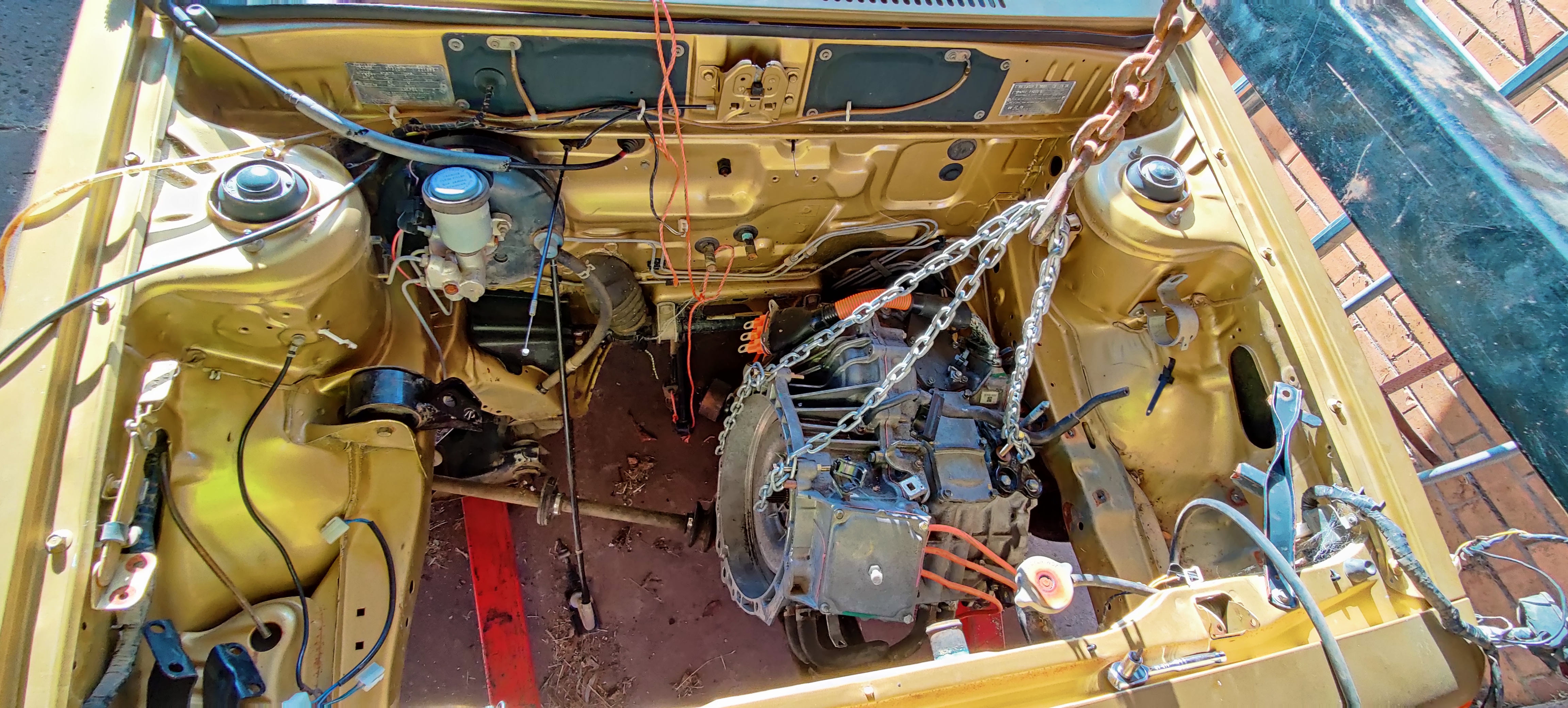

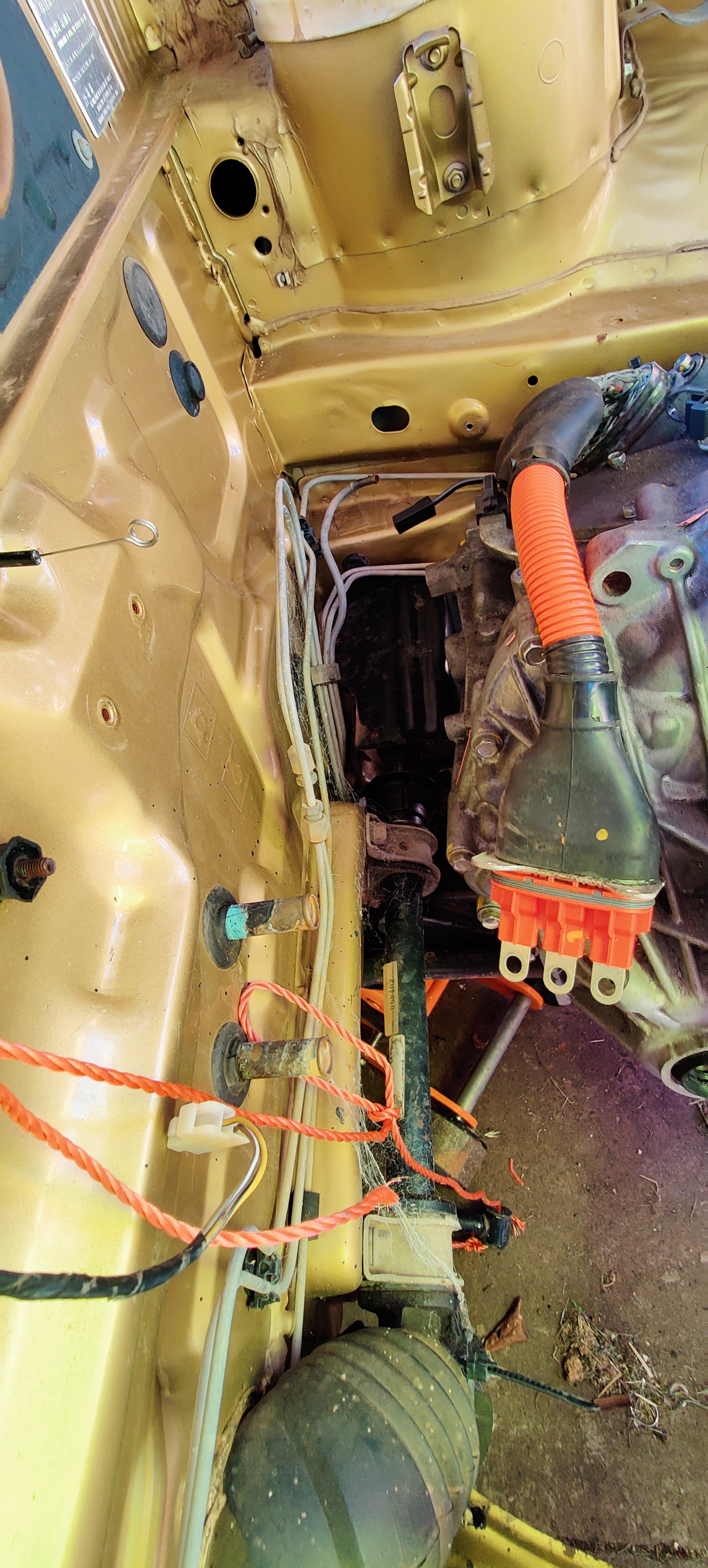

Here’s the full engine bay, it’s still got a bunch of space on the left of the bay as well as above the trans, which is hard to tell from this angle.
Here is my rough intended mount method. The circle on the right is a few bolt holes through the chassis rails that I will use in combination with some thick steel bar. The other two circles are the original transmission mounts, these will mounts to the bottom row of bolt holes on the trans face plate. There is also a stabiliser rod from the original transmission that runs down a small space where the trans column would normally be, I’ll be also using this for some extra integrity. The lines will be box steel connecting from the main engine mount on the left to the top row of bolt holes on the trans face plate. The box steel will then be used as structure for some of the batteries and other required electrical shizz. Some of this stuff will also be mounted off the chassis itself.
Looking for thoughts on how I’m looking
Hell yes. So stoked to see an update :grinning:
I think your positioning looks good, the only think I have to add is that when you are drilling
I would be sure to reinforce the area around your new holes by making a mounting point in the style of the main engine mount on the left.
I will be doing something along those lines. Won’t be drilling any holes, there’s already holes with threads so I’m gonna use those, you can see them if you look closely in the circle on the last image
Ahh, gotcha. Are you planning to hard mount it into the car (metal to metal)? Or are you gonna soft mount it (metal to engine mount bushing to metal)?
Not sure which way I wanna go, I was thinking the hard mount as that will add overall rigidity to the vehicle, but at the same time the bushing could help with allowing very slight movement for high torque pulls. But I would imagine an electric motor would be far happier being hard mounted
I’d probably still go with some harder (pu) bushings.
You don’t have the vibration issues of a gas engine so the old style rubber bushings are overkill, but I’m thinking the hard hits of torque you mention could fatigue the metal if you don’t dampen it out a bit
Sounds good to me. 3 out of 4 points already integrate bushings so it will be fairly trivial to put it in the 4th. Will also only need simple rectangle shapes of it so will be easy to find it
