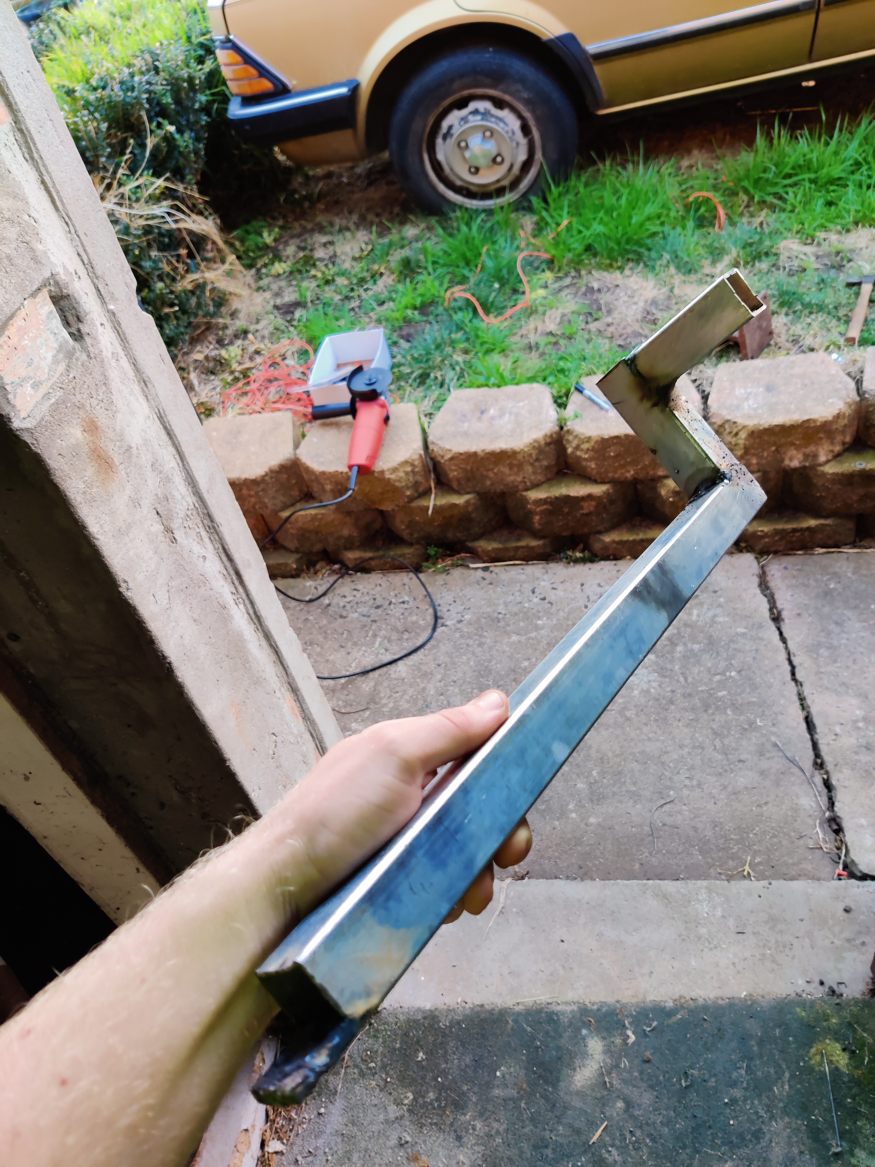

Here’s the beginning of the mount. I’m a dumb fuck and didn’t realise that galvanised is way harder to weld, and 1.6mm thick steel basically evaporates even at 40A. Will be getting thicker non-galvanised stuff this week to make life easier and stronger

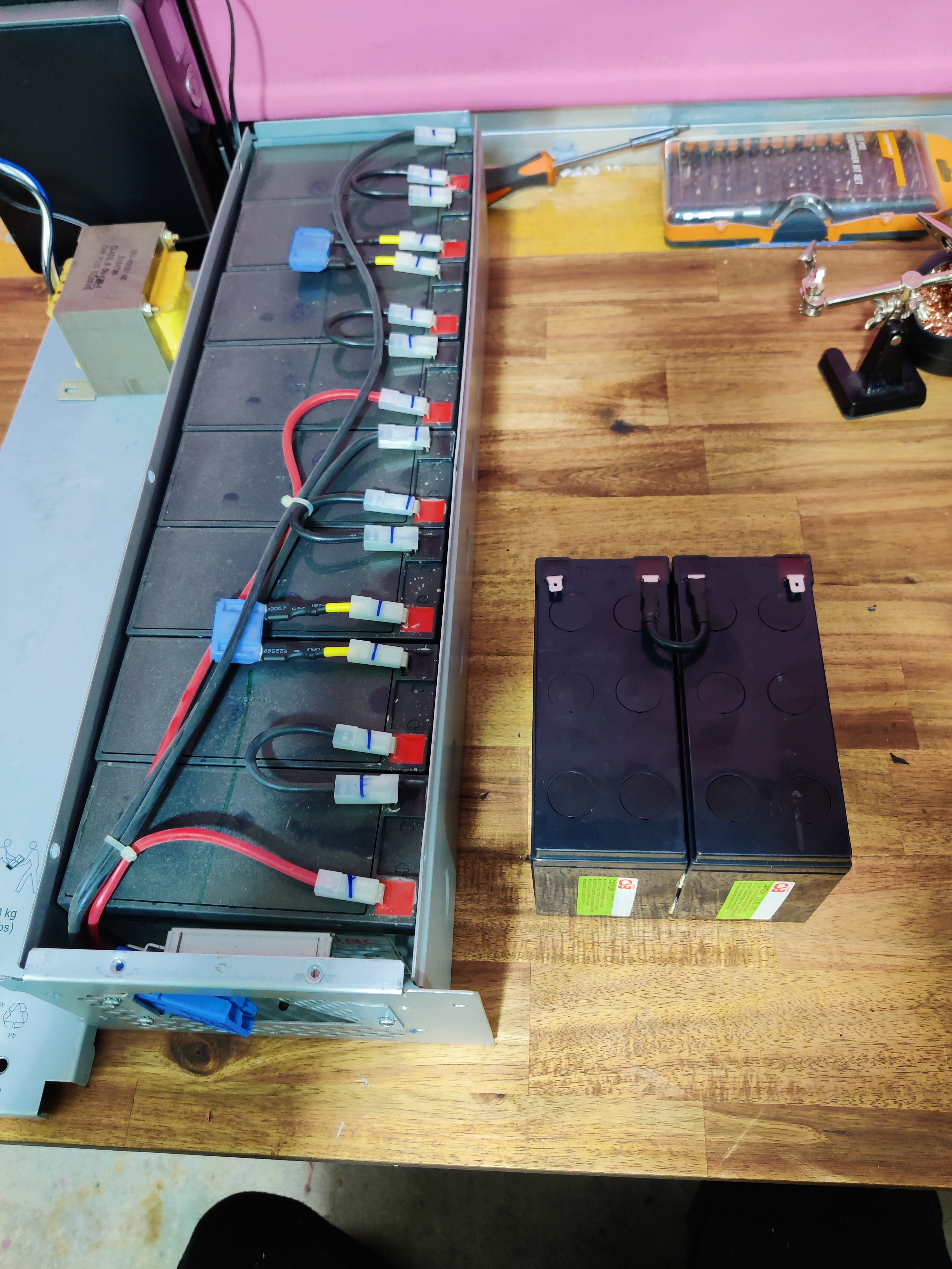

I have acquired 120v worth of lead acid from UPS batteries. All cells are currently at dead voltages but I will see is any are salvageable. I should be able to acquire more packs and hopefully end up with a high voltage traction pack for testing. I don’t want progress to be stopped by lack of batteries so this will be the current solution. Will buy batteries once I’m 100% sure what I want.

I wonder if for the range of that pack, you’d get more distance tethered to an extension cord and your charger :rofl:
I wish that were possible! Would simplify things so much

just a heads up you gotta grind the galvanization off before you weld it, the gas will give you zinc poisoning
Will be starting from scratch tomorrow with regular steel. I was a big dumb dumb with using that shit. It was all the hardware store sells and I didn’t know any better
