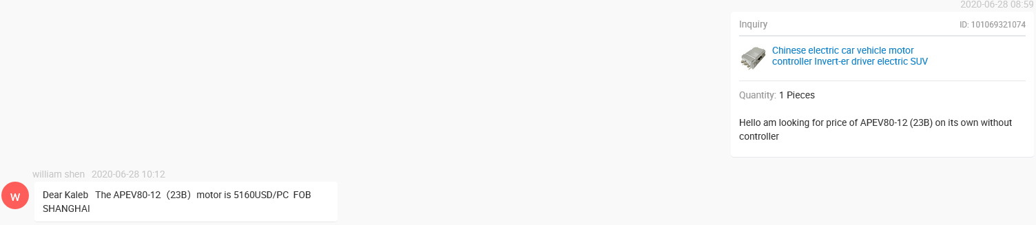

The motors shown here are pretty good, if the specs are legit. Over 1000nm on a ~200kg motor is insanity. Might have to contact this seller and see what a APEV80-12 (23B) goes for. I wanna do a Ford Falcon 500 drag car and this would be perfect. Those motor RPMs will also eliminate the need for a transmission which lowers weight. Au Arduino, which will be used elsewhere in this vehicle for control, can monitor the gear selector position and then push the required user profile to the inverter.

The siamesed stators seem like the economical route again, especially if that $800-$5000 range is accurate for the APEV80-12.

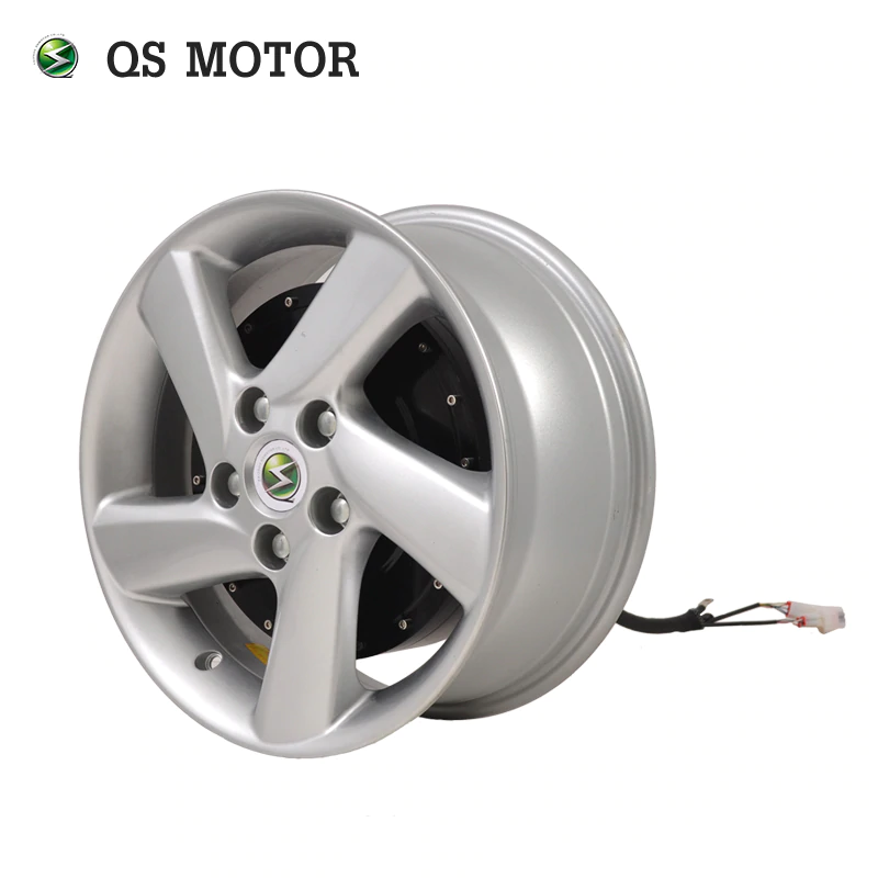

Have you seen the yumcha in wheel electric motor conversions… #Aliexpress AU $845.75 | QS Motor E-car 273 6000W 45H V3 Electric car single shaft hub motor

I haven’t seen anyone use them but have been aware of the option. 6KW*4 would make for a pretty slow car but it is an easy way of saving space of course. Torque vectoring would also be possible here

I am looking for a 15kw hub motor for my E motorbike project next year. They do exist but they are expensive and inefficient. In wheel is a cool concept but I don’t see them producing tons of torque.
