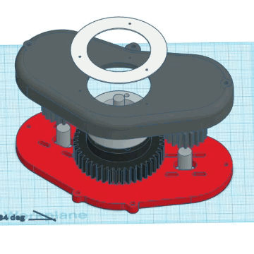

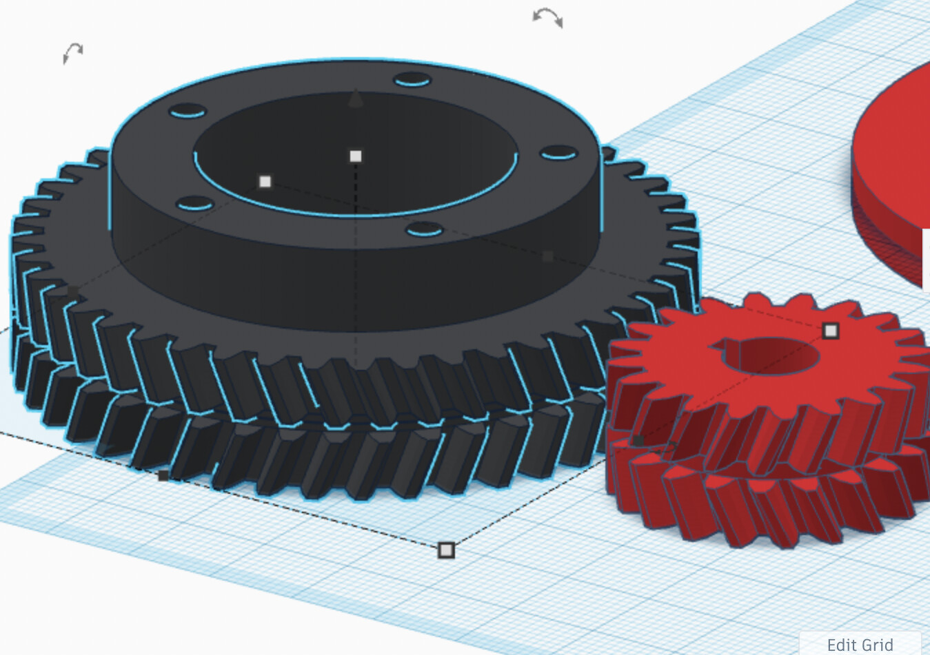

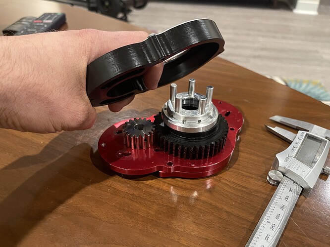

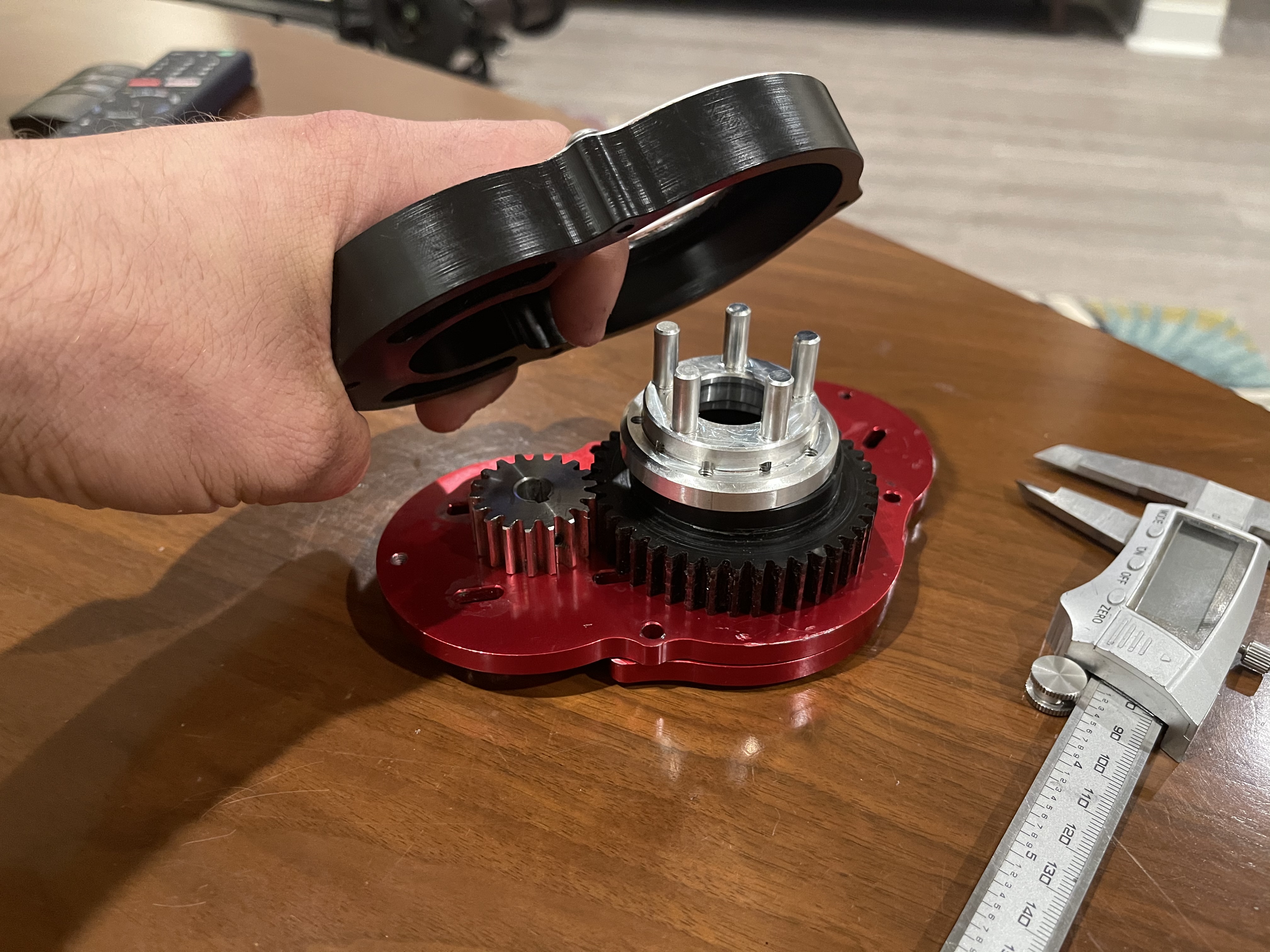

Red plate getting water cut, straight cut gears exist now. Printing grey housing. White teflon shield exists.

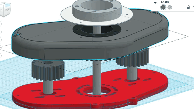

I’m embarrassed I used tinkercad. Fusion 360 with out a CAD background in 2wks while simultaneously getting a feel for 3d printing was more than I could manage.
Stop me if I’m fucking up. This is all new territory for me. @cadguys @Venom121212 @Janux-esk8

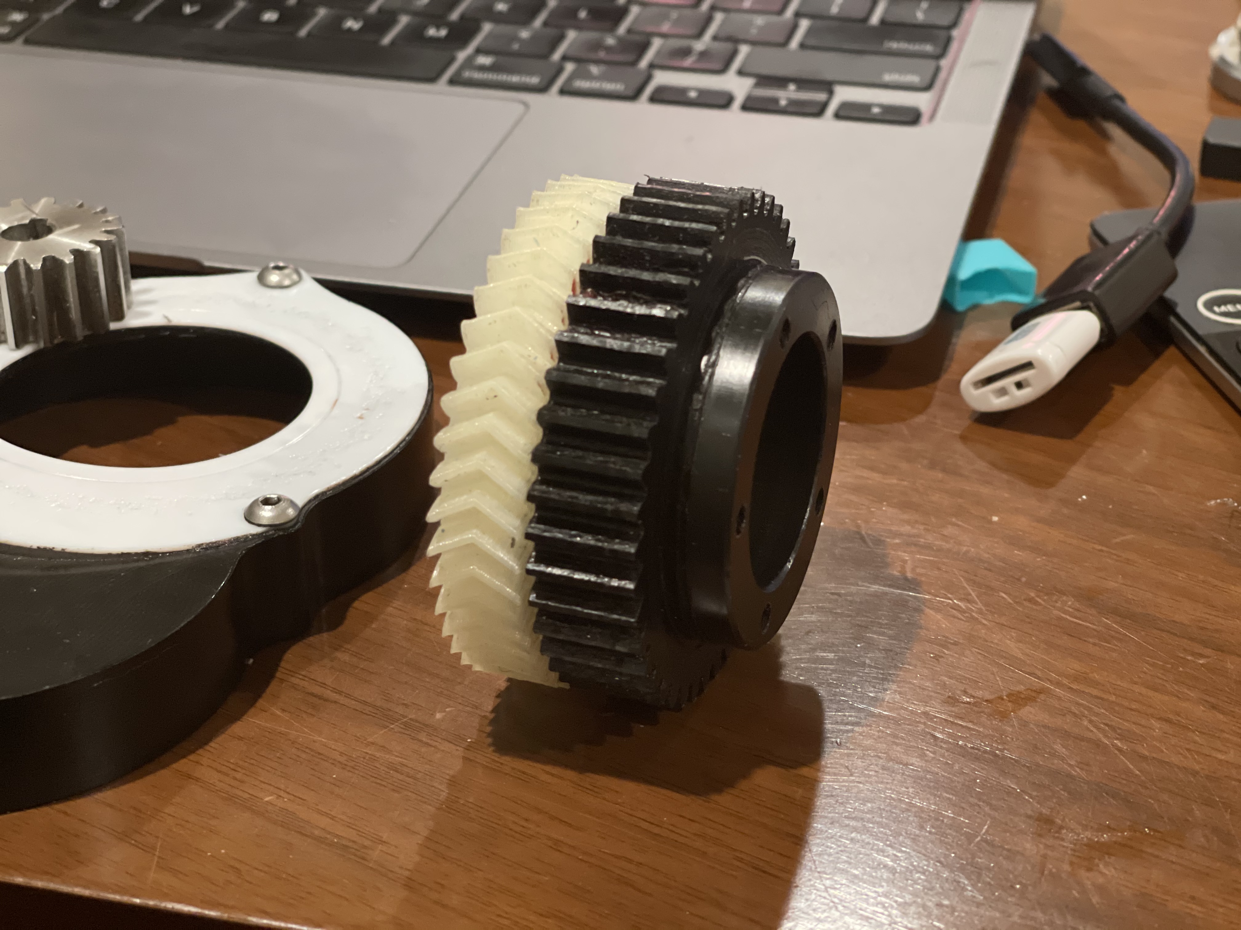

Taluman 910 alloy is pretty tough, especially if annealed. You can’t really sand it. Just gotta keep it under 180c during use. They make high temp 910 that has printing extruder temps beyond my current capability.
I used an opencad involute gear generator to check the profile before I added the helical angle.
[https://www.tinkercad.com/embed/aP3K9KI5z7M?]
roast me, I deserve it. I am aware it’s a kindergarten mockup and symmetry is lacking, but the interface made sense and this isn’t exactly next level design. just typical American, “I bet I could fit an LS8 in that import roadster, say I won’t”
I’ve been told…
That the gear profile models in some cad softwares aren’t perfecly accurate.
https://khkgears.net/ has accurate models you can download and use.
