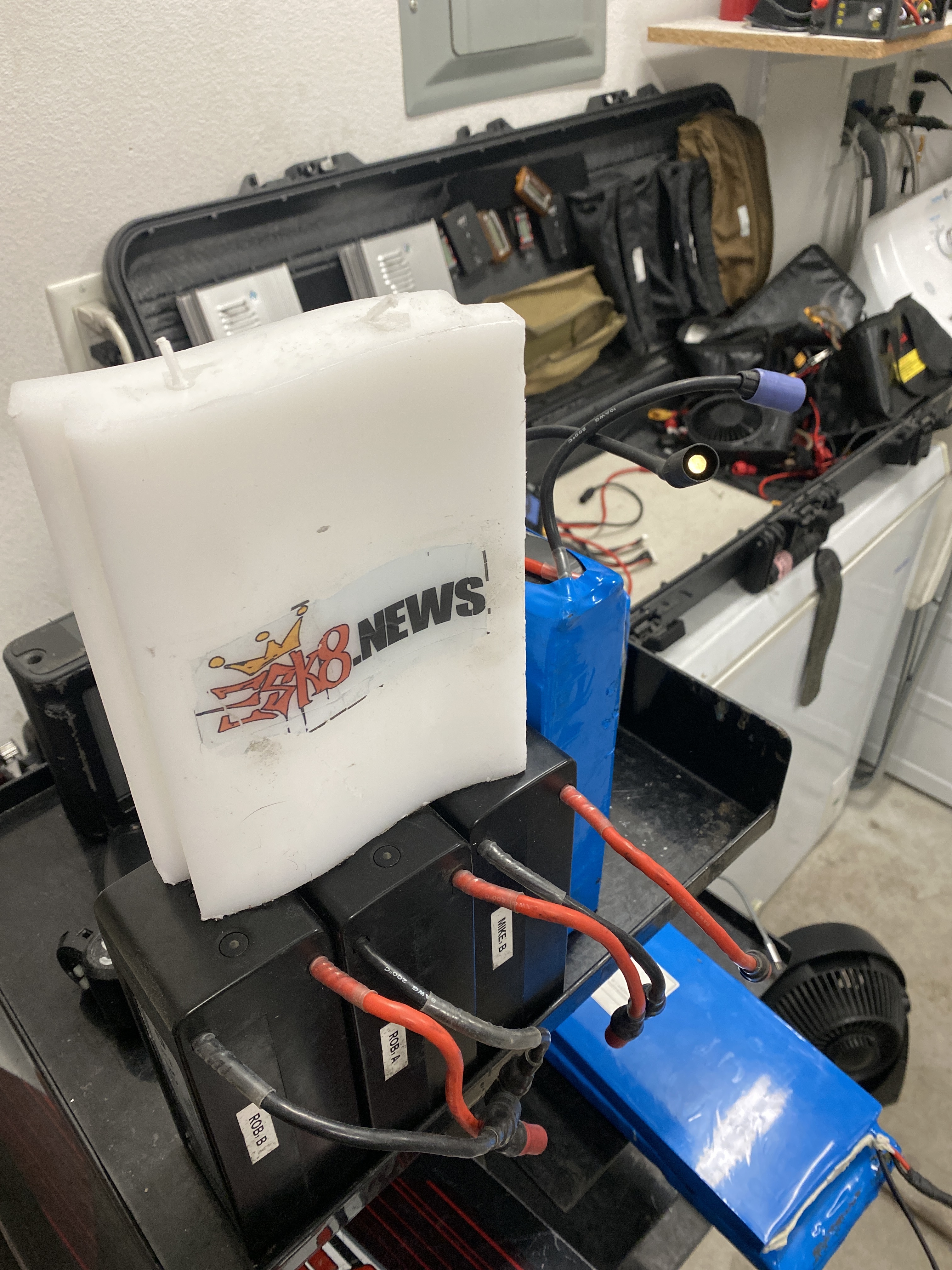

The drunks always knock it over and have scuffed off the graphics twice.
What happened to the candle besides the drunken ships?
When @Arzamenable moves to Oceanside San Onofre Nuclear Power Plant has to build a block 3 so the power grid doesn´t collapse when Dr. Mike starts charging boards.

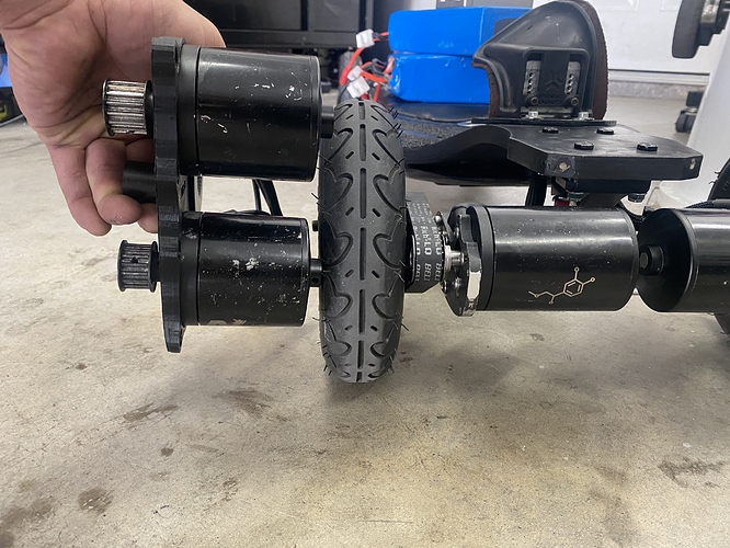

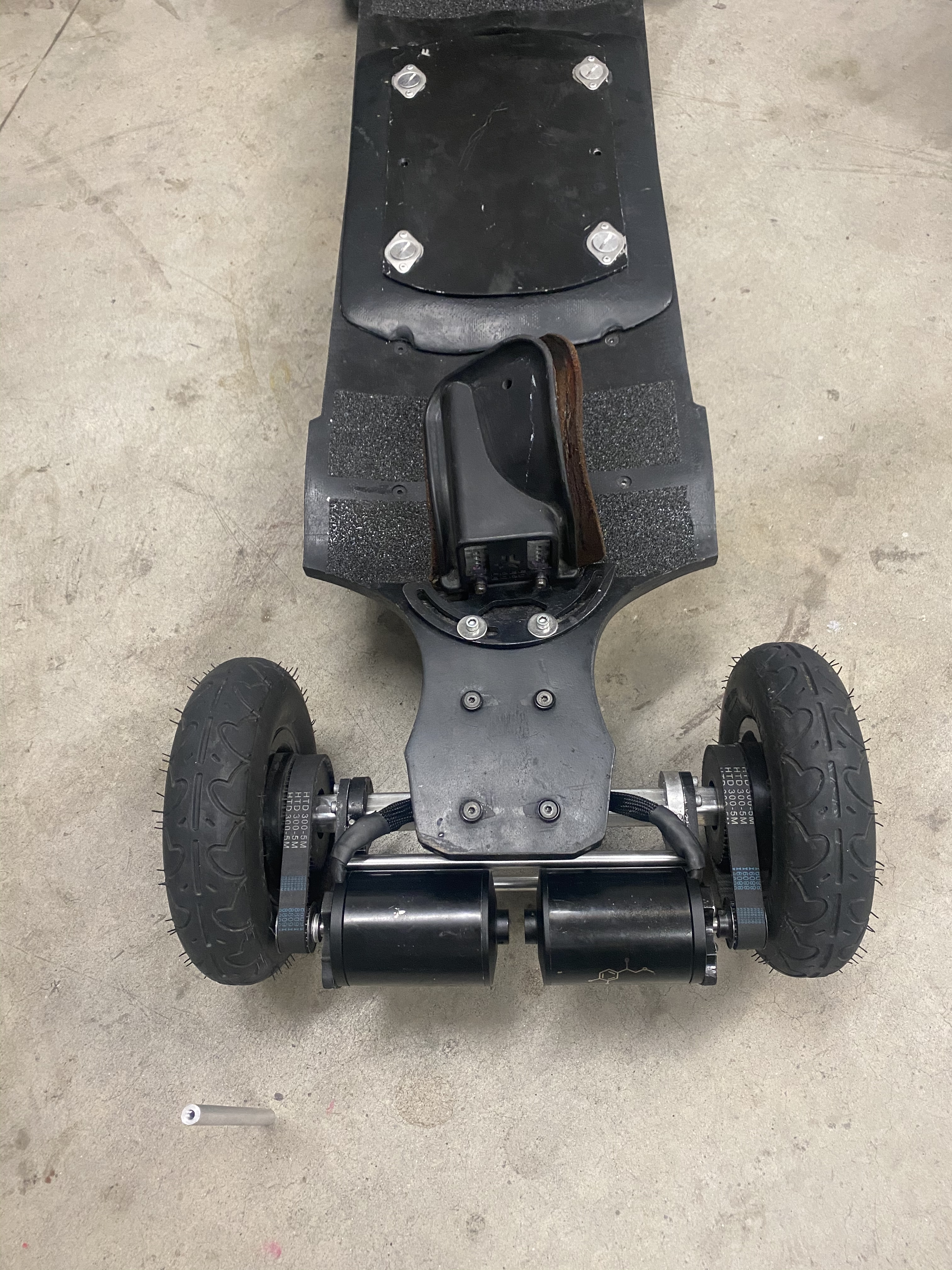

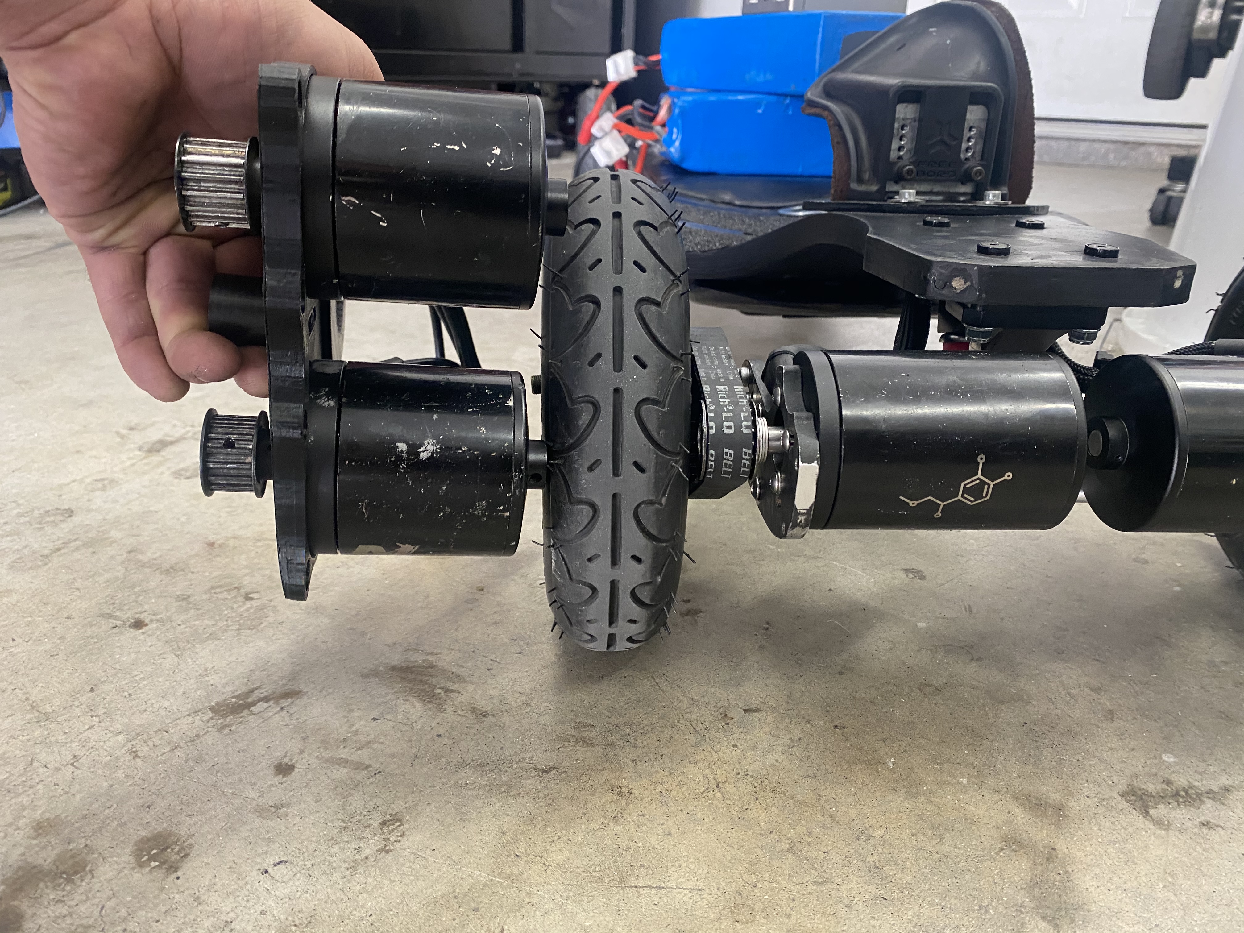

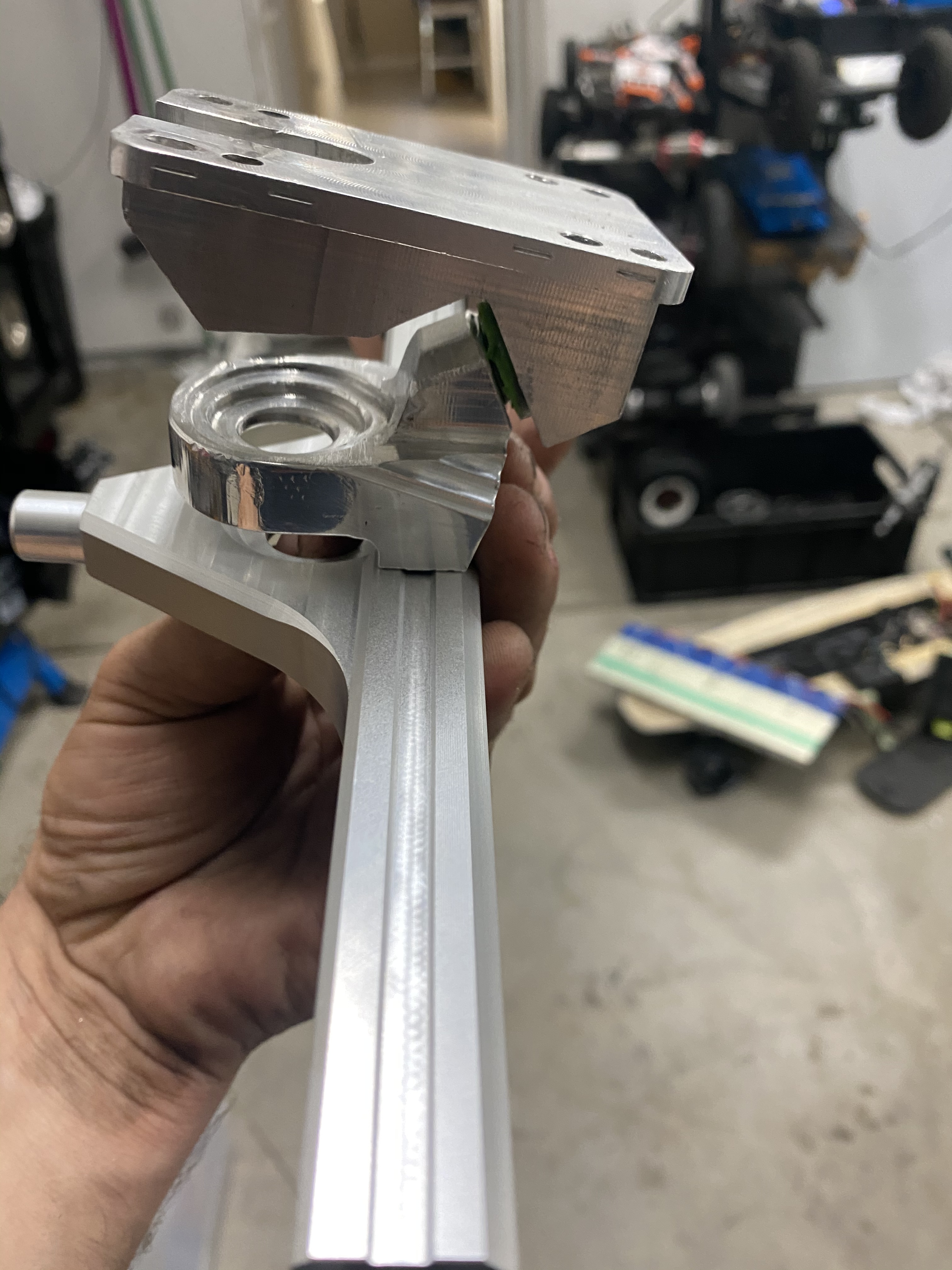

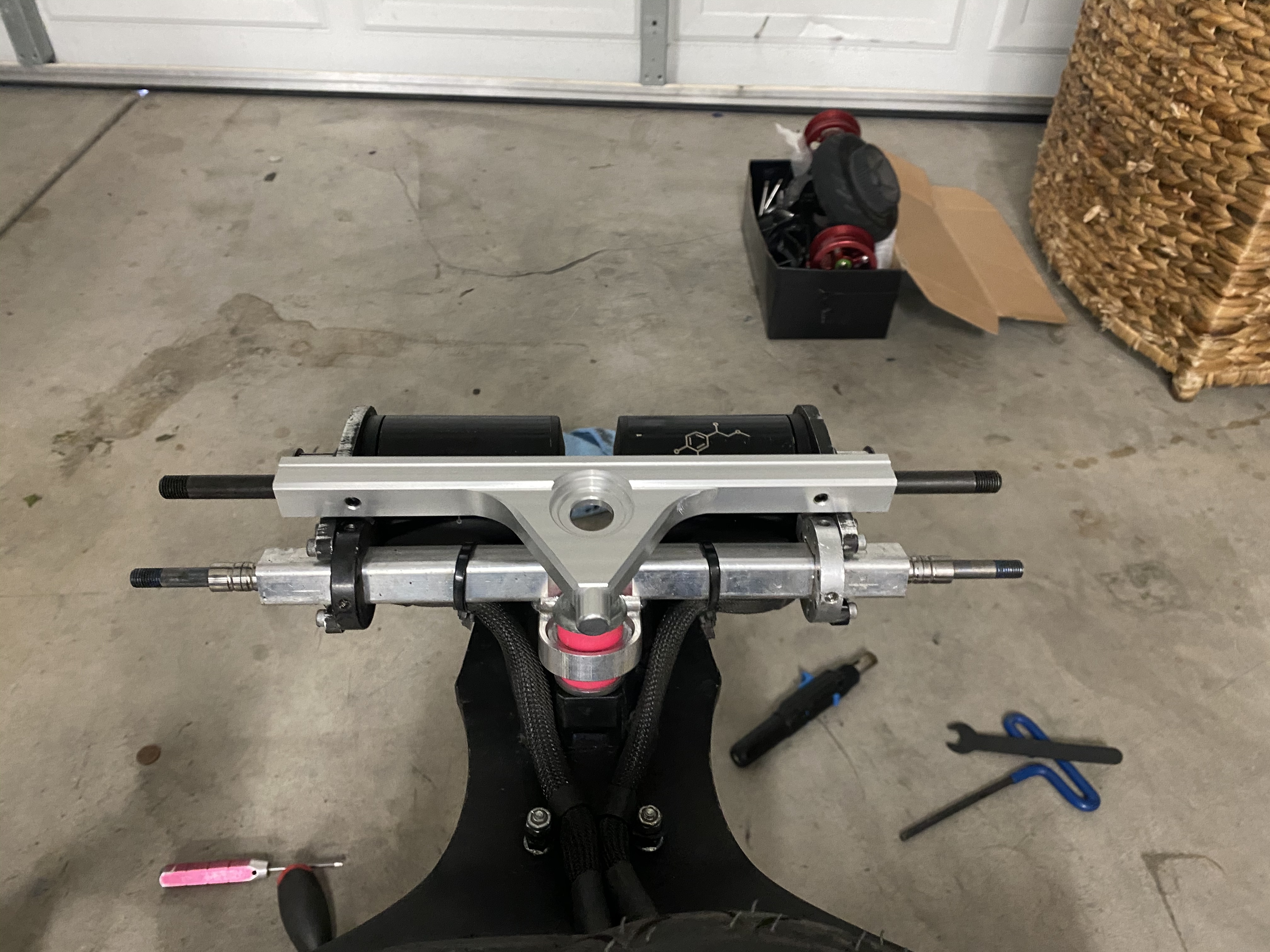

Proper cross mounts, less asymmetry
Much gooder :ok_hand:

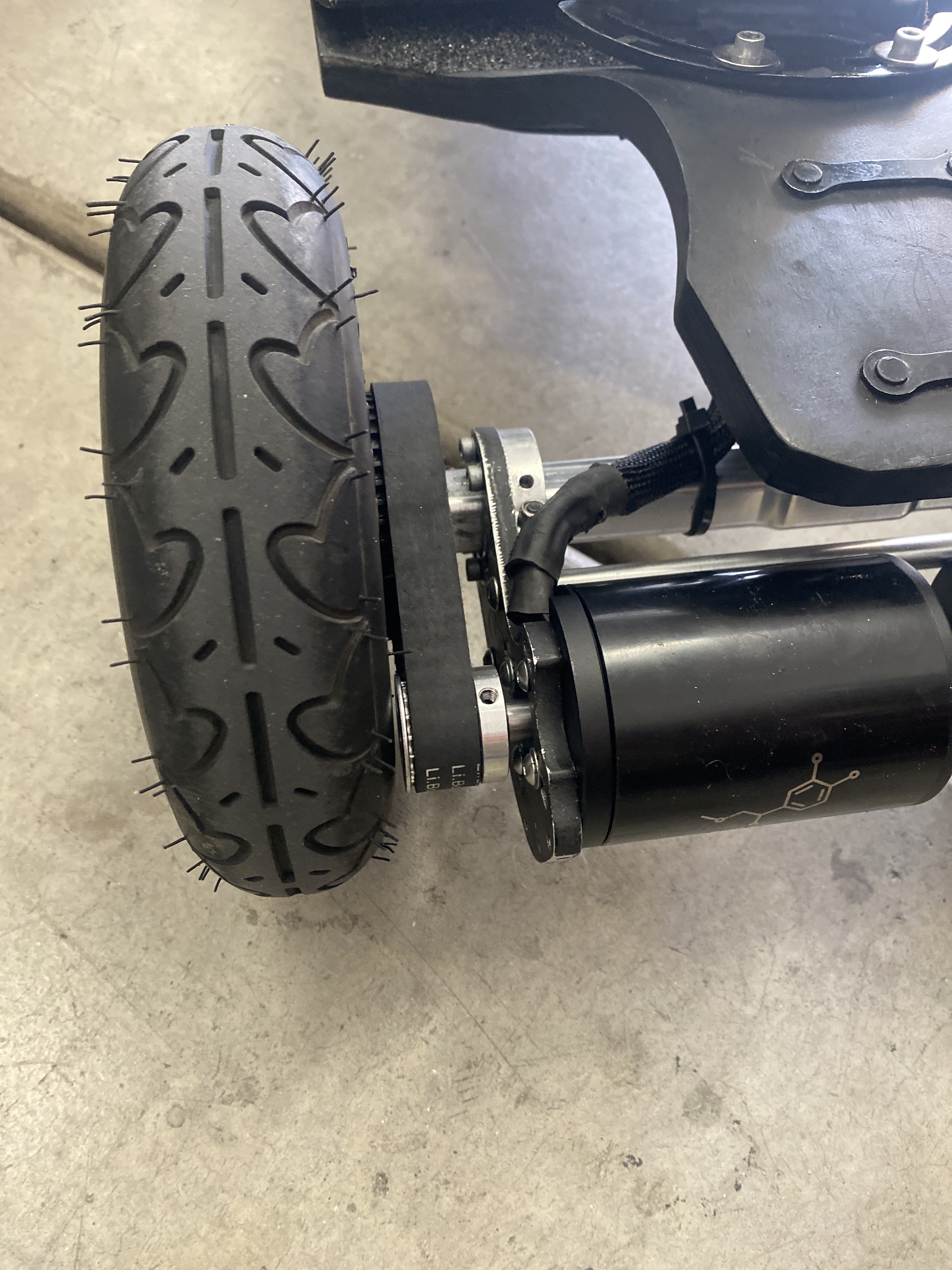

Super big thanks to @J0ker for the 16t pulley set.

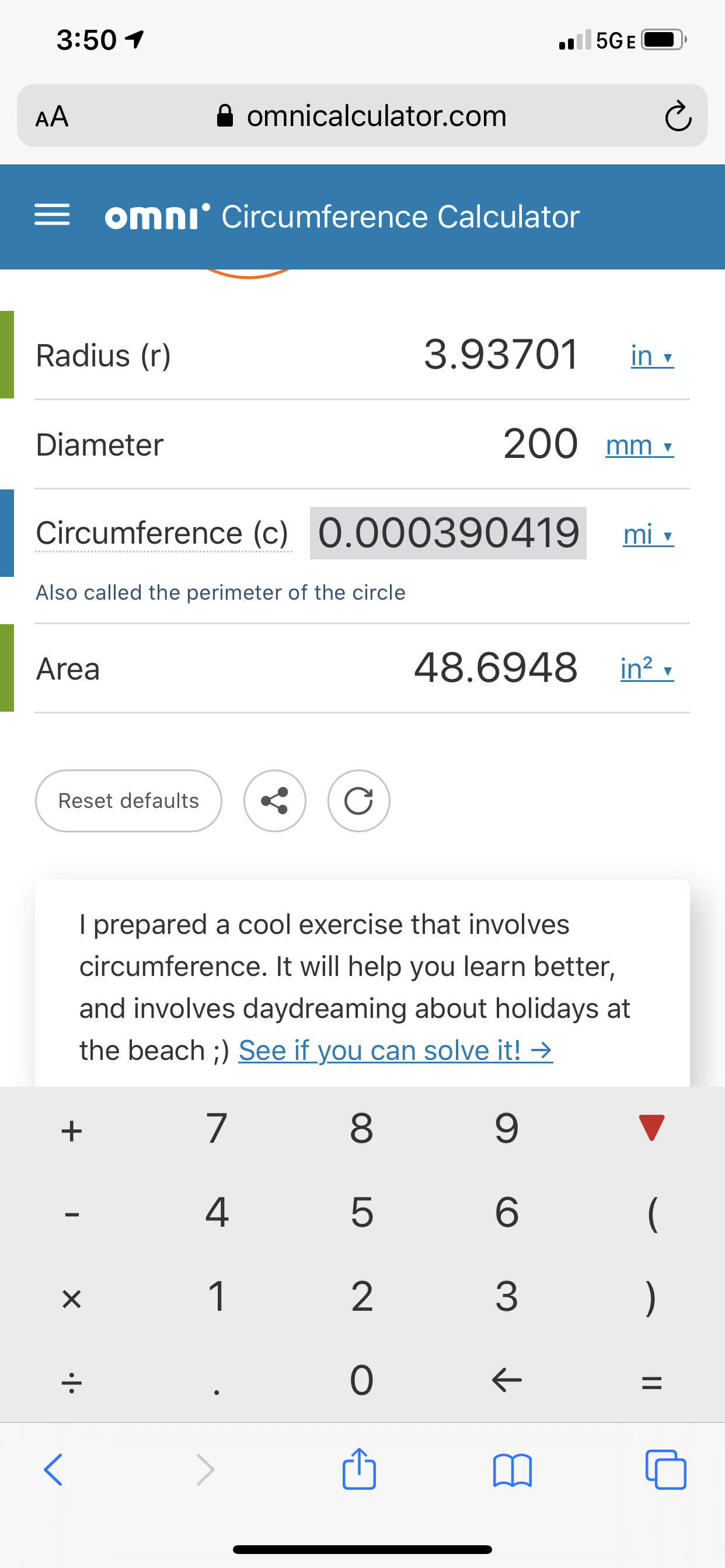

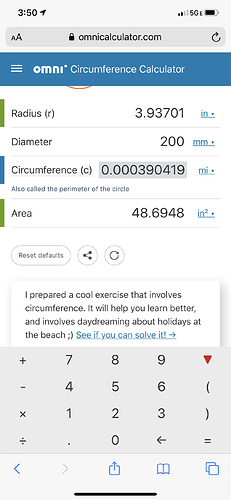

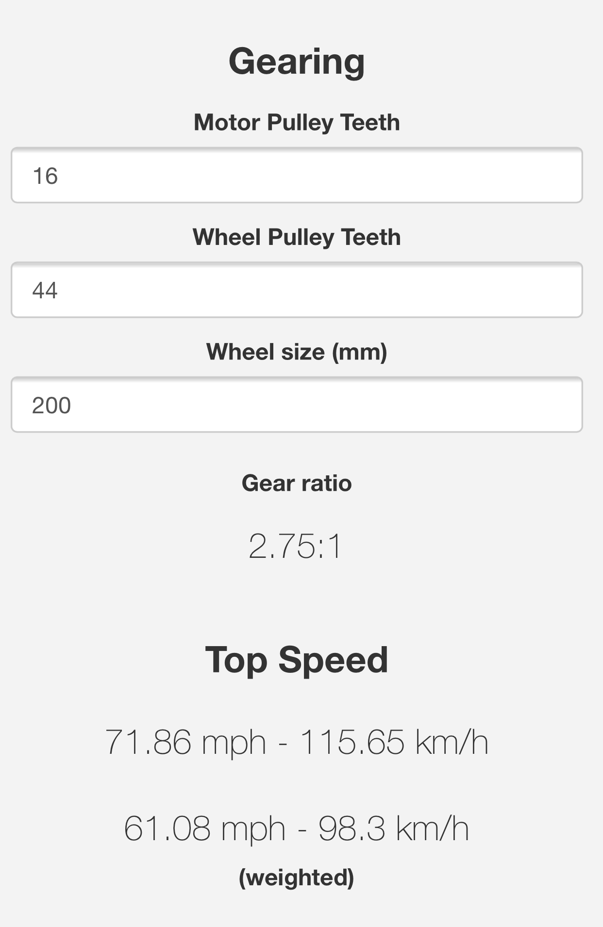

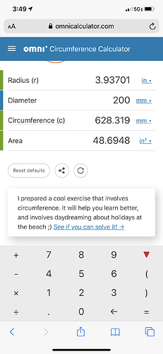

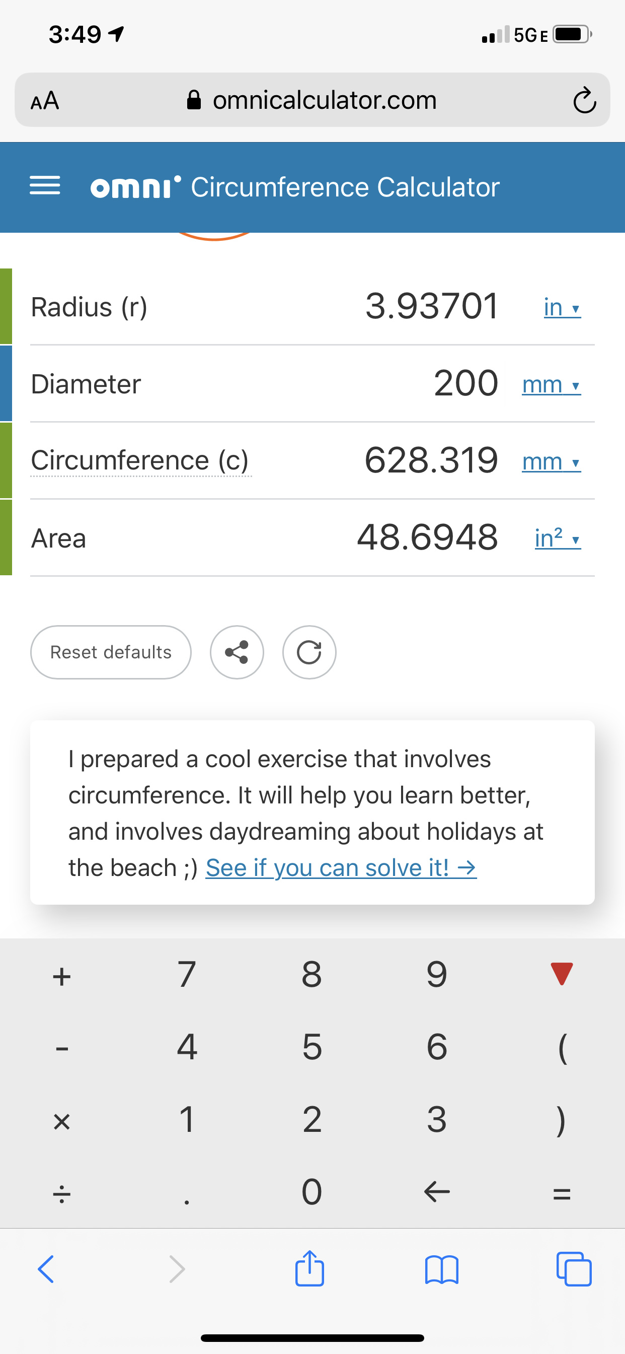

I guess I have a tape measure and I can measure the circumference.
“200mm diametr” haha

Why is the pivot so square?
are you planning on your truck F-ing you; is that why it has an IUD on it?
:smiling_face_with_three_hearts:
Jebus, that does in fact look like an IUD.
Mike if my trepanning needs a touch-up I’ll call you for rates!

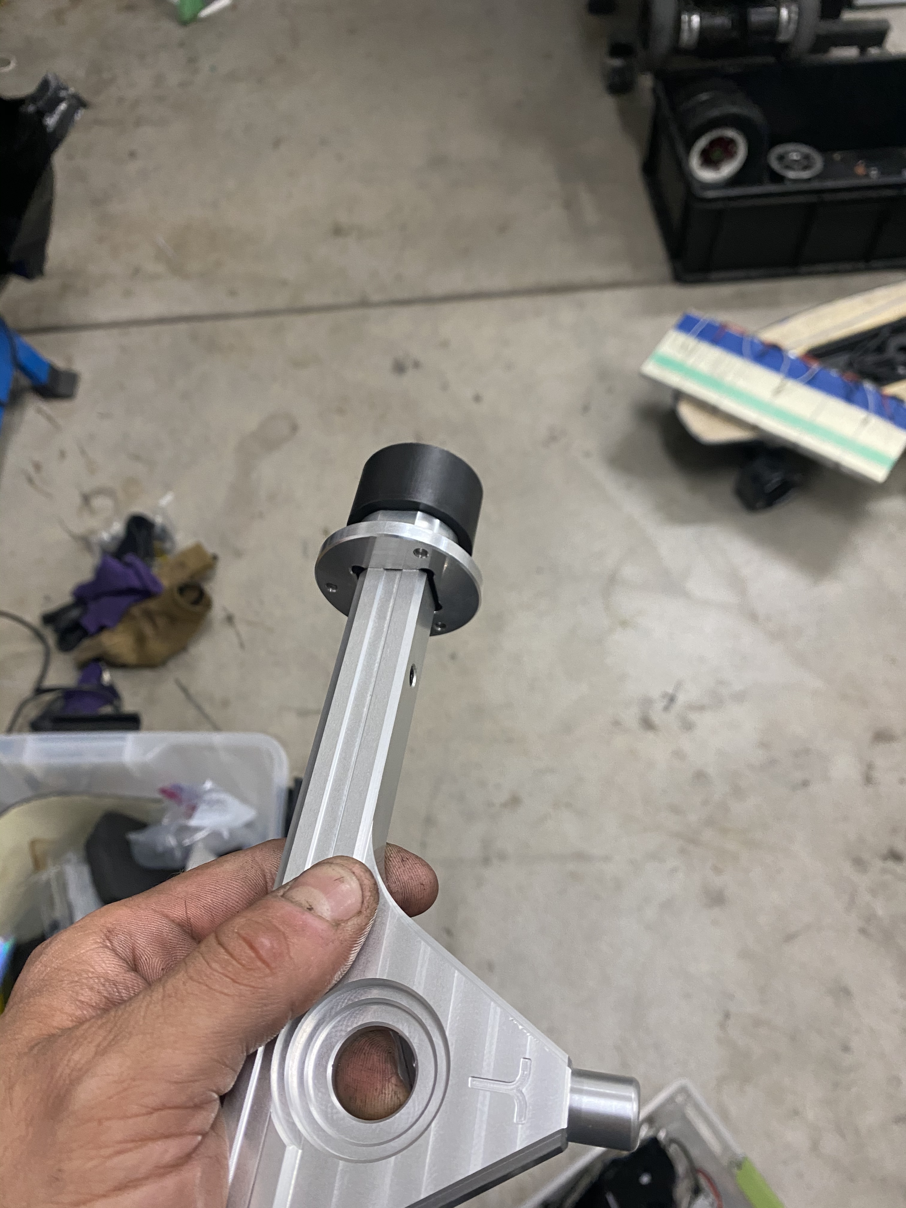

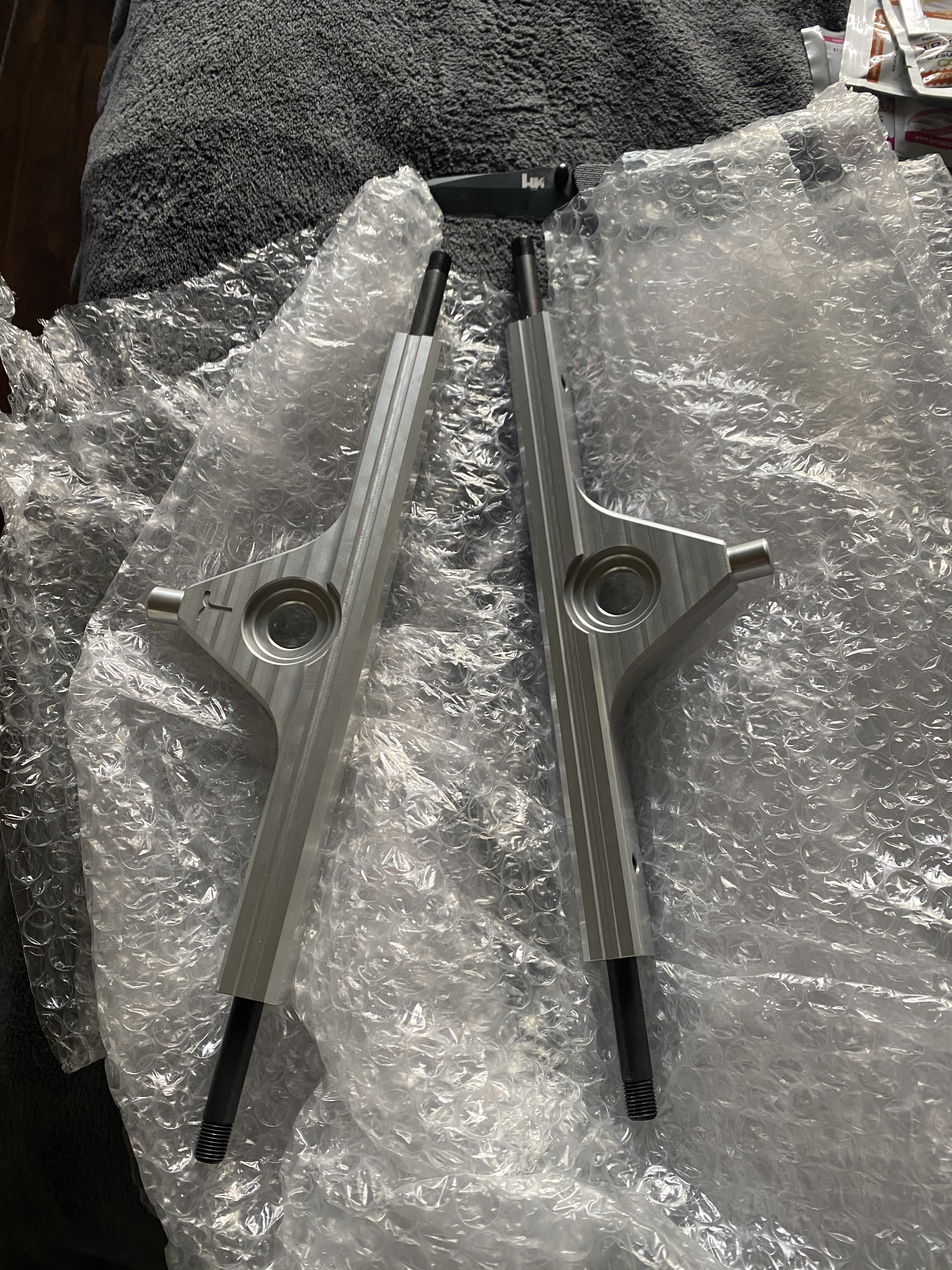

Dunno, it’s intended for their truck, not calibers
What brand is that? … Trampa?
It is. They have 9.525mm axles. I have the bearing sleeves to adapt them to kalynycs hellcat fatties. I’m going to drill and tap them from the board side like Surfrodz. I’m getting the rkp part machined off and a small seat ground out to match SR TKP geometry.
I spent some time looking at titanium bar stock. 15mm low grade stuff is readily and cheaply available on eBay.
I wanted 18mm of higher grade and that stuff is unbelievably expensive on McMaster.
I suppose I could have always had axles made to accommodate the larger angular contact bearings.
