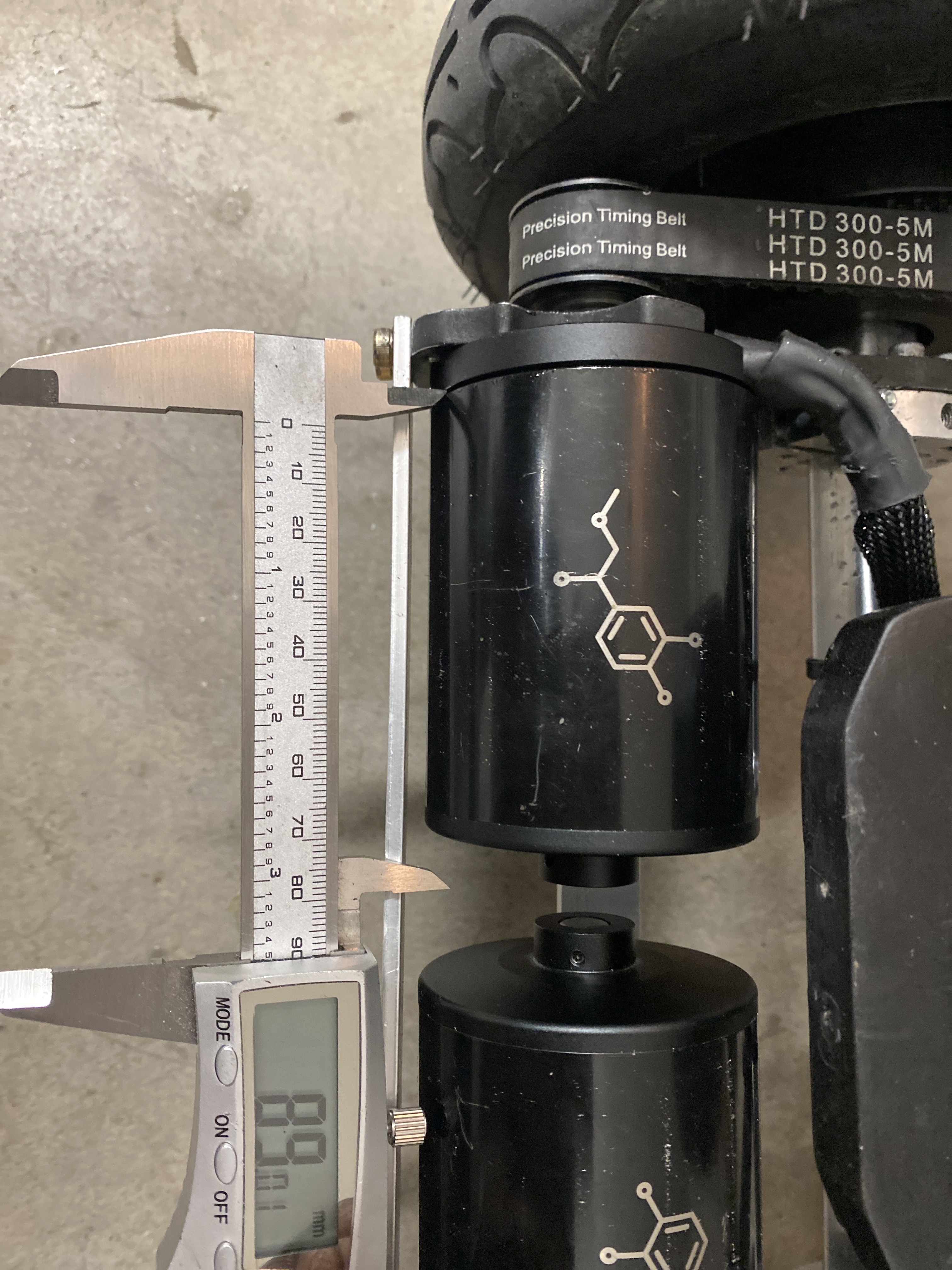

6389 x 8 | quad unity/stormity | 12s/18s tattu | RedEmber 44

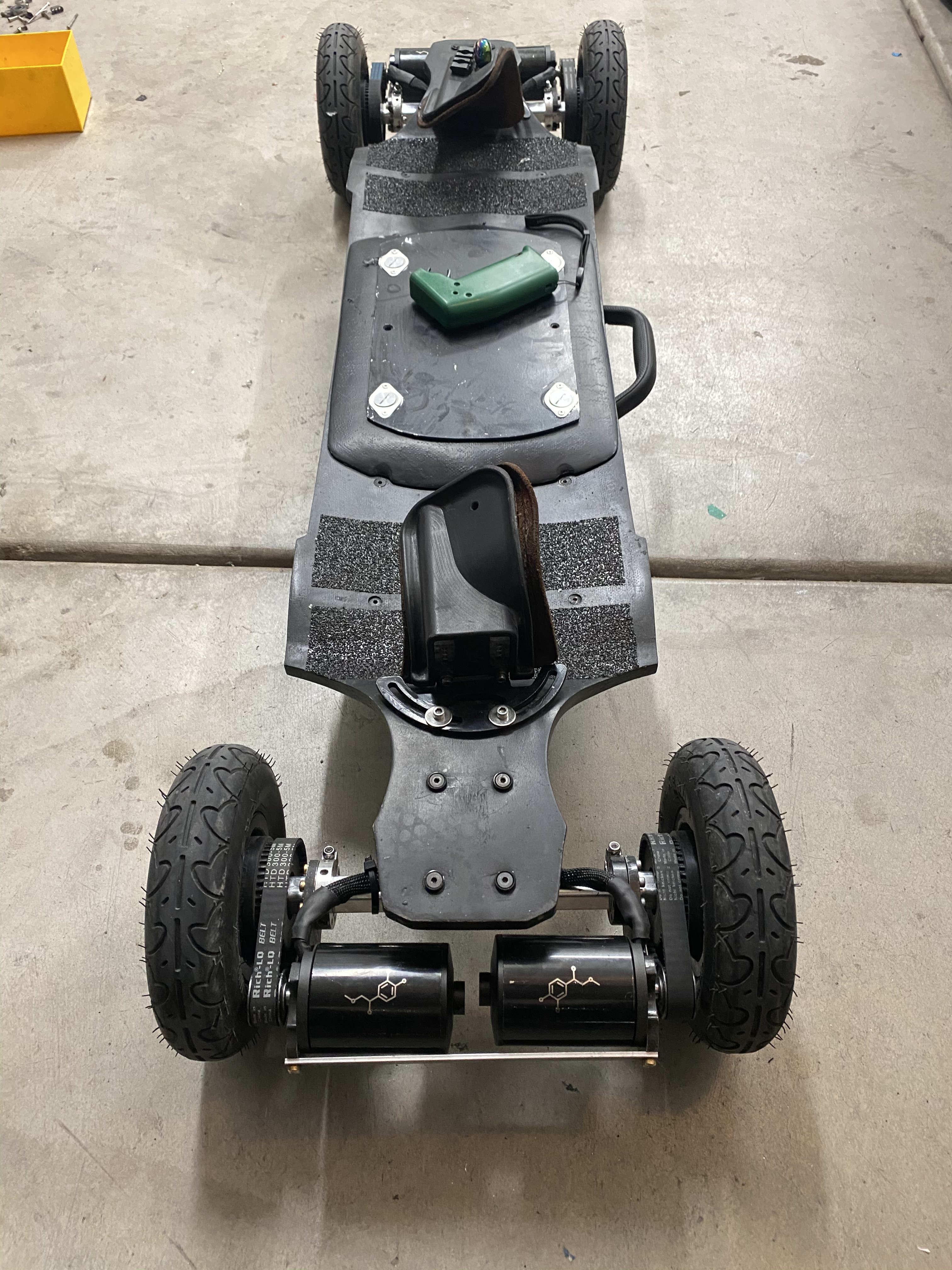

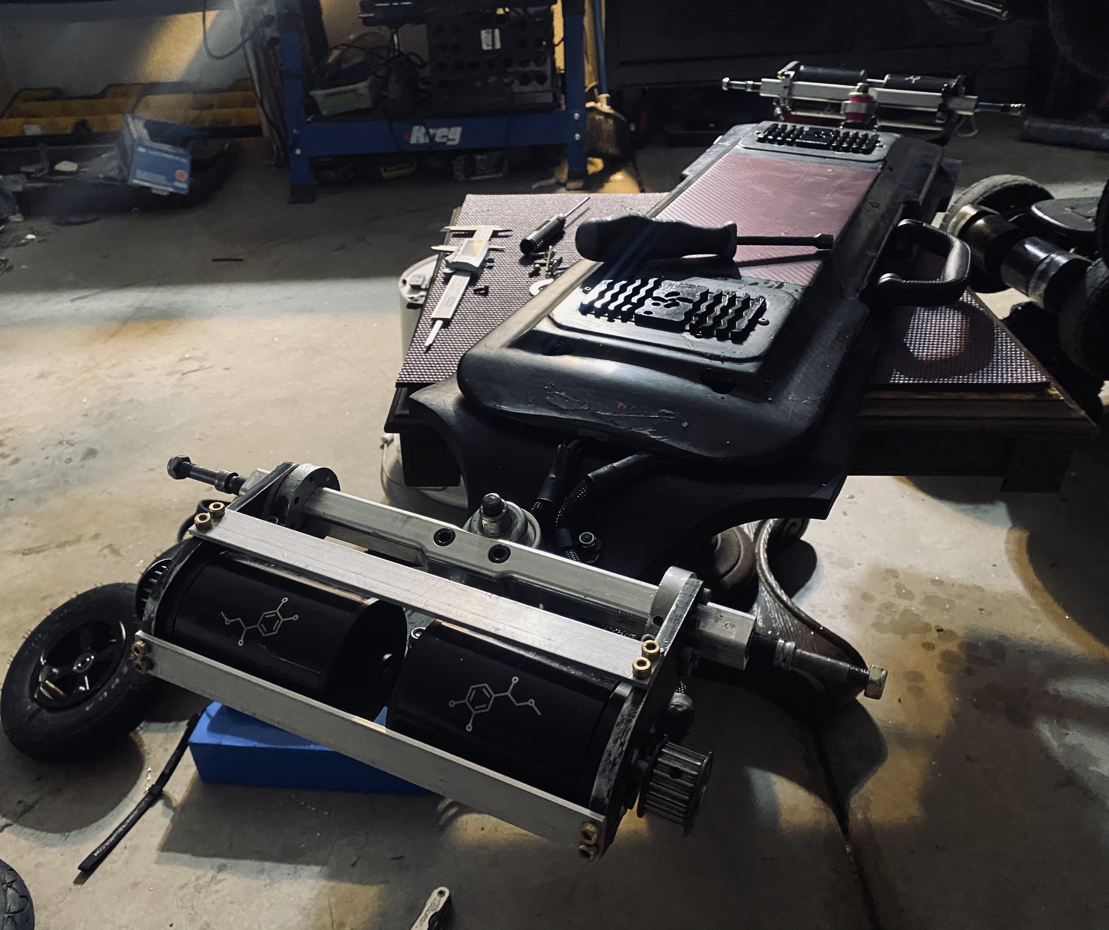

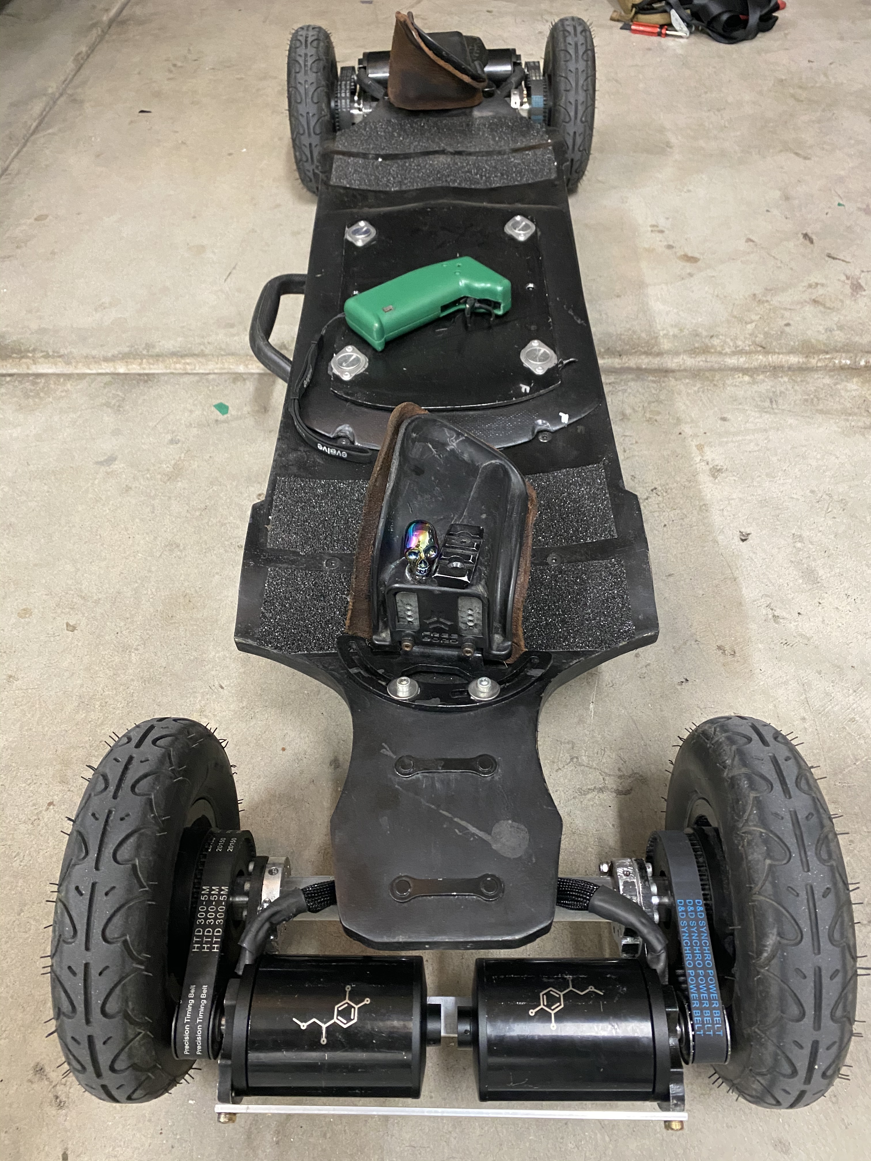

First run on 190kv 6389s from lacroix. 4x Outboard configuration, 18t/44t/200mm
Motors outboard is significantly more stable than inboard. Wasn’t the fastest run, but it was so punchy.
I’m not sure where second set should sit. High outboard, or low inboard? :thinking:
High outboard looks like it might require you to move the trucks back or chop the deck?
Those misaligned motors are triggering me dude.
That’s weird why outboard feels better then inboard… But that’s a 78.7mph unweighted top speed :exploding_head::crazy_face:
I think low inboard would look better and have better cable management… Also, if a motor mount loosens it won’t take out the other at the same time :grin:
I know, I know, I was racing the sunset. I’ve never used (Or made ) cross mounts before.
I’ll Cut slots for them and use steel or thicker aluminum.

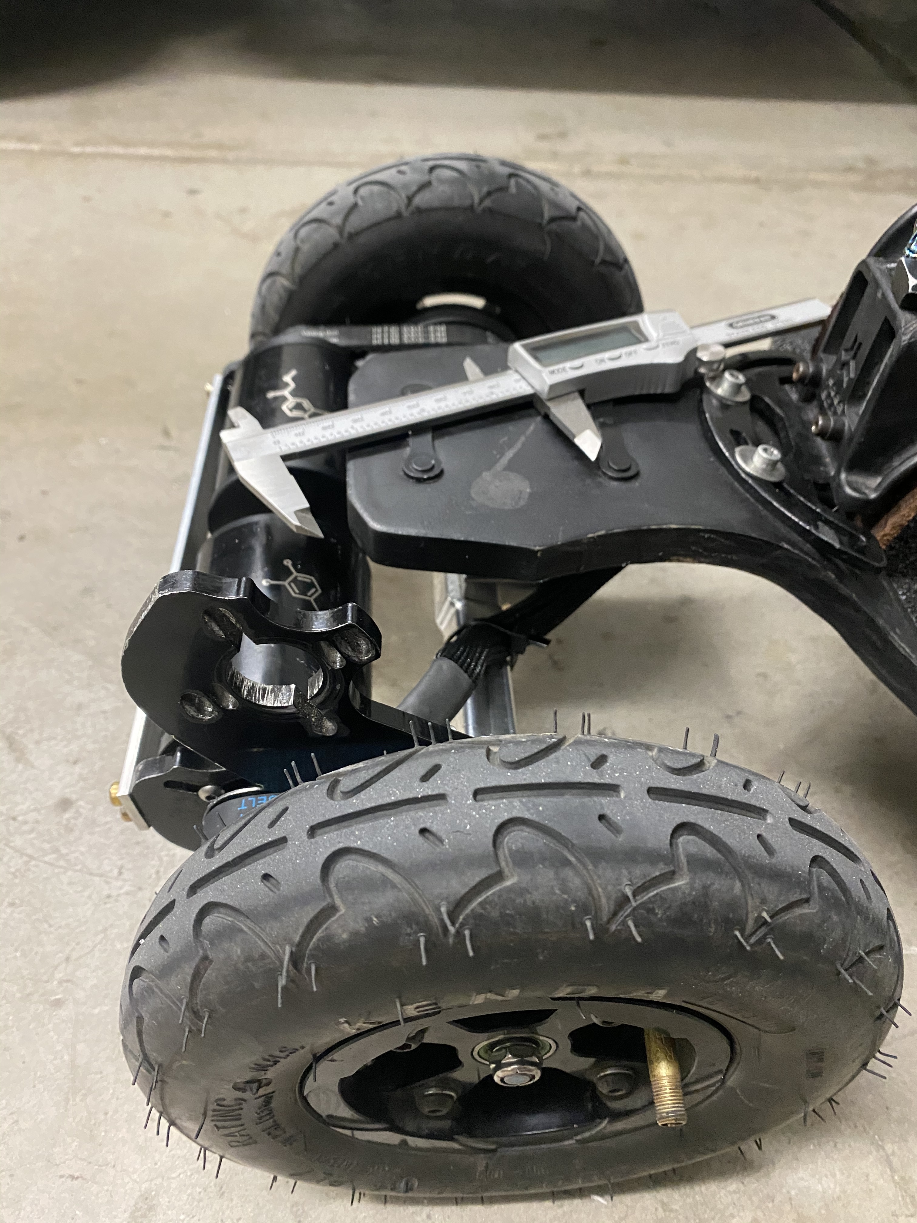

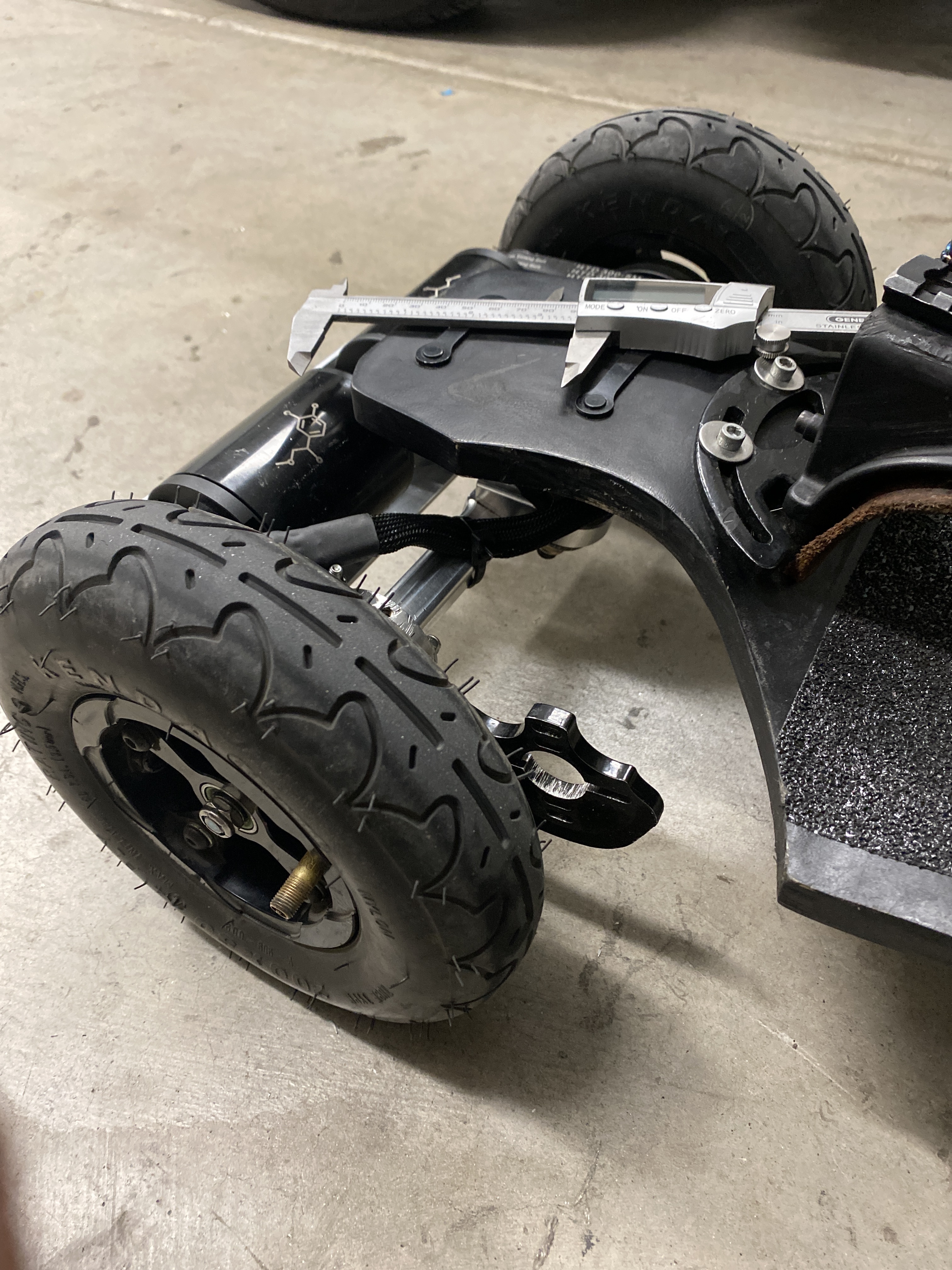

I’m ok with some chop action. I think that’s preferable to moving trucks out. As it is, I need to add some reinforcements to the necks. :call_me_hand:
If you mount them inboard, are the motors lower than the hanger and/or enclosure?
Inboard seems more balanced, at the risk of motor damage
There are always steel threaded rods
They are a few degrees above horizontal. Enclosure isn’t any were near. About on the same line tho.
Could you bolt a little aluminum or something plate under the inboard motors?
Could protect them more :man_shrugging:
I’m kinda liking the inboard option. Balance seems like it would be important here.
I think so too. Belts may not be viable. I ended up
With a 4x set of @CiscoV Janux spur drives. I bet designing A double motor mount plate for his drives (and most others for that matter) wouldn’t be to hard.
