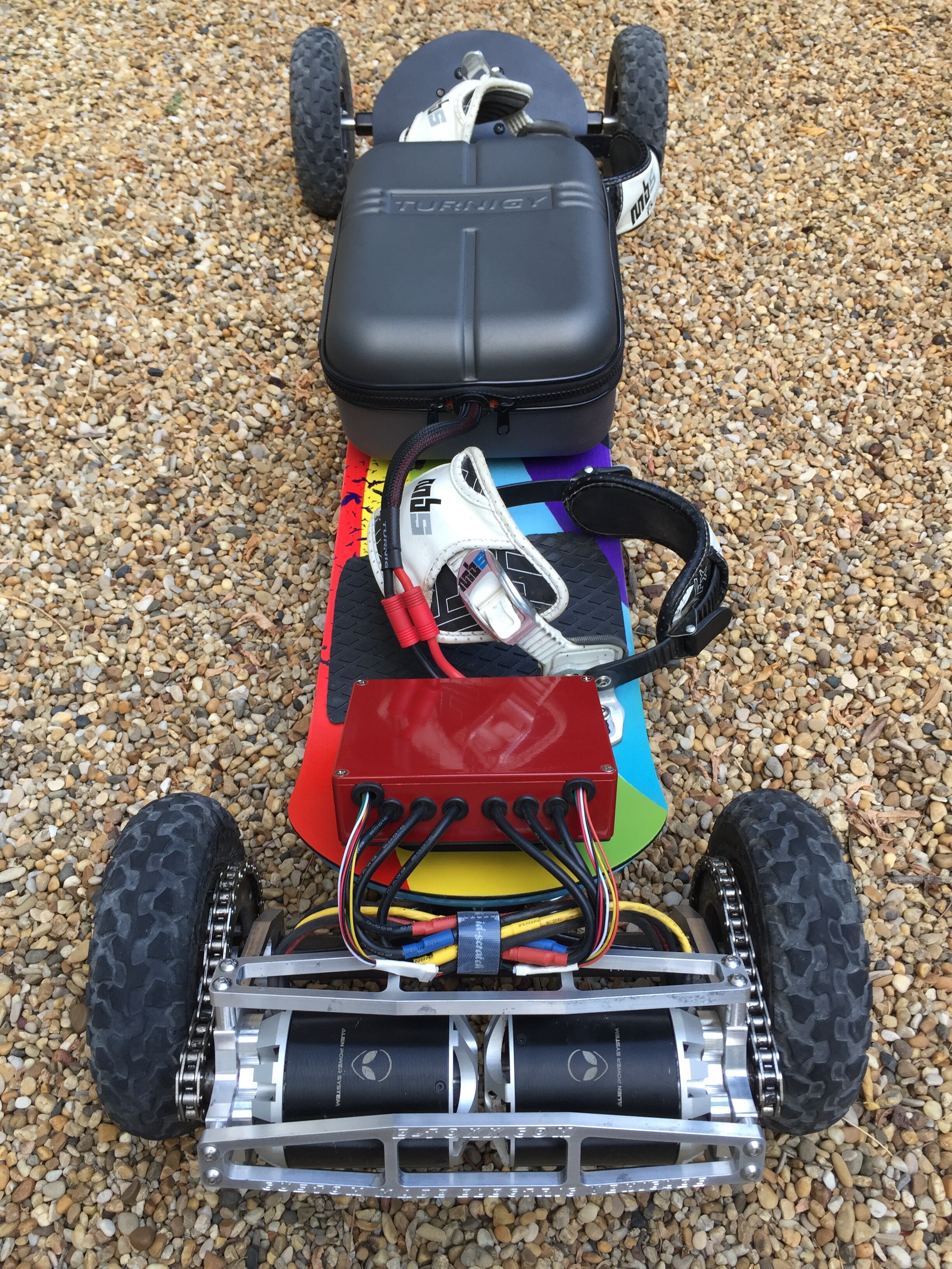

- 6374 Turnigy sk8 192kv 12S 8/40 :
- 80100 APS 130kv 12S 10/35 :

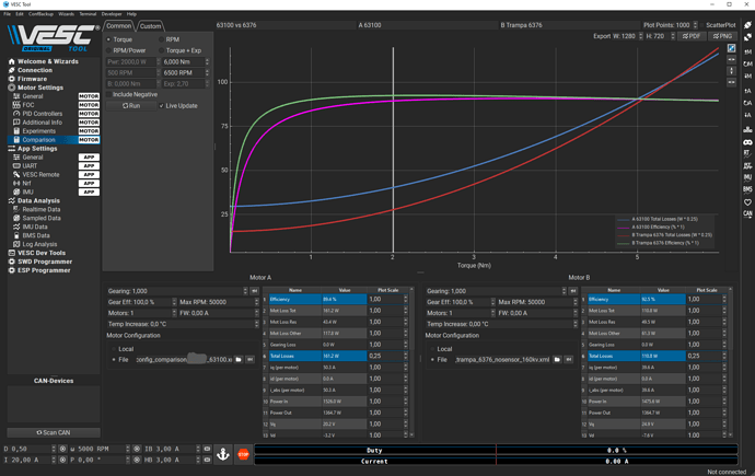

We did a quick motor comparison today. 63100 vs. our 6376 motor.
Things to note: Motor sizes differ quite a lot. The Trampa 6376 has a rotor support bearing in the front of the stator and that space can’t be used for stator length. Also the rotor diameter is smaller (64 vs 59 mm).
  • The 6376 has a smaller stator (shorter and less diameter) and weighs 960g. No load current 1.2A
  • The 63100 has a bigger stator and weighs 1350g (+40% compared to the 6376). No load current: 4A
We were quite surprised to see that the smaller motor outperformed the bigger one.
Less amps for same torque, higher efficiency, much lower losses.
Just at the very edge (at around 5.5Nm torque) the bigger motor becomes slightly more efficient.
The difference in resistive losses is negligible.
How is it possible with so much more copper mass on the 63100?
Design of stator, maybe lamination thickness, steel used, copper used, shorter stator teeth (bigger bore), magnets, airgap… Could have many reasons. Vedder compared quite a few motors in the past and such results popped up a few times.
We also tested some inrunners of the same size and some were a lot better compared to others, although the physical design was not so much different on the first glimps.
