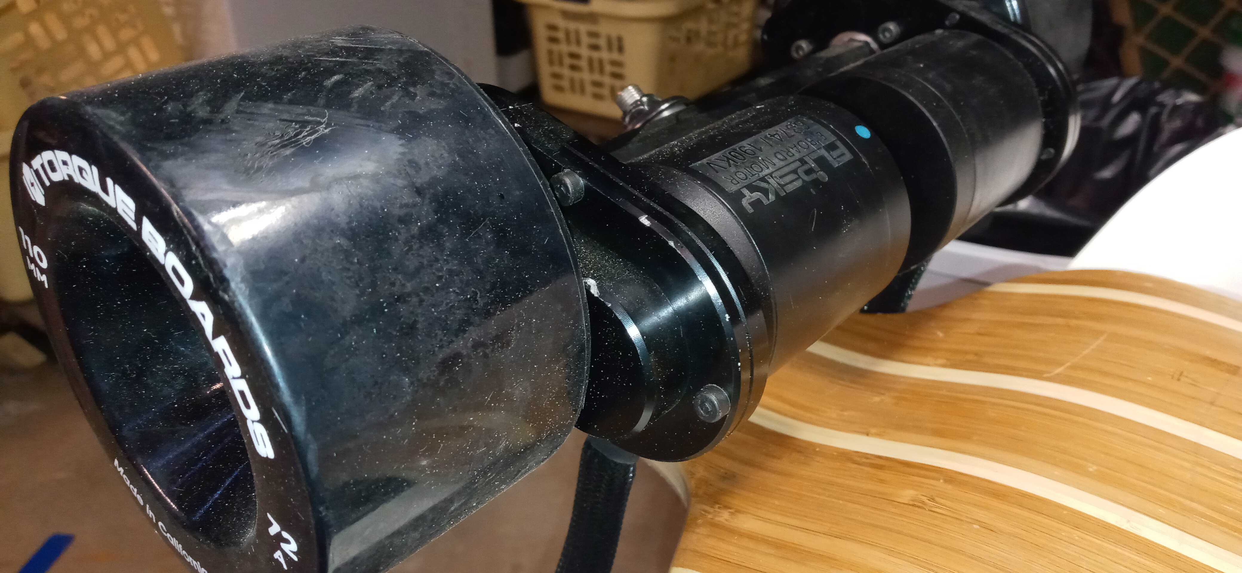

6374 is too small
80’s are what i want to do. I haven’t done anything that big before
Those look like 72T pulleys, you have a clue what motor pulleys you have? might be able to shave a few T of off that to get a bigger ratio.
Unless you pull max battery amps this most likely wont be needed.
13t is what i counted
Thats ~ 1:5.5 ratio. 1:6 would be the next step but I would be worried about belt skipping. Maybe the step after that would be bigger, lower kv motors or 4WD like mentioned before. What are your motor amps set to?

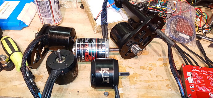

I have a couple unity fobox a?coupme of spintends and assorted motors
I can but upgrades. It has to be top of the line. That’s all.

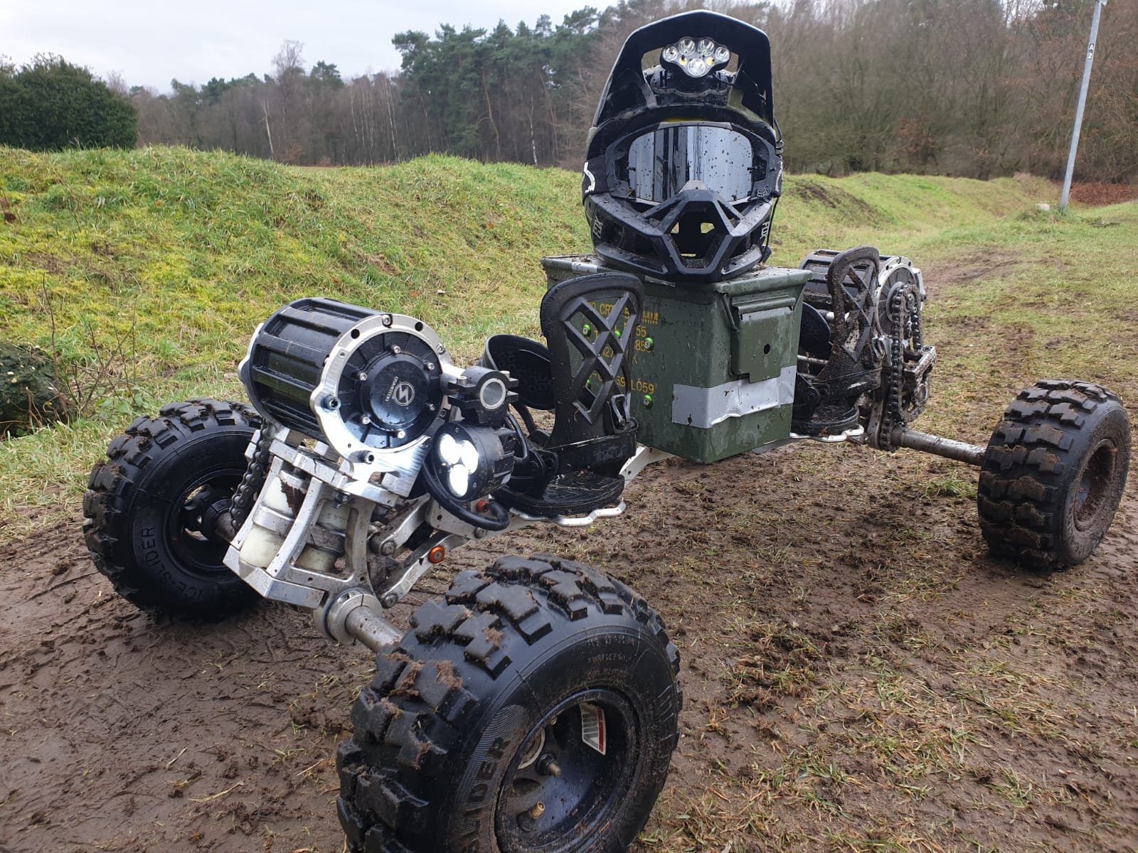

Big enough?

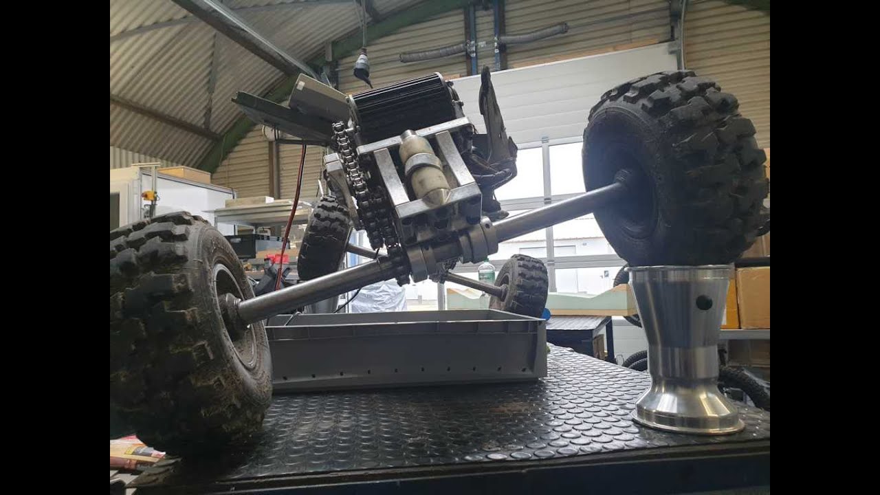

What’s inside of those and how big are the motors?
This is the new beast from e-toxx :slight_smile:
I don’t know the specs.
That toxx is brutal. How much? How can i score one?
I think it’s only 9999€.
$1300. Ill take one.

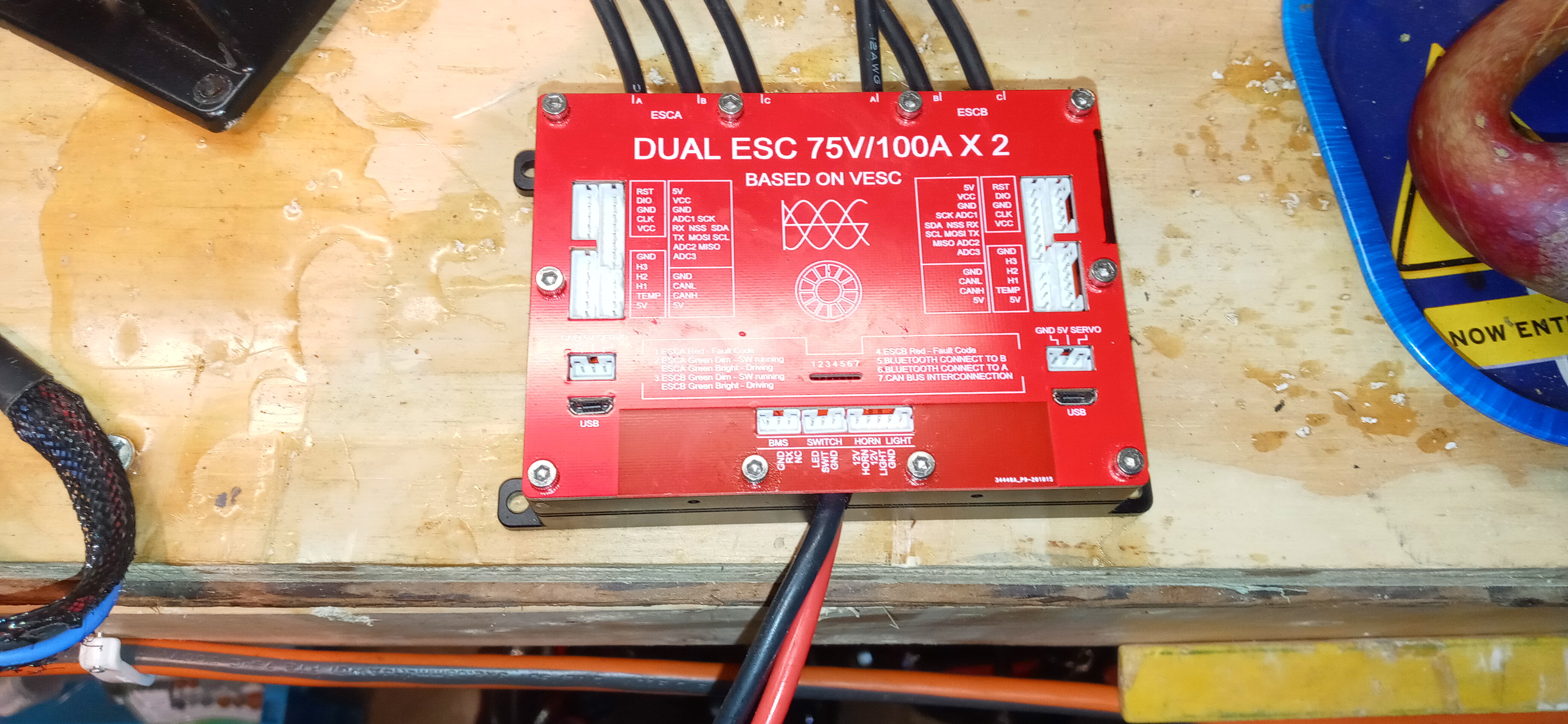

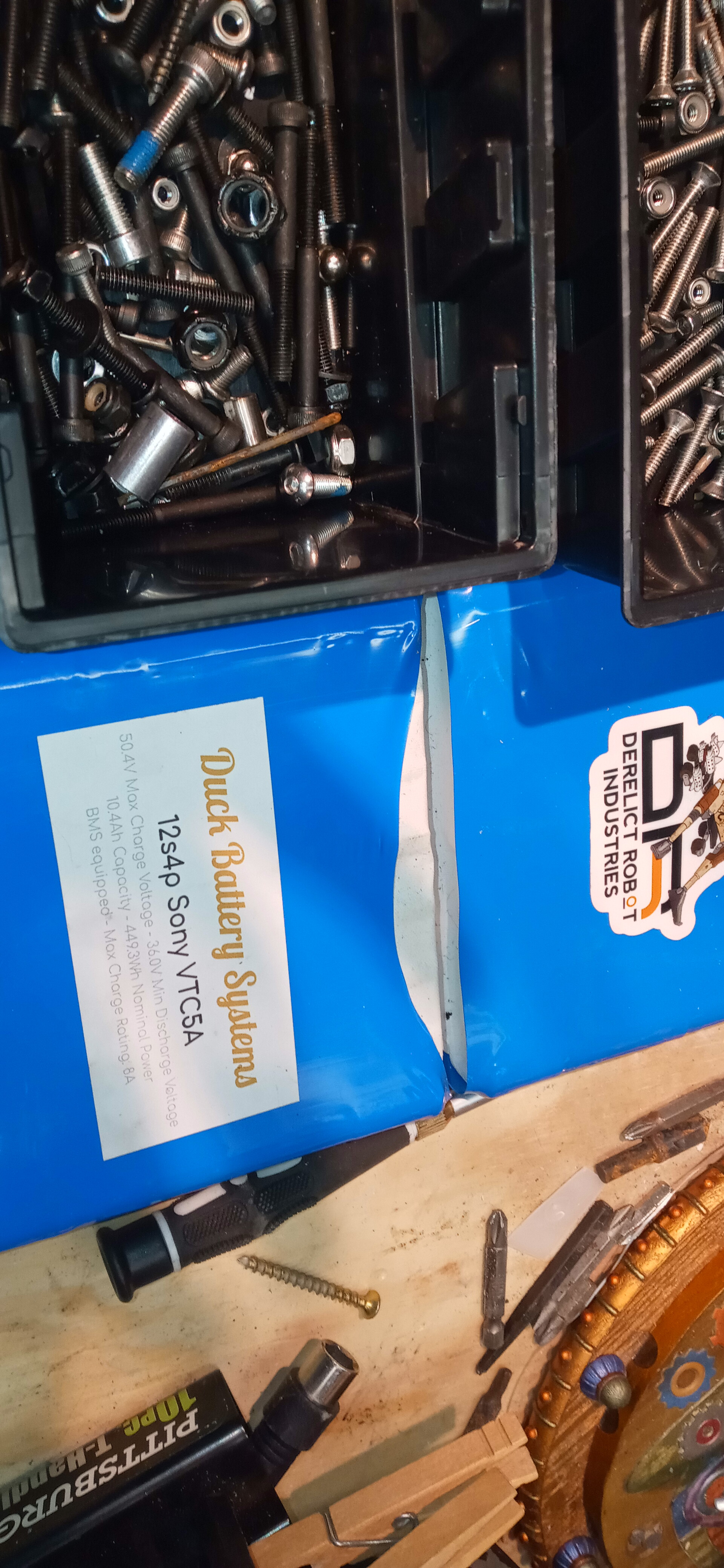

You definitely need to get him a way bigger battery. Big motors do nothing if the battery and escs can’t support the right power.
Edit: if it’s 4-5p high C lipos than it’s fine thou :sweat_smile:
