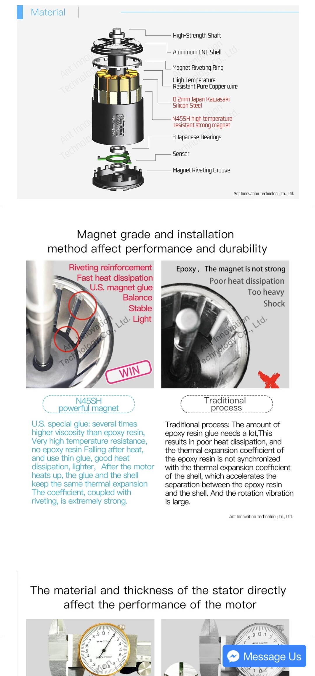

Can we just cringe a bit at “magnet glue and circlip” innovation?

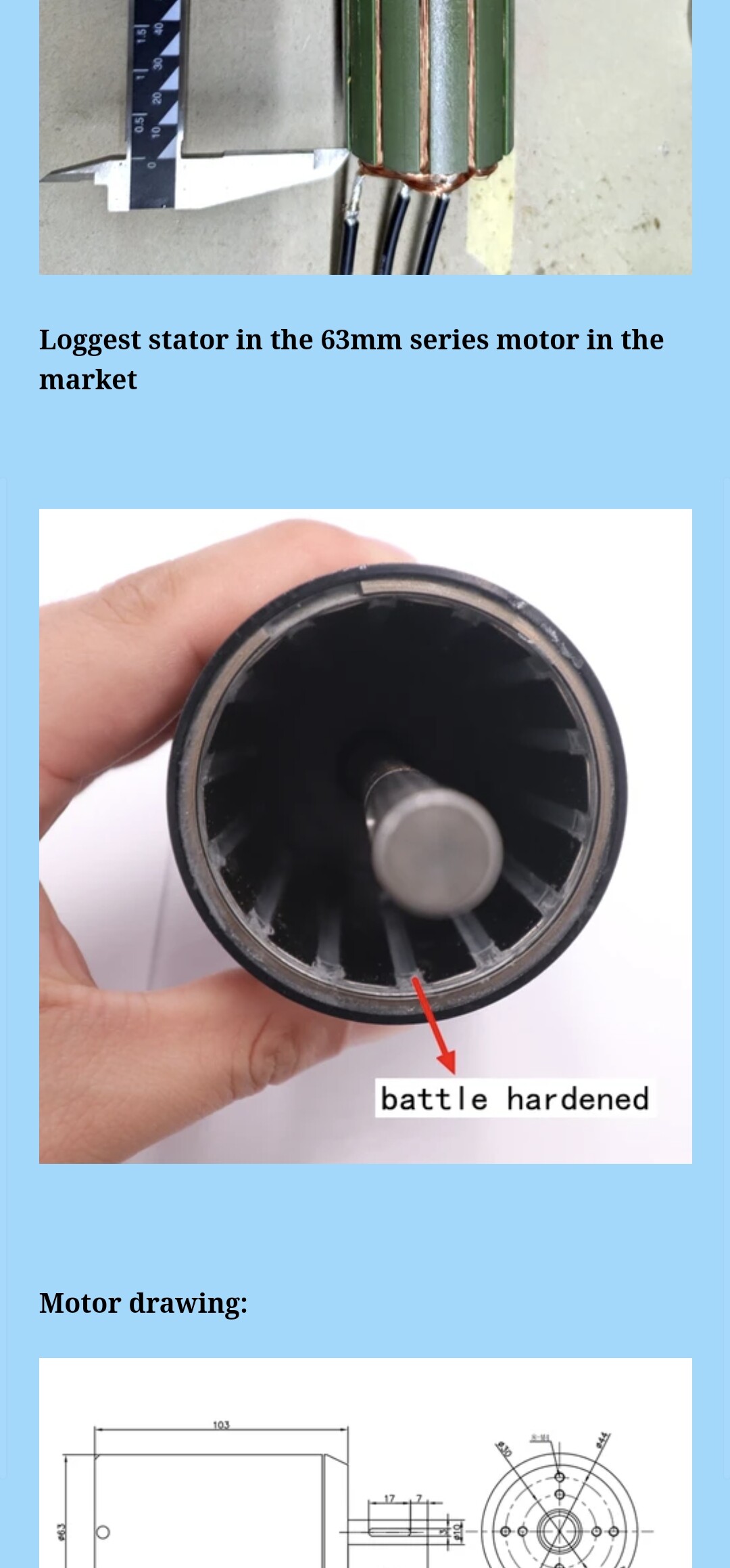

40 usd more expensive than freerchobby (who says battle hardened, plain and simple), coming from the same factory, but they brag about not doing what it’s already tried and tested for years in esk8
Freerchobby pic:

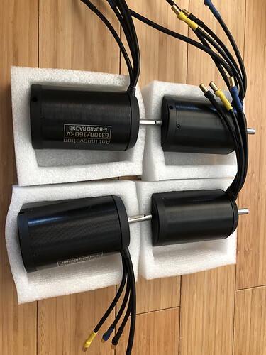

i snagged 4.
waiting on drives.
will be dropping them 1/4 with 9inch so they will get a proper spanking
Nice man, are you doing a 4wd build with those?

How do they feel in hand? Do all spin freely? Have you ran detection and full unloaded speed on any?
