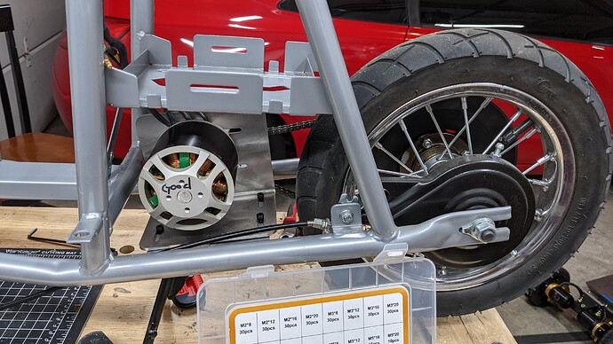

50mph razor scooter build using esk8 parts

the fork looks like it’ll obliterate on impact with a pothole at speed…
Idk why but this makes me excited lol. I’m gonna thermally adhere the esc to the frame for better heat dissipation

Just purchased a zenith from @KaramQ !! Can’t wait to get this thing running
Is it a 80mm?

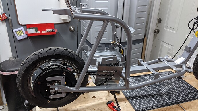

Yeah I’m pretty sure it is. Also I added pics of the frame to the original post
Won’t you have it already built in to the system or is it a freewheel cassette in the rear?
Bingo bango
Damn scooters. Ironically I had the same issue with my scooter-3sk8 monstrosity and found the esk8 forums while looking up how to add regenerative braking
Where do you plan to put the battery and electronics? On the footrest or under the seat (seem kinda right).
yup
Yup what lol. Where is it then?
Edit: I meant kinda tight. But I guess is under the seat then
Under the seat, sorry I misread your comment

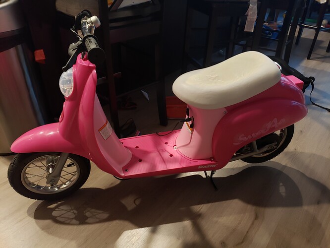

So, in theory, my Sweet Pea should be able to go even faster since it’s a light red color, correct? Cause I need to show up that little girl that laughed at me at the park today. :sob:
:smirk: however you look at it, thats pink… :grin:
The little girl was obviously jealous of your barbie scooter.71Vc-zyU64L.AC_SX425
Actually, I think her dad was the jealous one. Because right after his daughter laughed at me, he goes “that’s awesome”. :smirk:
And I guess you could call it pink, if you want to be a dick about it. :stuck_out_tongue_winking_eye:

Little update. The motor mounts are in. I must’ve been high when I ordered because now I have 2. If you have this exact scooter you can have it for the cost of shipping lol
Now I really need a 12mm ID sprocket that works with #25 chain with the lowest # of teeth possible :persevere:
Please tag any chain pros if you know em
