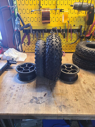

or up a size as well.
Size of what?

Size up of tire. Switch to a 9" or even 10" tire. The difference in contact patch and roll is staggering.
(Not my picture, but that’s a regular 8" tire and a regular 9" tire)

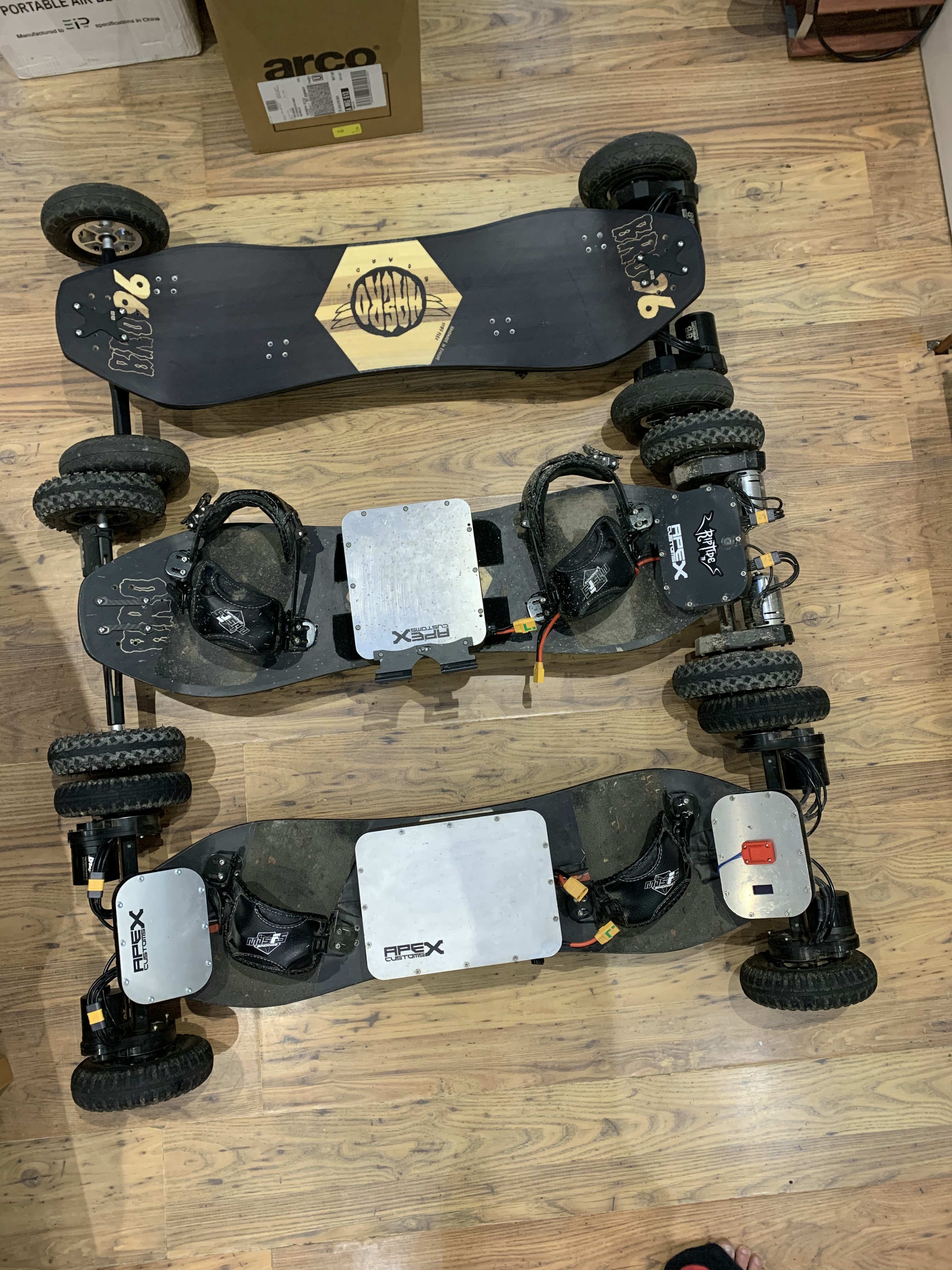

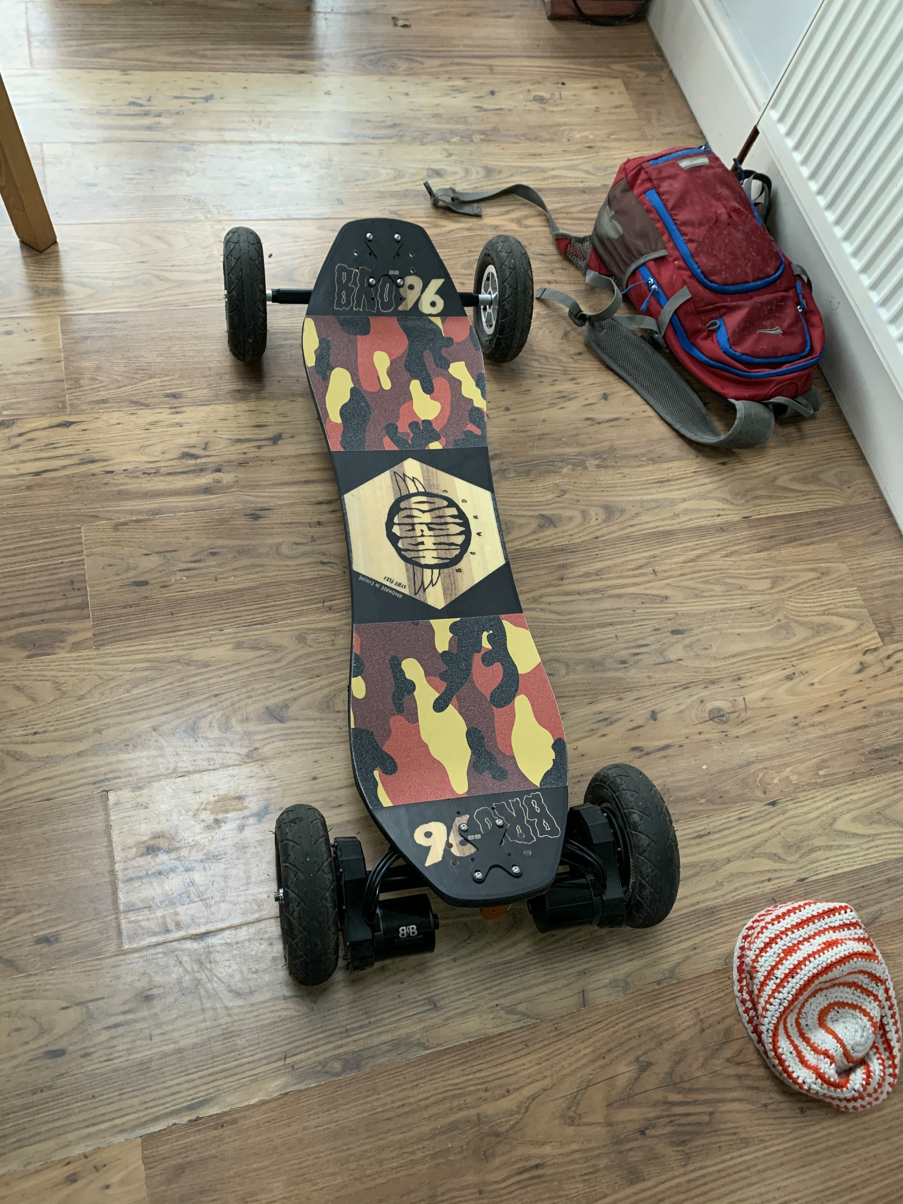

Here some of them are, lined up. When the tracks get steep, loose and bumpy the 4x4 is the one. The lightweight mtb for leaving the ground and chucking about and the carver for tearing up the pavement. The carver tops out at not much over 25 and it has oodles of grunt.
Very nice. From the descriptions, the 4wd rings closer to what I want. Leaving the ground sounds lots of fun, but dangerous. The lightweight is the one up top? What is the 4th one down below then?
Wow what a difference 1 inch can make (twss)

That’s the carver again but with grip tape on it! Lightweight one in the middle.

I could have figure that out, now I see the 96…
