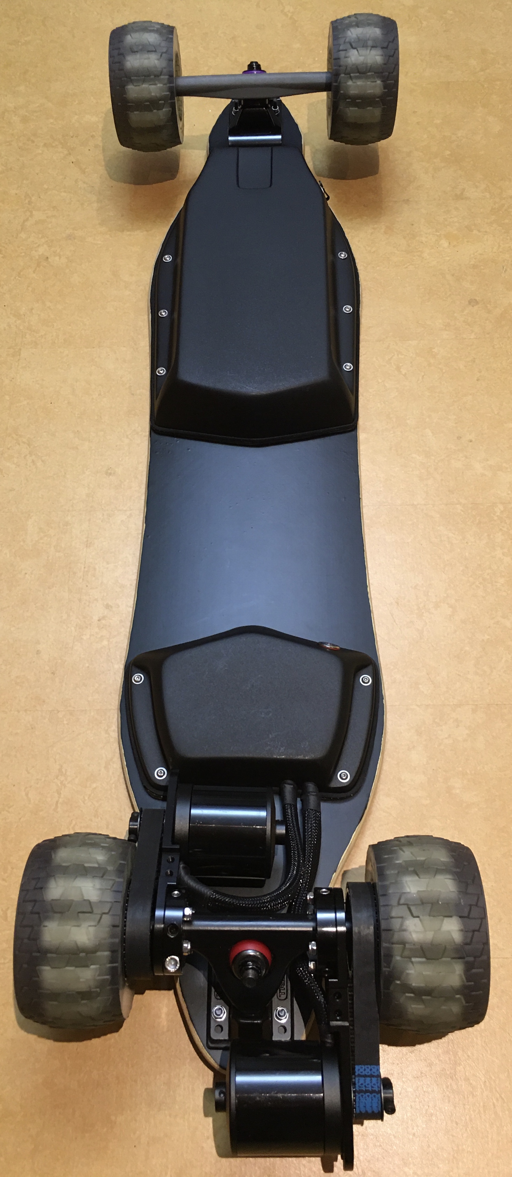

That’s what I got so far.

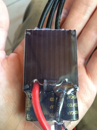

I wouldn’t go all in on a Flipsky package. They have notorious QC issues. However, I have had good experiences with some of their products. Their newest 6374 motors are great and I believe they are on-par with the other options you are considering. However, roughly half of the remotes and ESCs I have purchased of theirs have been duds or have shown issues that make me no longer want to use them.
If you can order from Amazon and have an easy way to get a refund/replacement if it doesn’t work just right, I think their stuff is worth more than what it sells for. I have a pair of 4.12FESCs that have been working great for going on two years of heavy use, but the first pair I received popped within a week at only 30 amps. I definitely wouldn’t want to have to get in line with their customer service department if I purchased directly and received a turd. Also shipping times for replacements would suck.
Motor current is what determines the power of your motor. A 6355 at 50A has the same amount of power as a 6396 at 50A. The only advantage of bigger motors is that they can take more power before they get hot because they have lower resistance and can radiate more heat. When your total power is spread to 4 motors anything over 6355 is only additional weight for your setup.
If you want to keep those narrow trucks you can’t fit air tires or 2x6374 next to each other. You could do a diagonal mount one motor to the front one backwards like I also did on my board.
Maybe one motor at the front truck one at the back truck.

Flipsky vesc also have improved. I only had one out of 20 vesc die in my local community. The flipsky 4.20 have been improved with the help of some forum members and even come with a TVS diode preinstalled.
I like to buy them on Banggood because they have good customer service.
Maker X 4.20 or 6.6 are probably better quality tough.
