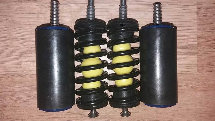

Measure the length of the spring with retainers Springs for Trampa trucks are about 74mm long and 30mm in diameter. dampers about 67mm long and 32mm in diameter. So I guess the space between hanger and baseplate is about 65mm but I don’t know exactly.

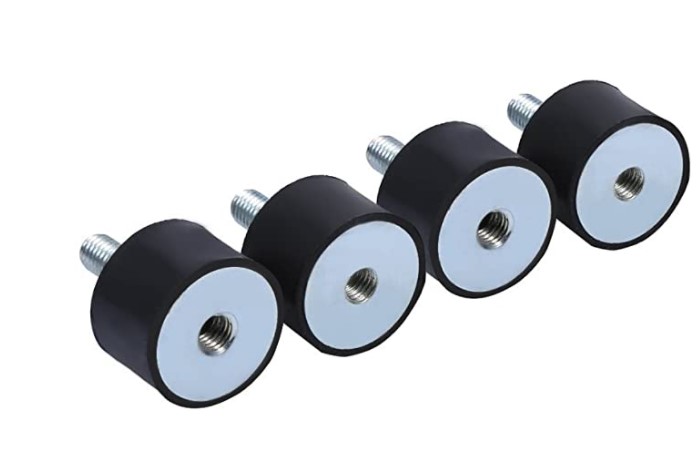

I’ve been looking into Trampa barrels. All they are it seems is pieces of nitrile rubber (NBR?) cut to length and 32mm diameter. I’ve been looking were I could get a large piece and just cut it as Trampa’s are 50 quid + shipping per truck, so 100 for 2.
There’s a scrap shop 5min from my place that has tons of these for pennies
wondering if I stack enough of them they’d do the job just the same
They’re urethane compound i’m afraid. If you go to trampa trucks you’ll also need motor mounts for them, but the barrels as an upgrade when buying the trucks are only like £10 more.
