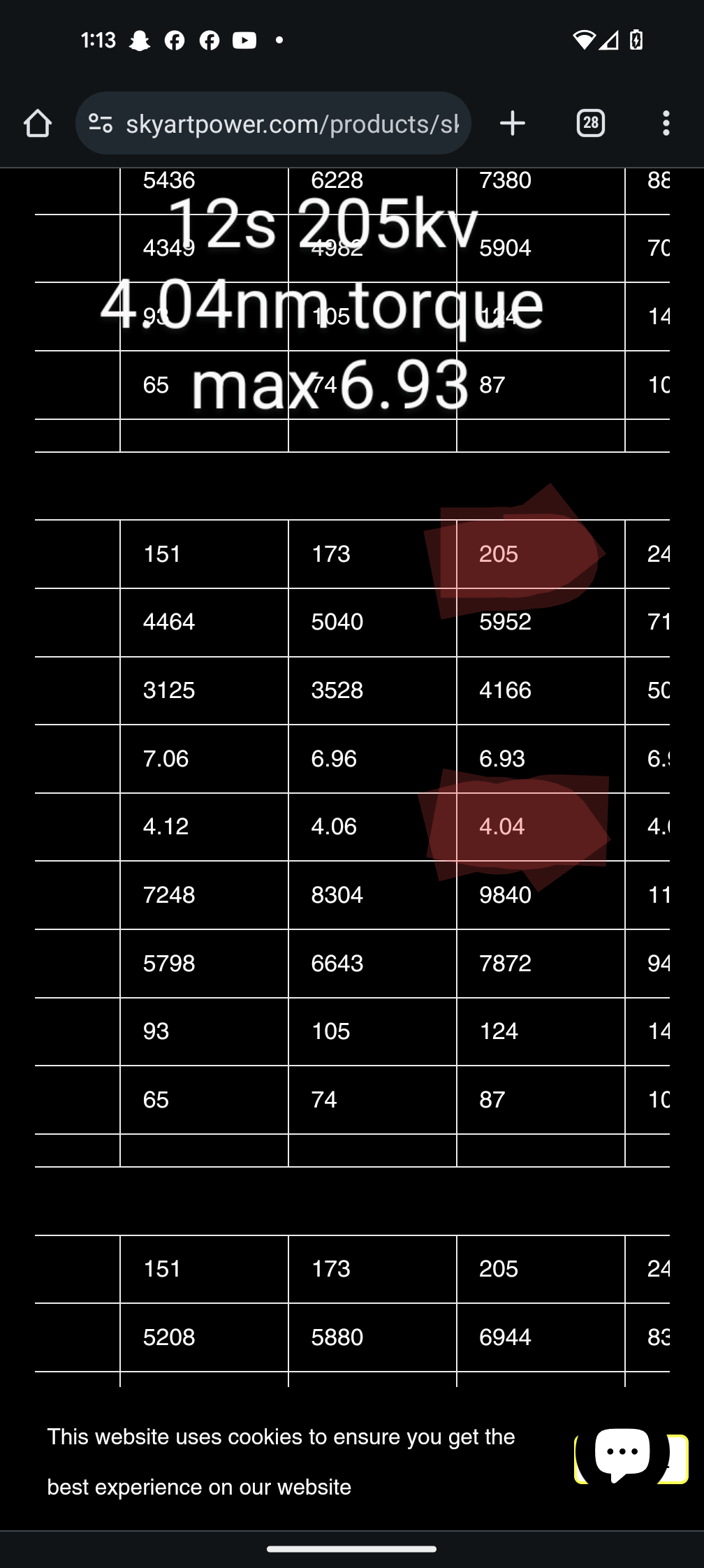

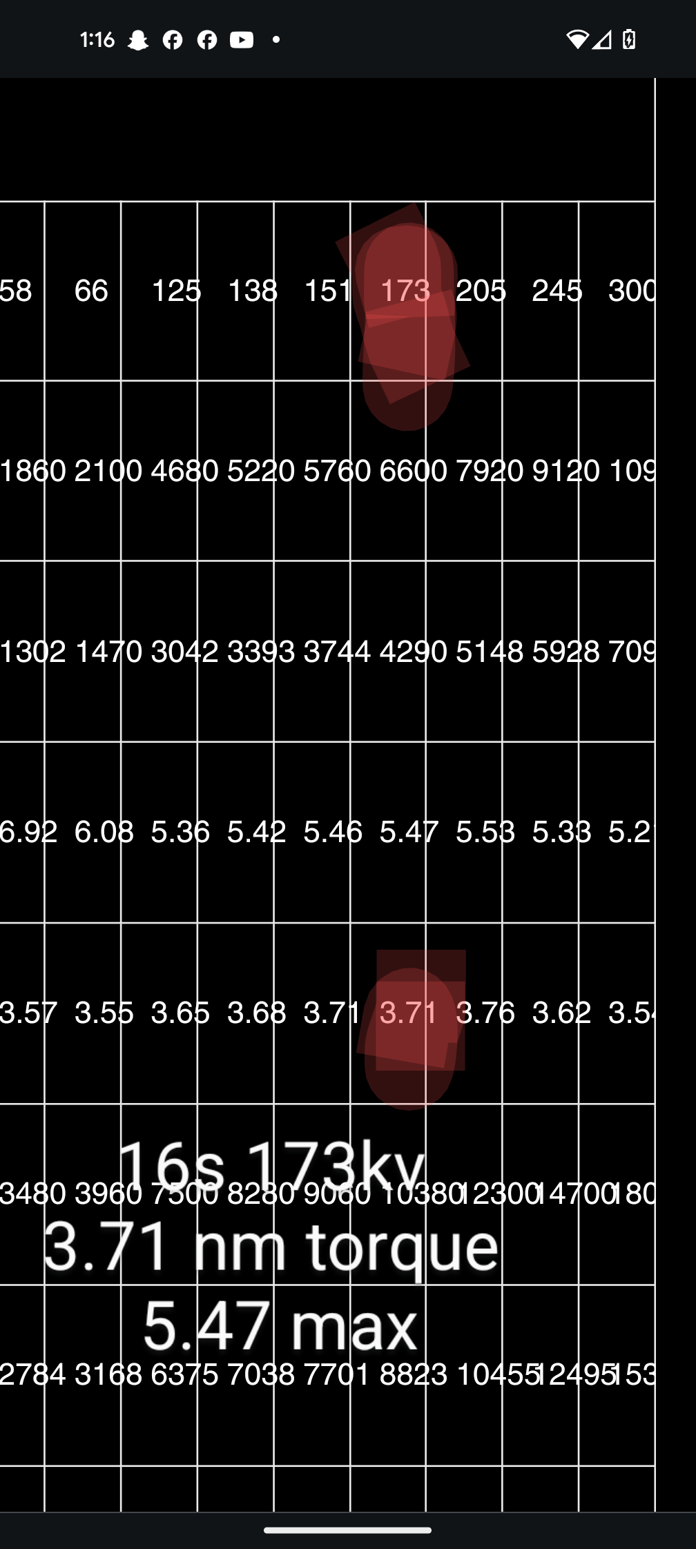

I’m still learning all this but my limited knowledge and math skills tell me with a 2wd 6485 setup I would lose .33 nm per motor, .66 nm total, and 3.43 nm total after gear reduction going from 12s 205kv to 16s 173kv. But I would have 38.5 nm total after reduction on 16s so that 3.43 loss doesn’t seem like much to me. But I would gain a lot of speed. Hopefully @Skyart can either verify what I’m saying or tell me I’m an idiot and why I did steal this data from his charts but i could have screwed it up on the way lol.
