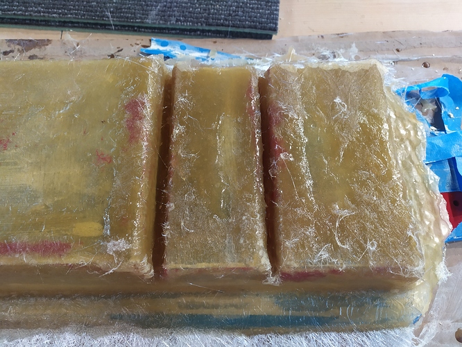

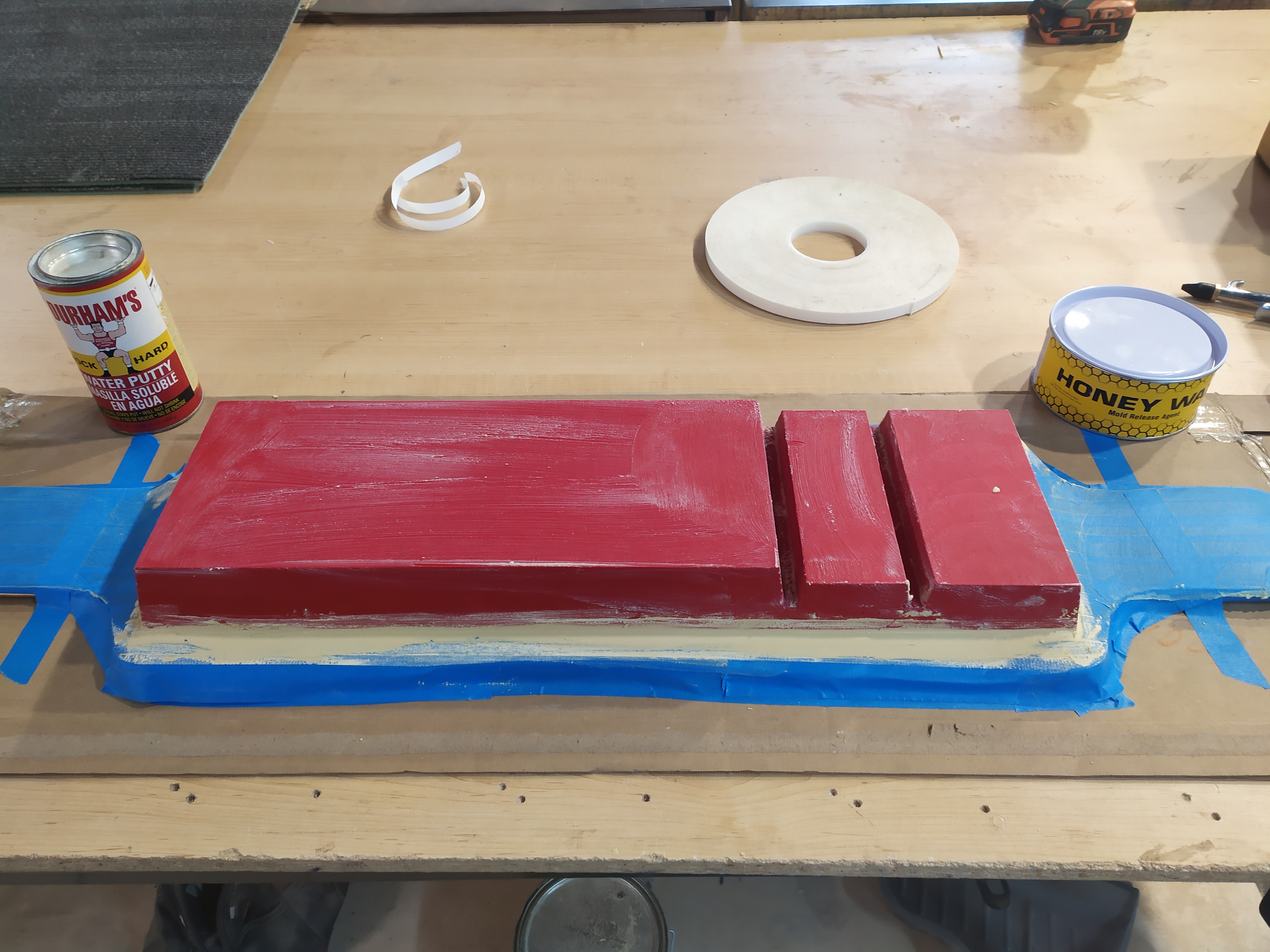

My turn to add onto it! So I decided to use a positive mold since I didn’t have the time or patience for a negative, and I had to use double the amount of resin and fiberglass you used. It’s about 22" long, 7" wide and 2" at it’s thickest to fit a monster of a 12s6p battery in.
Against all my best judgement I decided to make a segmented enclosure… Which works great when it’s a negative mold but was a pain in the ass for a positive mold. I also used polyester resin (just the labeled fiberglass resin at home depot) since I work in a big wood shop and had the space.
You can see just how lumpy and ugly it turned out lol. I gotta say the most important as ice I can give that I wish I had followed initially is to not cut the mat but to tear it up. The strands round corners very well but the thick cut ends do not, it’s what caused so many air bubbles, popped out corners, and even gaps
Close up shot to just how ugly it is lol
After sanding I had 4-6 holes in the thing on too of air gaps, but despite me wanting to smash the thing as I was making it, after a good night’s sleep I decided it’s salvageable. Patching was much easier once I started tearing the mat instead of cutting it and it’s actually starting to look half decent. Once I sand it and paint it I’m sure it’ll be fine
But for anyone else who’s interested in making an enclosure, let me say this. DO NOT MAKE ONE TO SAVE MONEY, I guarantee you you won’t save money on it unless you consider your time worthless. Even then, the tools and stuff you have to buy almost equal the fiberglass and resin costs. I made one because I wanted a decent looking thing that was tough and perfectly fit my deck and that’s what Im going for. If you want perfect and cheap, buy one from a vendor, especially if you’re using a popular deck.

It’s easy to smooth out those peaks with a surform while it’s still curing, or within about a week of layup.
There are no mistakes in fiberglass, only more sanding😂
Haha the peaks sand down just fine, actually it looks okay after sanding and patching so I’m happy so far, especially since I was so close to throwing it all in the trash while making it!
I just can’t imagine making this thing without a power sander. It’s the only real way to get a smooth finish with a positive mold lol
The first layer went on without many issues. I kinda just mushed it in there once I wet it out enough with resin, then I baby sat it for like a hour or so, rolling it when it came off the mold. I’d also come periodically once the resin got tacky to keep pushing it back down
But once I did the 2nd and 3rd layers (at the same time) I cut a slit at each corner so the mat would conform a bit better to the corners and baby sat it again lol. I did have some air gaps, but you can fix those with resin/fiberglass mat once its cured and after sanding
