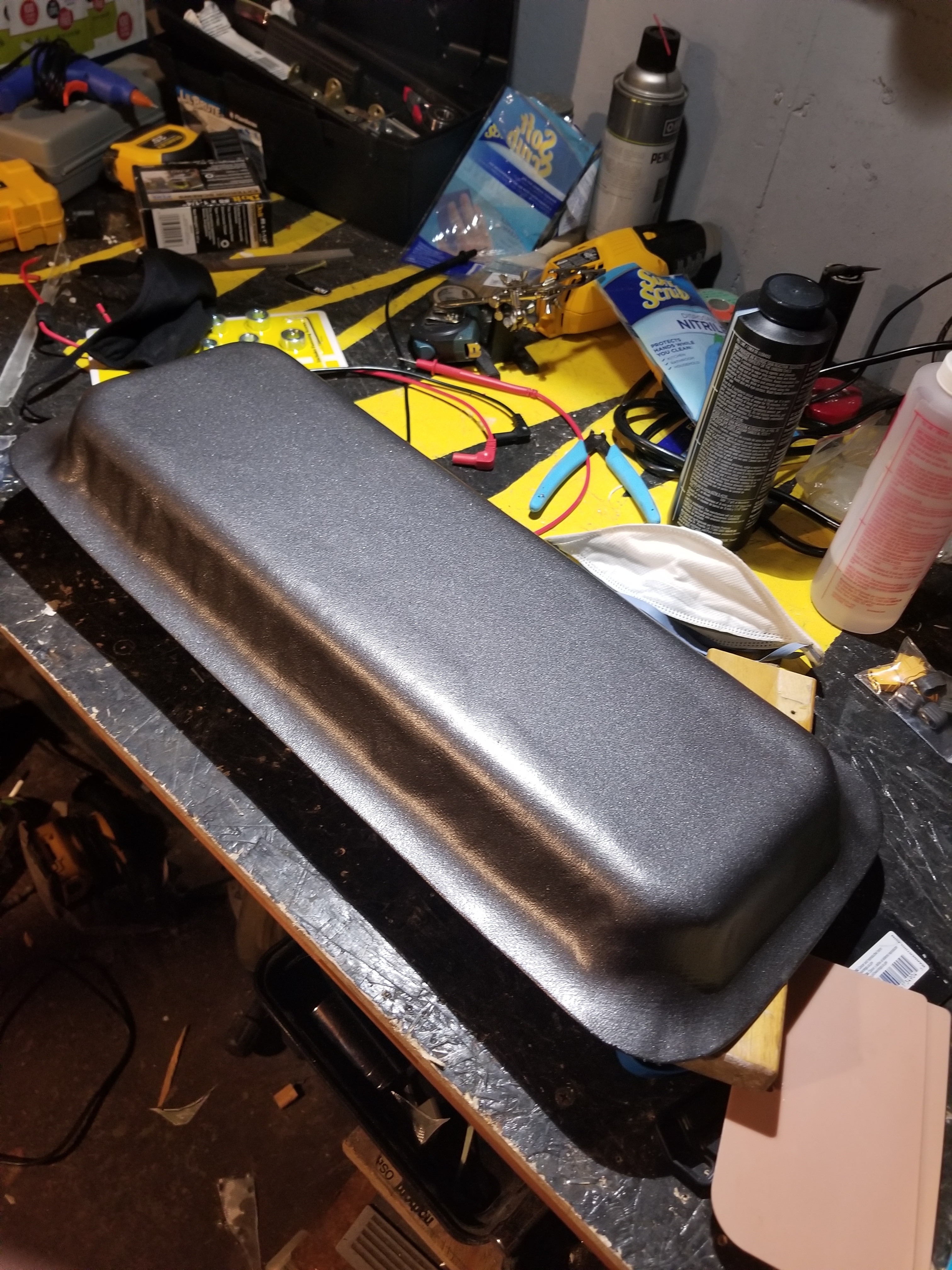

$40 Home depot custom enclosure
This is what I got from the home depot method. ~$80 of materials. 3 layers of GF cloth is a lot stronger than I thought it would be. Great tutorial!
niceee that looks so clean!
Thanks!
PSA spray paint has acetone in it and will dissolve an insulation foam mold. I got sick of foam and made a mold out of scrap wood instead so I could more reliably reuse it if I had to.
