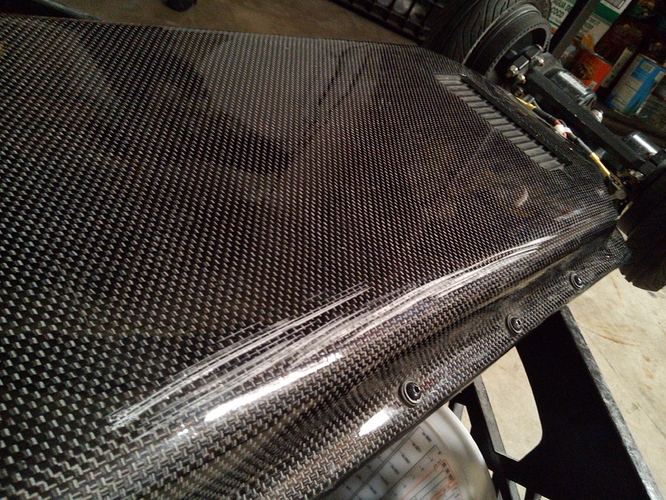

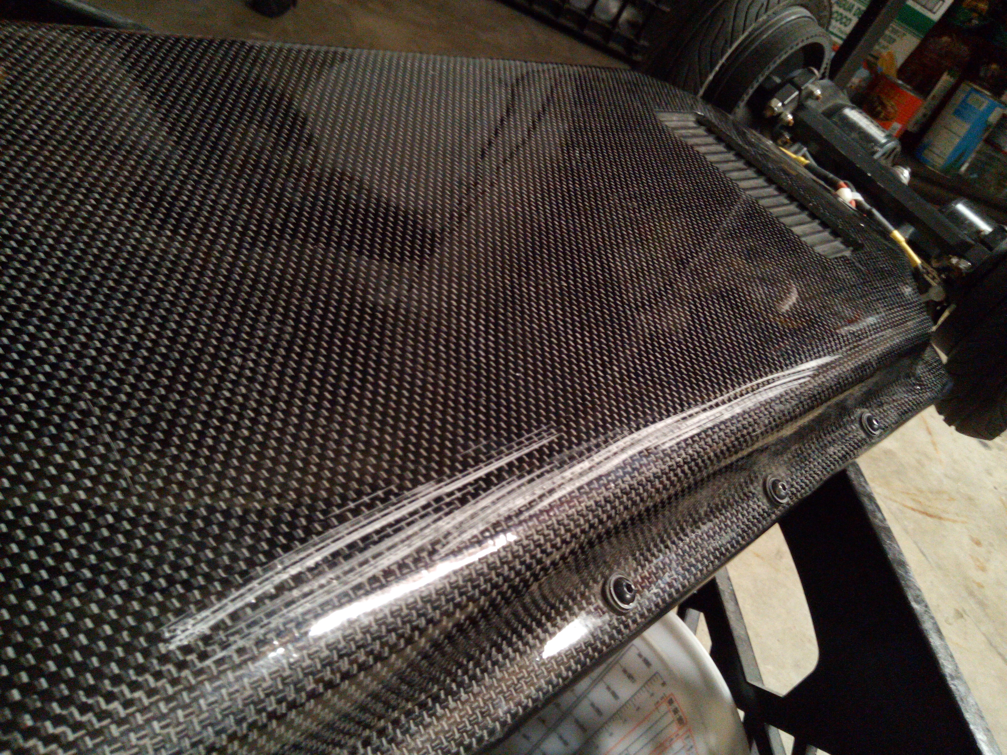

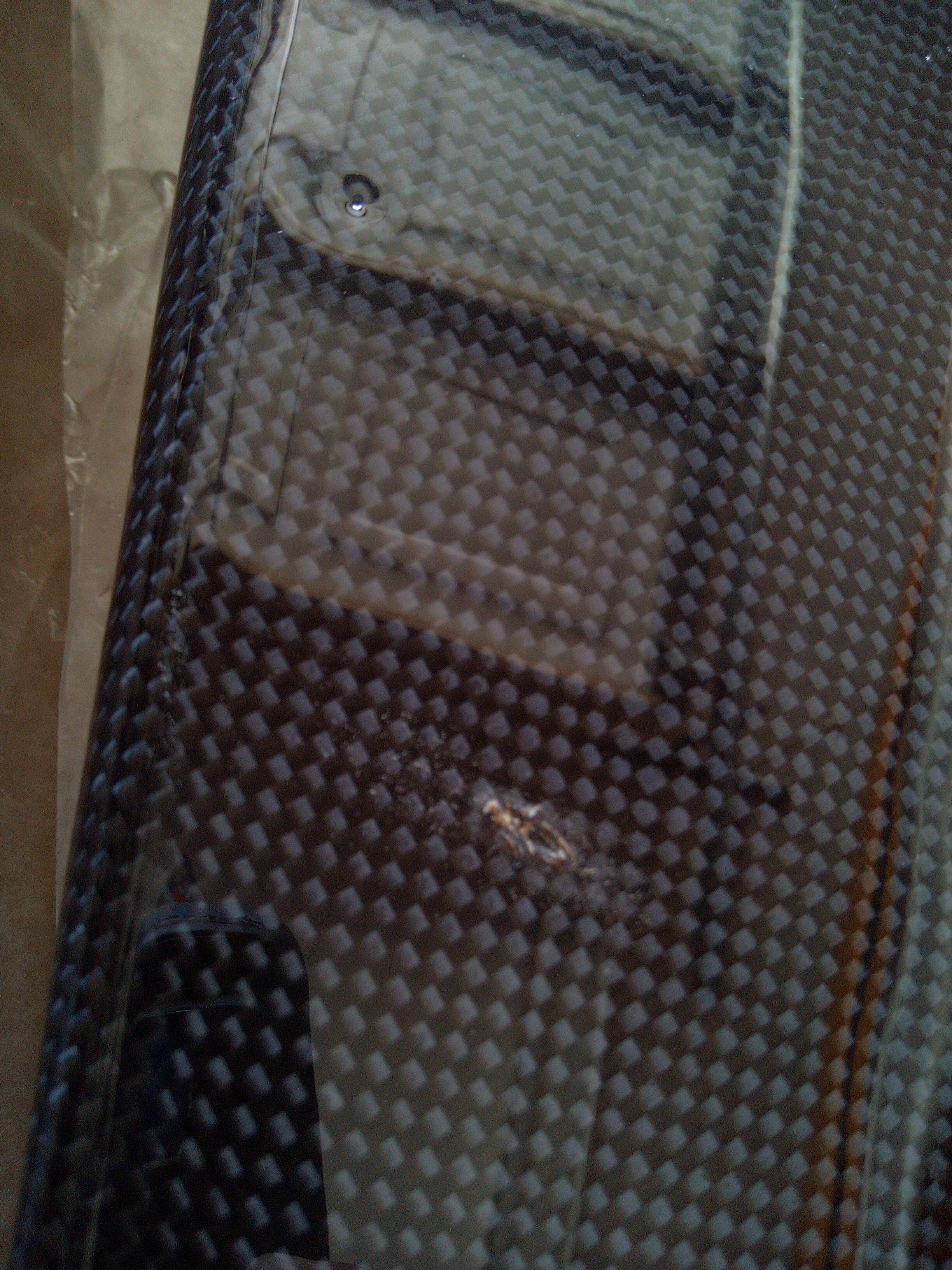

Update, a few hundred miles on this enclosure:
This thing is solid. I just got done doing an accidental rail slide on it. I was taking a different route than usual and suddenly I was facing a square curb. I instinctively slowed down (when I should have just SENT IT and flown right over) and ended up smashing down and sliding off the curb. ended up with a light gouge, no cracks or other damage. make it THICCC :v:

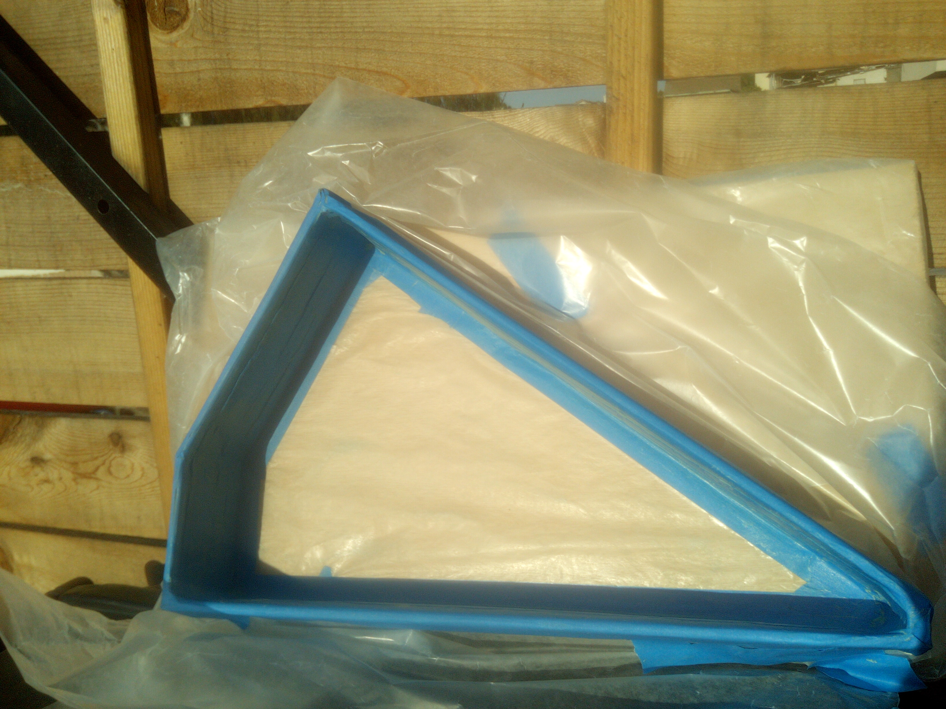

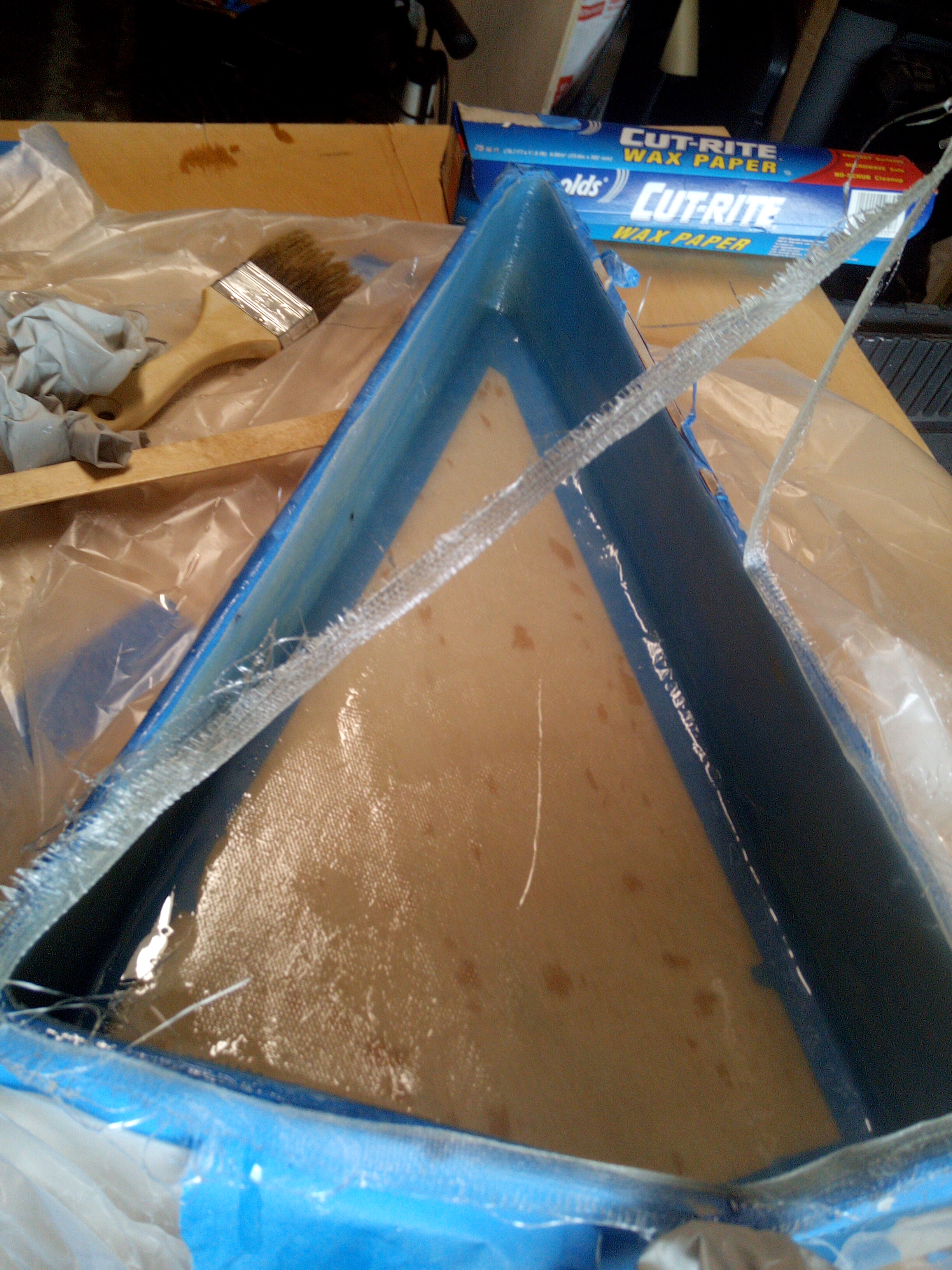

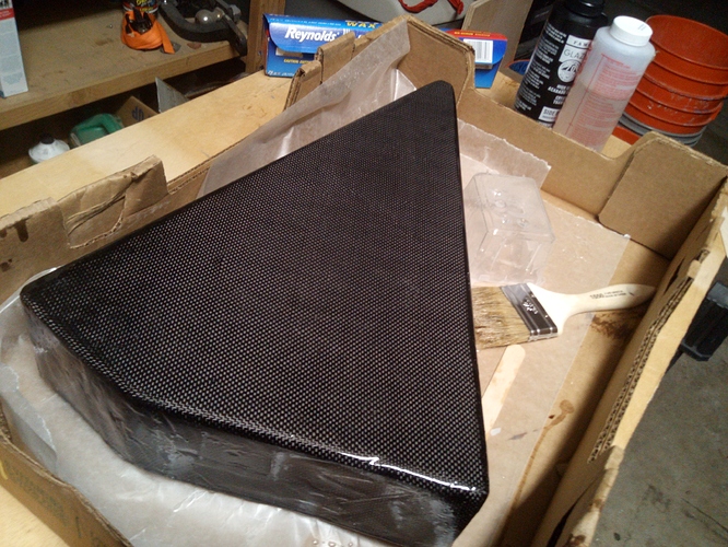

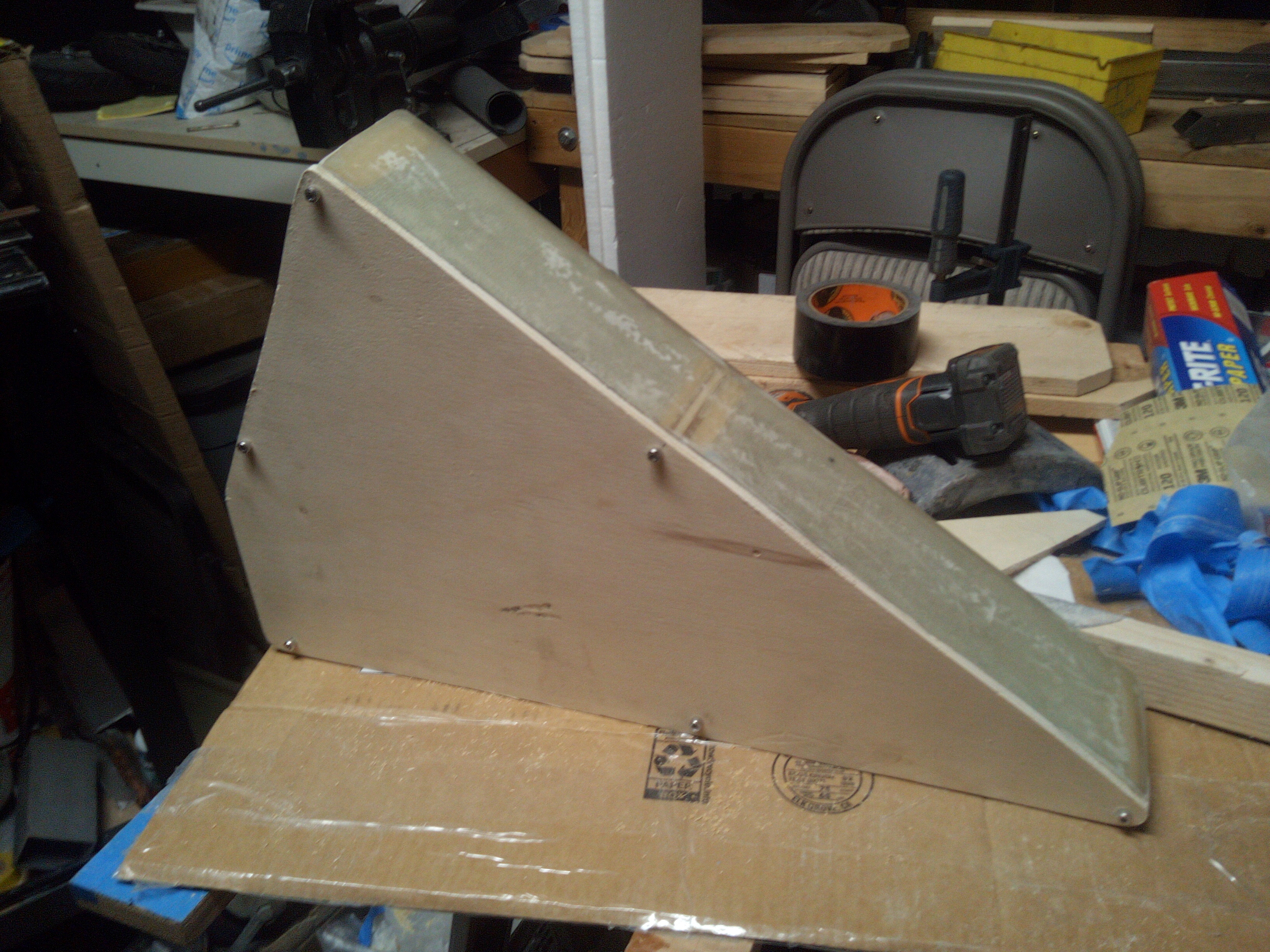

quick recap:

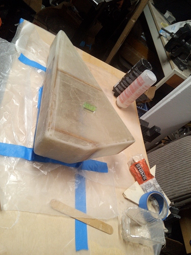

Foam tape and wax over the deck for a mold
2x layers of 6oz chopped strand mat
home depot tabletop epoxy
cut and sanded to shape
gloss coats and more sanding
carbon fiber layup, more home Depot epoxy
careful cutting and sanding of the edge (don’t touch the carbon surface, just trim and sand the edges)
final gloss coat
holes for wires, heatsink, bolts
rail slide it off a square curb for testing
repeat this last step multiple times

yeah, and chopped strand mat linked above (not the woven mat) makes it easier to work around the corners. after you build the fibers up a bit the corners get more and more round, then working the final carbon laminate around the corners is easier.
I have not. this would be very very messy but fast. more suitable for something like a boat, where you need to cover dozens of square meters before the resin starts to harden
to mix in dye or pigment, you would first get a complete mix up of the epoxy, then stir in the pigment (or mica flakes or graphite or whatever). This is advanced resin layup technique and would work best with a stopwatch and a strict timetable. and lots of practice. You need to work with a purpose because you’re mixing twice as long and the cure time is the same.
I used regular automotive paste wax. Tutle Wax I think, but any wax will work. Hairspray can also work (I have heard) but I have only ever used Turtle Wax and have had good luck when I put a nice thick coat. IMO, you cannot put too much wax

The carbon was just an additional $13 shipped on ebay. Tons of weaves and sizes available. I found one that was 24x60 inches, so not much extra material. and at most 1/2 another can of $22 resin puts the grand total to an extravagant $64 bucks.

Good question! I didn’t keep that scrap, but I kept some of the bit that came out of the heat sink cutout and it’s hard a a rock now.
I tested that piece to destruction by putting a corner in a vise and whacking it after I couldn’t bend it with my hand. It did bend/break but didn’t snap. The material did retain some of it’s toughness and isn’t brittle. Actually seems ideal to make an enclosure with as I’ve come down HARD, (harder than I ever would on purpose :joy:) on this thing and it hasn’t cracked or splintered, and I’m a heavy guy + a heavy backpack. Other fiberglass enlosures have seen a bit of cracking around hole when abused that bad. Part of this enclosures durability may come from the sheer thickness of it, but that is also to the materials credit since I was able to put twice as much down for the same price. Would definitely use this resin again. :+1:

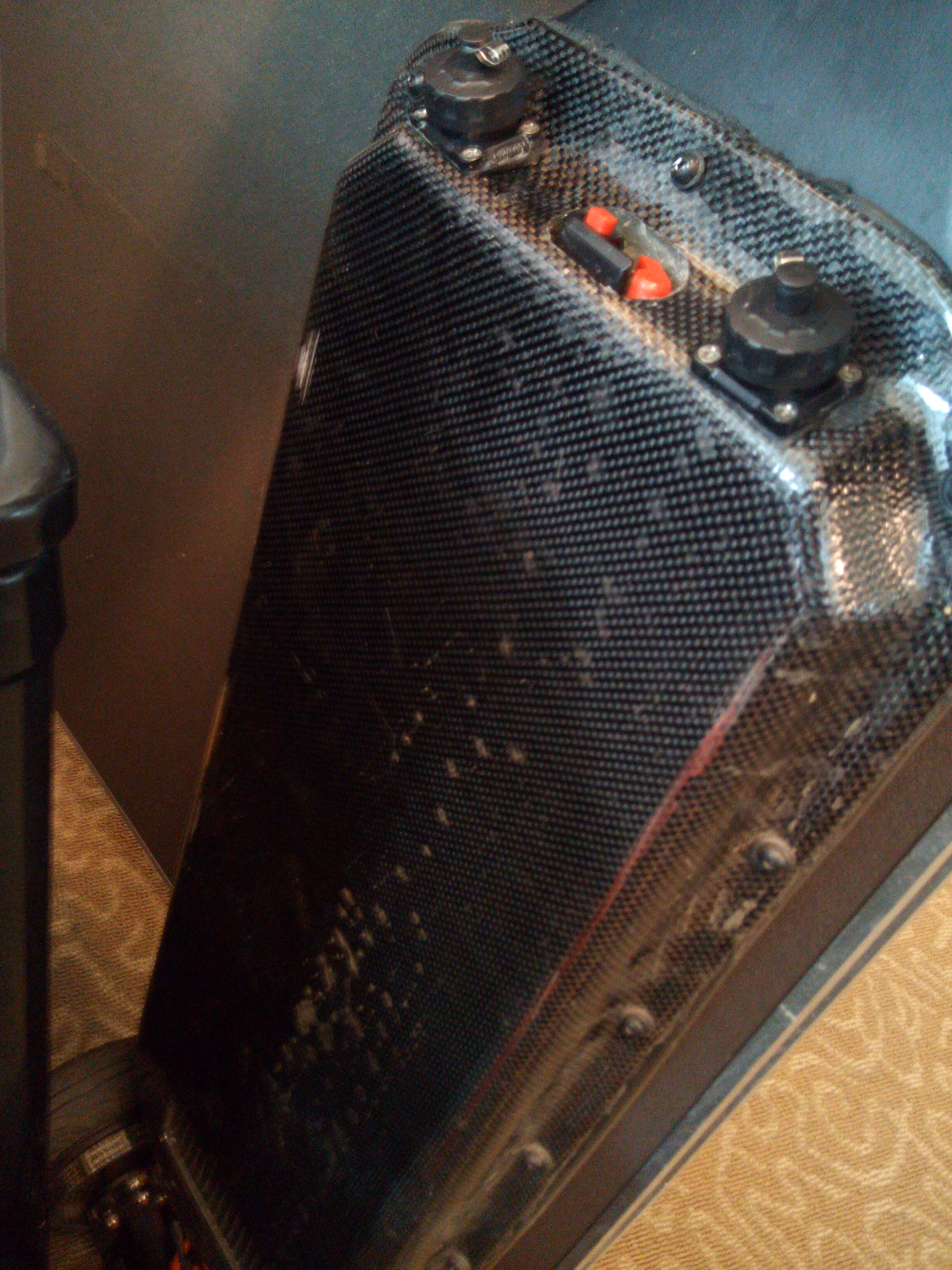

Right now, I’m using this same basic recipe to make an ebike enclosure, check it out
That’s super cool, thanks for the advice.
Because this is my thread, and I do whatever I want with it, I’m going to continue posting about the the ebike. I don’t care that it’s an esk8 forum, I’ll burn this puppy down.

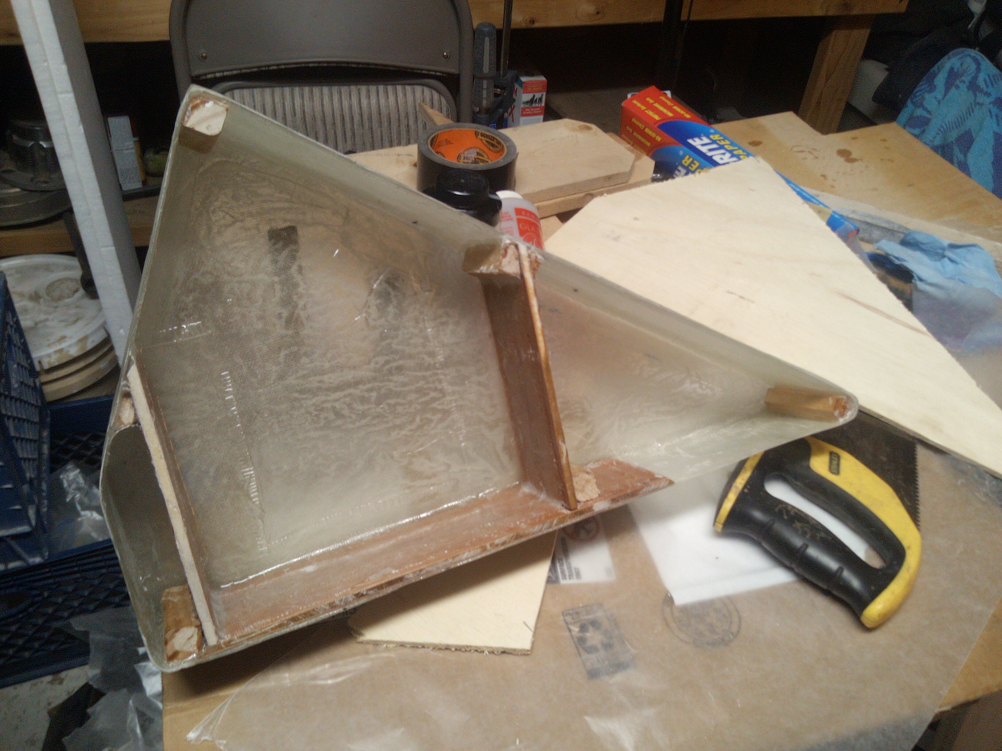

I used Bondo brand woven cloth for body work (only thing Home depot had) and the same ol Famowood table top resin. The enclosure on Deep Purple 2 is rock hard and pretty much bulletproof with all how thick I left it. I put some 1/8" plywood and glassed that into place to with 5-6 tabs of the same glass. came out pretty solid.
The package, strangely enough, did not state the thickness of the cloth, but it felt like a medium weave neutral axis 6oz cloth. I put at least 3 lams of that to start, more in corners and along edges. Since this was woven cloth, I had to notch the glass. Do this while the cloth is still dry unless you hate your scissors. Which, by the way, must be of decent quality and sharp to cut glass cloth.
The ply helps a lot with the stiffness, so did the carbon

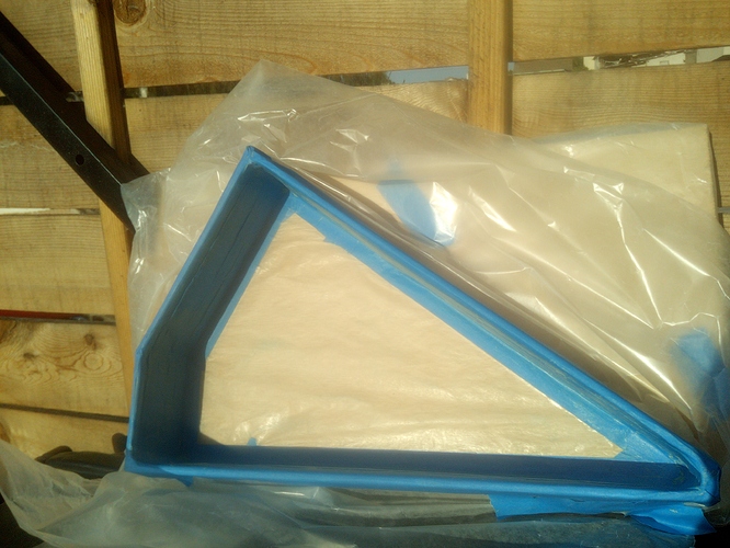

Here’s what I’m doing:
Before I got too far, I installed some wooded bits to the layup to take the same threaded inserts I use on skate enclosures. Then shaped a piece of 1/8" ply so it lines up with the holes and sits neatly on the outside edge of the enclosure. once the box part hardens, I’ll tape it up and use it for a mold for the lip of the lid, which will come over the sides a little to help seal it up. This could be money, or I could end up with a fully sealed, impossible to open enclosure. Either way, stay tuned for the result, haha
