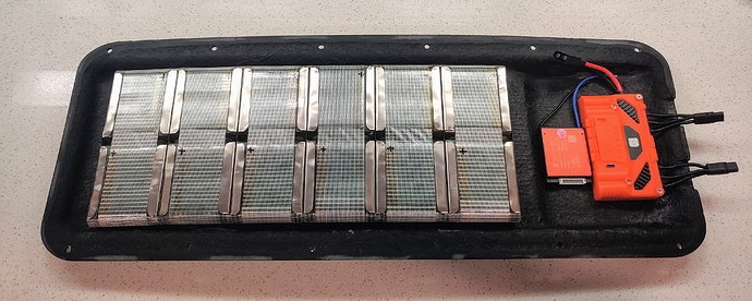

Feeling pretty good about the enclosure as well. Very sturdy. A minor quality issue with the side cutouts, but @torqueboards is already handling it.
By the way, the DROK Battery meter from Amazon works with the fiberglass enclosure: https://www.amazon.com/dp/B01LQ7MT4K?ref=ppx_pop_mob_ap_share
Also, this charge port fits great: https://www.amazon.com/dp/B07S5ZLFDG?ref=ppx_pop_mob_ap_share
The third hole is a bit too large for the Unity switch, but I’ll fill it with epoxy and drill it to a smaller diameter.
Getting ready to wire up the 12S4P P42A battery

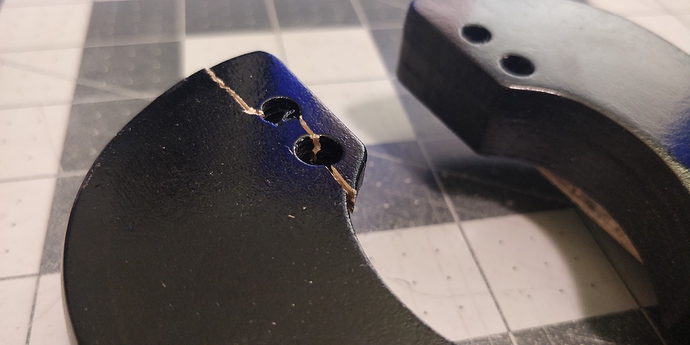

Finally got my things! Overall very happy, but has anyone experienced something like this? Would normal wood glue or epoxy and some clamps be able to fix this? It’s barely hanging on by a few strands of wood
Nothing’s fixing that.
Really? :sob: Oh I guess it’s worse that it’s a drop through.
FAAAAAAAAAAKK
If I put bolts through these and try to fasten it’s probably gonna snap.
@ZachTetra you do woodworking. Is this salvageable?
Yeah, unrideable. Don’t take that chance.
Yeah, don’t ride that.
Did you use the countersink bolts and just bolt through the top?
You need a top plate. :rofl:
My Hummie got damaged in delivery and was similar. Got a replacement. Seems like a pretty important part of a deck…
Anything can be fixed tho, fibreglass plate top and bottom like a sandwich. @glyphiks repaired ends of a butchered demonseed deck a little while back. But given it’s supposed to be new, why do that here?

If you top mount the deck and use a big deck protector it will be okay, but if you drop mount that absolutely not
We have different definitions of that word. This is structurally flawed now.
