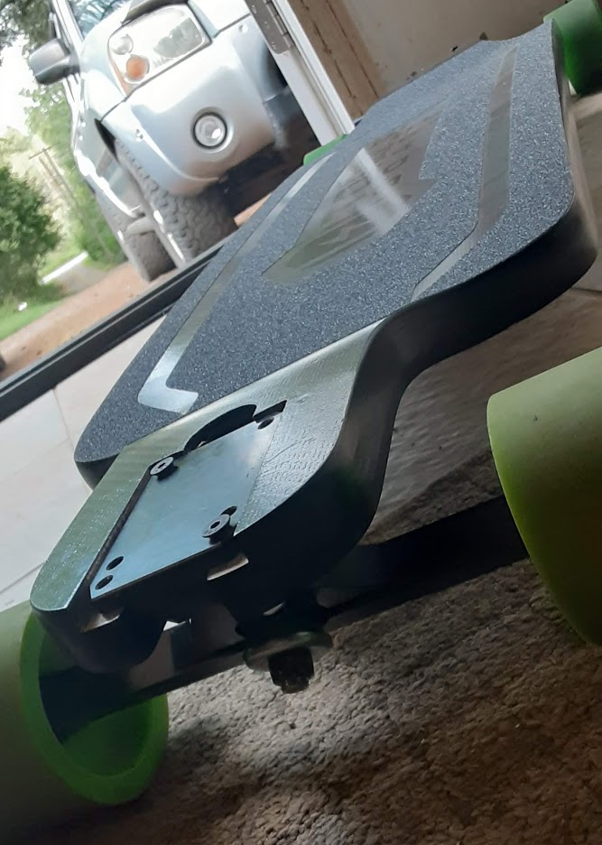

Here it is set up for it’s first mounting

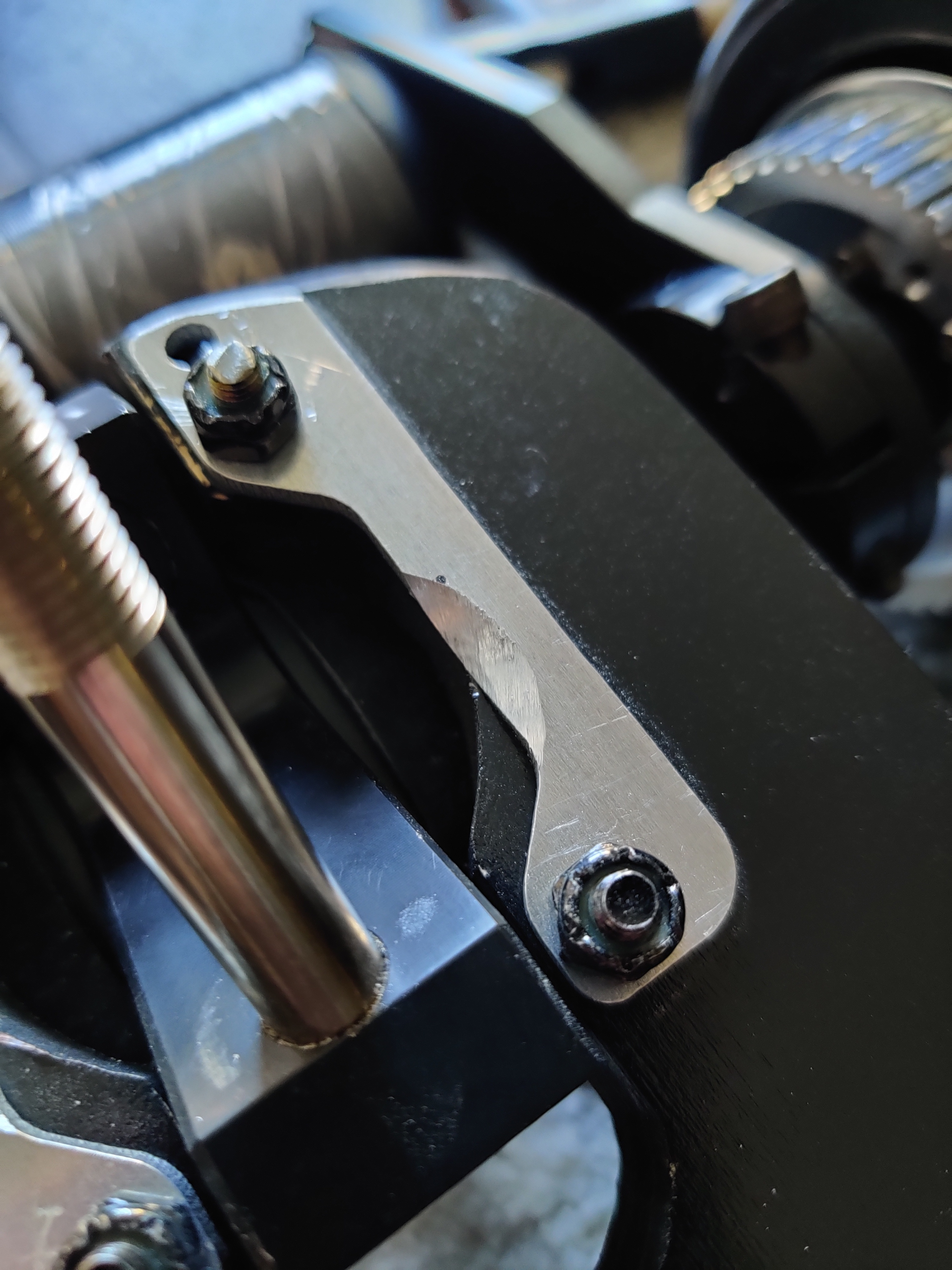

Make sure you use a top plate on the flushed drop through. Not sure if that’s the truck itself or a riser.
That’s a dropped truck, then I use shredlights mounts below as cheap high quality anti-sinking pads.

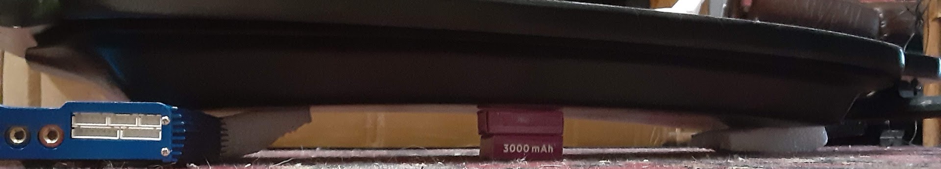

Here I am testing worst case (sorry for the dirty) ground clearance.
Dropped trucks + 83mm wheels. With a BB DS enclosure, fits two 30Q’s in boxes(39mm) in the middle and an IMAXB6 (32mm) under the end.
Anyone know if that is acceptable ground clearance? really not a lot but if I go up to 110-160mm wheels the problems go away I’m sure.

I did a drop through mounting for the @Boardnamics baseplates, with @RipTideSports backing plates. Took some dremeling to avoid the hanger hitting the backing plate but now it is rock solid.

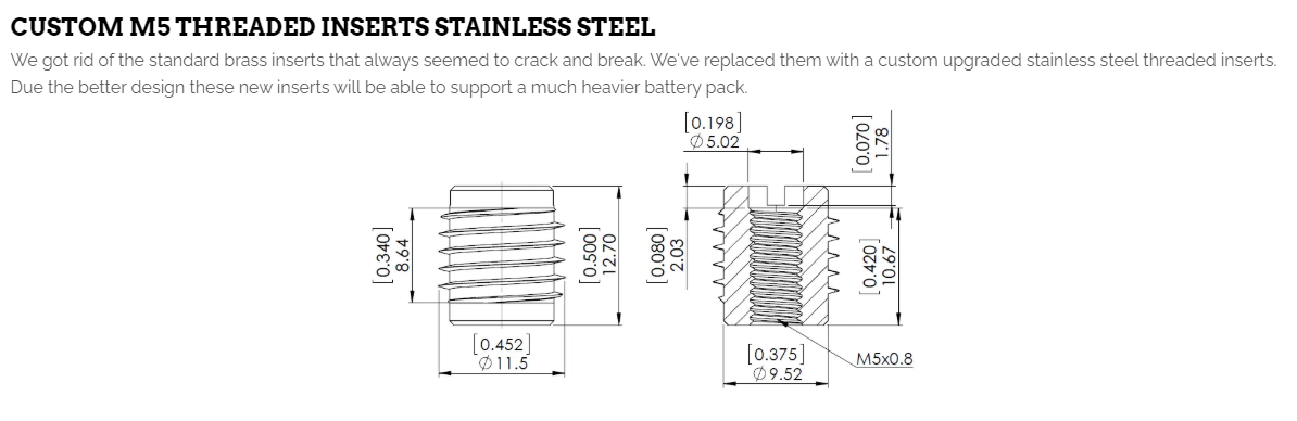

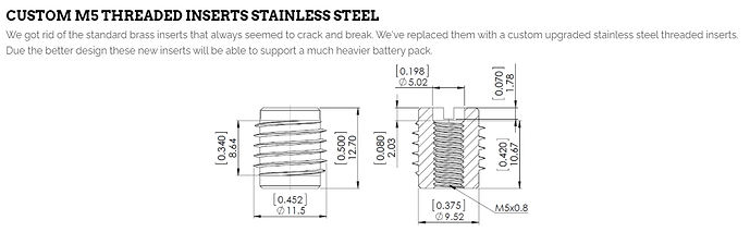

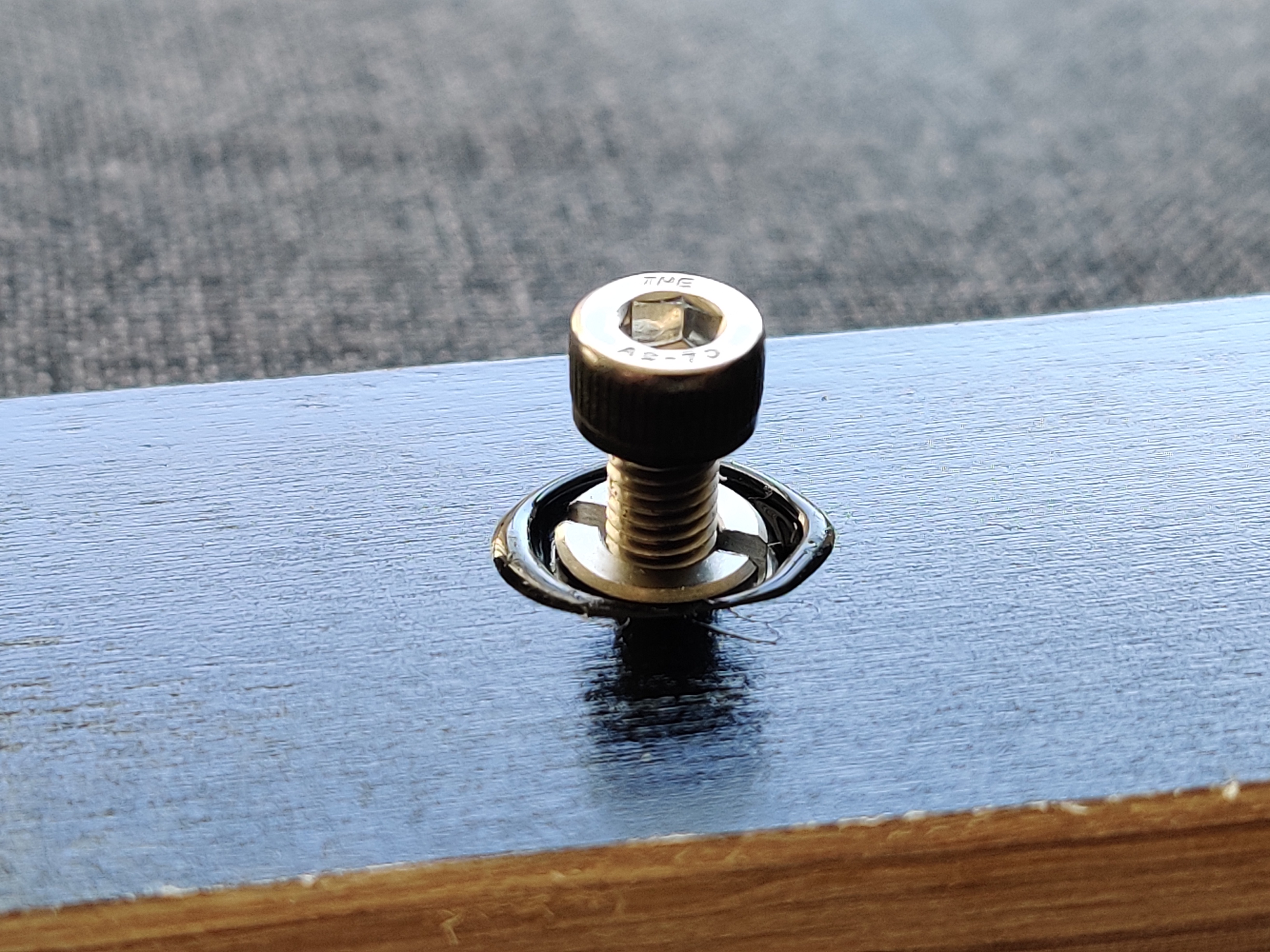

I’m trying to get one ready for a test but I ran Into an issue with a insert hole
knew it wasn’t a great sign when I could screw the first one in mostly by hand.
So I should just glue this one in?
You are supposed to epoxy those in. @torqueboards has some instructional videos about that.
You could use m6 inserts
