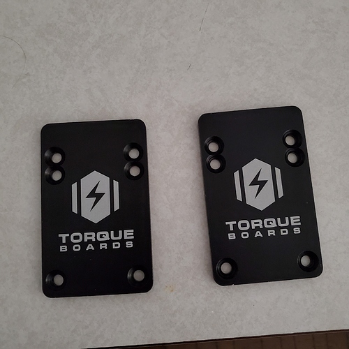

Yeah, they sell em. They don’t line up very well with the bolt holes so you may have to Dremel the deck a little bit to get them to align properly.
That’s perfect! I don’t see them on the site, did you have to DM Dexter for them?
yeah, you will have to ask Dex, theres an option for them on the site, but only if you purchase a complete deck and it always says out of stock. But he should have some.
Awesome, thanks for the info - I’ll DM him right now
Package received! Came with a gasket as well.

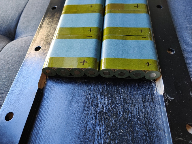

21700 Cells, 12S4P

Routed the deck cutout wider with a dremel. Now it fits a 12S4P nicely.
Nice! I would recomend reinforcing that somehow
Hmm, I only took out a few millimeters. I actually did an angled cut and left the bottom corners of the original cutout intact. If the deck is now too weak, it was too weak already when I got it.
Good call.
Yeah, take it from a mechanical engineer, that deck is fine.
