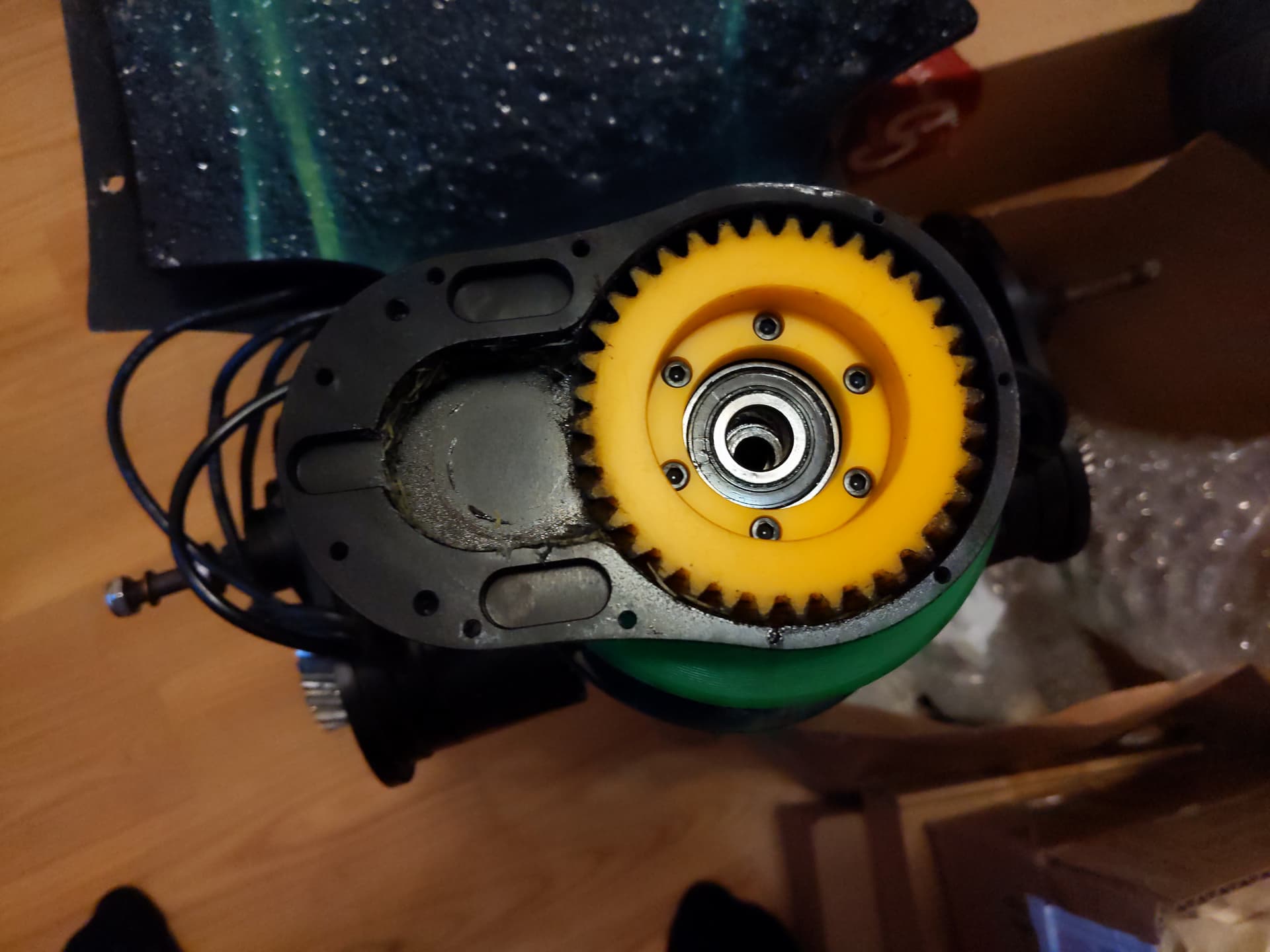

Changing motors and migrating to a different size hanger a @3DServisas Urethane drive trains that had been running AT 6x2 tires for about 500 miles now
It looks brand new on the inside still, the white lithium grease provided with the drive train is indeed still white, minimal dust ingress. Just thought I would post this, really good quality stuff

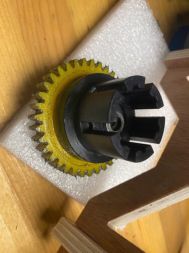

And here’s how they look like if the drives come loose because you used red threadlocker instead of green on the clamp bolts :sweat_smile:
I managed to clean it up, and seems like the damage was at the end of the teeth, so it should still run fine :slight_smile: :crossed_fingers:

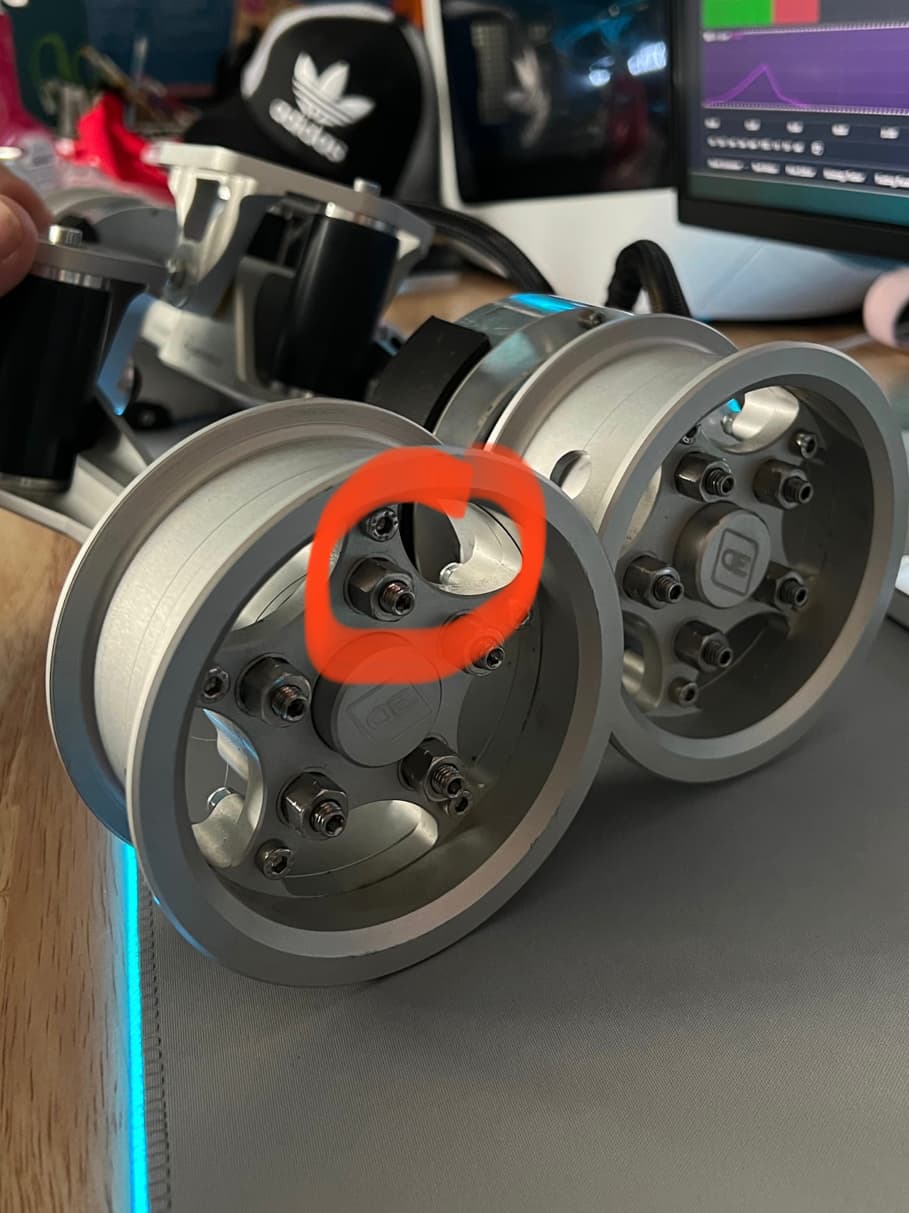

Does anyone know how to remove the hub from the gear drive? Trying to change tyres on this drivetrain and the wheel hub is bolted to the adapter of the gear drive. a M4 bolt head on the front, and a locknut at the back which seems to be impossible to reach to as it’s blocked by the V-ring.
On mine I just remove the screws that attach the hub to the adapter
then remove the axle nut then the wheel comes off and then you can separate the hub into 2 pieces by removing the other screws on the hub
You can just do that? The one that i have, there is a locknut on the other end and it free spins, which is giving me an issue haha
