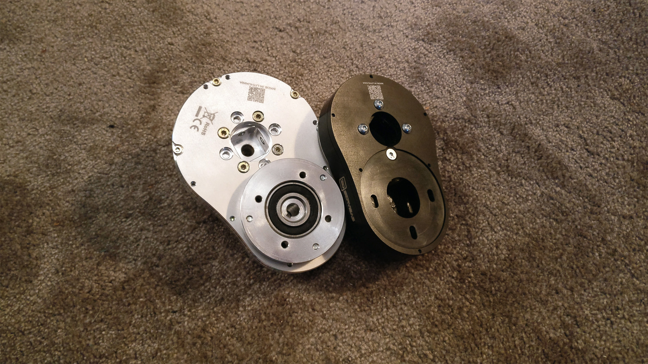

Cool brother I was just wondering how you can supply gear drives pre meshed without motors and gears.
Just one option on pinion then?
Gears are already installed into exact position as they spin in bearings, you just insert motor with keyway into gear and just screw motor on mount. That’s all
As you can see in picture the gear is already in place:

We did some research on motors before going with helix and found out that a lot of motors are spinning not truth and varies sometimes by even whole 1mm which is not healthy for gears especially helix gears as slight misalignment can fck them up. So we added bearings to the motor side to allow motor spin how it wants but allow gear spin only truthfully which amazingly reduced noise even on straight gears and by using angular bearings we mitigated axial loads of gears which save your motor/wheel bearings.
Thats exactly why I asked. Tolerances. Looks like you sorted that out. So many guys do not mesh correctly. Nice work.

I got message from @3DServisas saying that you need to use Loctite 648 to glue keyway to axle and apply to the motor axle too and insert into gear and bolt motor in place let it dry, add grease, put cover on and drive

When we will have another bearing for sealing on the outer part of the wheel gear adaptor, with herringbone gear, we will be even closer to (my) perfection area!
It is already way over my expectations.
It really arrived ready to spin!
This is just after opening the box, 1st shooting.
This would increase the width even more so… I don’t think many would like to ride on 300 hangers :smiley: Also gear drive is dry and rubber is rubbing it would spin even more freely with grease :slight_smile:
