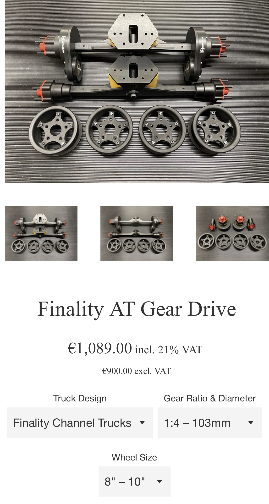

FatBoy320 V2
A new gear drive system from the 3DServisas Finality product series. A revolutionary new design involving all drivetrain components to provide the best possible driving experience for riders.
After designing and making gear drive systems for longboards and mountainboards for over three years, we are thrilled with the results, and it’s our pleasure now to introduce our newest gear drive system.
Finality AT Gear Drive system
A multi-component gear drive system consisting of three key components:
  • Finality Wheel Hub (FWB)
  • Finality Gear Drive (FGD)
  • Finality Wheel Rim (FWR)
Finality Wheel Hub (FWB) System
After designing and riding multiple styles of boards and thousands and thousands of kilometers, we were never happy with the wheel mounting and driving system. It always was a major vulnerable part of the design. The exposed bearings, lack of precision, complicated assembly process, and weight issues led us to redesign this mounting and driving system from scratch. Using our motorsports experience and consulting several experts in the field, we would like to introduce a new way to mount and drive wheels on electric boards Finality Wheel Hub System (FWB)
New-Hub-3D
After a full redesign of the system by taking inspiration from the car wheel hub, we designed a new wheel hub system with an enclosed dual tapered bearing and a five-bolt mounting pattern. It allows us to mount the wheel rim to the trucks and drivetrain without any issues and removes bearing’s from the wheel rim.
After redesigning the wheel hub system, we needed to make new wheel rims for the wheels. After removing bearings and just having a 5-bolt mounting mechanism using M6 hardened bolts, which each can withstand more than 100kg, we can provide the most rigid, light, and accurate wheel-spinning experience.
Finality AT Gear Drive (FGD) System
After releasing our last most successful gear drive design, we bring the updated gear drive design to this system. A CNC machined aluminum enclosure with a special plastic wheel gear (which is more rigid than POM and equivalent to aluminum rigidness) and steel motor gear this system is only available in helical gear design for best power transfer and noise levels. With a fully enclosed design and multiple bearing design for the best gear work efficiency.
The gear drive comes in few diameter options tied with a specific gear ratio, which allows this system to be mounted on several truck designs
Available Configurations
Finality Channel Trucks with Finality Wheel Rims
FatBoy FB320 v2 Hanger (Baseplate and bushings not included) with Finality Wheel Rims
Lacroix Hypertruck™ Trucks (Not Included) with Finality Wheel Rims
More Information:
  • 2 x Finality Channel Trucks
  • 4 x Finality Wheel Rims
  • 2 x Finality AT Gear Drive System with Finality Wheel Hubs
  • 2 x Finality Wheel Hubs for front wheels

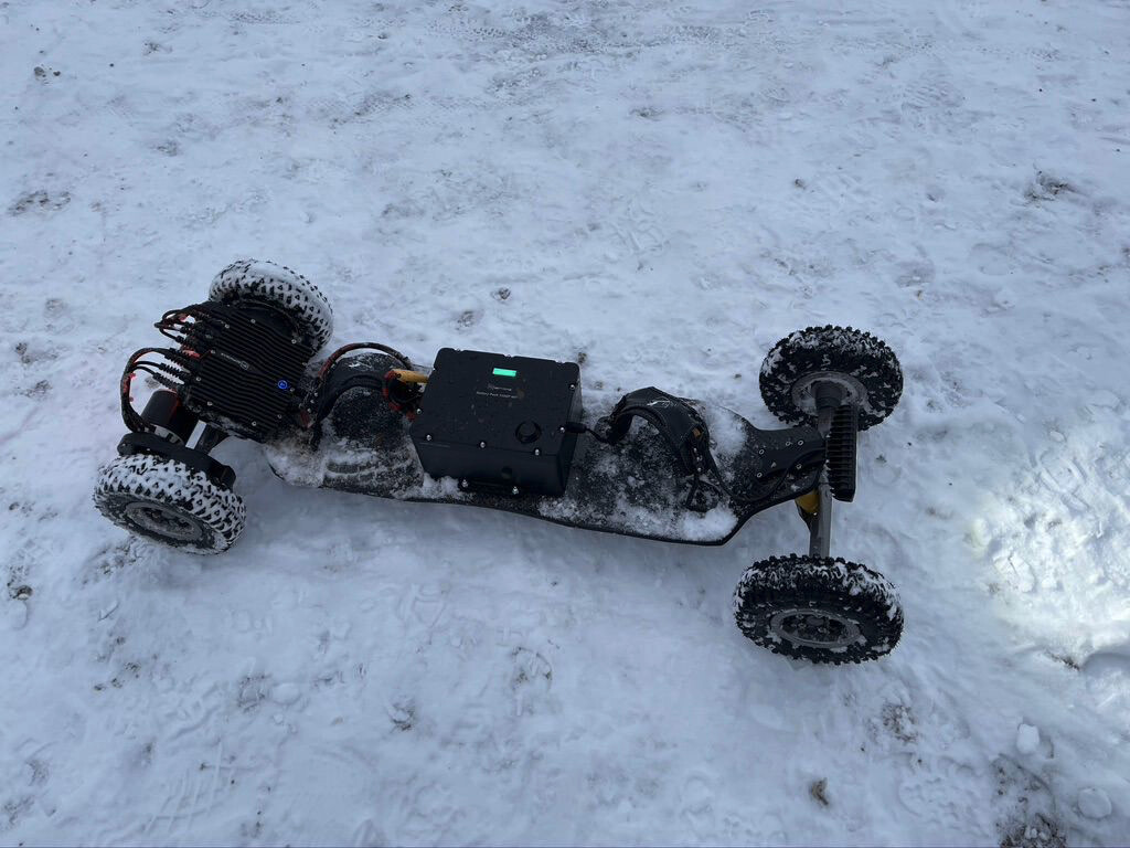

These seem like some pretty good benefits, what can you tell us about the testing/beta you have done with these?
Combined over few thousands of kilometers as we were developing this since last summer. It is visible in our board pictures but just nobody noticed yet.
