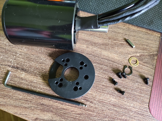

Did that happen due to those retaining bolts shearing off?
Yuppppppp… smh… trash they used the smallest fukin bolts…
Look at this trash
Damn! That’s crazy poop.
Just like @3DServisas predicted. Wires n everything gone. That really blows
Looks like M3 in a motor structural plate? Wow
Yea… fukin joke… m3x6 :joy::joy:

All motors that are going to be put in BioBoards gear drives will have the modification I have mentioned before. Yet, a guide is there to do it for your own motors.
Current batch of motors is fixed by hand like 3d servisas guide. Next batch coming in soon is fixed by maytech. So no boards will be shipped with faulty motors.
@ahrav please follow the guide here on your motors and for the one failed il send a new one for you. But please hold out 2-3weeks before we get new batch.
The pictures and instructions are helpful indeed…peoples be very careful to not introduce metal shavings during countersinking, put a bit of paper in the holes first and cover the rest of the motor…,
Or just remove the faceplate and do it separately…? :man_shrugging:
You mean remove the stator from the baseplate? Usually that’s difficult without an engineering tool shop.
But yeah that would be ideal

I mean the faceplate that’s held by M3x6mm bolts. That’s the bearing shield and all that holds the motor. It takes away easily.
Would love to know that too…
Ah good to know, that makes it the best way by far
Dear lord, just tried to remove one plate. All 5 bolts loosened up by using the long part of the hex key, with finger force. Ouch. :no_mouth:
Sorry for lint, the motor was in… storage. :laughing:
