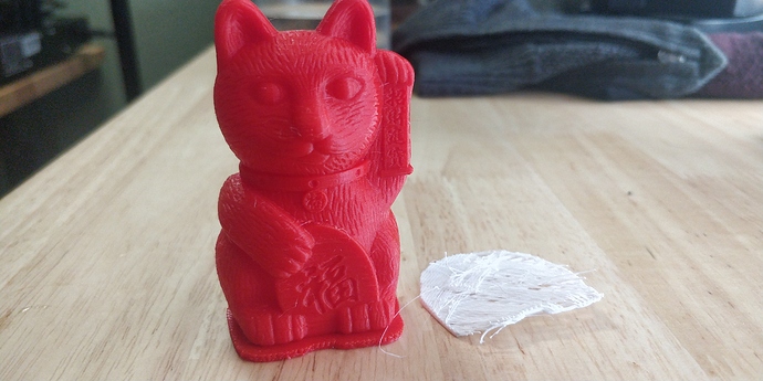

I cleared the blockage in my nozzle and I did the bed leveling print 3 times and made manual adjustments on the move. Then I started to do a Cat print.
First layer is on the top then… Things got weird when the motor started skipping. Nozzle jamming again :frowning:
Are you sure your nozzle clogged? Can you heat the nozzle to plastic melting temp and then manually push out some filament. If it comes out with just a little push them it’s not clogged.
If it’s not clogged then the problem is with the motor or the driver. The vref(adjustable by turning the pot on the board) might be too low.
If it is indeed clogged even though you had just cleaned it, means that the PTFE clamp is defective and is not able to keep the PTFE tube in place. Time to replace it with new one.
It’s indeed clogged because I took nozzle temp to 230 and nothing came out.
Before I start turning some pots or replacing some PTFE clamps, i’m gonna wait until new filament comes in on Sunday to test. I would rather believe that these failures are because of the shitty free spool that came in the box
Oh no no. That’s only if the nozzle is not clogged but still the motor skips.
If the filament you are printing with has no additives. Like metal particles or cf etc, then there is no chance that the issue is with the plastic. Personally I have yet to encounter a plastic that doesn’t print. And I buy the cheapest I can.
UNLESS, the diameter of filament is greater than the ID of PTFE tube. In that case, yeah, it would clog. You can easily check for that by inspecting the filament visually.

Guess I figured out my issue! Using better quality filament changes everything :sweat_smile:
Great to see you got it working!
