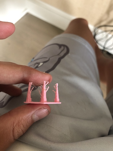

@mishrasubhransu decided to do a retraction test with the stock settings… this happened :grimacing:

Couple random pics I documented it all somewhere I imagine too :slight_smile:
@mishrasubhransu this is stock with 0 coast 0 wipe and 5mm 45mm/sec retract
The one with 0.2mm wipe is printing right now
From left to right…
  1. Stock from @mishrasubhransu
  2. 0.2mm Wall Wipe
  3. Coasting and the above
  4. 50mm/sec retraction compared to 45 plus the above
@agentdev and others how should I go about fixing?
Most likely you just need either lower temp or more retraction. If this is the stock hot end, try as high as 7mm of retraction…I just had to do they tonight on 5 stock Ender 3 pros that were otherwise too stringy.

Retraction speed was fine at 45, but what’s your retraction distance. Try going up to 7mm. Also increase your travel speed to 200mm/sec. This way it gets faster to the other side and doesn’t have time to ooze.
Try the two pillar test.

So two pillar test with everything applied except 7mm distance at 45mm/sec and 200mm/sec travel speed?
Yeah, everything applied including 200mm/sec travel speed. Then increase retraction distance over few steps until 7mm and no more than that.
Thanks man! Still temp at 250? And bed at 70…
