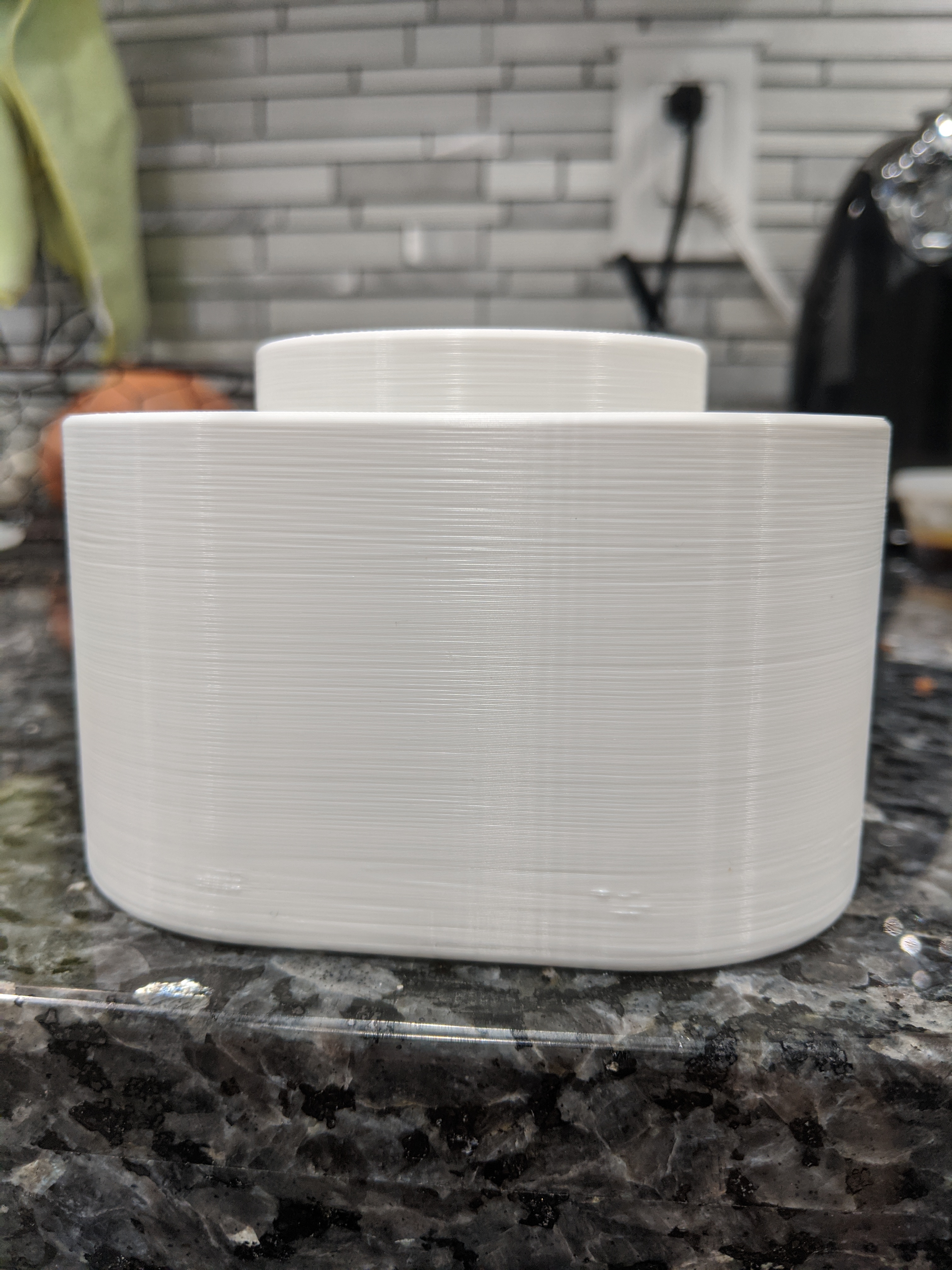

What should I do to stop these little bumps from showing up?
And the Slight stringing to go away
Turn flow down for bumps, try coasting if that doesn’t work out.
For stringing, reducing print temp a bit works for me.
If it’s not structural, increase retraction and reduce temp. This looks like what happens when it’s not extracting enough at the start/end of a layer.
To add to the above:
  • Does your outer wall look OK?
  • what is your seam preference setting set to?
  • when you preview the file, are these the start and stop points of layers?

  1. Wall wipe distance: 0.2mm
  2. Coasting.
  3. Increase retraction.
Do it one by one and in order. And then you can combine them based on their effect or reject them.
Thanks man! Will do! Thanks everyone!
