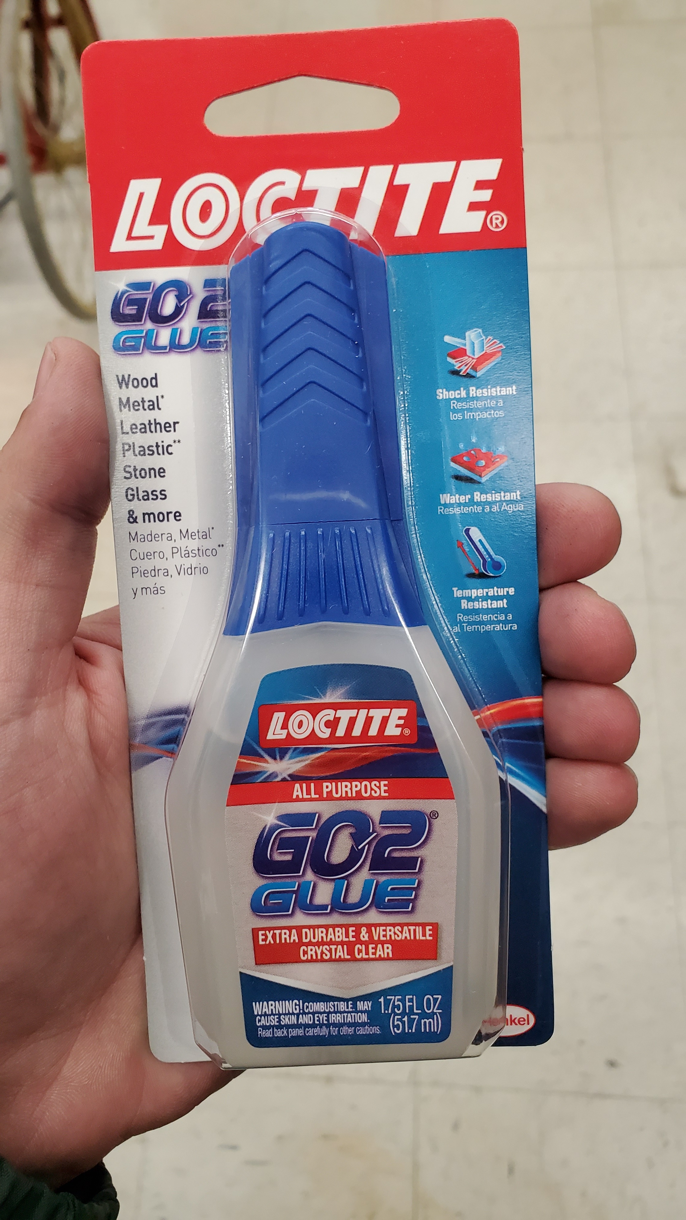

I know a lot of sites recommend superglue for pla prints. I’ve been using gorilla glue gel and it’s been working pretty well. I went to restock today and noticed a loctite alternative for plastics. Being a fan of loctite, I opted for it. Plus it was almost twice the volume for a buck more and made sense.
Anyone use this stuff?
