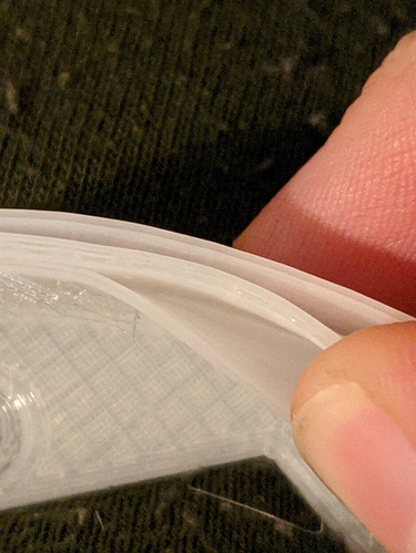

One thing i can’t get quite right is sticking layers with TPU.
or rather walls sticking to the infill
What is your line width @xsynatic? TPU doesn’t like wide extrusions… I use 0.38 with a .4mm nozzle. Many slicers use 0.48 and TPU is unable to expand and bond well to adjoining walls.
Increase flow% for TPU profile specifically. TPU is stretchy so when the filament is pulled in, lesser quantity is pulled in, compared to PLA, because the filament is stretched. You know how a rubber band gets thin when you tug on it.
Already increased by 20%. (Thats the result you saw above)

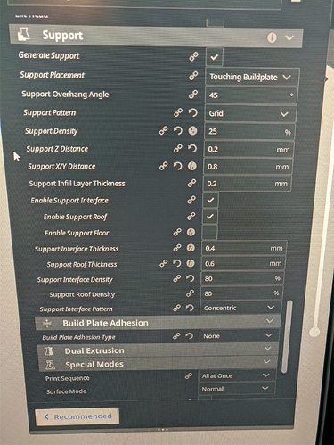

These are my settings. *Flow was increased via the printer itself
I dont use cura so im not really familiar with all those settings. I put the extrusion multiplier at 1.25, printing temp 235 and most important print very slow, like 20mm/sec
maybe I am going blind but I didn’t see the flow%. You can just type flow to select the flow options. I would say set the flow to 101% and see if the walls stick, if not 101 then 101.5% and so on.

This is what i mean on the printer itself
So cura set it to 100% but i changed it to 120% while the printer was preparing for the print.
120% is crazy which means your esteps are not calibrated well. I would suggest calibrate that first with PLA and then slightly increase the flow% for TPU.
I would suggest to make changes in the profile settings, not printer.
