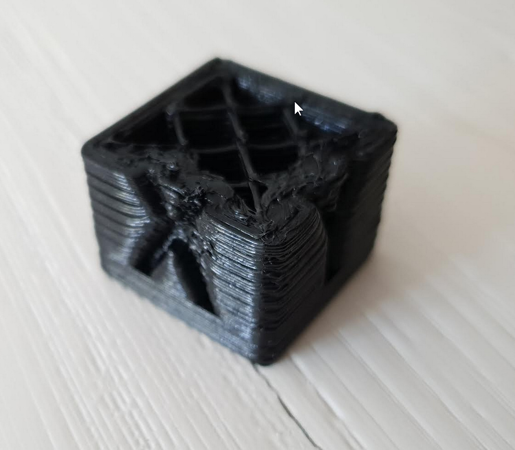

I’m not sure if it’s the same thing, as your lower layers do look underextruded, but if I try to print small objects with TPU, I get that melted look. The layers need time to set up before the next layer comes in. Maybe try printing something a bit larger? Usually with TPU for me, everything gets better if I slow it down way way way slow. But my TPU is all pretty hard/stiff, which is easier to print. Ah I see your stuff is also 95a.

Usually fails on the first layer and it’s when it starts doing the infill.
Going to just go nuts and set a higher temp. Clearly it’s having issues in the nozzle and I have replaced the nozzle, so it must be not melting.

Just set the temp to something high say 240. Raise the nozzle away from the bed. Use the control panel to extrude 10cm of filament. And see how it comes out. If it’s flowing well and uniformly there is no problem, if not, then it’s either your nozzle is not gettt hot enough, or filament diameter is not consistent and it’s getting stuck in Bowden (you have a Bowden or direct drive?) Or extruder gear is slipping. So which one is it?
Yeah tried that. Raised up, it extruded ok for about 100mm then the filament came out after the extruder gears and before the nozzle. Might have only been at 220 deg though. I’ll try it again.

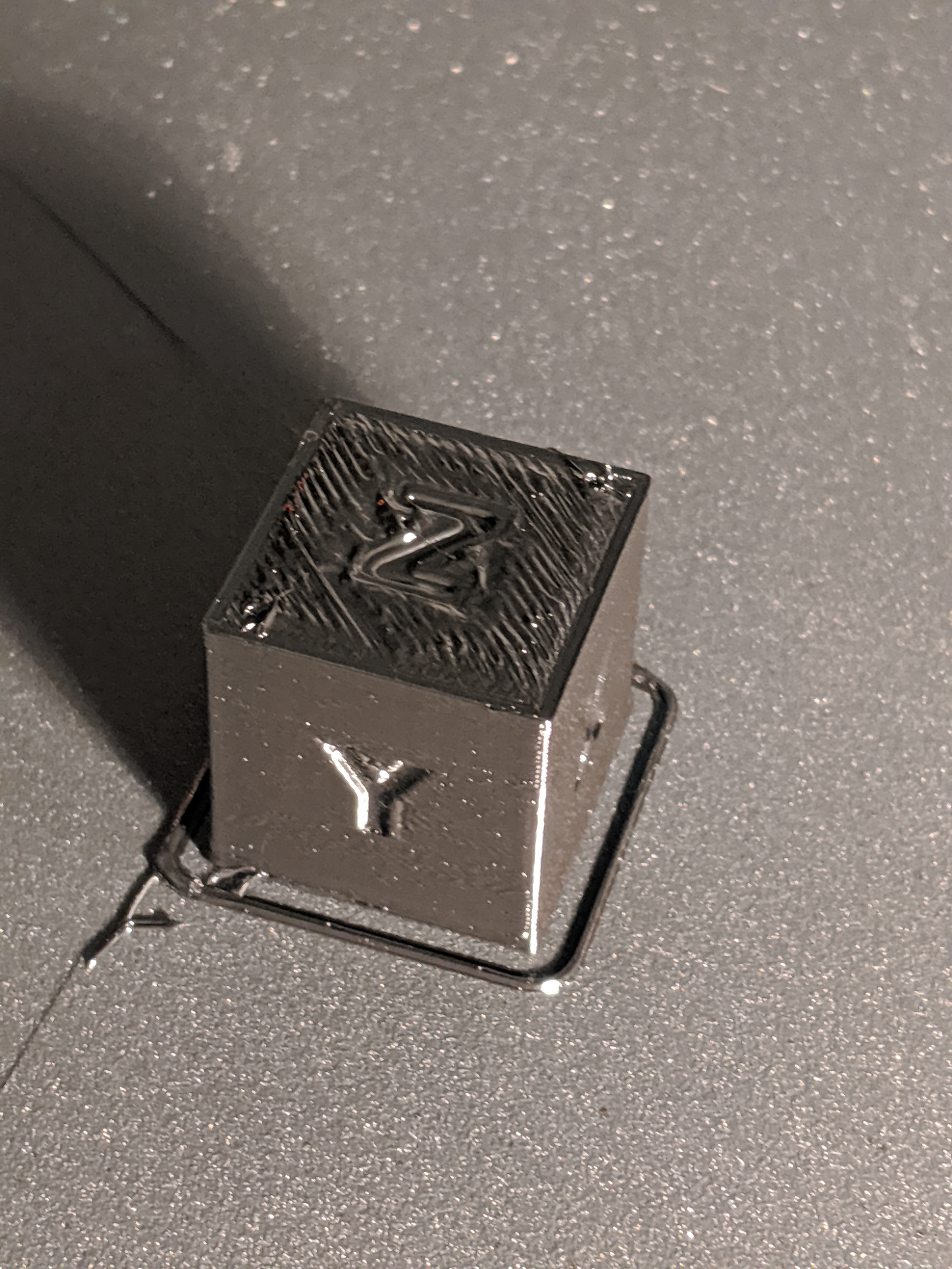

I’m trying the test cube here will get you my rates once finished and can see if it turns out okay. Says 45 min on .2mm fast mk3 setting in prusa it looks like the main difference for TPU in prusa slicer (slic3r) is the “max volumetric speed” which is set to 1.5mm/s, the generic pla for comparison is set to 15 mm/s, normally this xyz cube takes about 20 min or half the time to print in PLA
Other notable difference the extrusion multiplier is 1.2 for TPU vs just 1.0 for PLA
Prusa slicer version had temp at 240C on hot end and 50C for bed and seems basically no part cooling fan going. The TPU is hatchbox (I think 98A)

Came out really good here print temp was much higher than labelled on the box marked for 190-210 but printed at 240 feels a bit stiff but old filament not sure if product of age or temp but looks nice.

I may be nearly finished with my second successful print right now. Pretty happy, the XYZ Cube is at about 70%. Will post victory pics shortly.
Solution was probably 135 degs, 10mm/s and a devil-may-care attitude.
