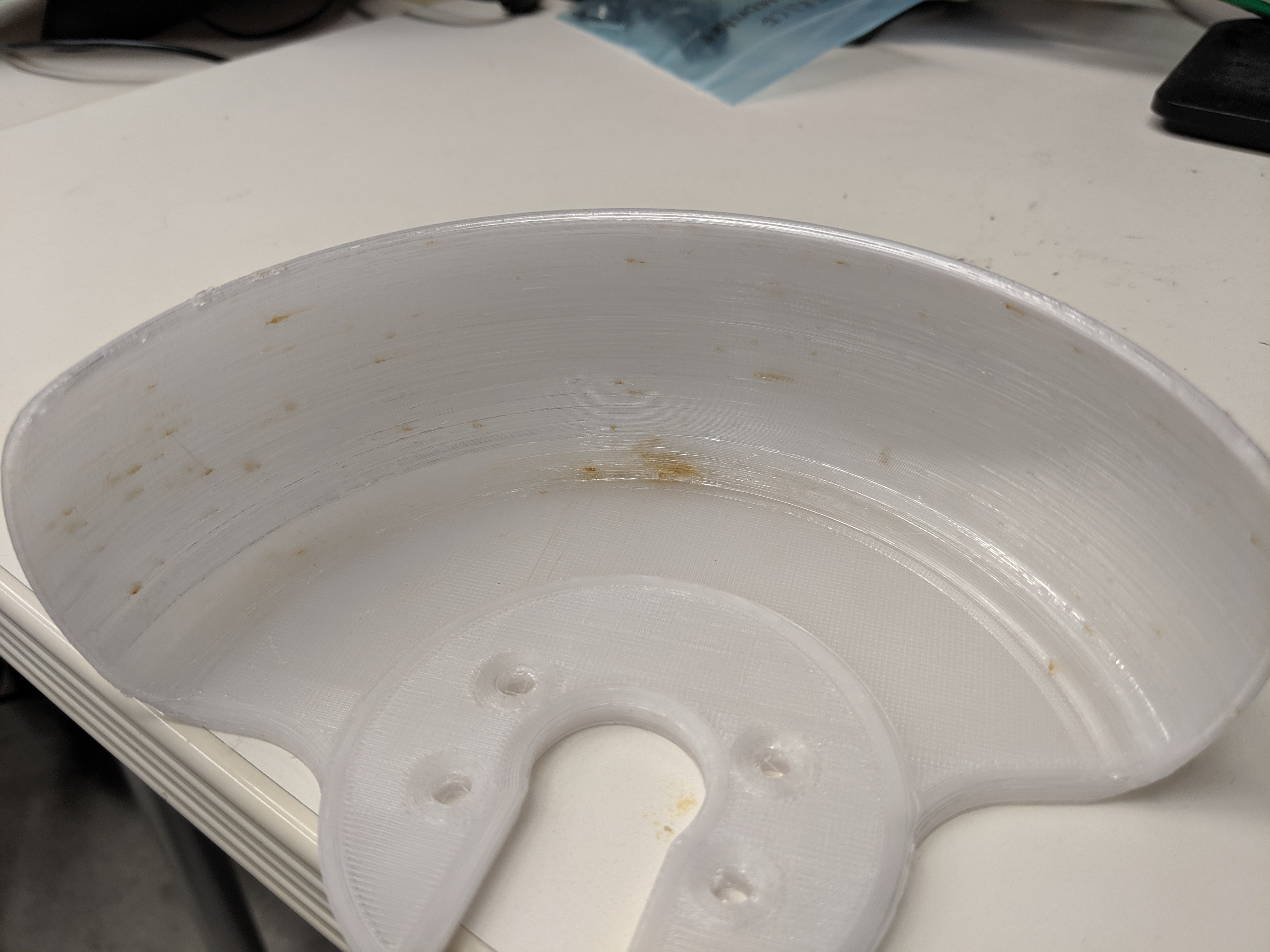

So it turns out, it’s the flat shape of the e3d v6 style nozzle that drags up filament as it moves, in case of PETG. My nozzle dia is 0.4 and the line width is 0.44. but the diameter of the flat portion of the nozzle is 0.8mm. The filament then burns and leaves yellow chunks on my prints.
makerbot_vs_ultimaker_nozzle
I could have gotten a pointed head nozzle, but I didn’t have any and solved it by using a sandpaper and a drill to make the nozzle point.
Below are 2 prints with same settings. Before and after
